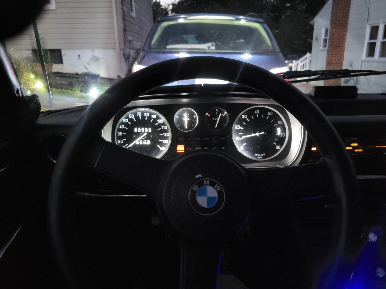

Some useful upgrades, the image makes the lights look a little brighter than they do in real life
I think they were from this site for my 73 Bavaria
Walmart also sells a 5.75 led headlight made of glass I have them on my 71 Bavaria

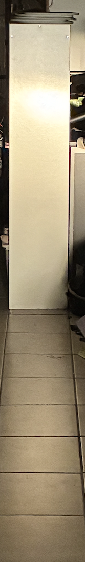

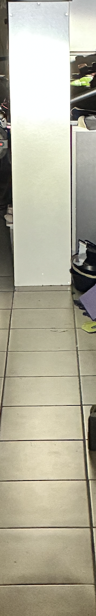

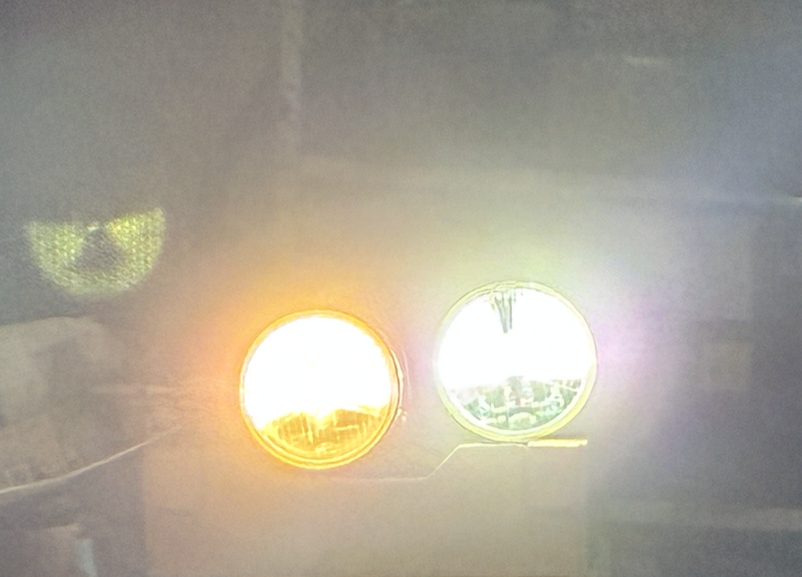

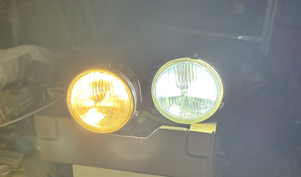

I did this test arrangement in by basement: left is the original H1, right is the LED:
lighting test in my basement - LED vs standard H1 halogen
my limited experience with LED bulbs in our vintage housings shows that the reflection + refraction (thru the lens) leaves a lot to be desired. because LED is very linear, it doesn't 'bounce' / refract as well - most new applications send light straight out without reflection. in both of the pics of the LED bulb in your lamps, notice the 'blank' spot at the top. that will probably be a blank spot somewhere on the road / in front. it looks brighter, and it is a 'whiter' light, but doesn't always get light where you need it. sooner or later they will figure it out, but there is a reason that most LED fixtures don't use faceted lenses as they aim where the light goes vs. vintage bulbs that sent light out omni-directionally so the reflector + lens distributed the light. you will also see that shadows are very crisp instead of diffused due to the linear nature of the source. that being said, i have not seen these newest versions of the bulbs ... they could be much better than a few years ago with the placement of the diodes to hit the reflectors ... but the facets are much different on each manufacturer's glass. the low beam cutoff generally doesn't work as well.
