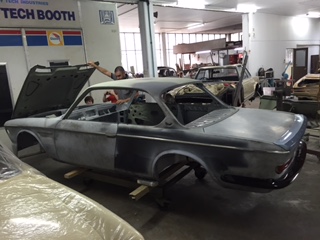

We are close to final painting on a full rebuild. See rear pictures.
The light weight rear bumper has been trial fitted and we have all asked the question why is it black gloss?
I have seen plenty of images of mostly Alpina's with very matt black rear bumpers but a few CSLs with gloss. As the decals are matt and the wheel hubs are matt black I wonder if they were all designed to match.
Has anyone got a stock original fibre glass bumper from the 70s and can report? Other comments?

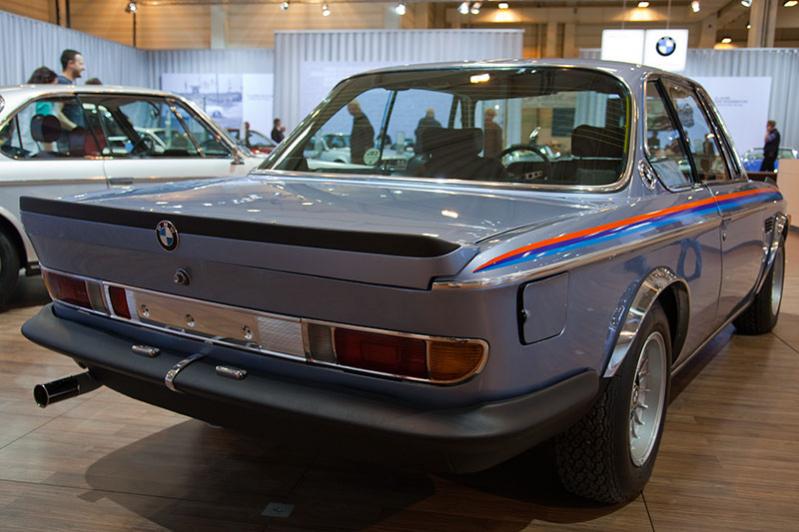

Hi,
It should be a matt finish.
I hope this helps.
Pete
