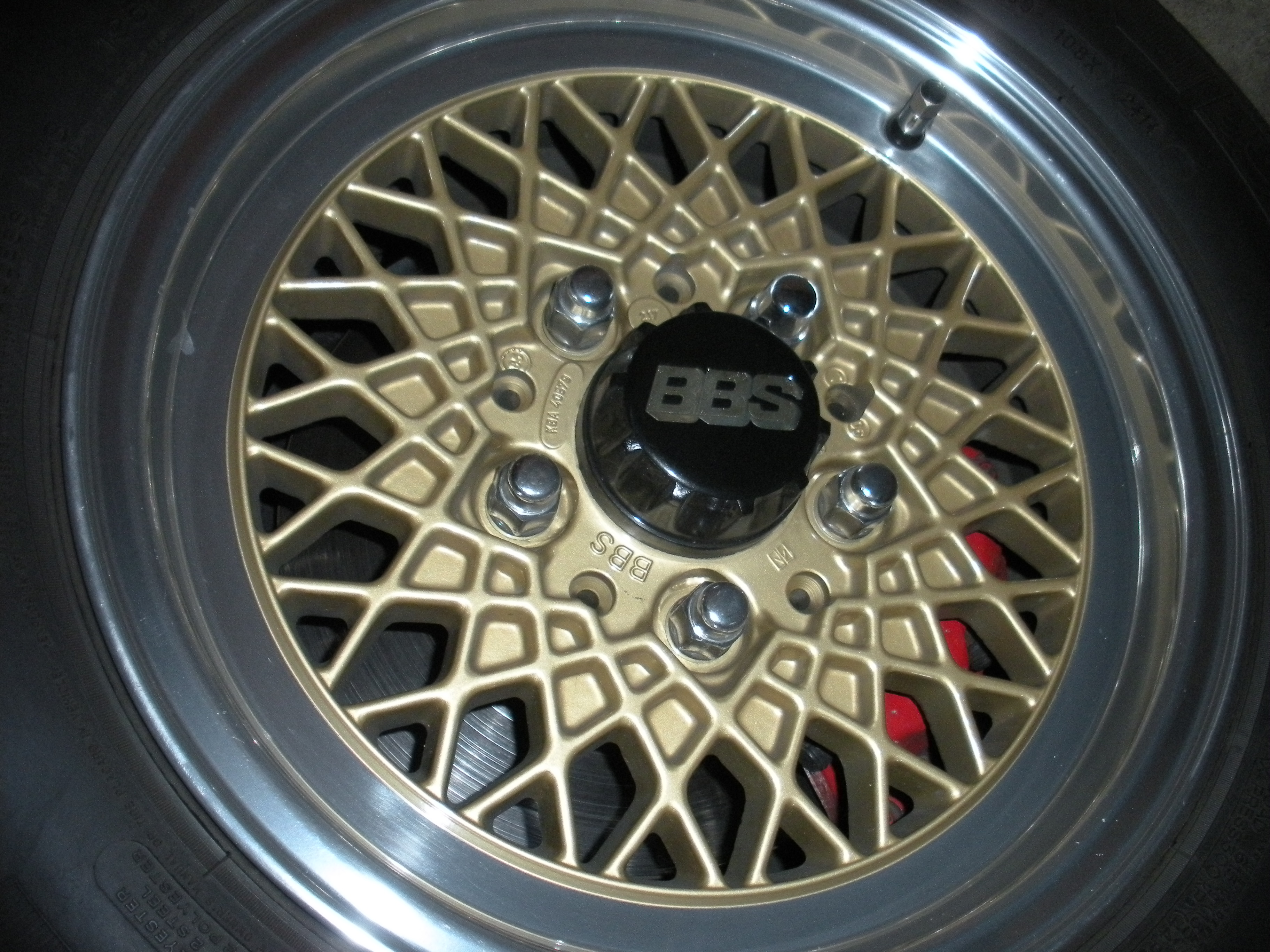

I have used several sets of McGard's locking nuts over the years - pic is of present set on my BBS wheels. I always get them at Summit racing - best price available.
Thanks for the reply, can you remember the particular code for the nuts as I need to make sure they are deep enough for the thread on the studs.
Cheers John
My records (from 2007!) show these numbers on the invoice:
Lug nuts: SUM-754001
Lock/unlock lug wrench adapter: GOR-71631N
I seem to remember that one could also get these nuts in "black" (whatever that means).
Best of luck, down under!
Gary
