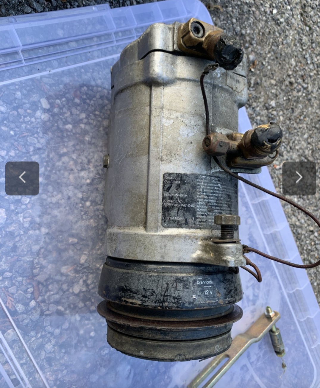

One kind forum member is stepping up to help me out; is the compressor (see pic) a clear candidate for replacement by the newer (Sanden?) type?
Or can an original unit like in the pic, (perhaps after rebuild?) function just as well? Screenshot_20231031_222436_Samsung Internet.jpg
Since you are not keeping the car original, I highly recommend the modern Sanden. It will produce better results, be replaceable, and most likely cost less than questionably rebuilding an older unit. Also, it weights less and takes up less room down below. Opinions……veel geluk

Agree, and you can also do away with the dampener on the fender that is only necessary with the original unit.

if you go with the new Sanden unit, i highly recommend the WC Wylie (Layne) mounting bracket. see the FAQ for best sources. also check out @Stevehose post on A/C upgrades with the parallel flow condenser. if you want to make things easy ... you can buy a kit from our friend @sfdon. it will have everything you need - compressor, bracket, condenser, hoses, spal fan ... all made to work together
+2 on everything said above @eriknetherlands - the guiding principle for my 2023 AC retrofit project was:
-everything on the passenger side must look stock - front plate, knobs, panels, side vents, evaporator core
-everything under the hood-upgrade to latest technology and new parts for maintainability, spares, function
