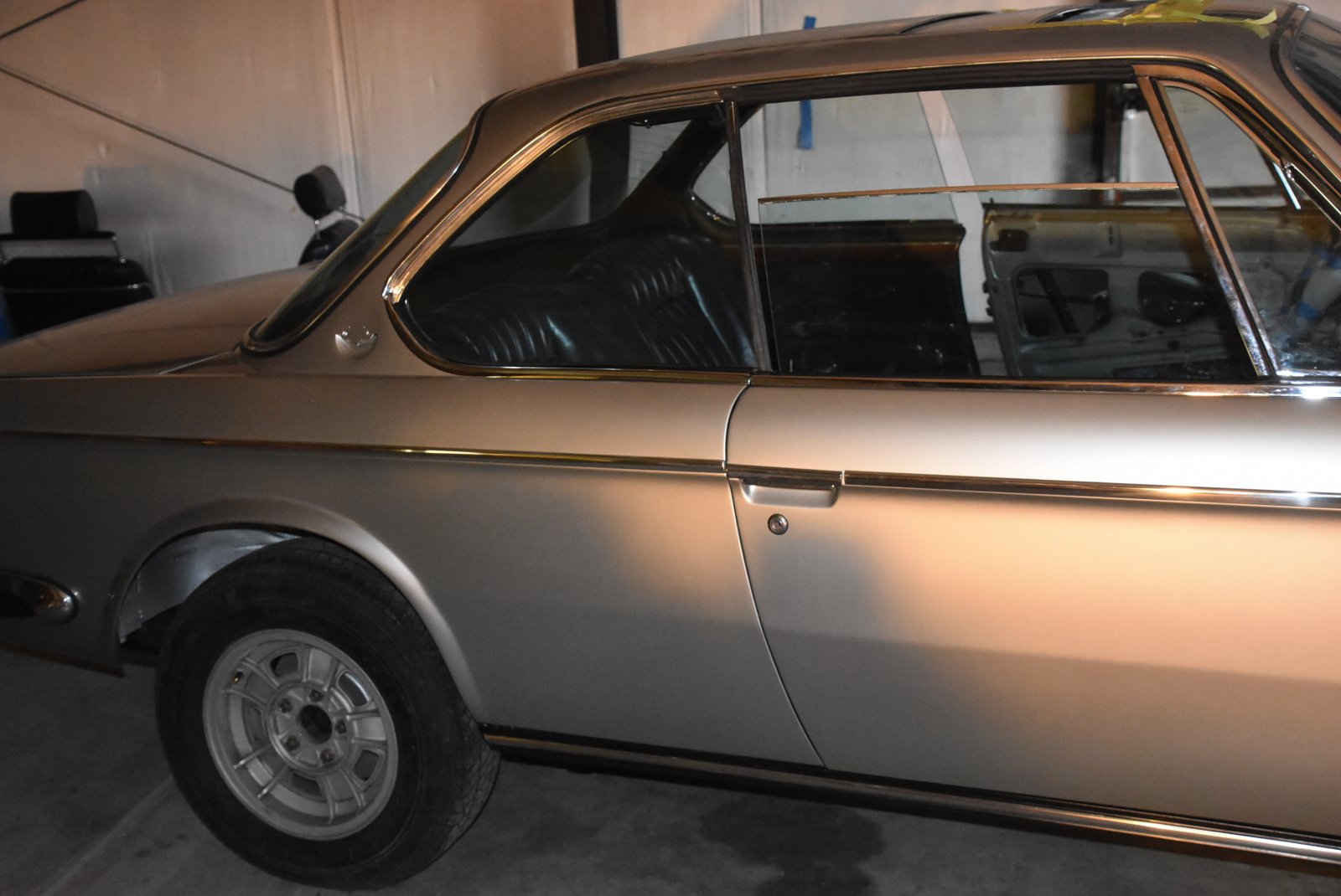

These are all parts that came out of the car, the car was not bent before repaint
For the windows,
I think I am aware of all the adjustment points on the aft track and on the vent window track
My problem, questions,
On the passenger side, the glass is too far aft, it is probably .05" from the metal trim
I think if I hit a bump or someone slammed the door it would hit
There is a chip in the window at that area already
I don't see anyway of moving the window forward or aft other than moving the door, and the gaps look pretty even where I have it
On the drivers side, the rear upper corner is too far out
It seems like the only adjustment is to move the bottom of the tracks out, but they are at the end of the slots
Maybe I need to slot them further, new brackets?
Are there any tricks to adjusting the doors?
We got them very close with a trial and error but it is difficult to do
Has anyone made a jig or stand to hold the door while it is open so it can be held at the correct spot while tightening the bolts?

I feel your pain, even though I made many cheater marks & took pics of positions prior to removal. Ultimately loosened all bolts & used big clamps to hold it in what looked like correct fully-raised position, tightened bolts, and then fiddled w different raise & lower positions. Even loosening the window-glass bolts gave it a bit more play to work with. I’m sure there’s a much smarter &
more efficient way, but this finally worked.
My question on the windows, it seems like I am at the end of the adjustments
The window mounting bolts seem like maybe a good idea, but it seems like it is free to float on the actuating arm
YES I KNOW THE IS
HERES WHAT I DID I USED A WOOD BRACE ON THE BOTTOM AND A SISSOR JACK
TO MOVE THE TOP IN THEN SET THE BOTTOM
TO MOVE THE DOOR FORWARD
ALSO YOU CAN FILE OUT THE TOP VENT WINDOW SLOT AND MOVING THE VENT WILL PULL THE WINDOW FORWARD

Sorry if I misunderstood. Sounds like you might have to make some space on the brackets. I also considered whether I’d bent the bottom of the rear guide rail where it attaches and whether I’d used the incorrect washers or other hardware that would change the angle. I compared to manual & driver’s door & ruled those out. Interested to hear what works.
YES ITS A REAL BEAR OF A JOB
AS YOU CAN SEE ON MY POST
i actually had to file out the hidge holes on both the door and body to get mine close
as my fender was not set correctly from the body shop.
a real bummer
setting the vent forward will help a bit for sure

Hi Alan
by file... I assume you mean the one attachment hole near the forward top of the door, near the vent, that seems to be the only hole that is not slotted
I can't imagine how they made any money on them, even if you did know what your were doing it had to take a lot of time to put one of these together
