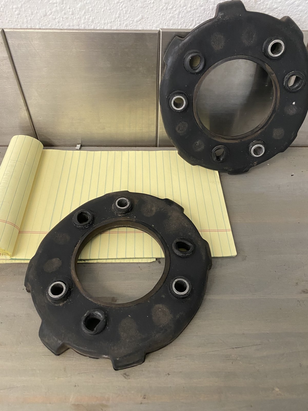

Looking for Front upper shock aluminum spacers (2).

Hello, In search of the two aluminum spacers that shim the front upper shock mount to the inner fender. part # 3131113721. Approximately 20 mm in thickness. I installed H&R sport springs front/ rear and the front is just a bit too low for my application. Suspect that the fender could rub during the wrong bump and or dip. The rear height did not change at all so I am going to have to find a way to shorten the rear spring a bit in order to make it more level. Anyone have a set?

If you can't find one, you could always go to SendCutSend and have a couple cut out and sent to you in most thicknesses. I hear good things about them.
I recycled mine, so I don't have anything for the front.
For the rears, there are two different spring perches. When BMW increased the ride height to meet US DOT headlight height rules, they added the front spacer you are seeking and created a new, fatter rear spring perch so as to raise the car by equal amounts front to back. If you have the Euro spring perches, the US spring perches will raise your car about 3/4". Paul Cain has a thread here where members measured ride height - If someone has posted data for the H&R springs with the European spring perch, you may be able to use this thread to determine which spring perch you have installed in your car. https://e9coupe.com/forum/threads/s...result-in-what-ride-heights.39747/post-343117 If you have the Euro spring perches, and want to make a change, I am pretty sure I have a set of US rear spring perches that were never installed. Message me if you may be interested and I'll double check that I haven't sold them already.

Thank you.
Larry Louton
Hello Ohmess, I am going to have to take at least one side down again to see what I have. The front spacers were removed by the previous owners, indicated by the long studs so I probably have the US spring perch in the rear all ready. I will take to my local dealer and see if I can order a Euro perch? Perhaps Walloth? So if I go up in the front 20mm and go down in the rear 20mm, Hopefully it will balance out a bit. 1-1/2 inch higher in rear now.
Thank you for the info.

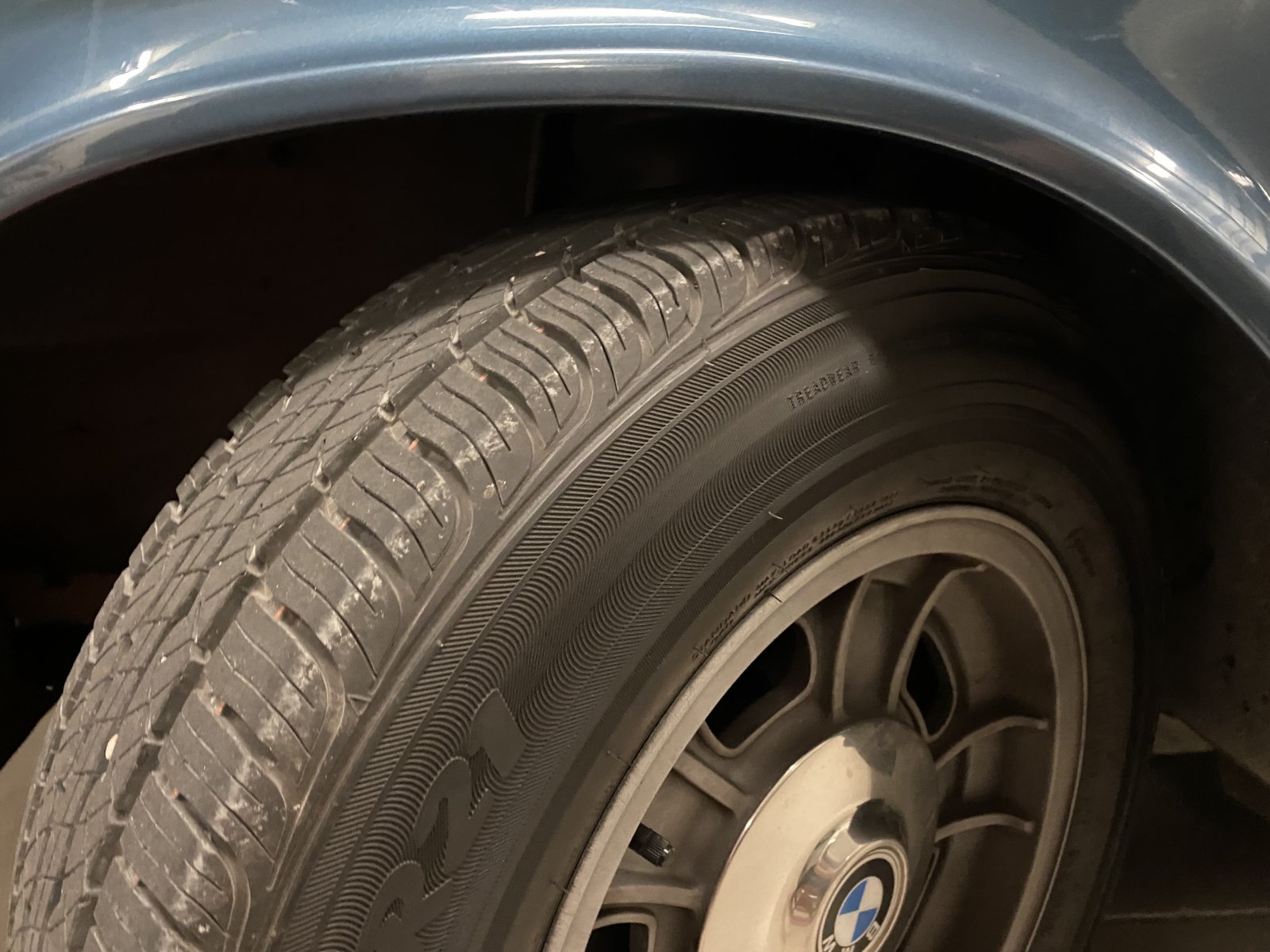

1”1/2 inches. If I turn the steering wheel to full lock, I have about two tight fingers between tire and fender. A bit too tight for me. So if I raise the front about 20 mm or 3/4 a inch, it will give me the clearance to clear the fender lip and half of height difference. Found earlier this evening at Wallothnesche a piece of information.
