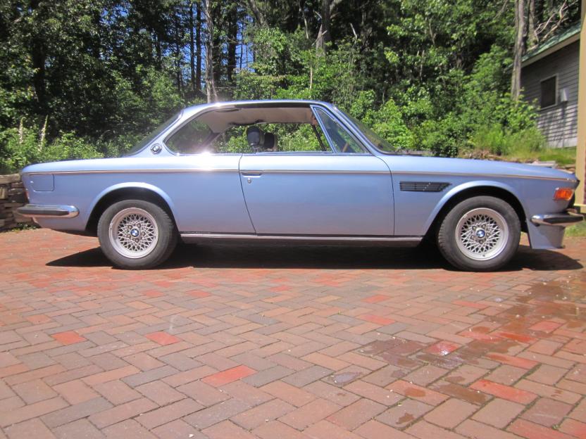

I have a set of 14 inch BBS Mahles I'm willing to sell for $500, recently restored to BMW silver with a coat of clear. Attached pic is them on Athena before restoration.

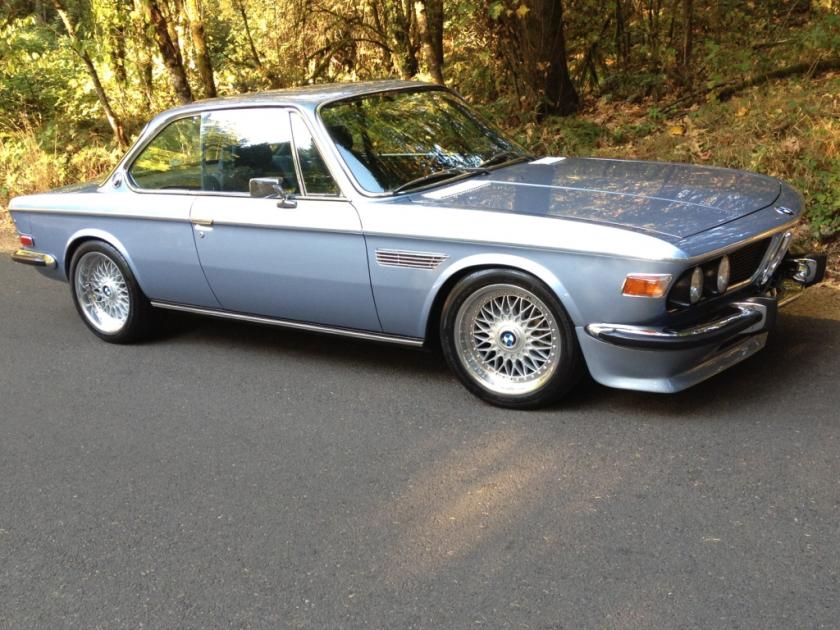

I had a set of BMW 2-piece style 5's in 17x8 with 215/46/17 in the fronts so it would clear the struts. Man I love how they look on our E9's. I get tons of compliments on how they look.

David, your car looks great!
+1 on the Style 5s. I've had them on my coupe for 7 years and finally found a rare set of the staggered 17s last year.
