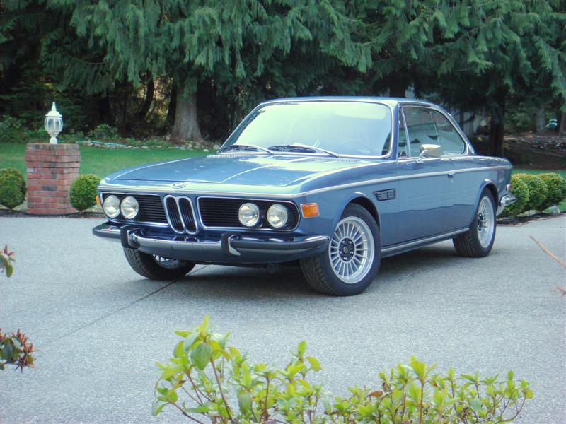

My car also has the Carl Nelson springs (Tony/Velocewest installed them before I bought the car from him). Tony also told me the car has the Bilstein Sport shocks...
I've since installed 16" wheels (7" wide with offset ET16) running 205/55 tires (Falken FK-452).
The only hitch I have had -
I had thought the tires fit without issue (and had 1000 miles to show for that) but had an episode now that had the left fender rub a couple of times.
So - As of last week, I have rolled the fenders and that should take care of it.
But - Yes....
I do like the spring/shock combo... VERY nice.
