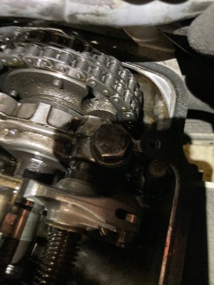

My m90 has a single. From a 735i E23 Sept 1979

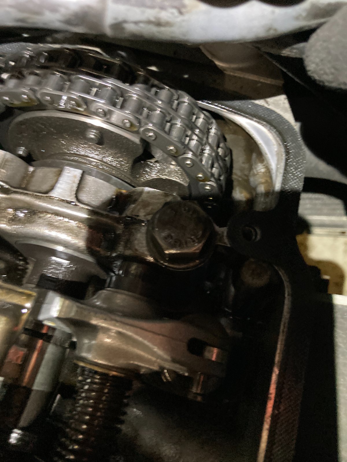

My M90 has double chain. At least now and through out my ownership the chain has been double. Engine origin M535i Dec 1980.

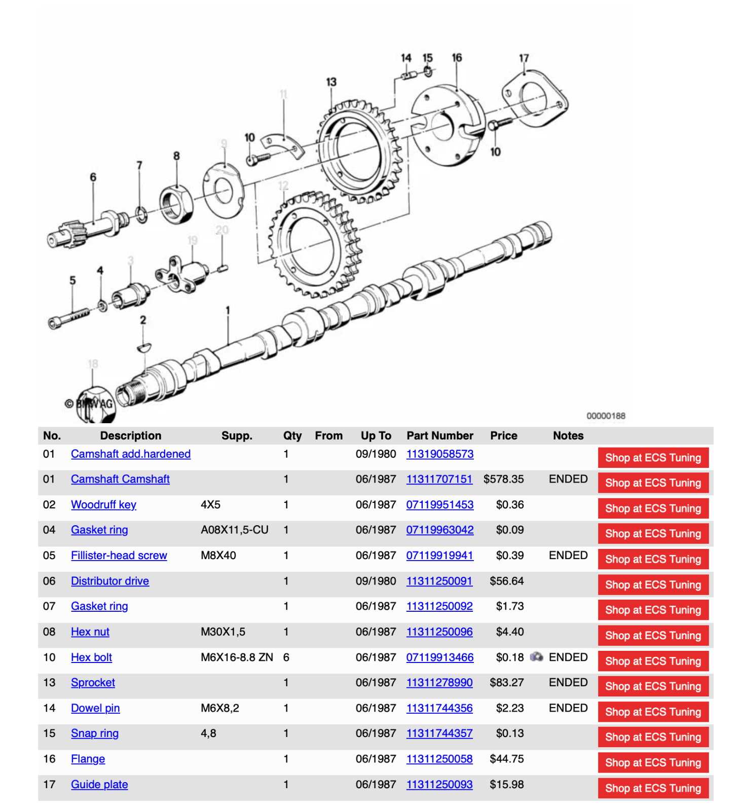

Curious if you have the VIN on the engine. RealOEM shows the 1980 535i as having a single row. For all the cars I looked at on RealOEM, the double row sprocket is listed in the figures, but it is greyed out, and only the single row is actually shown in the parts list

a note from the engine maestro - @sfdon says that the early engines had 2 row chains and quit at some point as it wasn't needed ... and from then on it was single row.

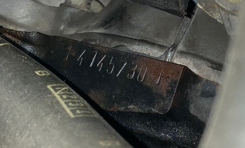

I do have it: 4145730
Sami
Sami
Very interesting that was a December 1980 car. That one comes up the same as my 1980 M90 (5549667, March 1980) as a single row in RealOEM.
And reading @rsporsche 's post it may be an obsoleted thing. I'll have to go take a look at mine again. It's been a long time since I had the valve cover off!
