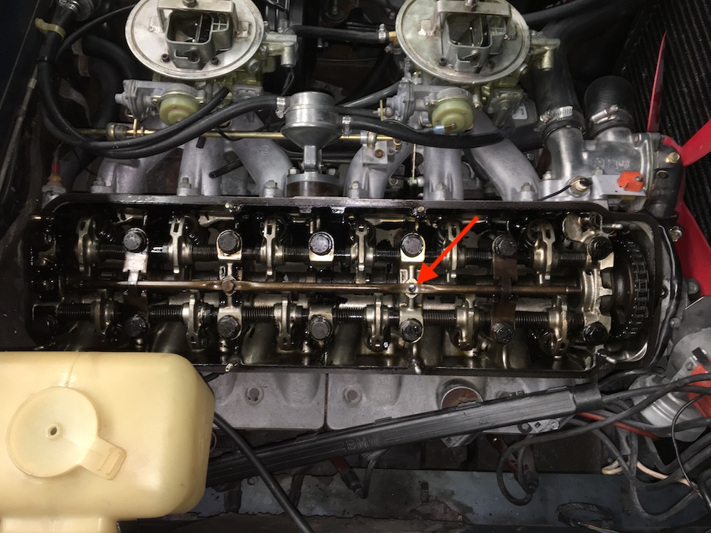

I removed the valve cover in my Bavaria today in preparation to adjust the valves and immediately noticed the front hollow hold down bolt for the oil distribution tube was missing...
Luckily I found the bolt and the aluminum sealing washer in one of the cavities in the head.
Although I haven't heard any strange sounds from the engine, what damage could this have caused?
The torque spec for this bolt is only 7-9 ft pounds. It can't be much or it will crush the tube. I plan on putting a drop of blue Loctite on the bolt before installing it. Has anybody else done this?

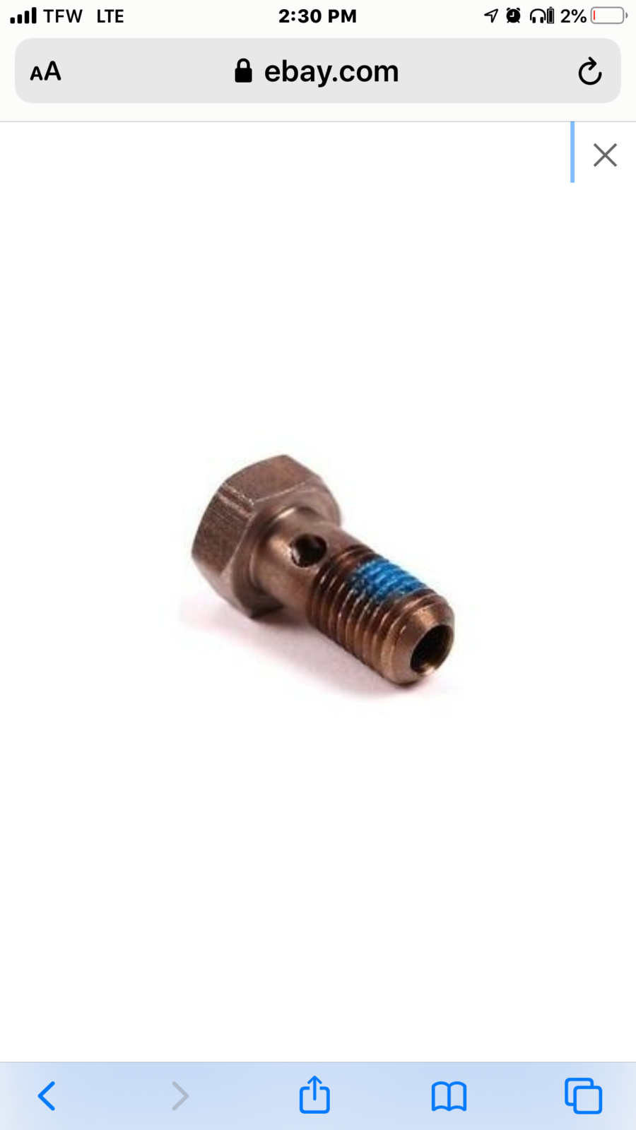

There are many approaches To this
Lock tight
Safety wire
Putting a crimp mark on the threads
Installing the factory replacement part that comes with a thread locking compound
You will spot the updated bolt by the circle on the head

Examine your cam lobes for damage including pitting and Presence of a saddle
on the top/side of lobe
I think I dodged a bullet. There doesn't appear to be any pitting, scratches, etc on any cam lobe. No "saddle" that I can see or feel on any lobe. Normal shiny track where the followers ride the cam from the sides of the base circle up and over the lobe.

Has anyone here crimped the center of this oil tube as I’ve heard done before to increase oil flow to #1 and #6 lobes?
