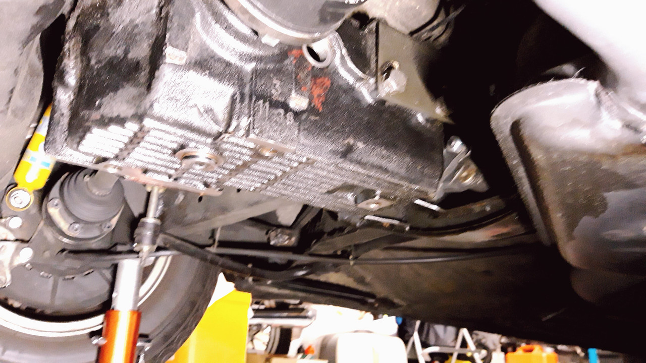

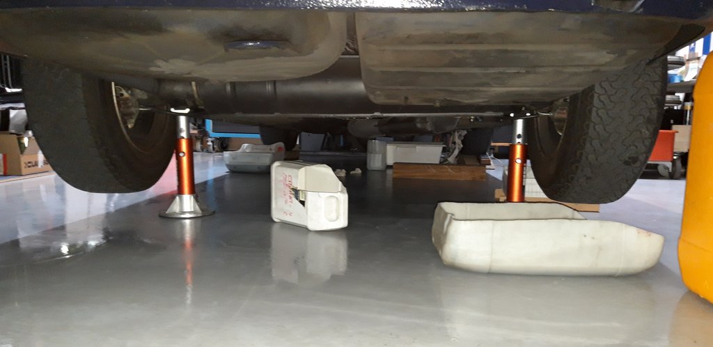

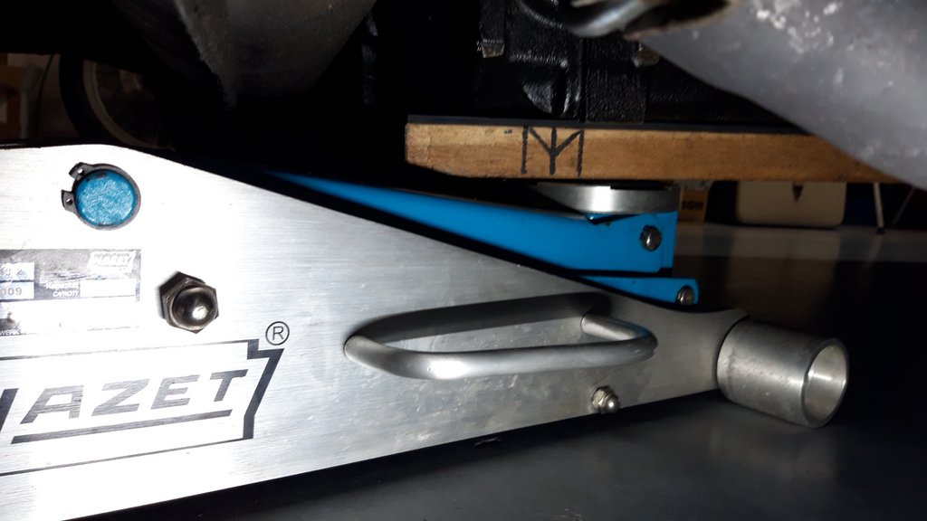

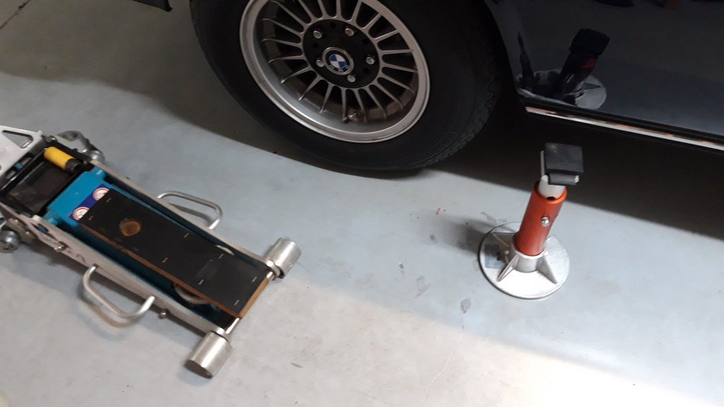

i find important to warm up the engine with a quick fast spin, no less than 30min to make sure that diff and gearbox oils reach their operating temperatures, and put the coupe on stands, considering the CN suspension setup i need a couple of wood ramps to be able to reach the front subframe plate, see pics

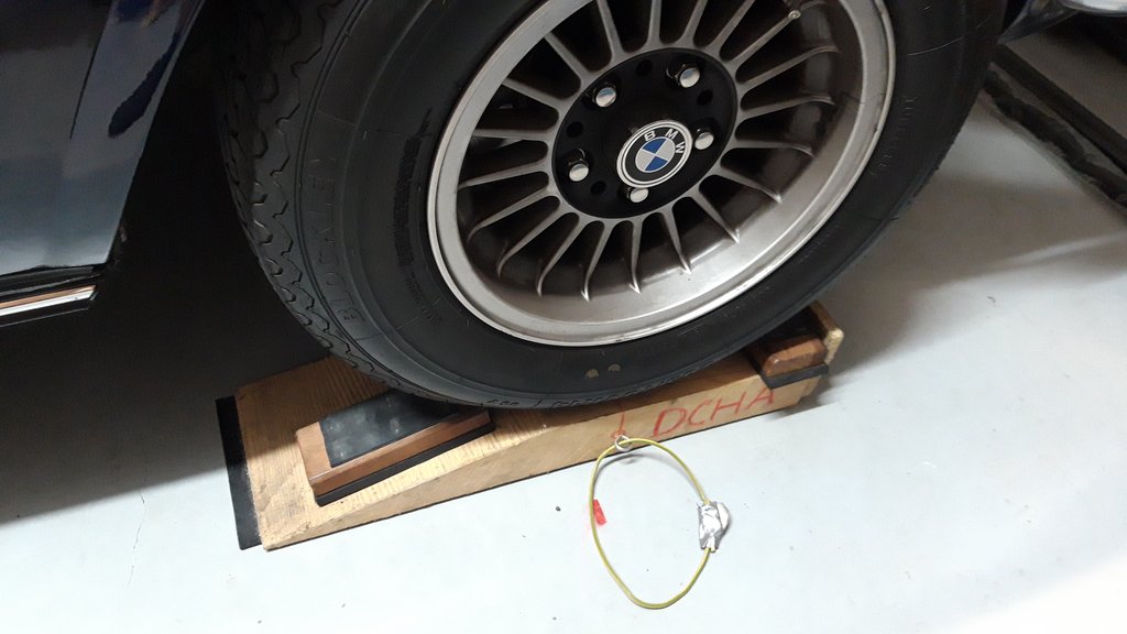

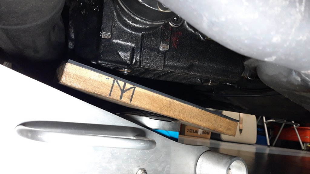

process is first rear, using an adhoc wood piece to lift the rear subframe through the diff, wood piece has a hole for the diff plug, lift it up and then my new ultra light and slim stands, so convenient to avoid touching the tyres when the thing is released down
then over the front, place a wood under the engine subframe front corrugated plate, lift it up and put two more stands on the front subframe,
finally
place containers or recipents on the floor

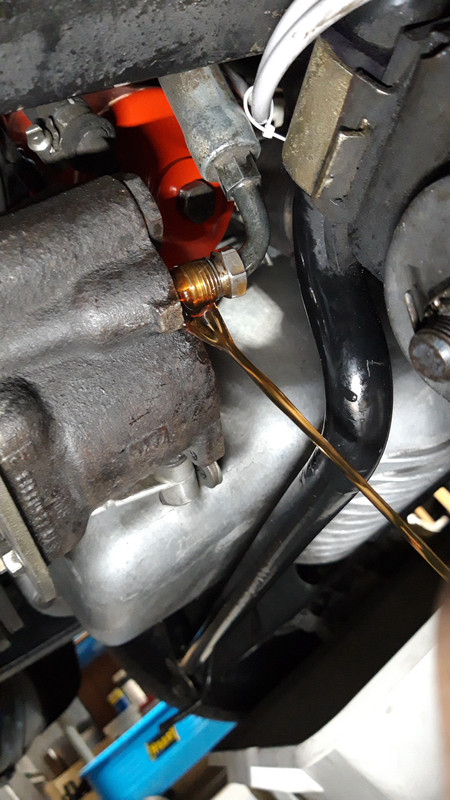

drain the oils, engine, gear box, diff, and steering, and then coolant

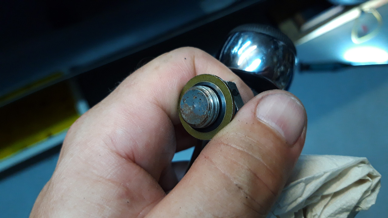

remove the drain plug first, and then remove the other end, it might be the topping plug or the coolant reservoir cap, this action helps the fluid coming out
keep the plugs, and nuts and bolts and washers in a safe place and note everything

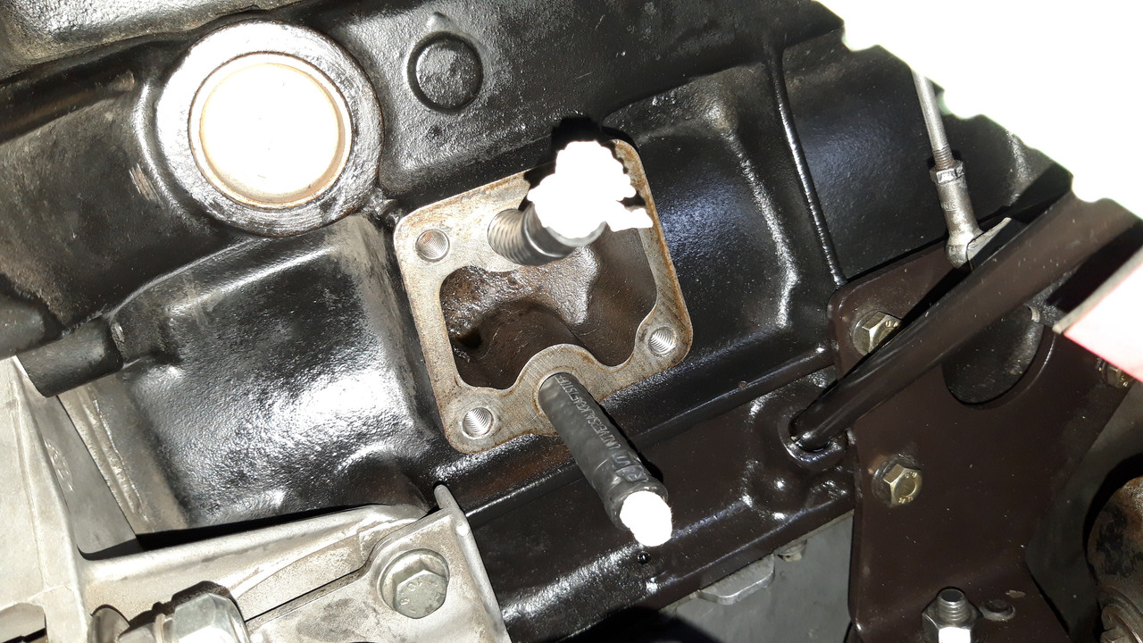

Hex bolt M19
crushable washer needed
remove all filter element from support, 4 bolts M13, change paper gasket,
inside container be careful to identify and keep the bottom plate (avoid throwing it away with the old filtration element)
reassemble, new paper gasket, bolts at prescribed torque, 25N.m

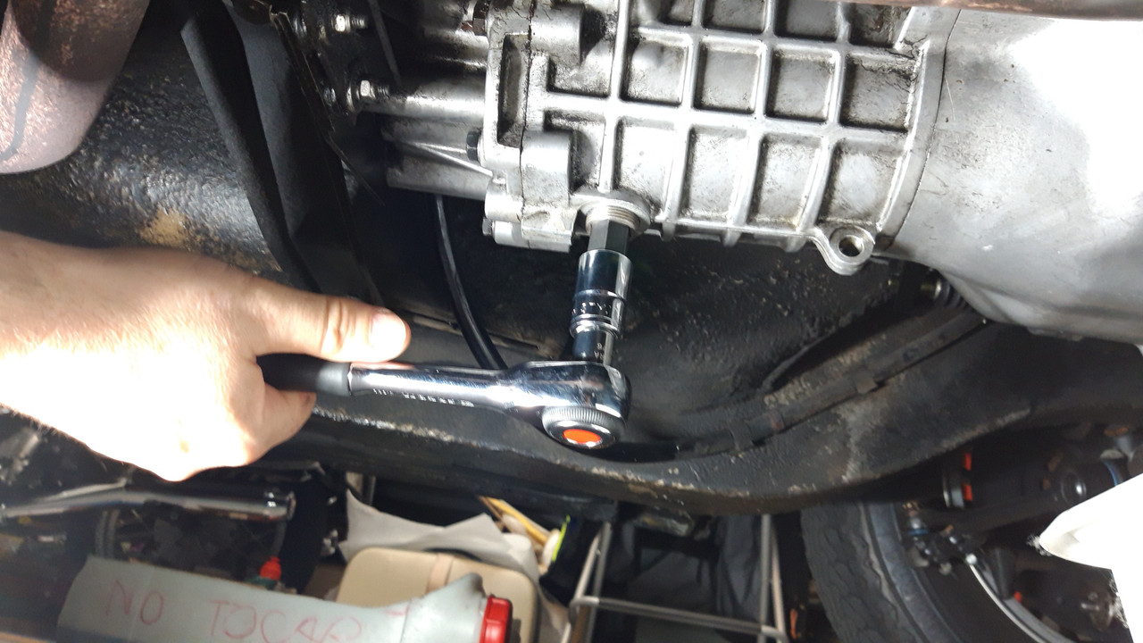

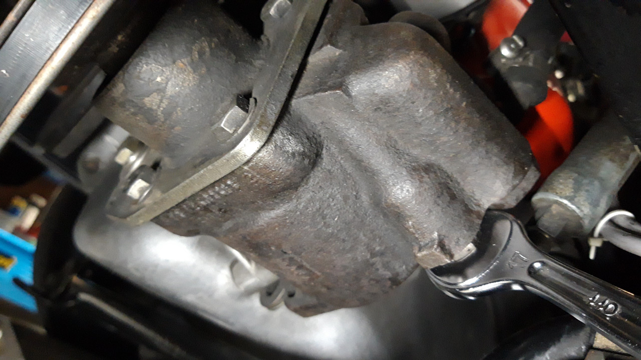

gearbox, change oil 30000km

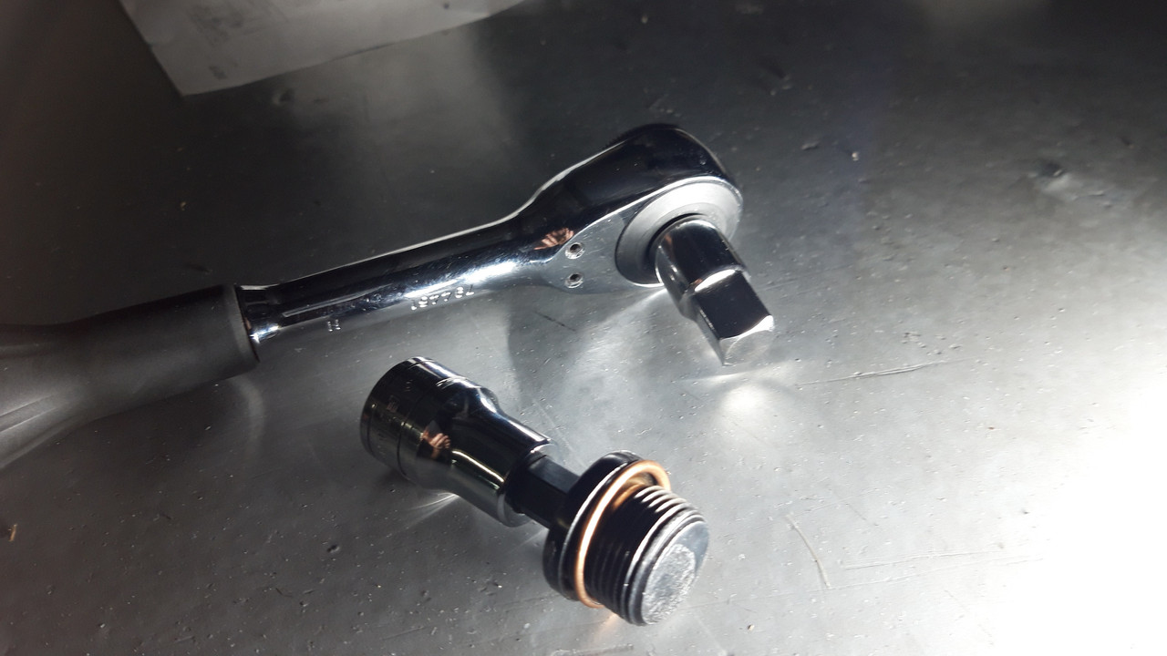

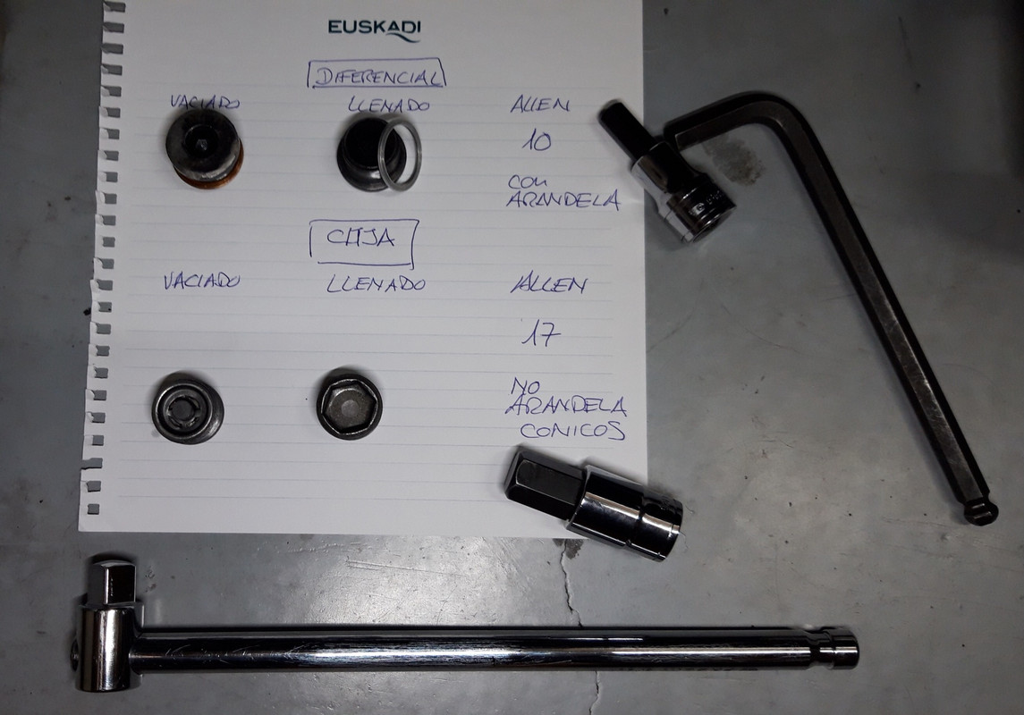

drain conic bolt with a magnet, use allen head M17 (no washer needed)
level is lateral hole used to fill the oil, also conical bolt in there, do not overfill
diff, check level 15000km, change 30000km
drain bolt allen head M10, need washer better if crushable copper type
level is lateral hole used to fill the oil, also allen head bolt in there, again washer needed, do not overfill

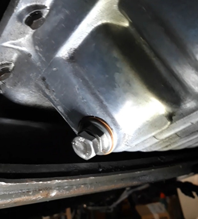

better drain when warm,

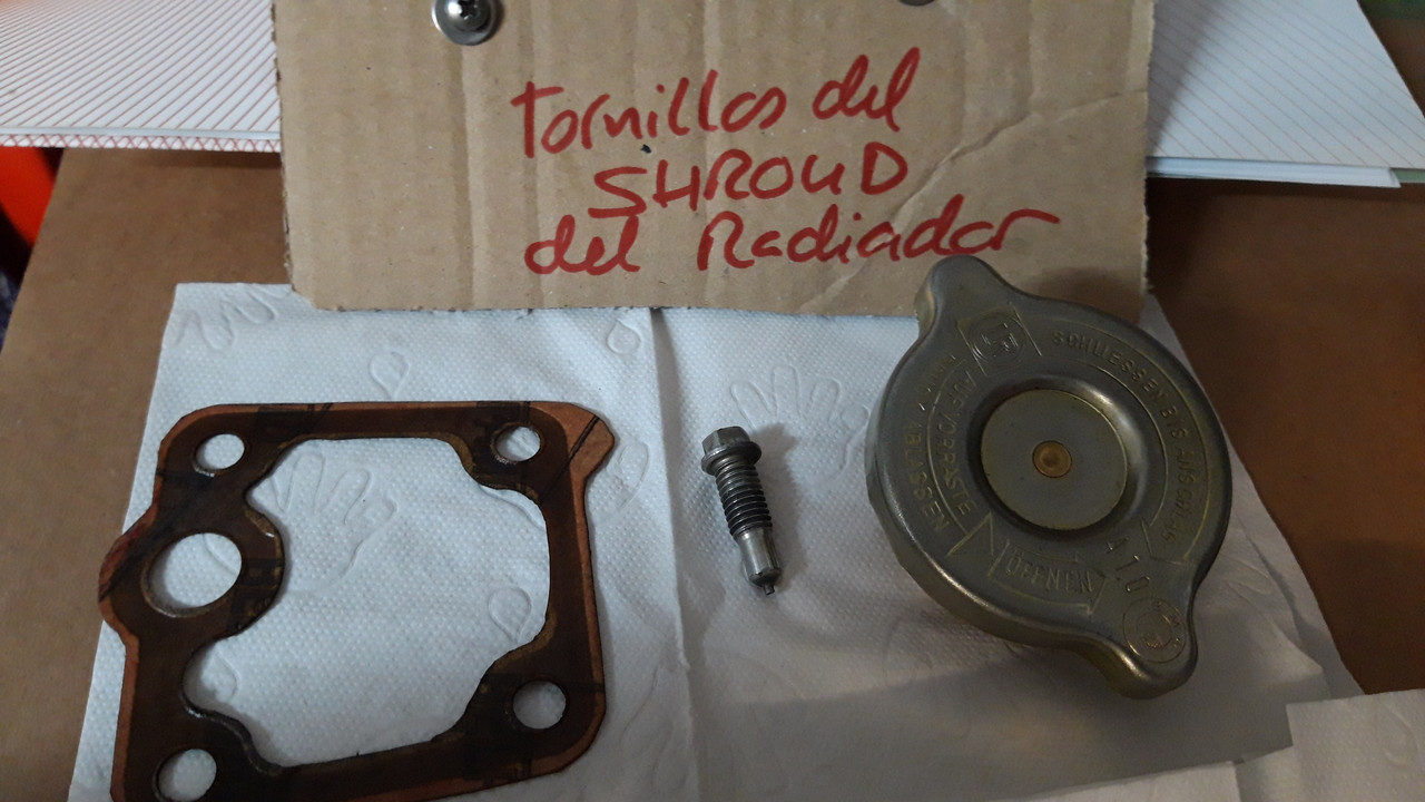

radiator bolt M19, needs washer
do not forget bottom bolt (M19) on engine bottom right side rear, here is where the main fluid will come out

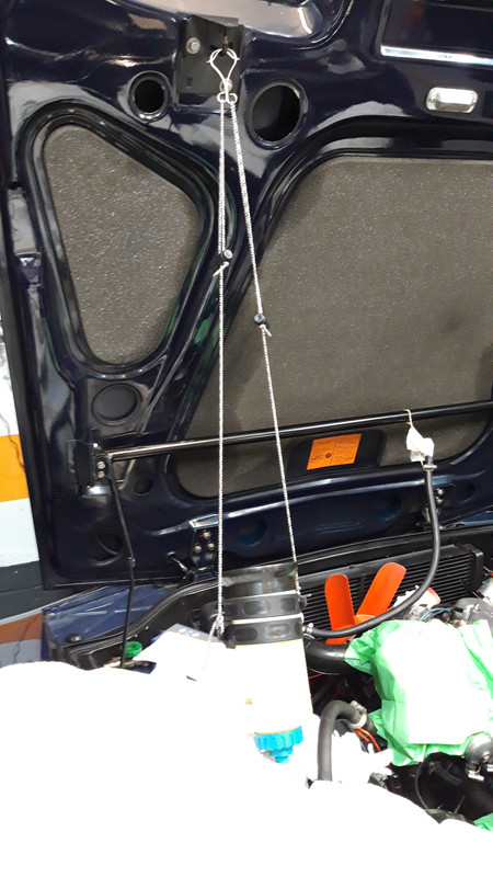

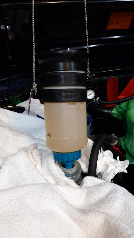

better use a venturi-suction type device,
while bleeding remove old fluid, follow manual sequence for bleeding points

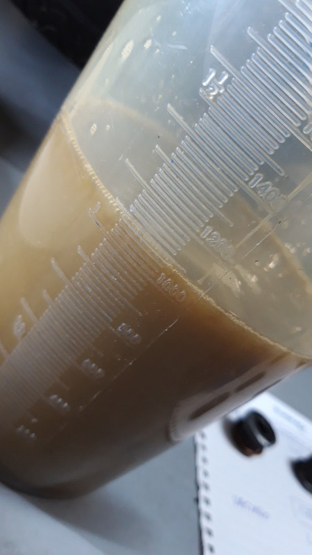

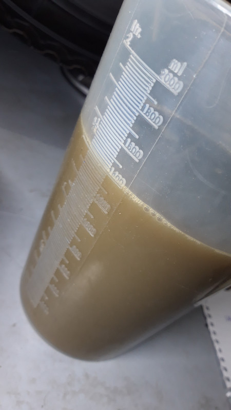

Thanks for the great photo essay DQ I like it.
What is the fluid in the plastic beaker that looks like "cafe con leche"? There's no fluid in my car that looks like that.

“cafe con leche”, that is gear box and diff oil, but i added ceramic additive, hence the emulsion that you see, it is 100ml. ceramic esther based additive
steering fluid is ATF D2 from BMW it is red in fact

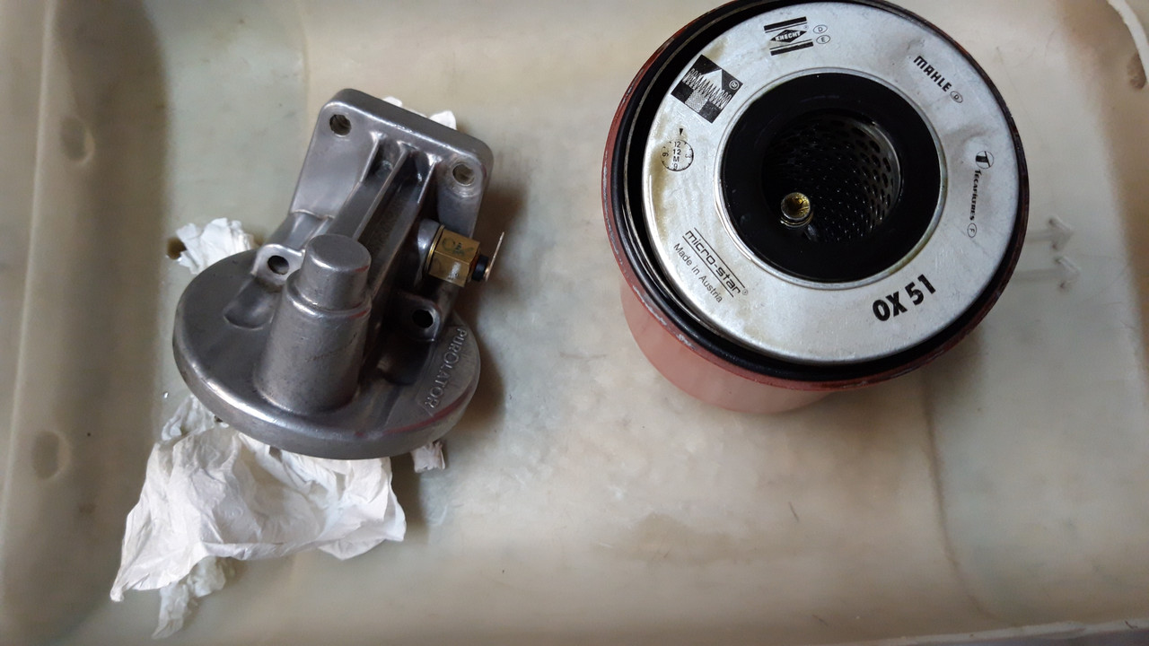

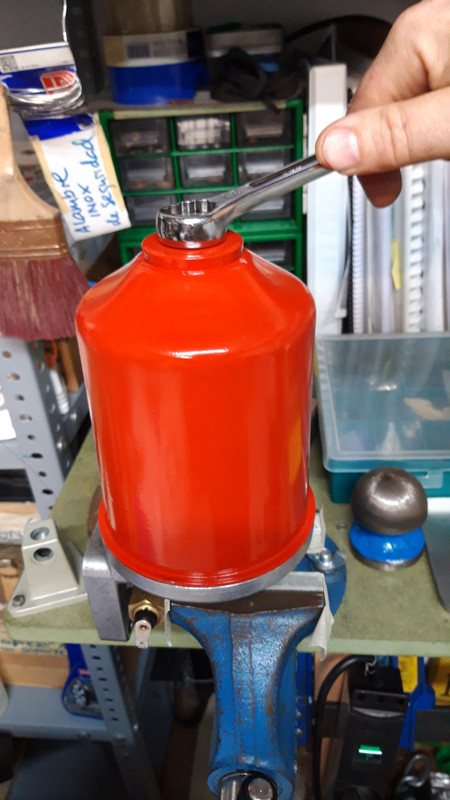

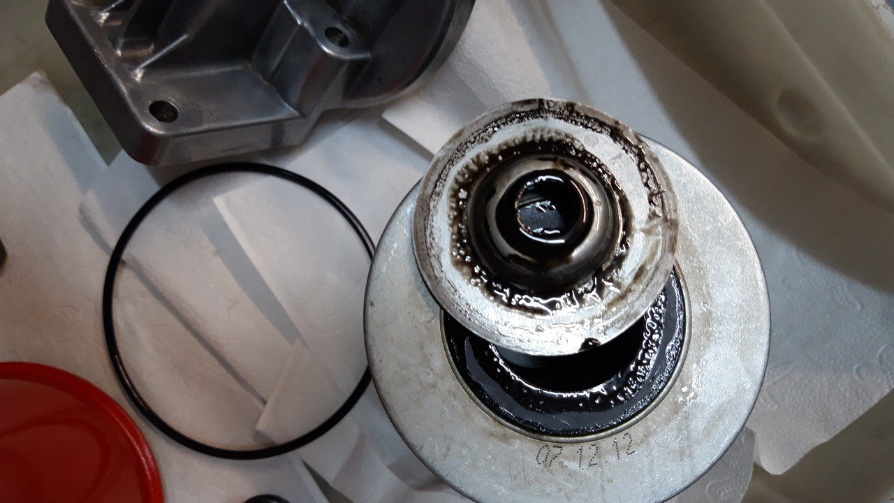

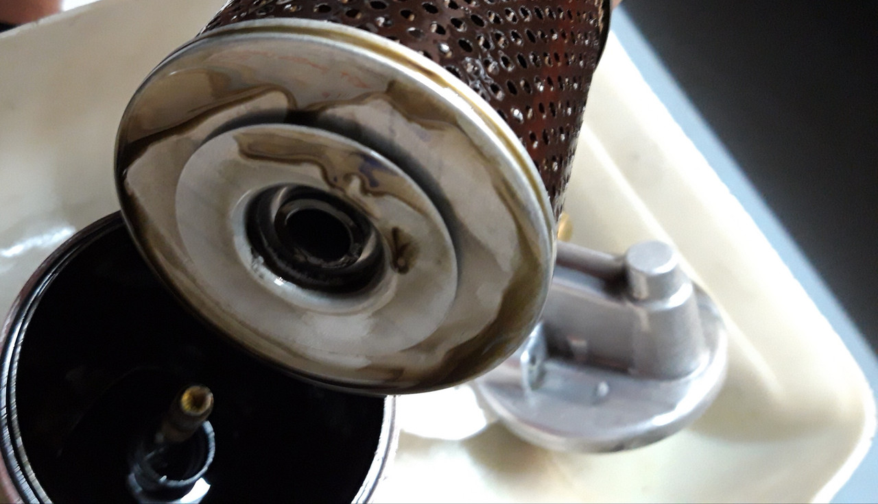

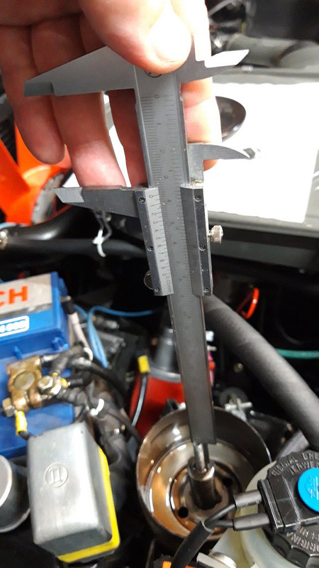

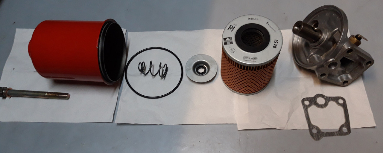

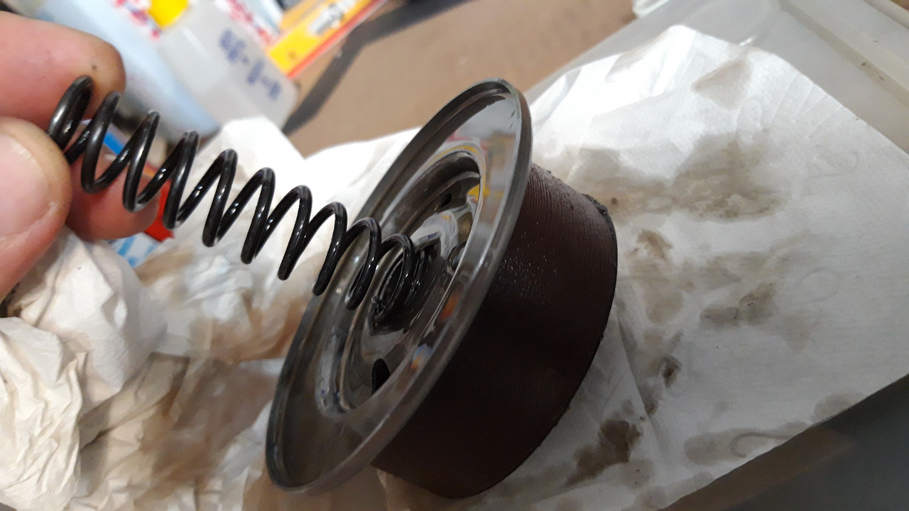

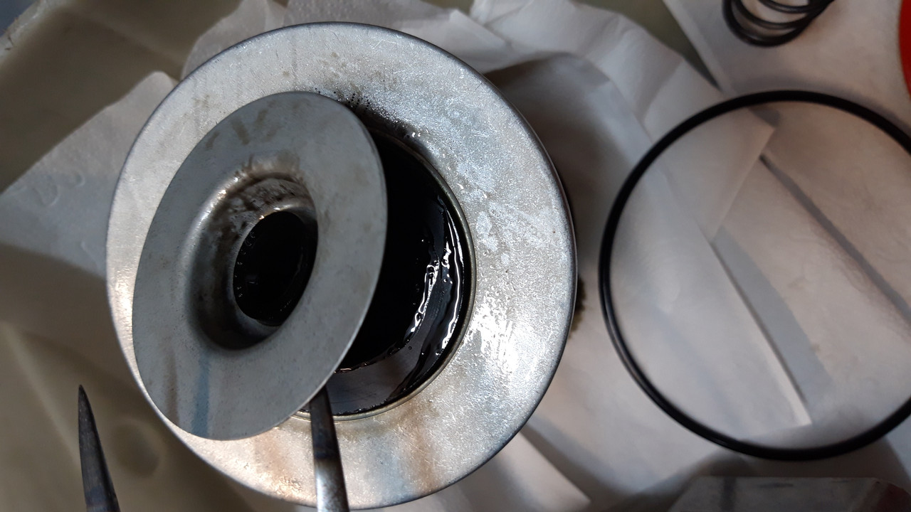

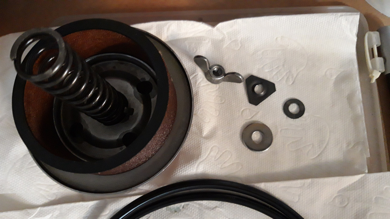

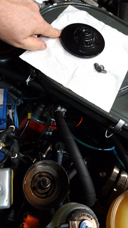

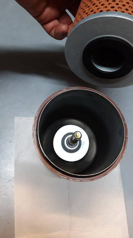

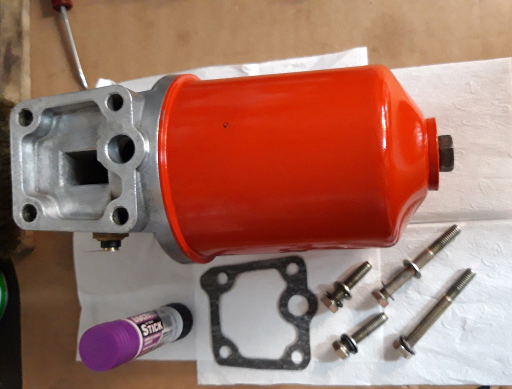

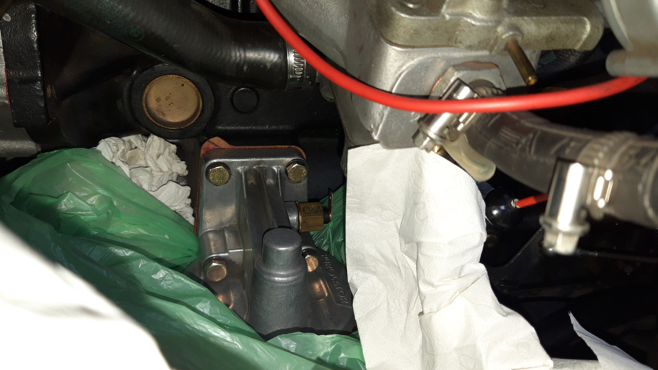

the engine oil filter thing,
well trying to explain a couple of things here,
1 first the process that i follow, i have the original factory setup, so bottom bolt,
i find the best way to remove the four bolts that secure the filter support, you can place a bag around the thing and pick the filter from the top, it works pretty well, it is dirty, as some drops will spill here and there , but uf you clean inmediately
2 the famous little plate responsible for adequately closing the circuit inside the filter, you will see that this plate always appears glued to the cartridge, so if you or your mechanic does not know about it he you will throw it away
