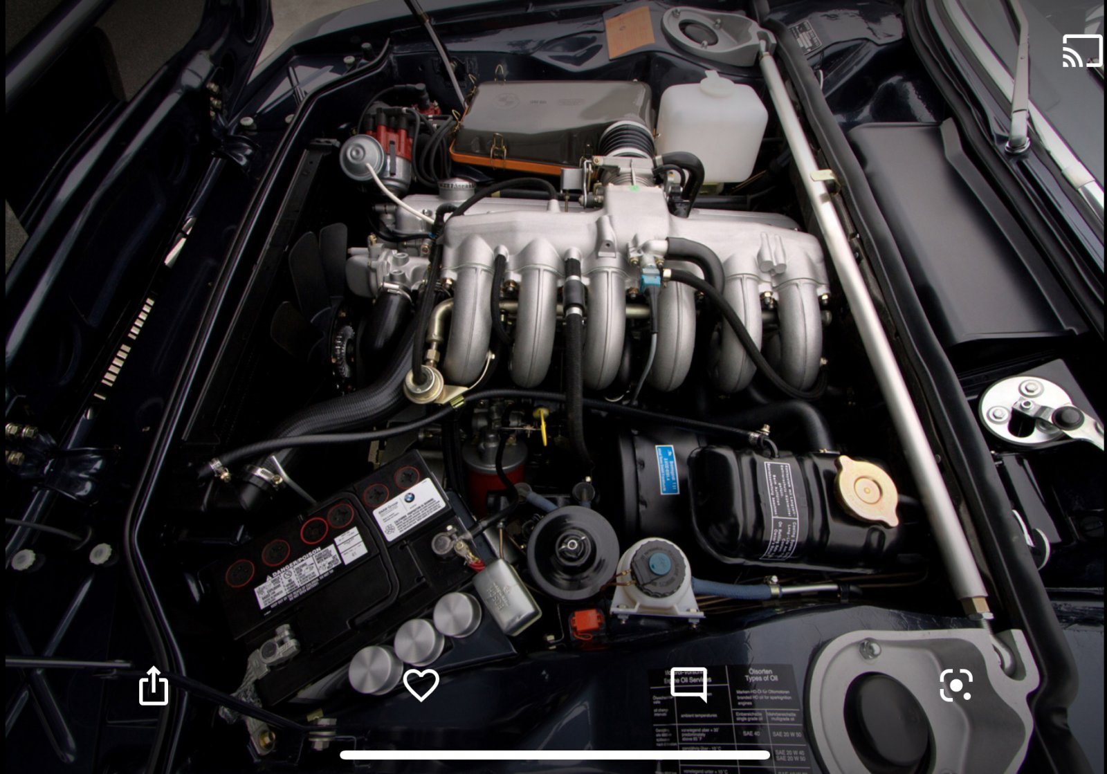

Also I spy my car in you pic too <:o)
Thanks for the reply and any recommendations on a shop that can do the job?
I have amassed quite of number of cars over the years so I'm going to have it done by somebody else since I have many many small projects on my current list of "to do's" with all my other vehicles.
You do! That’s my 3.3li in the lead at Laguna Seca on the 100 anniversary of BMW celebration. My car was being piloted by a Dutchman and his cohorts.
