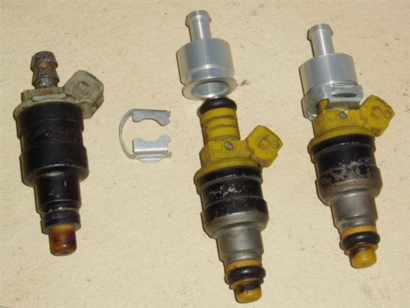

D4966EA0-42A6-4B23-A2AB-2D54E19112CC.jpeg E6CD061D-90A7-44A2-80DD-5BDFC7C44535.jpeg Fuel Injector Adaptors
AVAILABLE
Adapter kit to allow use of modern, high volume O-ring fuel injectors
on barbed Ljet and Motronic fuel delivery systems.
Hoses, fuel rails and mounting hardware do not need to be changed.
Update to modern EFI/EMS, minimize hardware and plumbing changes.
Minimize design effort, fabrication and expense.
Take out original injector. Install new high flow injector.
Put on adapters and clips.
Put hose and clamp back on.
Go fast.

As a heads up- most folks here just install new vanagon injectors and are done.
No adapters.
“0 280 150 206”

If i understand correctly, this is to fit the motronic injector to the fuel rail.
Is there an adapter to fit the injector to the aluminum piece?
sfdon
8,267
4,622
sfbay area
? No adapter needed for injector to manifold.
Just swap pintle cap, o-ring From early injector.
Buy new pintle cap and orings and top adapter from fuel injector corporation
Tracy California
