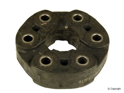

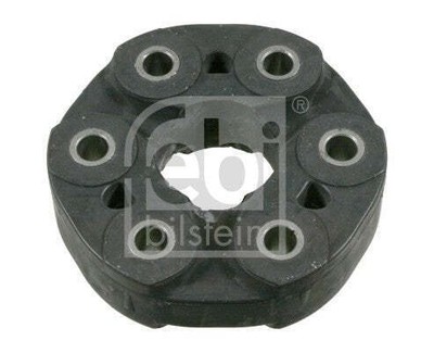

Looking up numbers I found a few,
26112226527 I want a good one ... Jurid? The best per past posts.
Help me out I don’t want to buy junk parts
This one says made in Germany, confirm from seller:
These have a pic of a German one, confirm with sellers:
