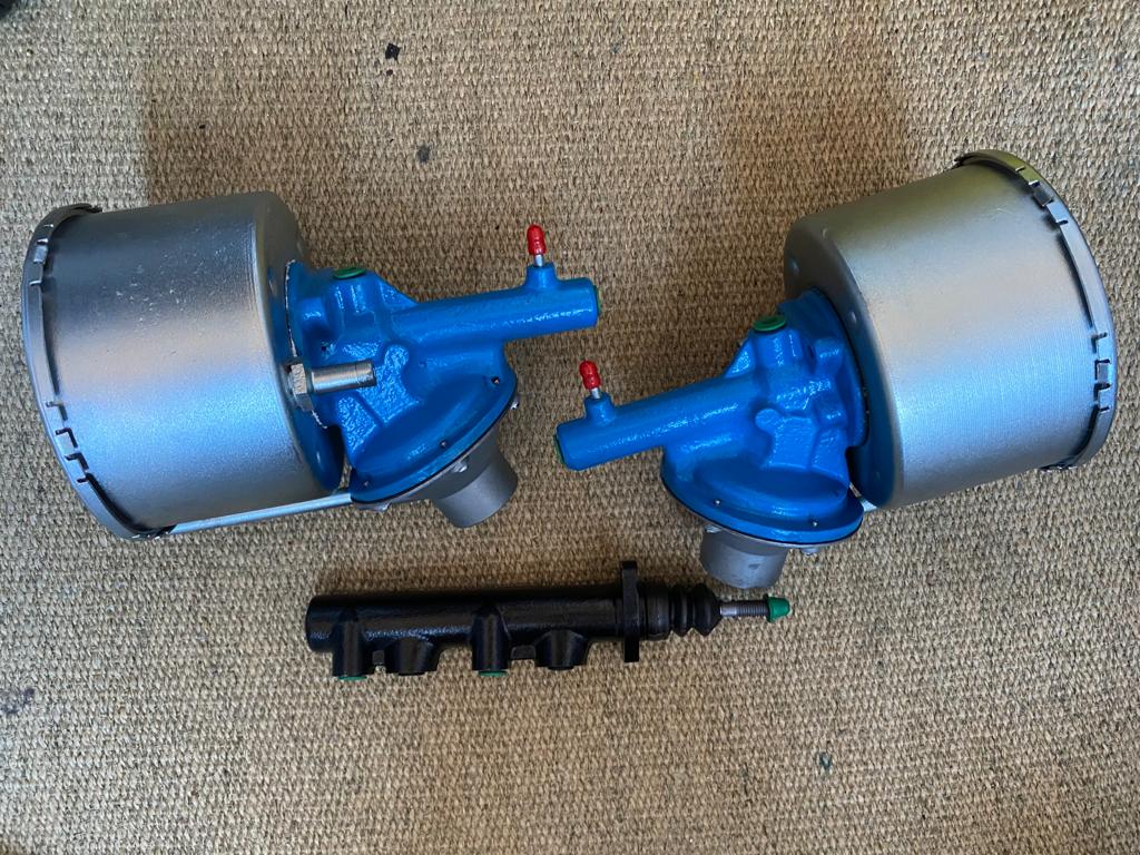

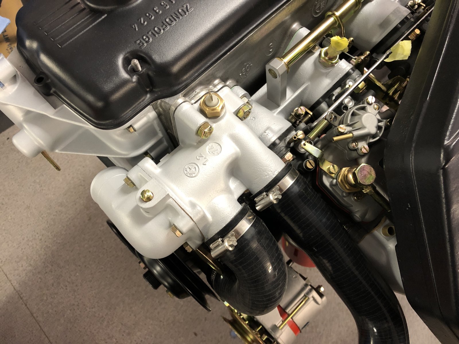

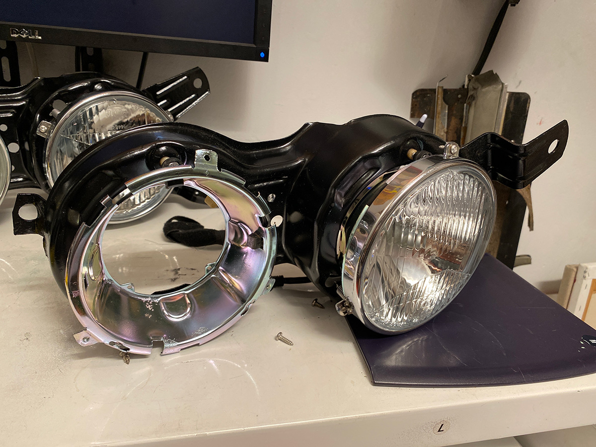

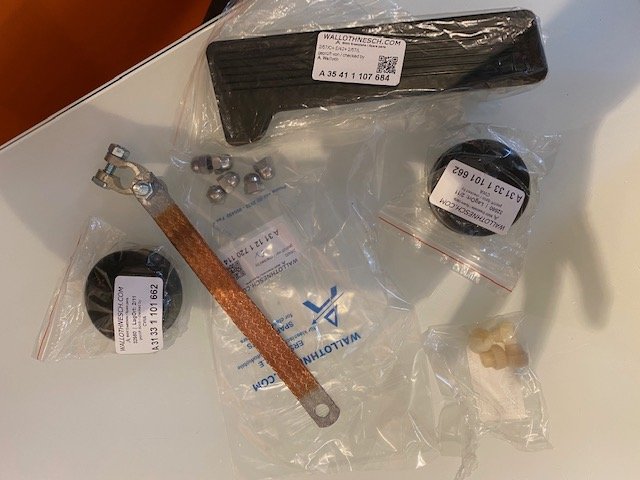

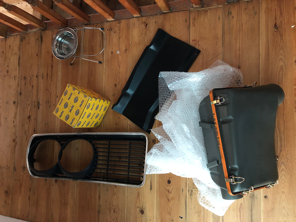

I haven't been great at taking pics recently, but here is a selection of recent refurbed and new bits - obviously not all of these jobs are quick and easy with the engine in place. Regarding the manifold and rocker cover etc, they have been blasted and I'll probably leave them bare as nature intended. That said, I do have a Cerakote guy in the UK I'm planning to use for my aluminium trim and I'll report back how that goes. I don't trust any clear coating not to craze or yellow over time on the engine, then you need to remove it.

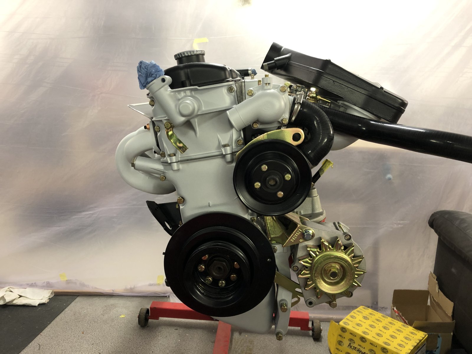

I struggled with this dilemma when I rebuilt my engine and decided on something a little different.
Originally I blasted everything and covered it with owatrol, but I wasn’t happy with the results. In the end I powder coated most of the aluminium pieces in a fine silver structure. The colour is not a perfect match to blasted aluminium but I’m really happy with the results and it should stay nice and bright for many years to come.

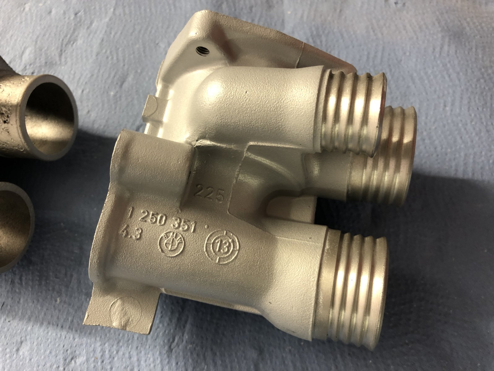

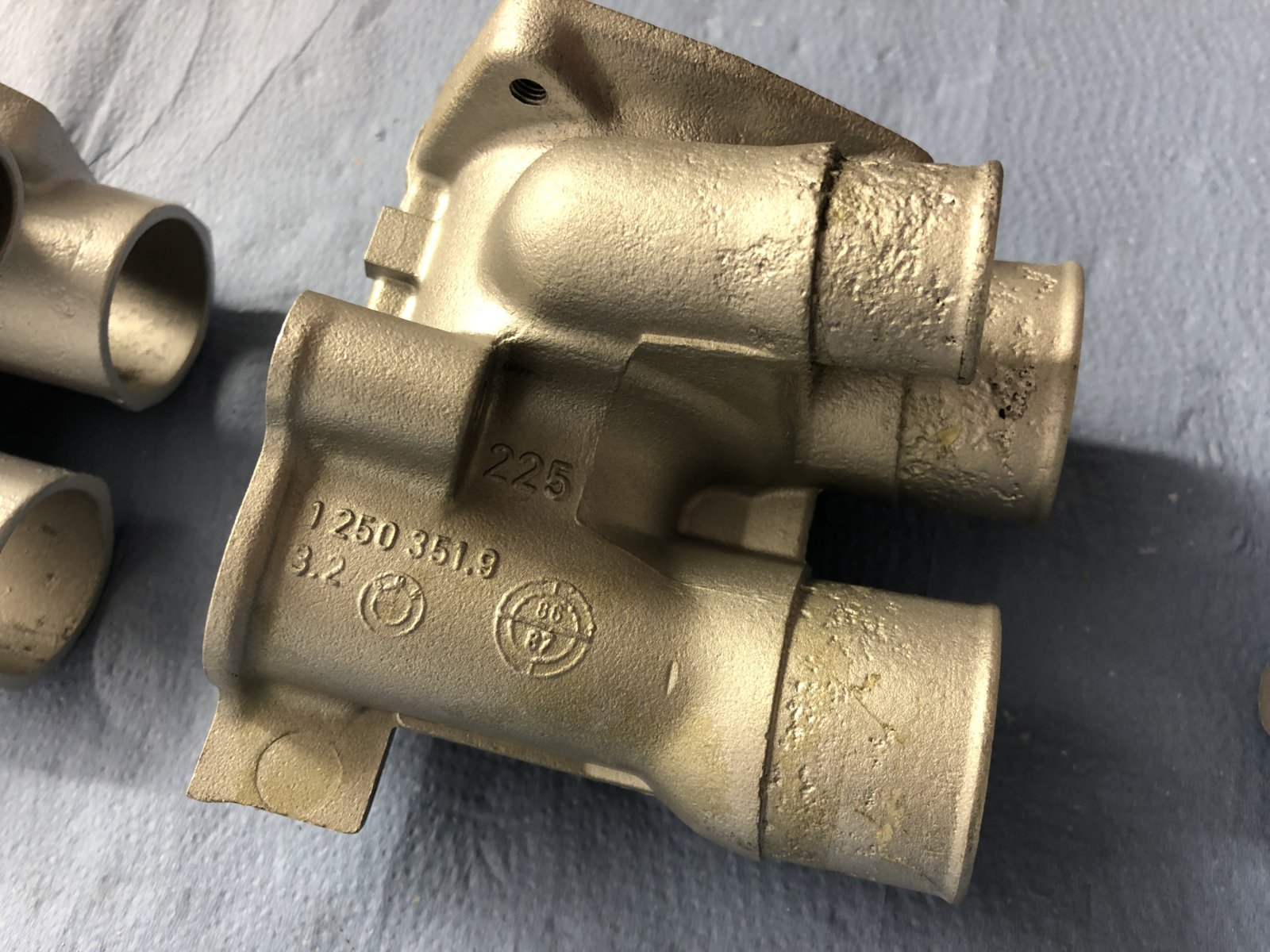

here are two thermostat housings,
First media blasted and rubbed down with Owatrol.
next is the powder coated silver structure. The hose fittings were masked off so you can see the colour difference
And here is the early model housing that I finally used:
Very nice, next time that you powder coat, you can get some compound from Eastwood to fill all those holes and corrosion before you powder coat It is made to deal with the 400-450 degrees required to cure the powder It is called Metallab I have used it a number of times, it even will plug pinholes in the aluminum It is like a paste and once it cures, you can sand it smooth and leaves you with a nice and stronger surface to apply the powder
Thanks, Rick
Thanks, Rick
Ah interesting. In any case that particular thermostat housings is of no use to me as it is the newer style and wouldn’t clear my carb’s
