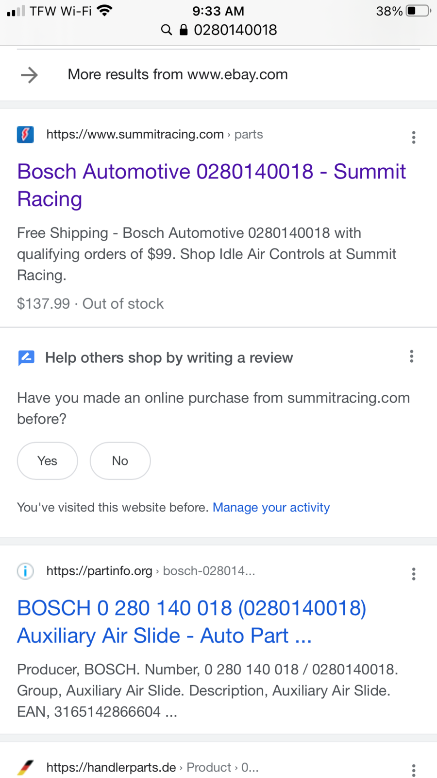

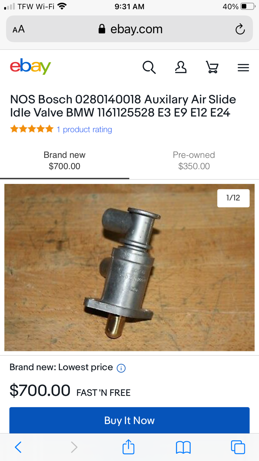

Maybe Econ 101 discussion time…
Used to be $137.99
Guess times have changed.
realoem lists that the part is NLA ... the ebay auction is missing the last number on the BMW part # ... 11611255284 which is NLA. there is a superseded part
11611263200, but on getbmwparts that shows up as NLA ... but Don's idea of searching the Bosch part # is better.
Yes, it doesn’t appear these are available except remanufactured, or NOS.

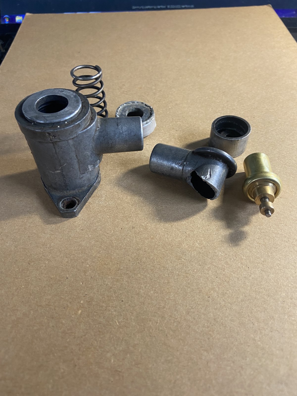

So I screwed up the separation of my valve by forcing too much torque through the housing without enough heat. The result is the photo you see attached. I need the top portion of the housing only, shown with the broken base. The new thermal switch I bought is shown in the picture. Simple design, too much time on my hands!

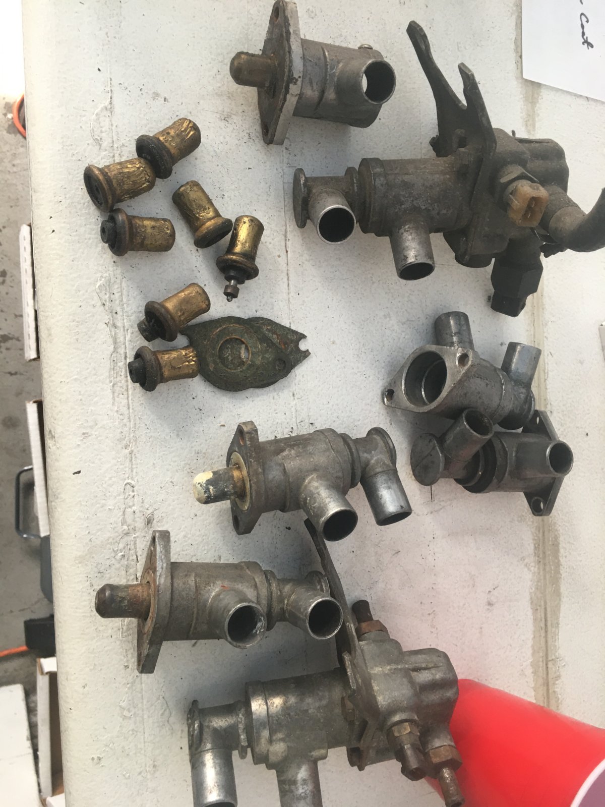

My shop has rebuilt these for Carl, CK and board members for years. We do require a good core. I will say again- if you try to do this job, I suggest 2 torches and eye protection. Also- besides the SI 596 RD sealant you need another sealant that is not available in some states in the US (including mine). Ebay Australia can help with that.

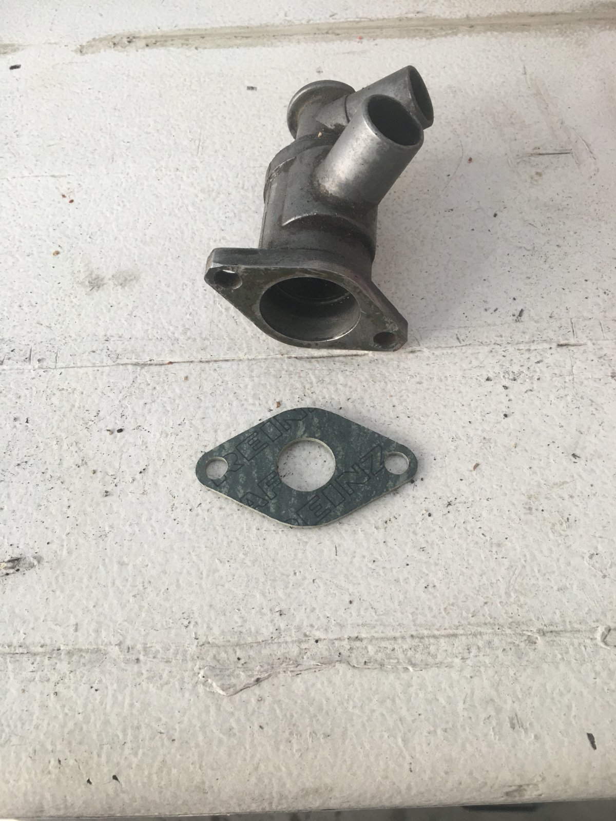

Be careful they can be bad when they come apart…. And don’t forget the gasket!
