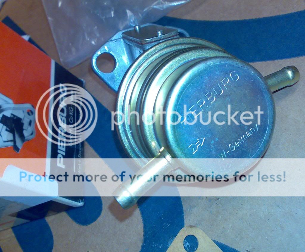

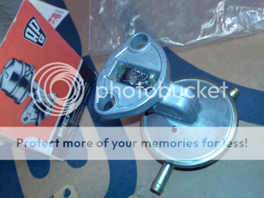

bear in mind this if you need to order for a new pierburg mechanical pump:
if you order the adequate part number for this pump, you will find a pierburd pump offered in several places,...e-bay, jaimic, bmw,...
it will be in some cases the old-style rubber membrane fuel pump by pierburg,

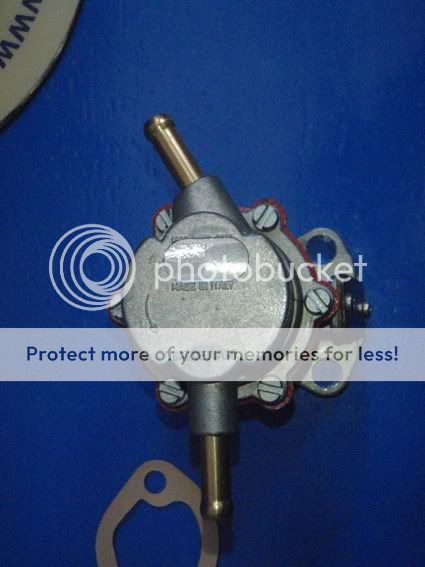

be aware that what you will get, will NOT be a pierburg pump, read this and tell me your opinion:
you will receive a pierburg box, closed with a pierburg seal, and inside:......a pump: "made in italy", and with the brand name machined out:
i am not telling you that the pump is not good, BUT...THIS IS NOT A PIERBURG !
what do you think ?

Make note, the pump in your picture has had the manufacturer's name milled off. The makers of parts for European cars often sell the same item in the aftermarket as what goes to the dealer. They'll use an end mill to grind off logo's, i.e BMW, VW, Mercedes.
Most of the new pumps I've seen have a stamped steel top rather than cast as in your picture, NOS maybe?

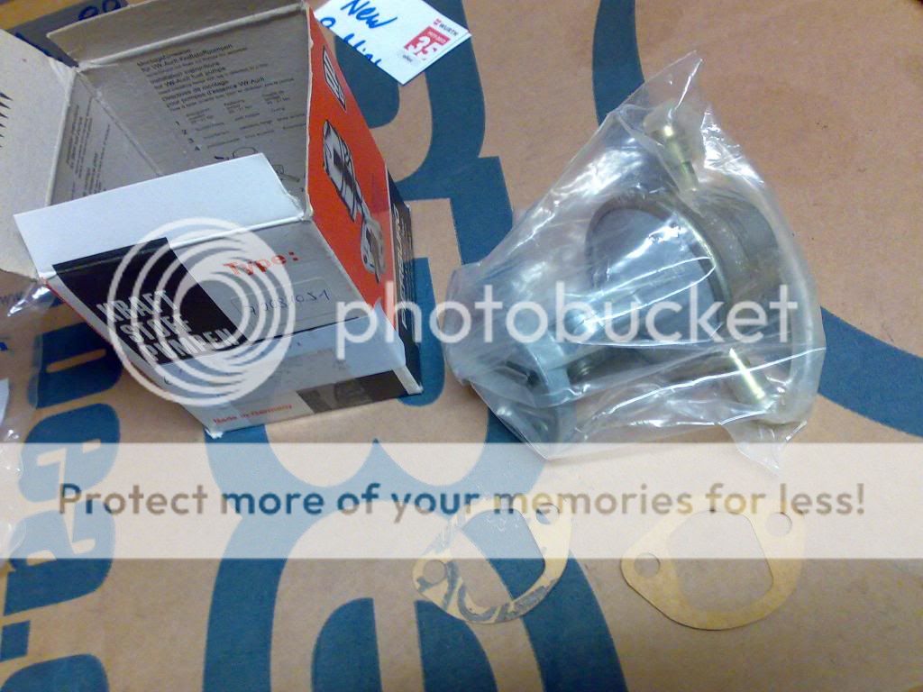

yes, i throw it away in my shelf, and bought a original NOS real PIERBURG mechanical pump. i have a source for that, a friend in germany gets such goddies for me
if you interested i can ask him for another one

new old stock, in the original box, i installed one and bought another one for the future
dont know if more available
i can check

Well I called the seller on my pump and they called theri distributor. As DougE said, they claimed they mill the name off because it says BMW or VW etc. They stand by it being a real Pierburg and the seller gave me a 2 year backing on it so I will stick with it for now.
What still baffles me is my old pump. I took it out, manually pushed the rear plunger (on the pump, not the one on the car) and hooked it to 2 containers with some gas. The thing worked fine, pulling from one and depositing into the other. Yet no go when on the car. Can the rear plunger be so hard to push that it won't pump on the car? I ask cause a) it was a lot harder to pump than the new one I bought and b) the back of the pump in the pictuer above has grease all around the plunger.
deQuincey
Quousque tandem...?
8,455
2,471
that is NOT true !, they mill it off because it says the italian brand that made them, i dont remember now, but a forum member here placed some pics a long time ago of the original italian brand, thus IT IS NOT A PIERBURG ! :p
i cut open my old broken pump, you have two different compartments the outside is the plunger and spring and rod, the inner is a sealed body with two metallic membranes, in my first pump i found the plunger to be in very bad condition because the yellow bushing was destroyed, i will try to post a link to an old thread in which i tried to solve it...
