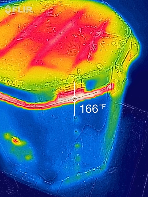

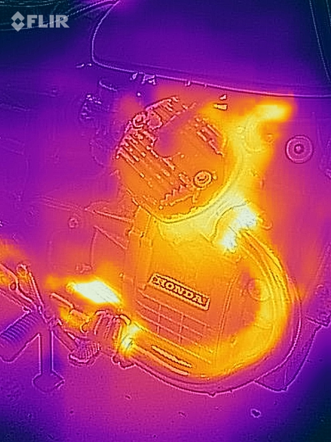

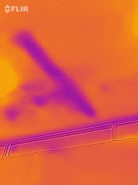

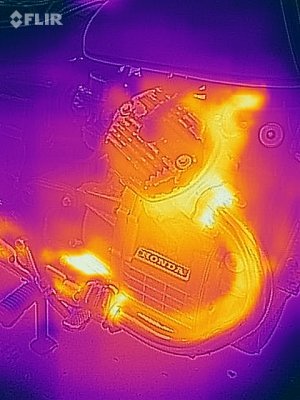

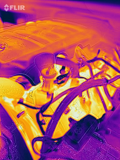

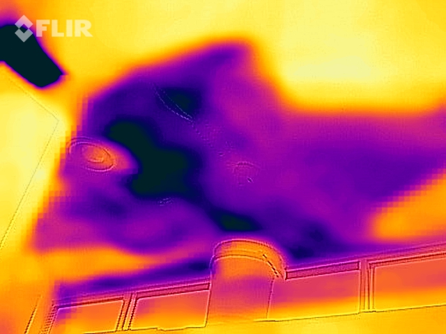

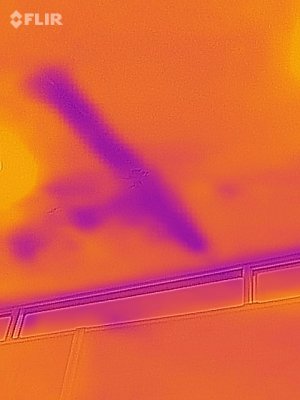

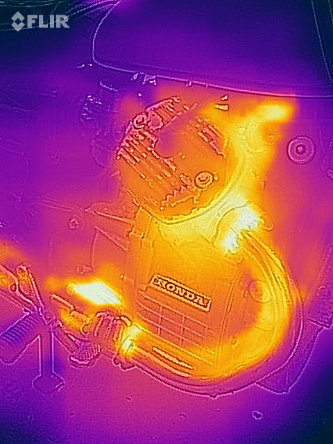

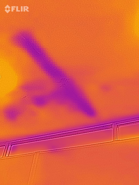

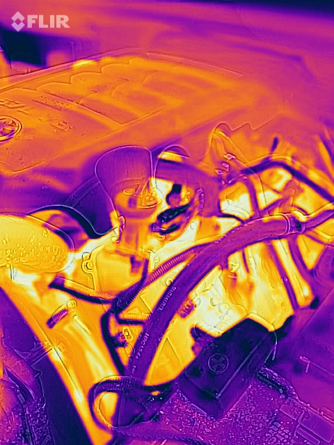

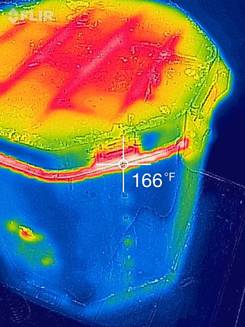

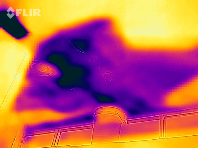

There's nothing wrong with a laser thermometer but I've upgraded to a FLIR IR camera attachment for my iPhone and found you get a lot more information faster.
Mine is entry level so doesn't provide real high resolution and the price has gone up to $230 since I bought mine but the cost of a lightly used one on ebay is around $150. It can give you spot temperature readings as well as show the pattern of heating or cooling at a glance. It's been useful around the house as well for finding water leaks in walls or around doors.

Picture of a radiator please?
I use a Seek Thermal small iPhone camera. Cost is reduced from traditional Flir as they don't have an optical image but only the thermal image but it is more than sufficient. Thermal point and shoot guns can be significantly off.
