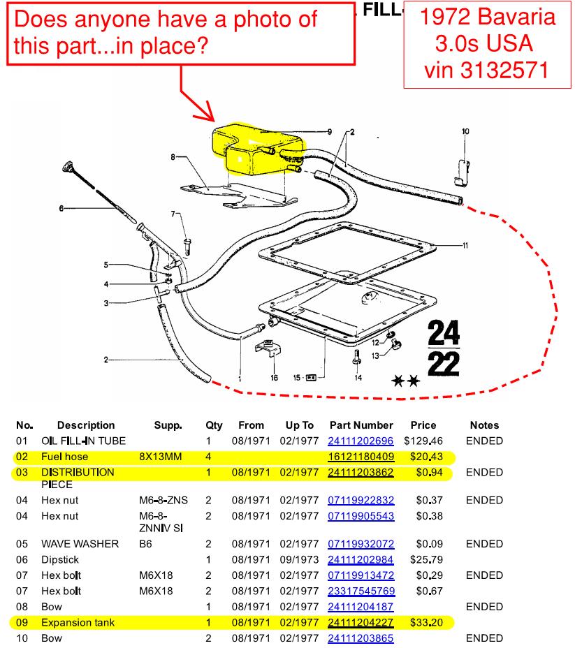

Can't find my "expansion tank" shown on the attached Realoem diagram? I found a hose and tee in my engine bay that were not connected...and I want to restore that connection before any real damage is done...but so far I can't find a spare #2 hose...or t he actual #9 exp. tank...Does anyone ouyt there with an Auto-trans have a photo of that expansion tank installed? SFDon very helpfully described it as "a Small kidney shaped item at firewall on exhaust side"...but I see no traces of it in that location on my car...and the hose-routing for the dipstick overflow tube (#2) is also kind of mysterious. Any clues will be much appreciated.

You know you need one if keep getting atf fluid running straight down to your exhaust.

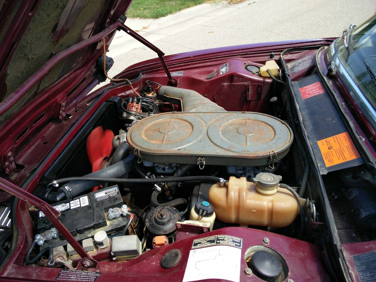

Here ya go. Mounted on the passenger side strut tower.
I agree with Chris. I've converted a 74 e9 & a 74 e3 from auto to manual. They both had the "tank" mounted there. I think they were on cars with Borg Warner automatics. The 72 e9 I owned 20 years ago had a ZF auto and no "tank"

My 72 has a BW65 (Borg Warner )...and the part #3 distribution tee...and a hose disappearing under the car near the bell housing. Plus it comes up in realoem with August 72 search parameters ...so I kind of think it was there and someone discarded it ...All that said; I'm still not convinced it has a
lot of critical function besides preventing overfills from dripping all over my garage floor.
