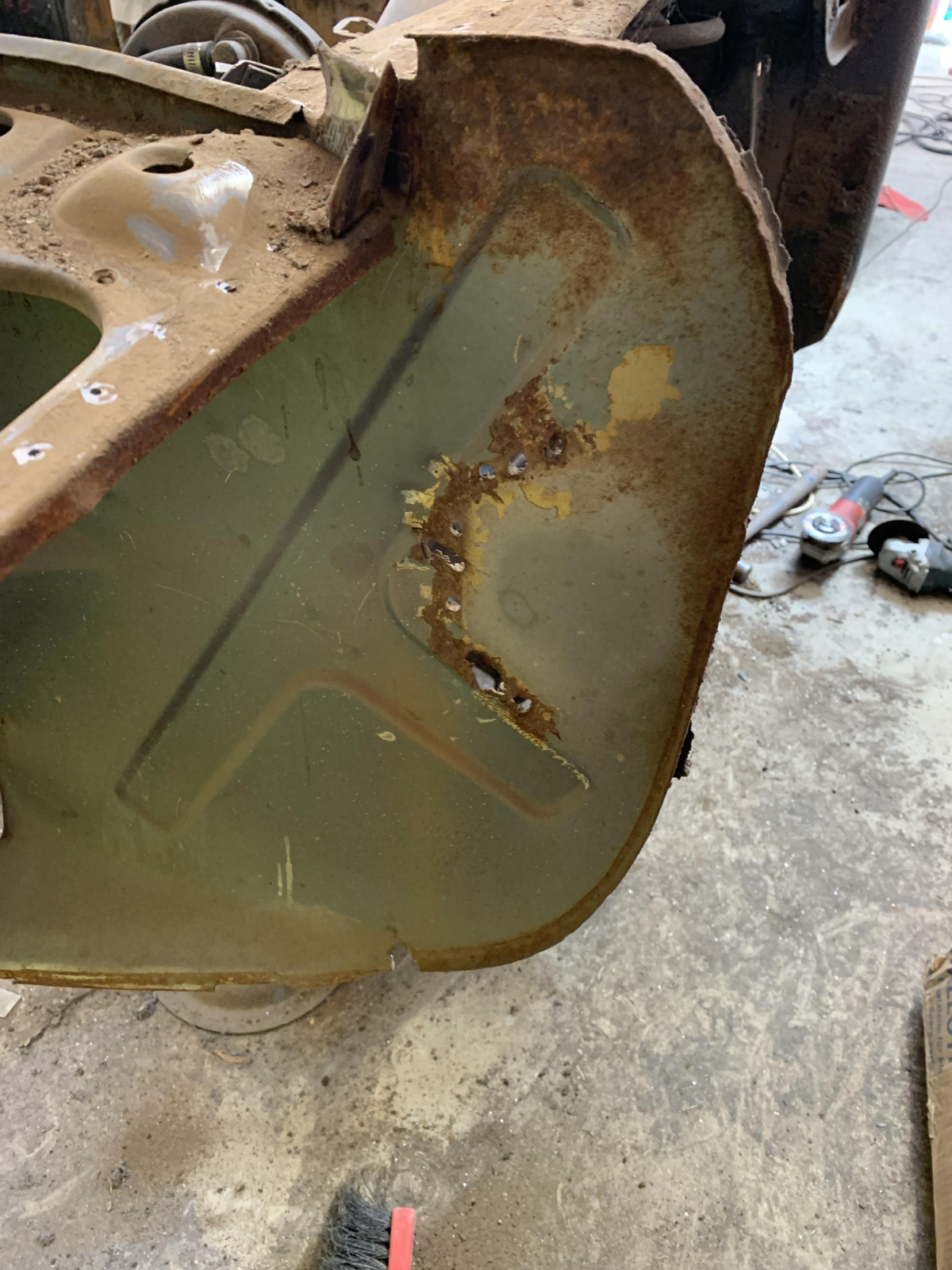

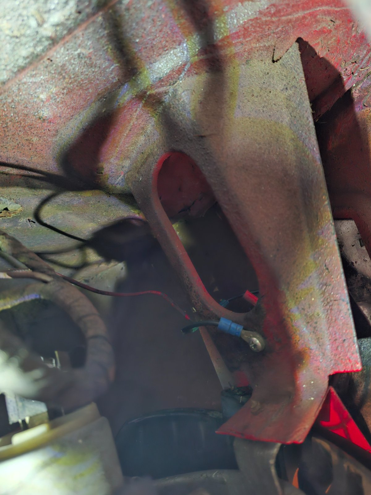

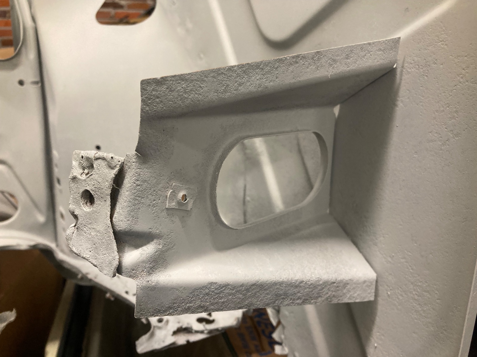

An Aussie friend wants to know what body section is missing from here? Seems something has been removed from both sides for the car. Had a look on W&N and nothing jumping out and wanting to avoid pulling my car apart..
Next question where can the missing parts be sourced?

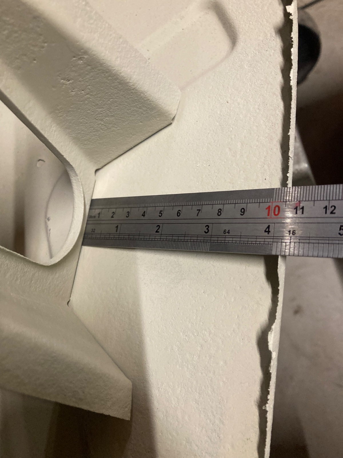

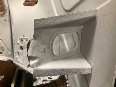

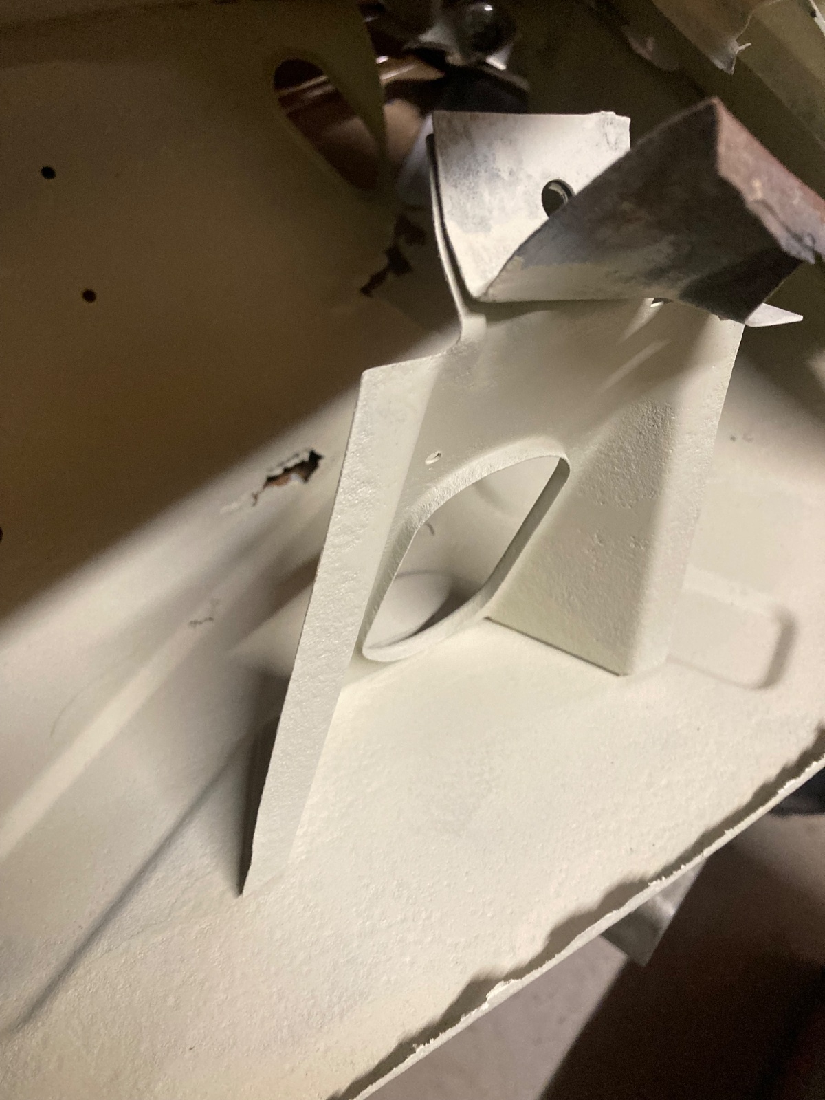

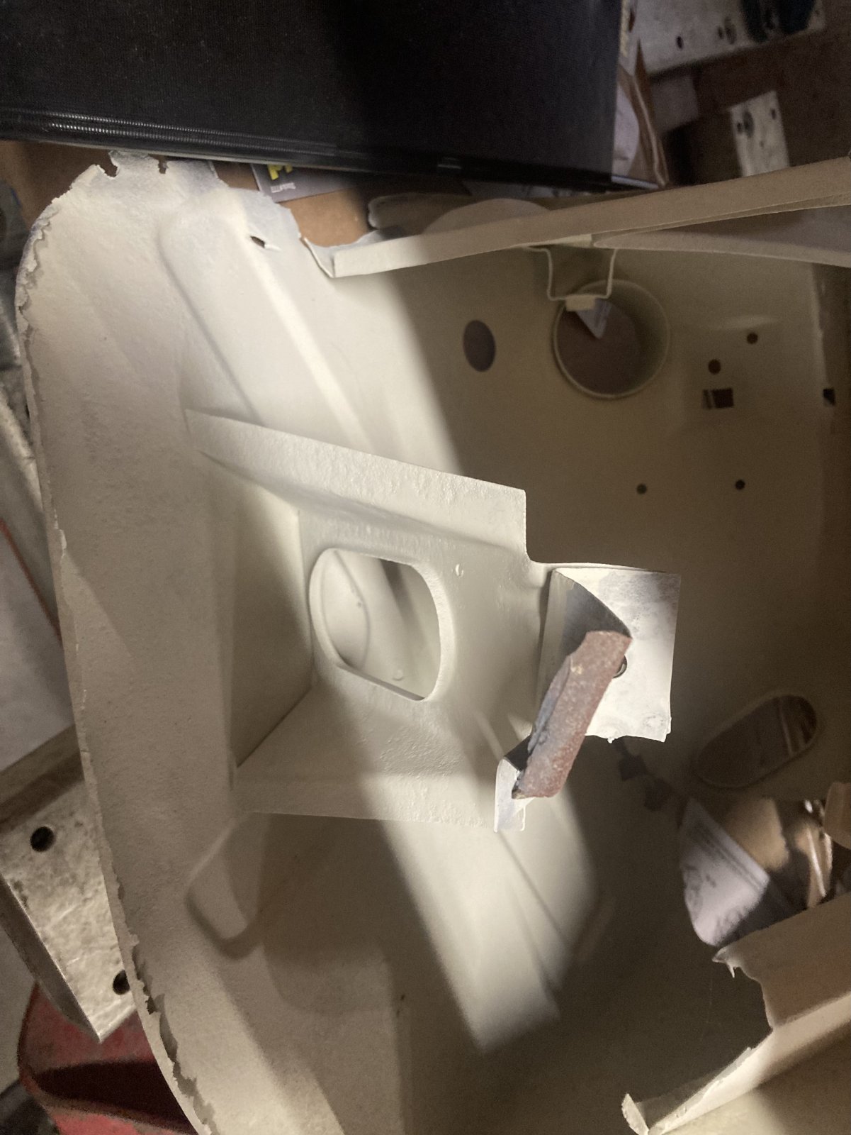

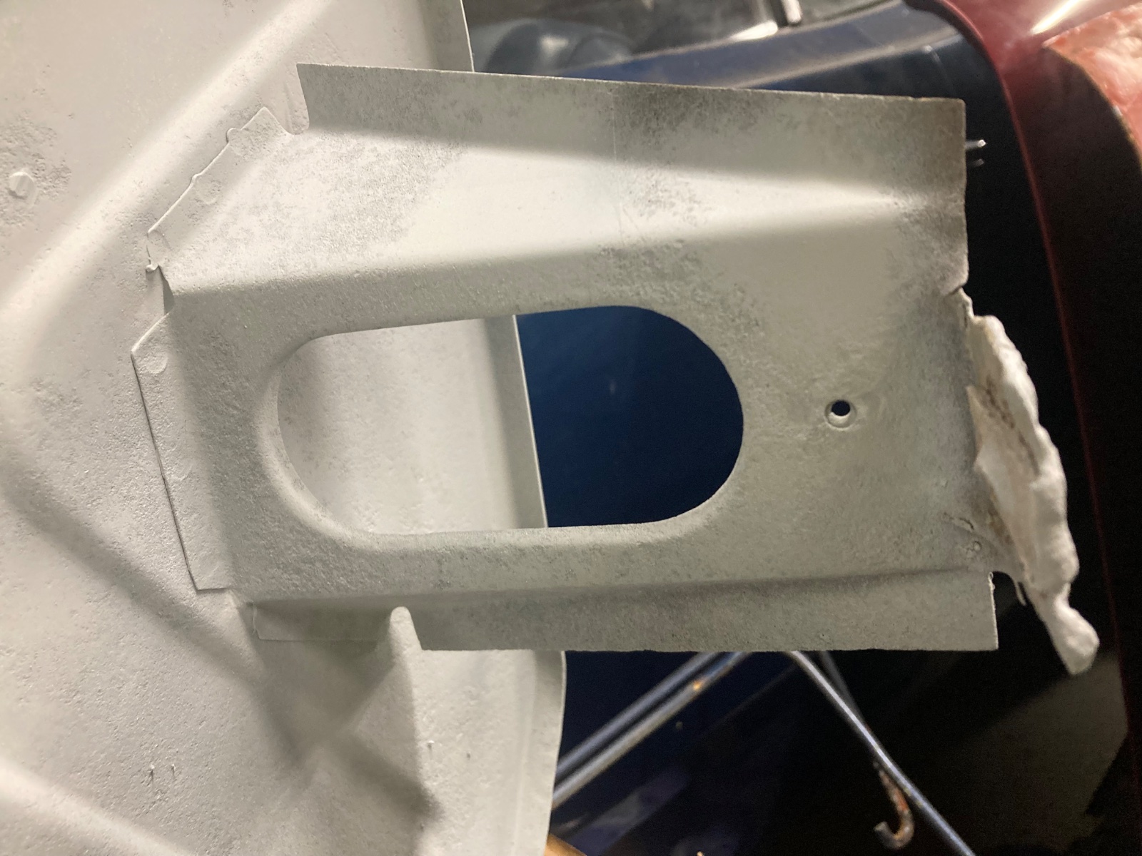

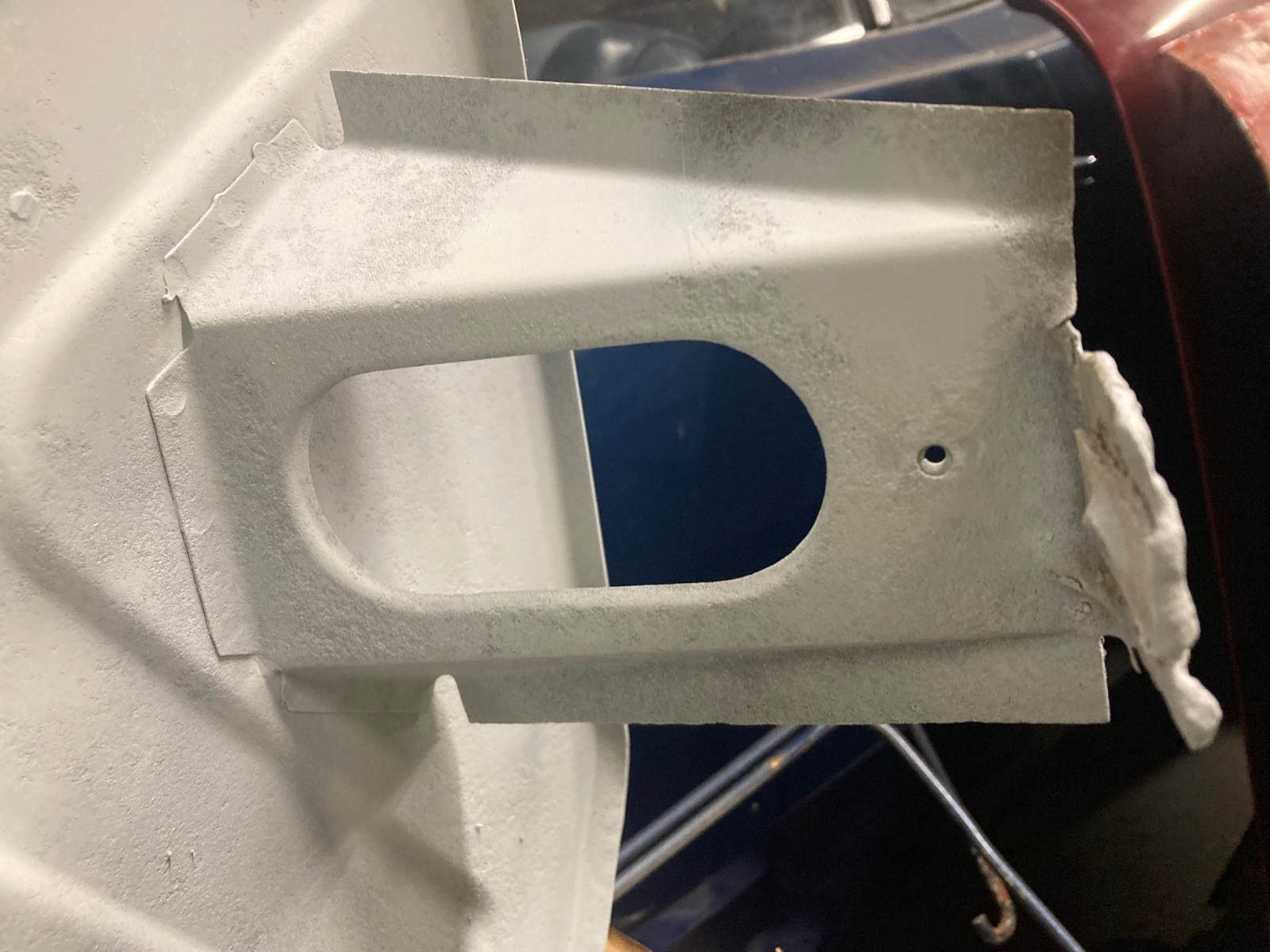

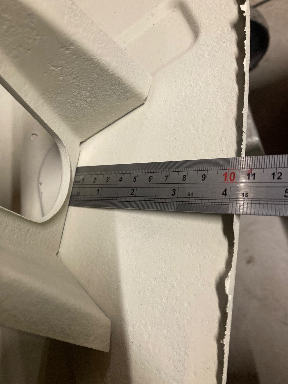

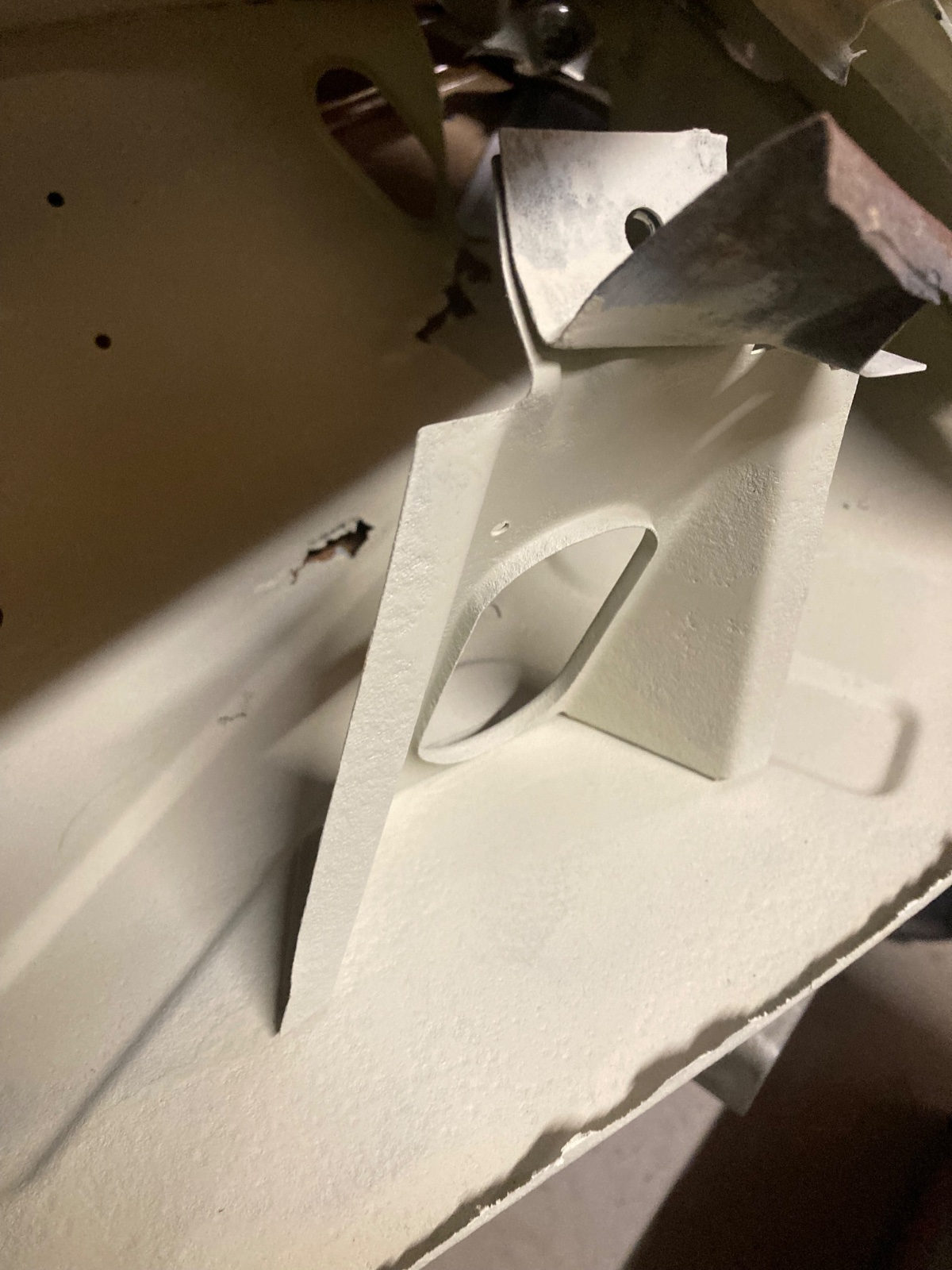

Hello Wes, in attachment a result drawing I made for you. And some detailed pictures so your friend could make them.
The big hole in the middle has also a few millimetres edges. See pictures
(I didn’t tried it).
(On the wheel side there are some other brackets)
