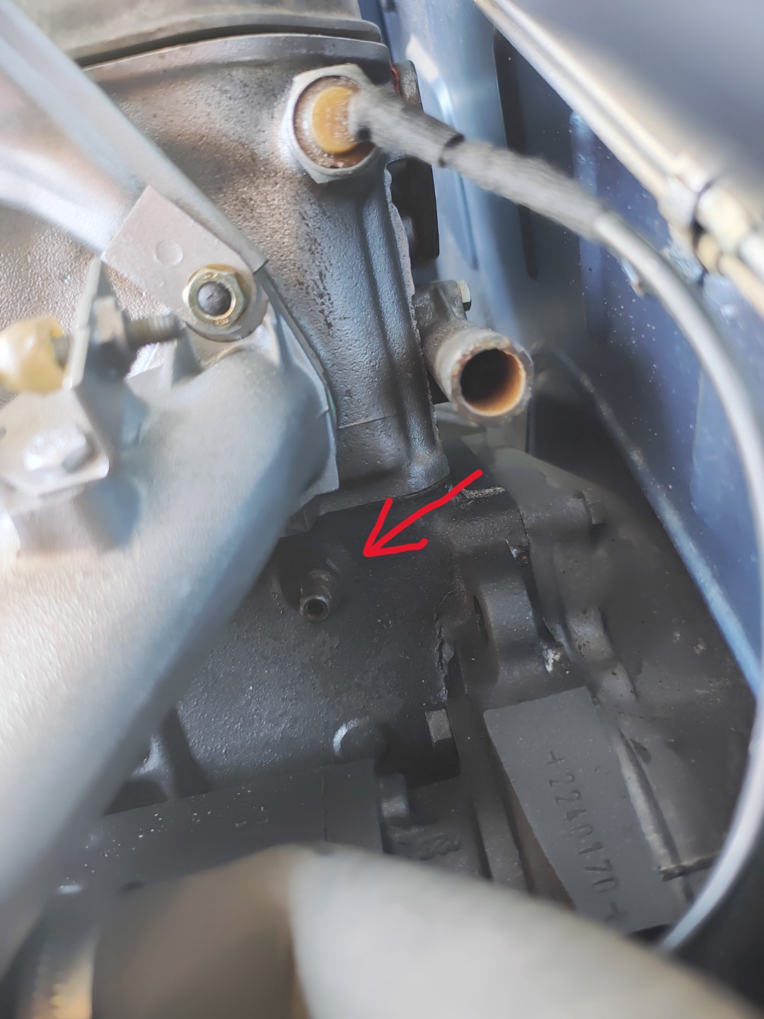

Hi there, I started to reassemble my 72' CS and I forgot to take a photo about one part of the engine. There is a hole under the last intake (photo). I don't know where to connect it. Please help. Thanx!

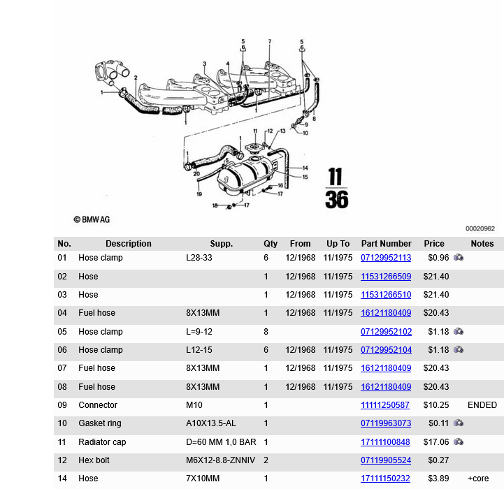

As I recall that insidious and inaccessible little tube is part of the cooling system. It feeds a tube that usually goes to the throttle body on CSi cars, and probably to the carbs or the intake manifold on CS cars.
