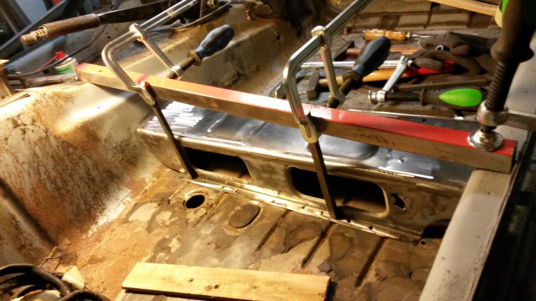

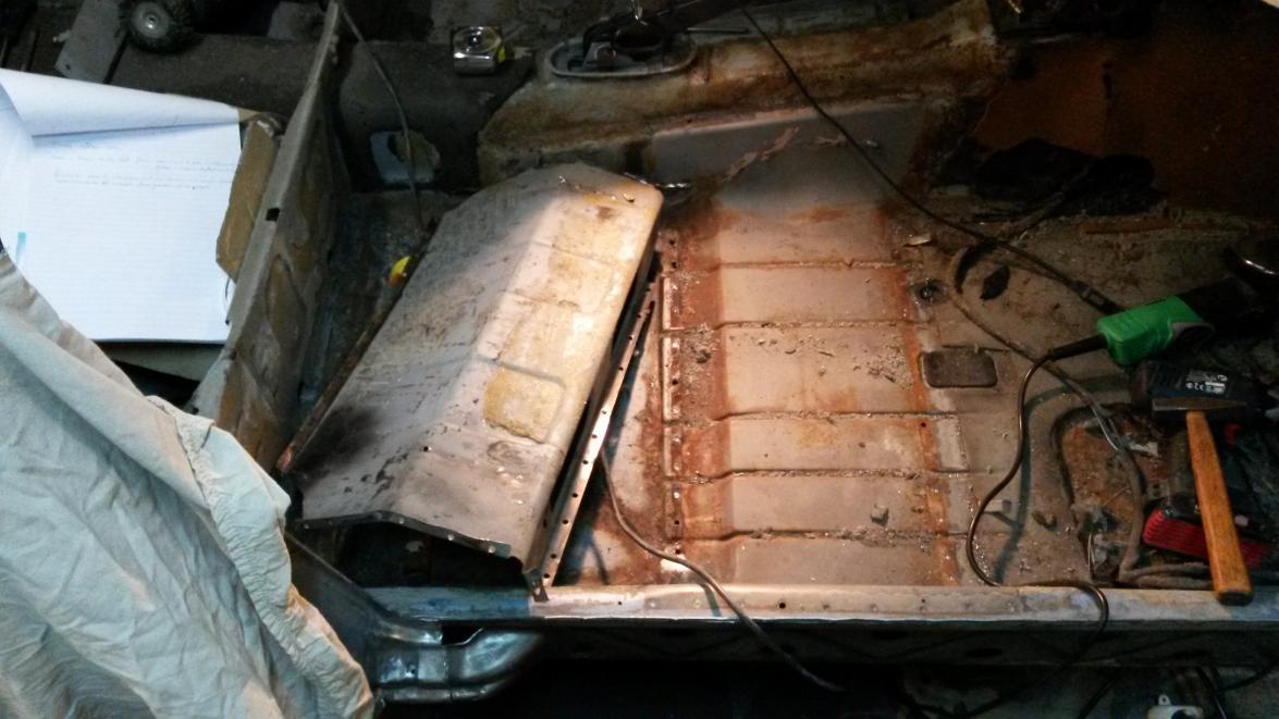

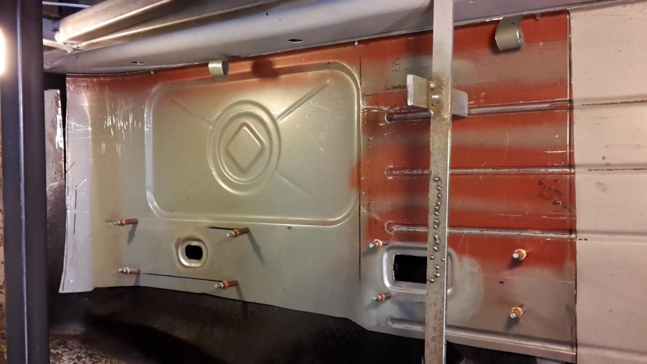

pic of opening; Left and right front floor
In this pic you see a new but exact copied right front floor.
There are actually 2 openings, one rectangular close to the seat base, and one oval shaped towards the firewall. Both are plugged with a plastic cap.
The metal bar passing in front is there to exactly relocate the seat base once the floor is done.
Second pic shows the location of the square hole, here still covered with the original black plastic cap.
3rd pic shows the left front floor. (in my 73 CS Euro model, Swiss delivered). On this side there is no square hole, but an oval one.
Perfect! Thank you very much for this info.
Those are great pics. The second pic is the one I would use. If you are just outside the passenger door on the floor looking in front of the seat, that is exactly what the opening looks like.

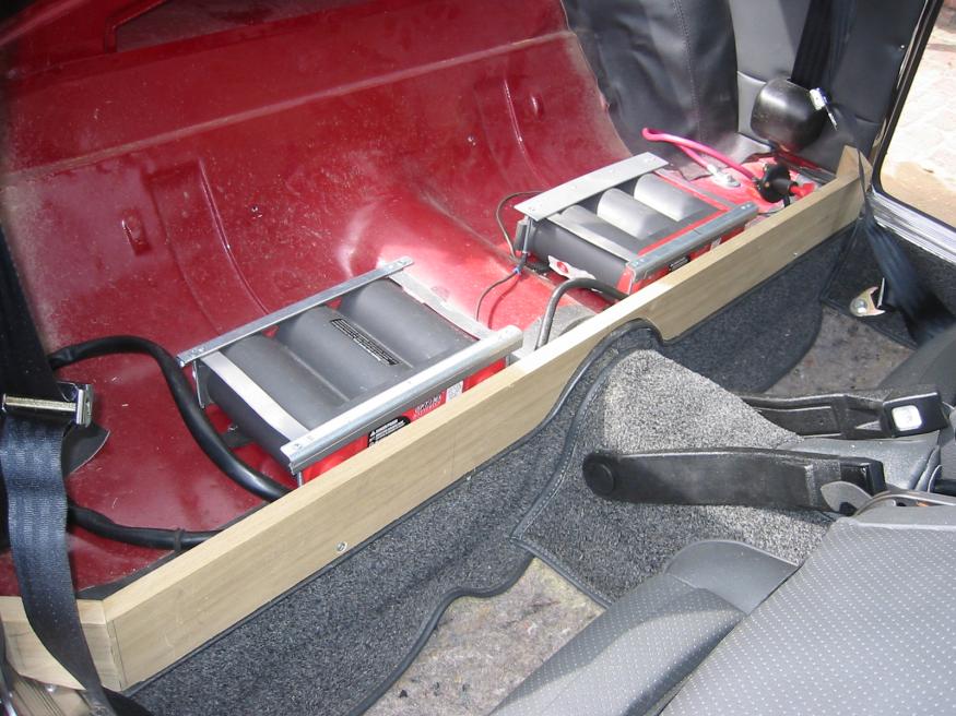

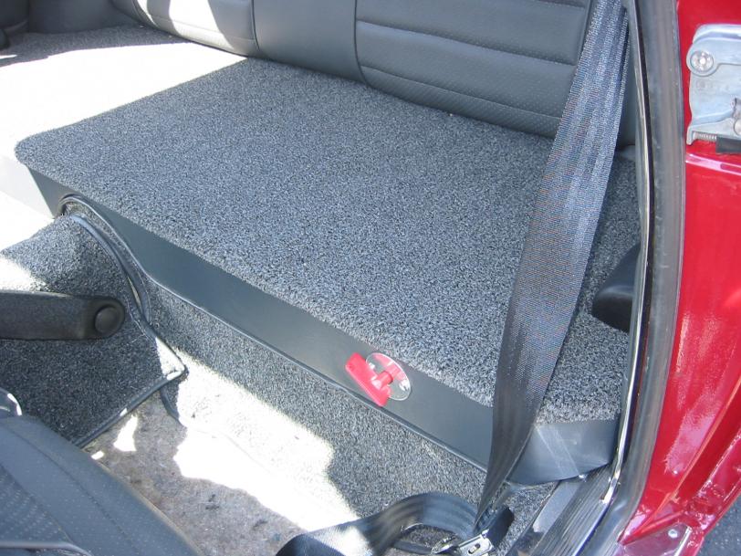

I have two Odyssey PC680's in parallel under the right rear seat. Built a metal tray and welded it to the floor. A strap holds the batteries in place (not shown in pics). I had to cut one small corner(±8 mm) of the floor at rear right corner to fit the tray so that the rear seat cleared the top of the batteries without modifying the fiberglass seat base. Also, for some reason, the shape of the floor is not the same on the left and right. There is more clearance on the right side.
