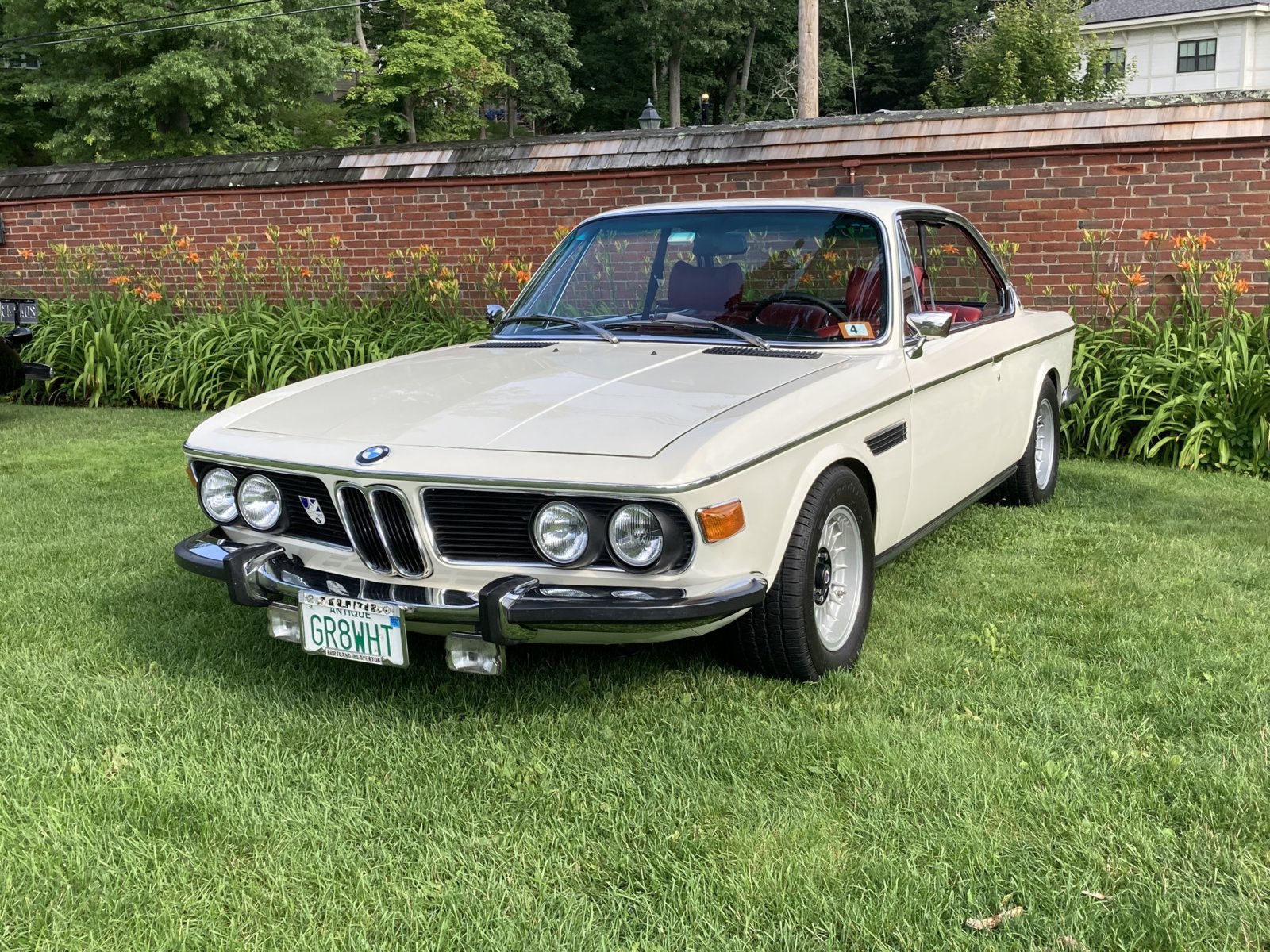

I had Speedway do mine, they polish and coat with clear Cerakote
Looks great
