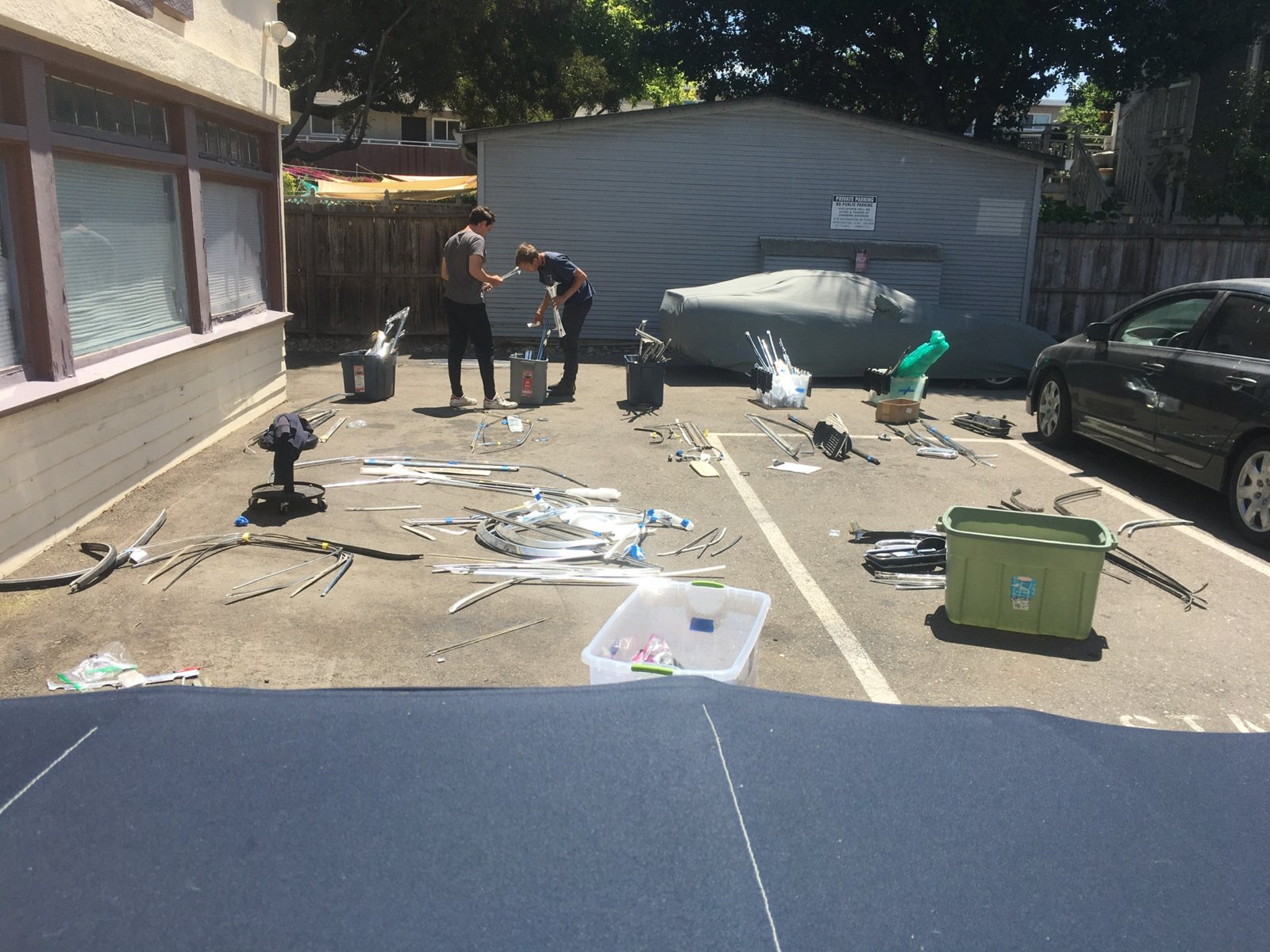

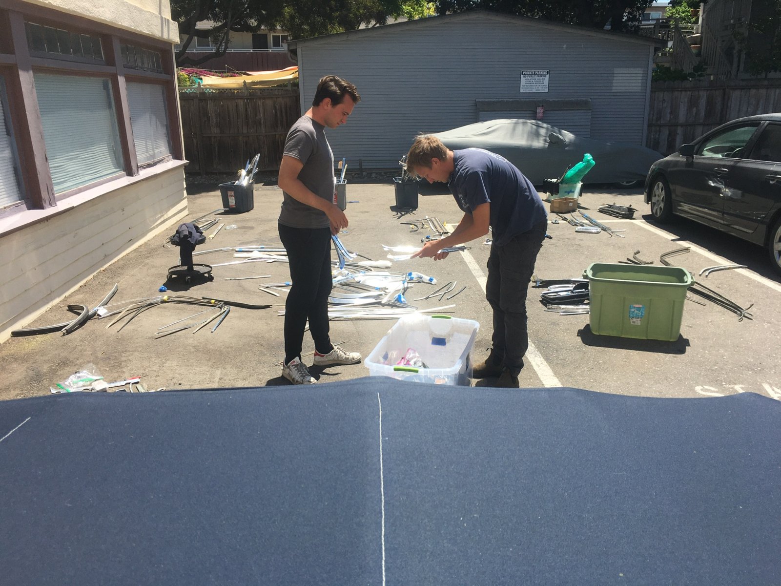

We are currently doing about 10 cars of trim with a crew - no chromatic anodizing. Polish has been best for us.
