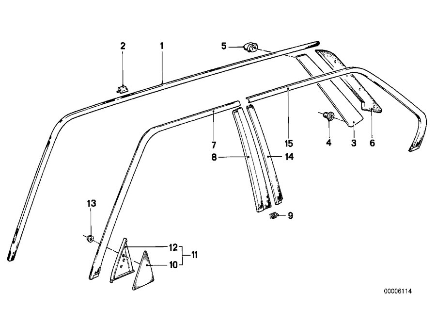

I recently put that rain gutter trim on an e30. On the e30 bmw uses little clamps pictured below.
I haven't had the trim off my coupe so dunno if that part would work in this case. I can assure you they hold the e30 trim on.
Check the pic and the part number is 51131863499. If you google that number you will see some variations.
It may be a simple to make the appropriate sized once you get the principle.
Part number 2 below.
