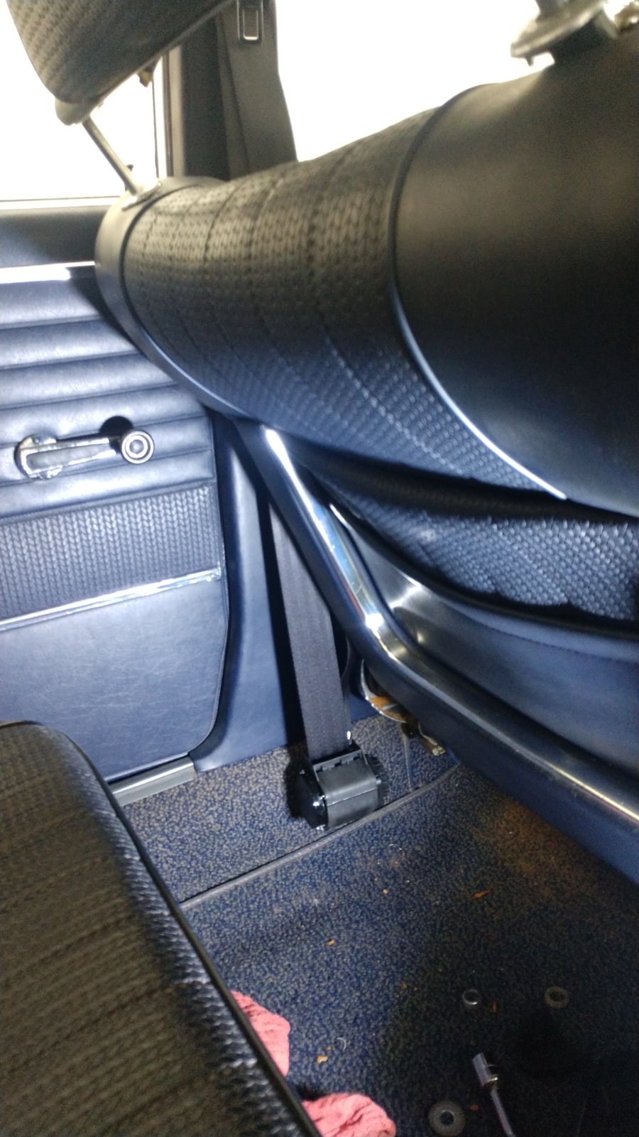

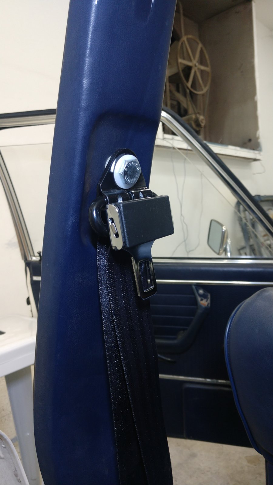

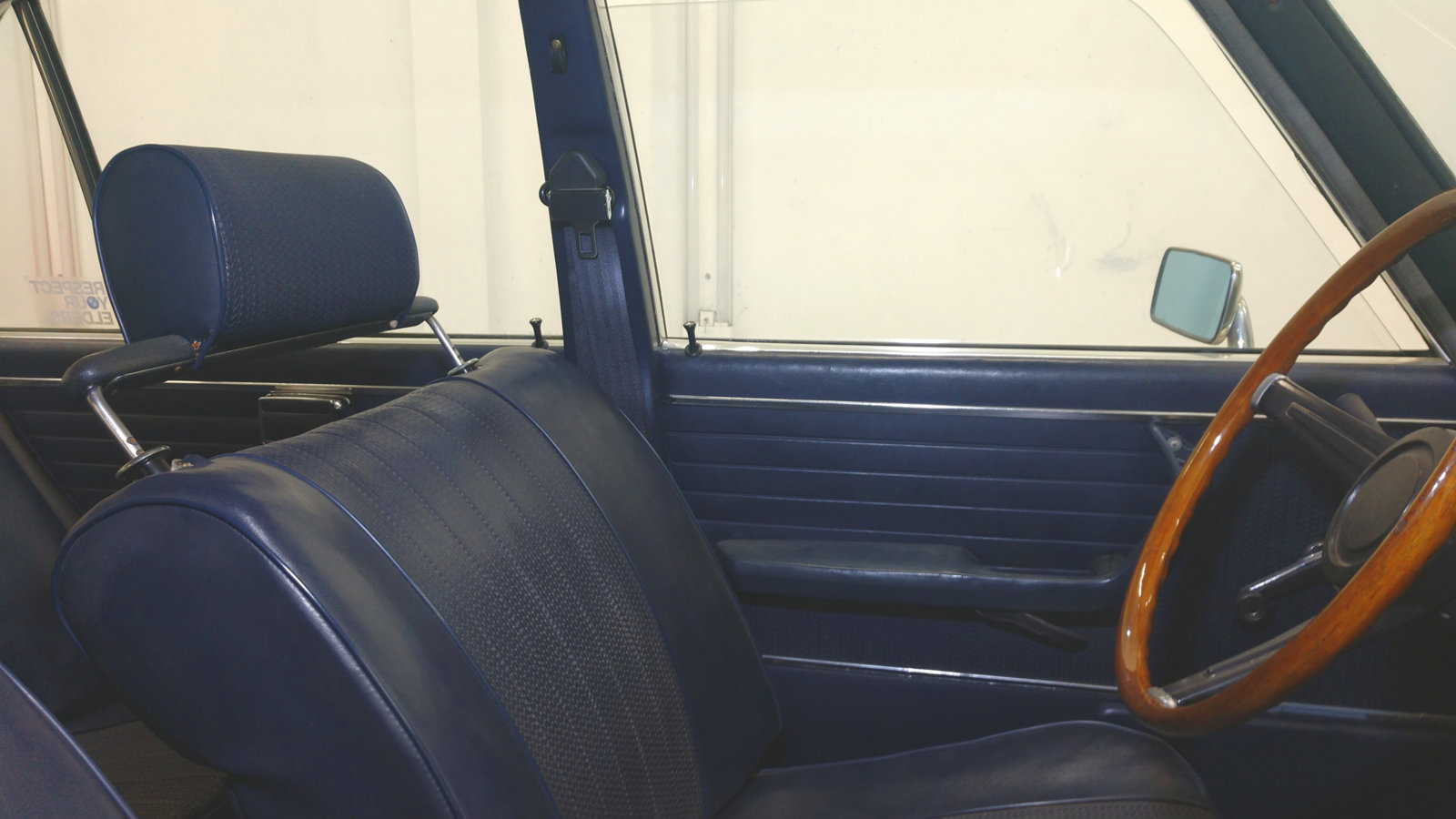

I bought these aftermarket retractable seat belts a while ago and finally got around to installing them. I'm very happy with the way they turned out.

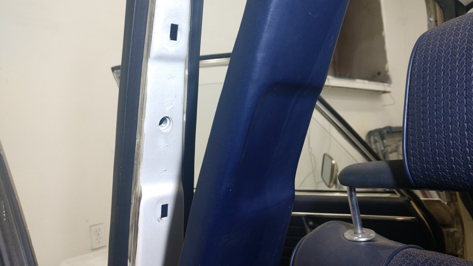

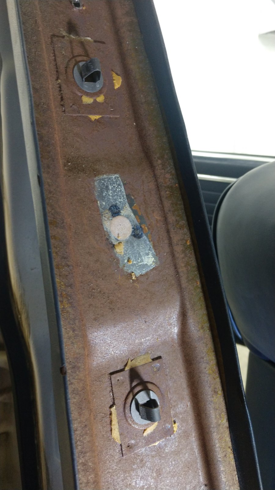

My car is a '69 2800 with the shoulder belt mounting on the roof but the B-pillar trim panel had the recessed area at shoulder height. I pulled the panel off and it already had a hole in the metal that was just covered with vinyl (I can't believe the trim panel is metal, and has metal clips. Awesome).
The retractor mounts on the interior rocker. I think later cars might mount in the bottom of the B-pillar.

I hated fumbling with the original seat belts and I never used the shoulder belt. It's so great to just sit down and pull the belt into position and have the shoulder belt at the right height. It took about 30 minutes a side including drilling the holes slightly larger on the belt mounts.
