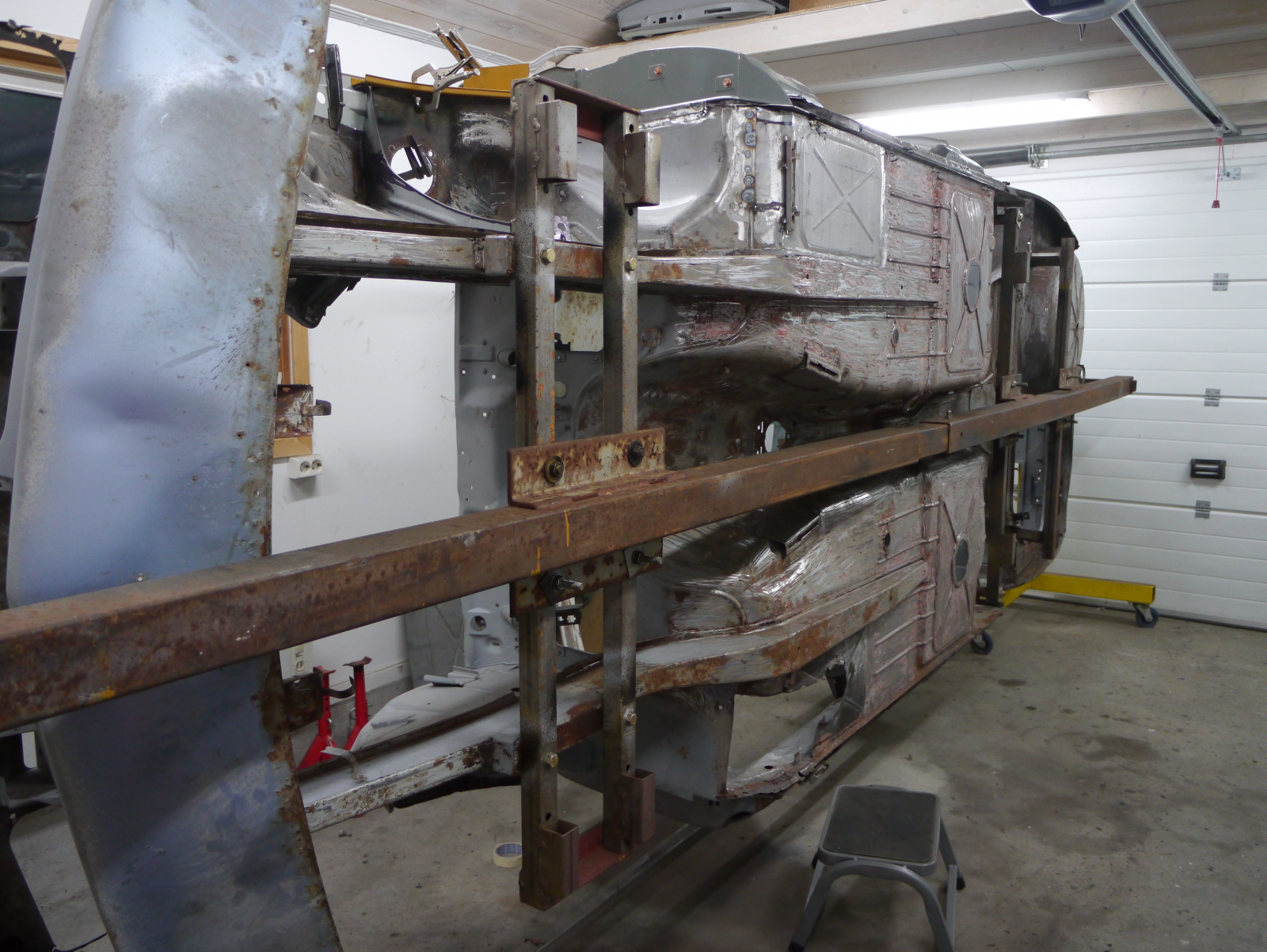

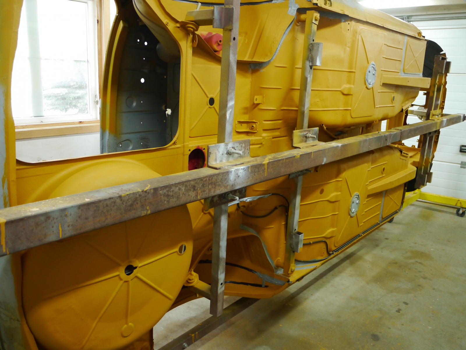

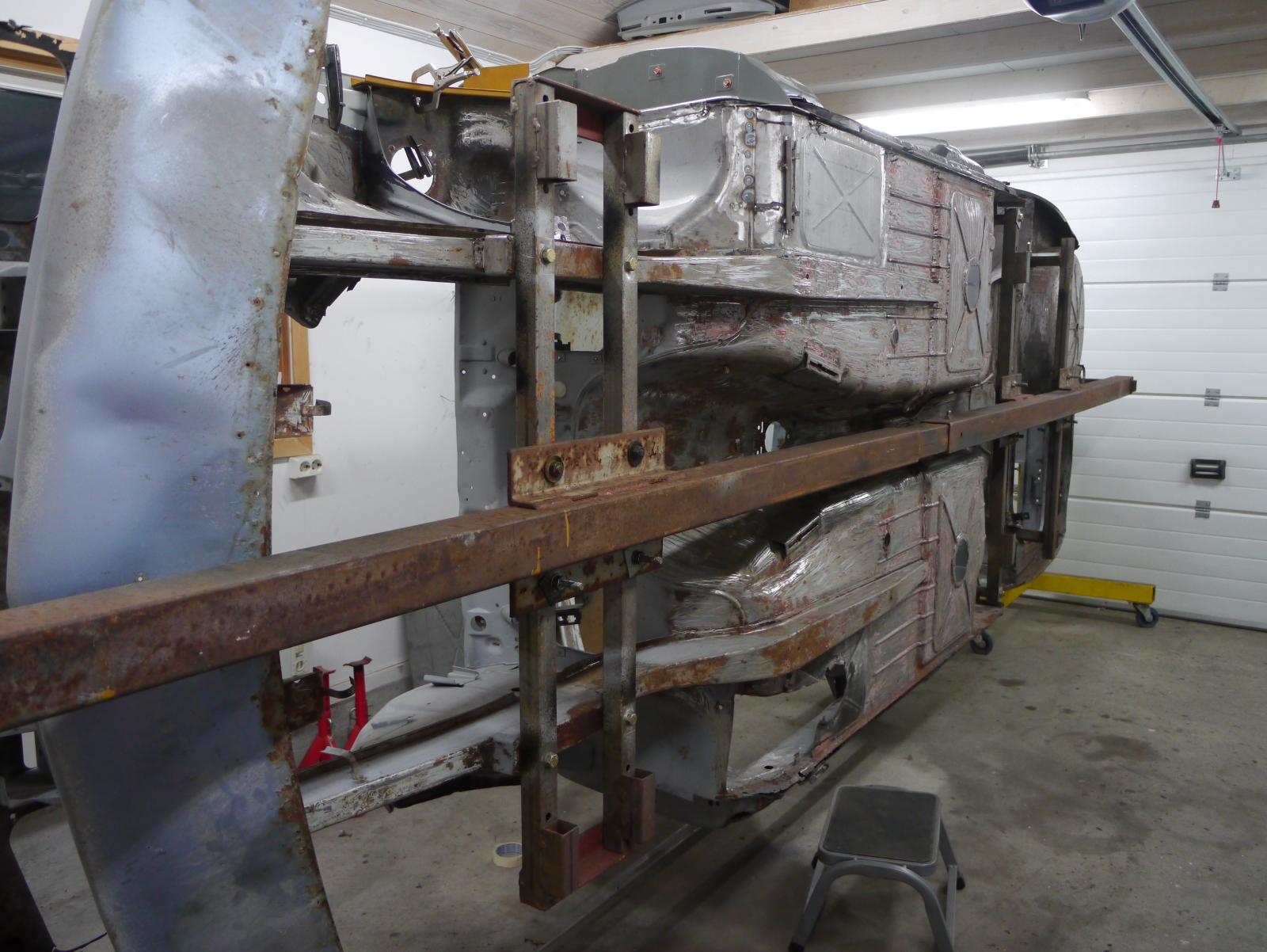

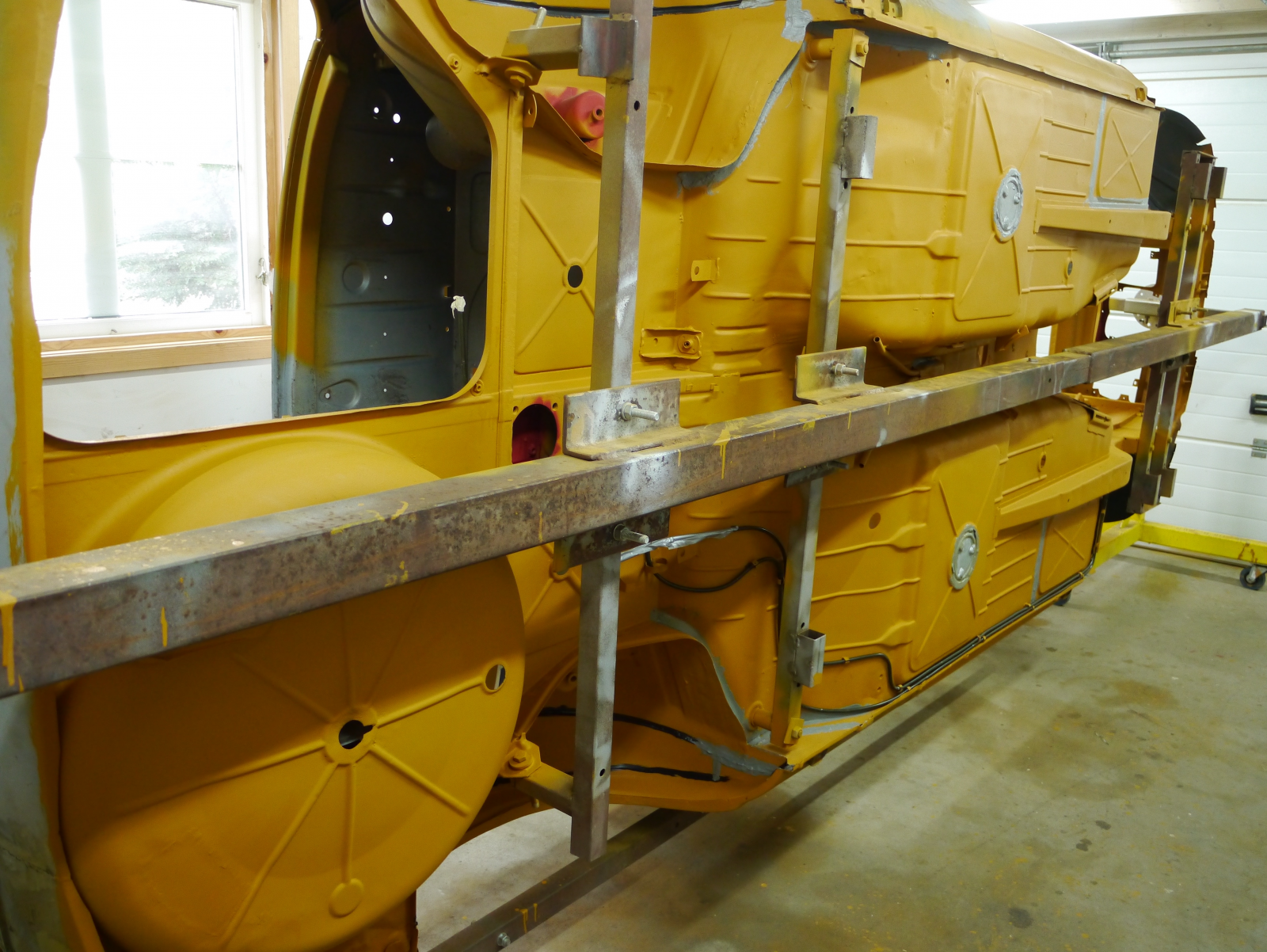

Here is my rotisserie solution. A very solid beam with cross members bolted to the subframe attachment points. In addition to this the door openings and coupe was reinforced with steel tubing, almost like a roll cage. You really can't exaggerate the need for support. Especially when you replace the inner and outer sills. If the strut towers are replaced you also need to weld in some measuring points before you cut out the old steel, to get the new steel in correct position.
My rotisserie holds the car at the front and rear subframe attachment points. I believe this works great, since most of the weight (engine, suspensions, subframes,...) is removed from the car when you put it on the rotisserie. Ofcourse you'l have to reinforce the body at the dooropenings etc.
If the attachment points for the subframes wouldn't be sufficient, then I would be afraid to drive an E9, and certainly take a corner or a bump in the road. The forces during driving a car or taking a turn are much bigger.

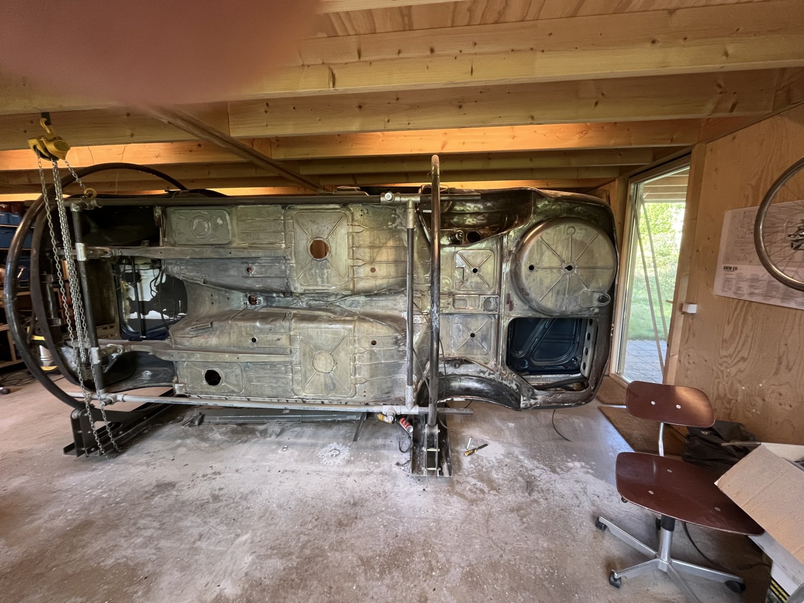

I'm working now for 8 months on the body of my E9 DIY rotisserie and it works great! If you're interested, I can deliver the drawings for this rotisserie. It's easy adaptable so you can put other cars into it too (Porsches, Ferraris, Detomasos,... ;)), and you can use it as a dolly as well.

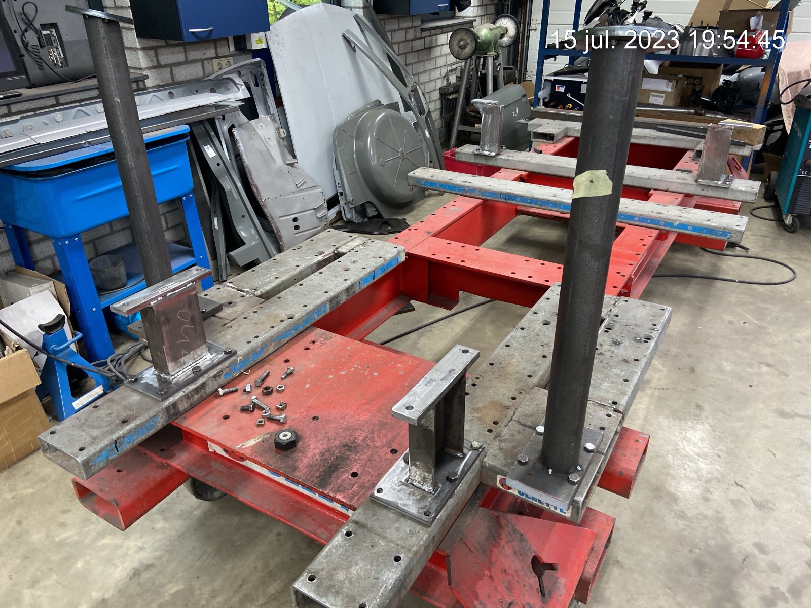

- If you measured it as being straight, you could build a light frame just to keep the shape. You could weld in an internal frame (with triangles in all three planes) Or you could make up an external frame, doubling as a dolly; 10 feet* 1*2 inch tubes would be sufficient. Perhaps you can go thinner if you combine such an external frame with some light internal braces.
- If you do not know if it is straight, or if you DO know it is crocked, then you need to correct it by building you car back to the factory dimensions. Thus you need something sturdier. A ladder-shaped frame supporting it from below with the 6 mounting points (+ optionally the diff mount) is a good option. I'd choose 2*4 inch tubes for length, and 1,5*1,5 inch tubes for the cross tubes. The red Celette jig in the image in the posts above is designed to PULL a body straight, not just assemble. So those big red beams are overdimenionsed if you want to rebuild it 'Lego brick style" (drill all spotwelds untill you have loose panels, and then reassemble while mounted on the fixed refence points.)

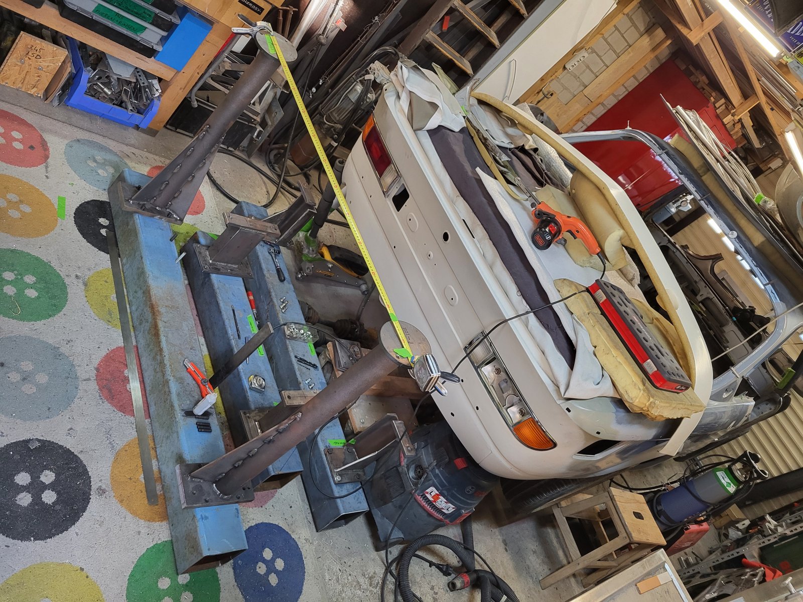

After completing the sill replacements~2 years ago, I'm now building an external frame to mount it on the 6 points so I can chop of the front end, and LEGO back the inner fenders, outer fenders, hood and front clip correctly.
If you have the space, one can build a torsion resistant jig with beams below the car and support it's framerails, front struts and rear strut towers. Optionally, IF you need to cut out exactly those points other points can be added to your jig like rear diff mounting points, sill edges or logic points like the 2+2 drain holes in the frame rails under the passenger compartment
I'm very impressed with the ease of accessibility with Johan's design. I'm not going to become more nimble with advancing years and the three years I've allotted may be optimistic. I am starting with a well-built dolly. Perhaps can adapt dolly to work with the hoop rotisserie. Also nice that unlike bumper mount ones the overall length is less than that of the body.
