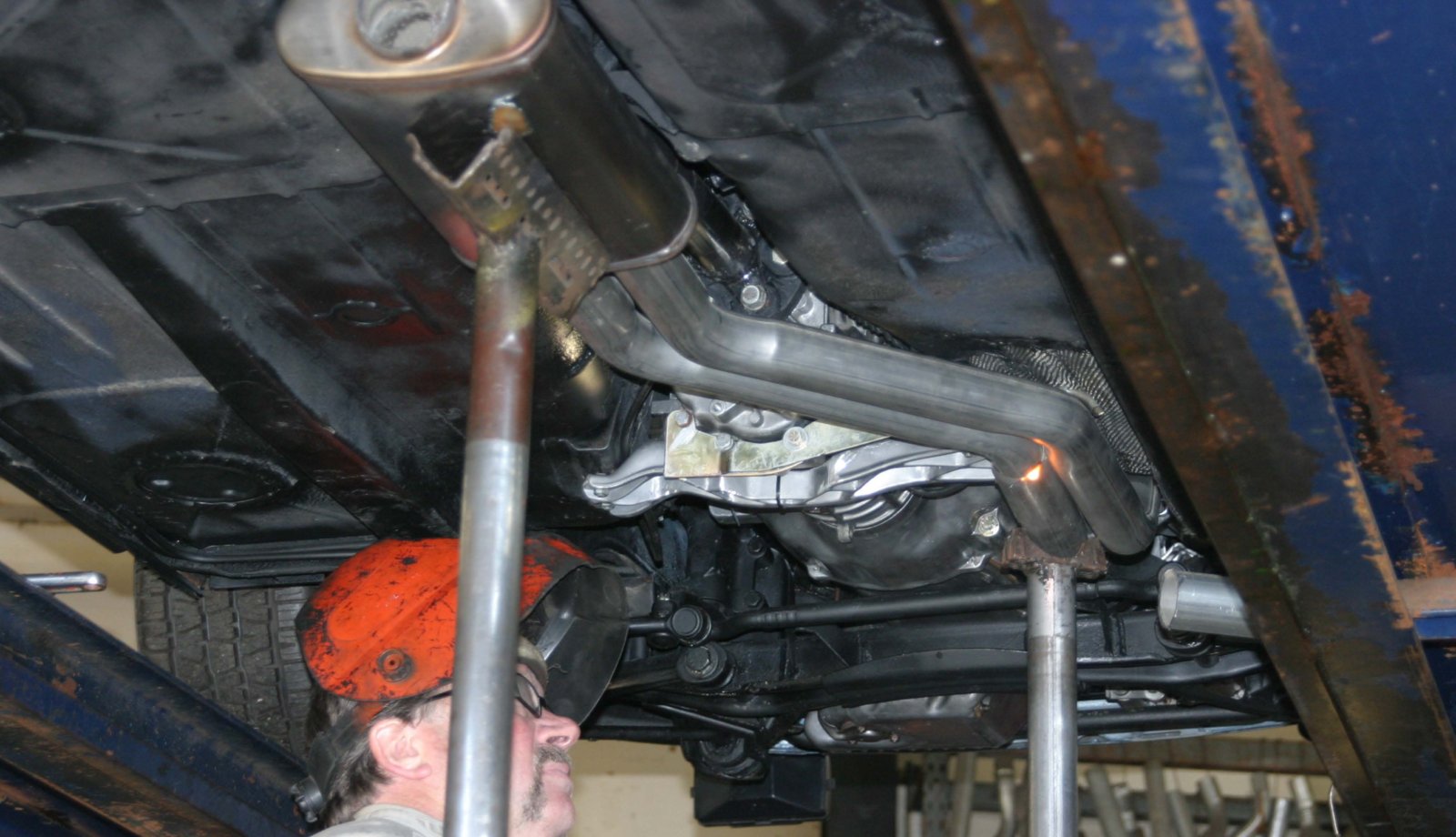

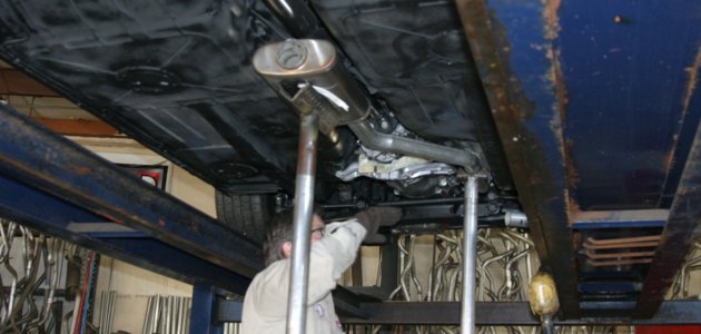

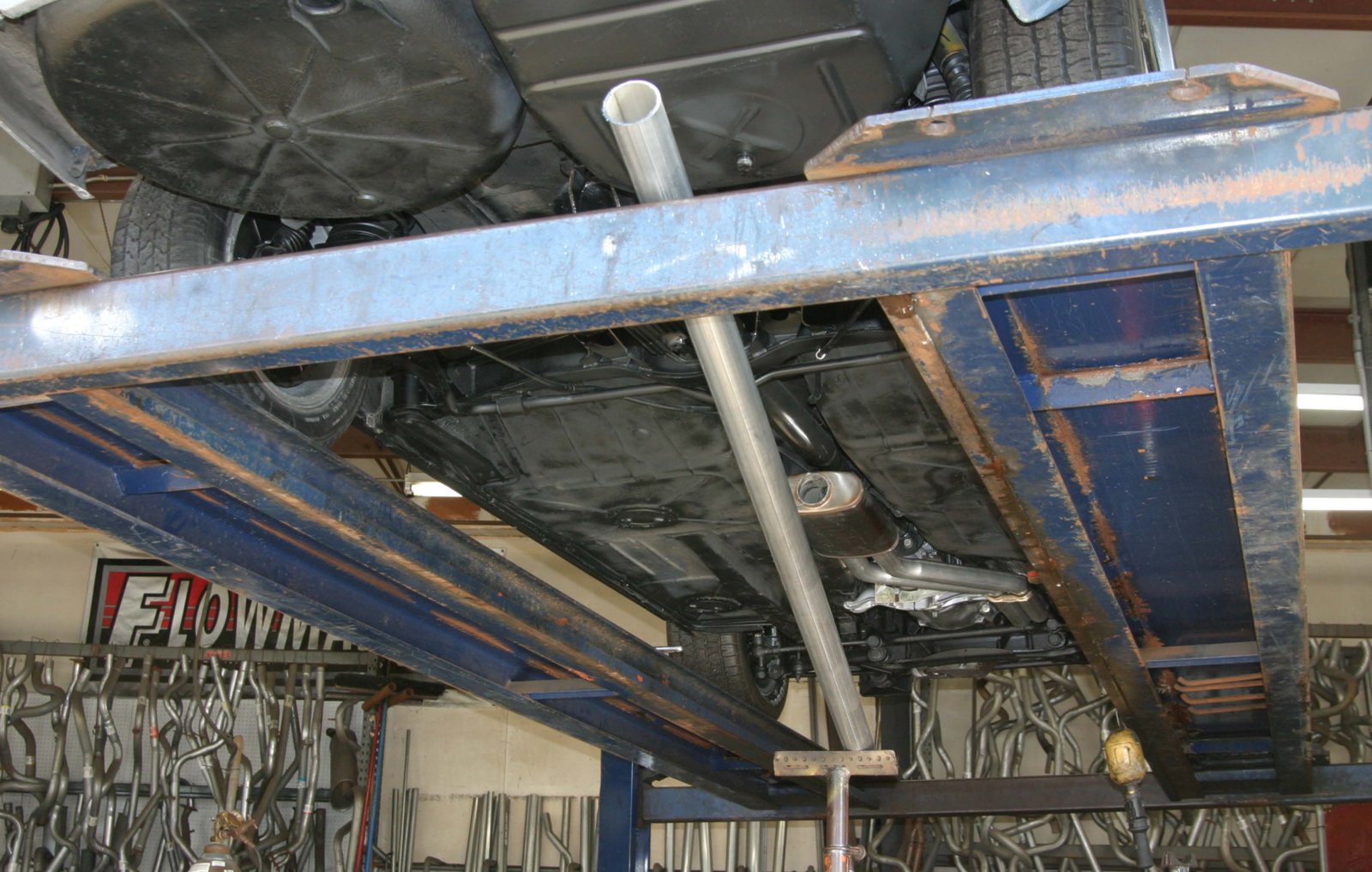

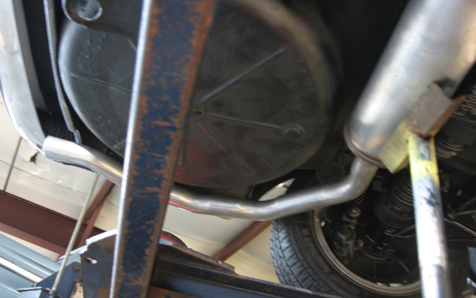

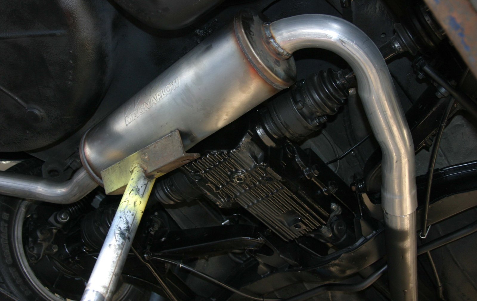

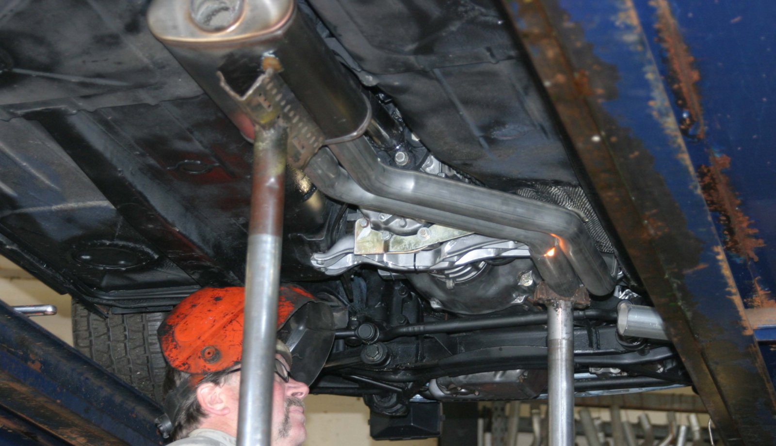

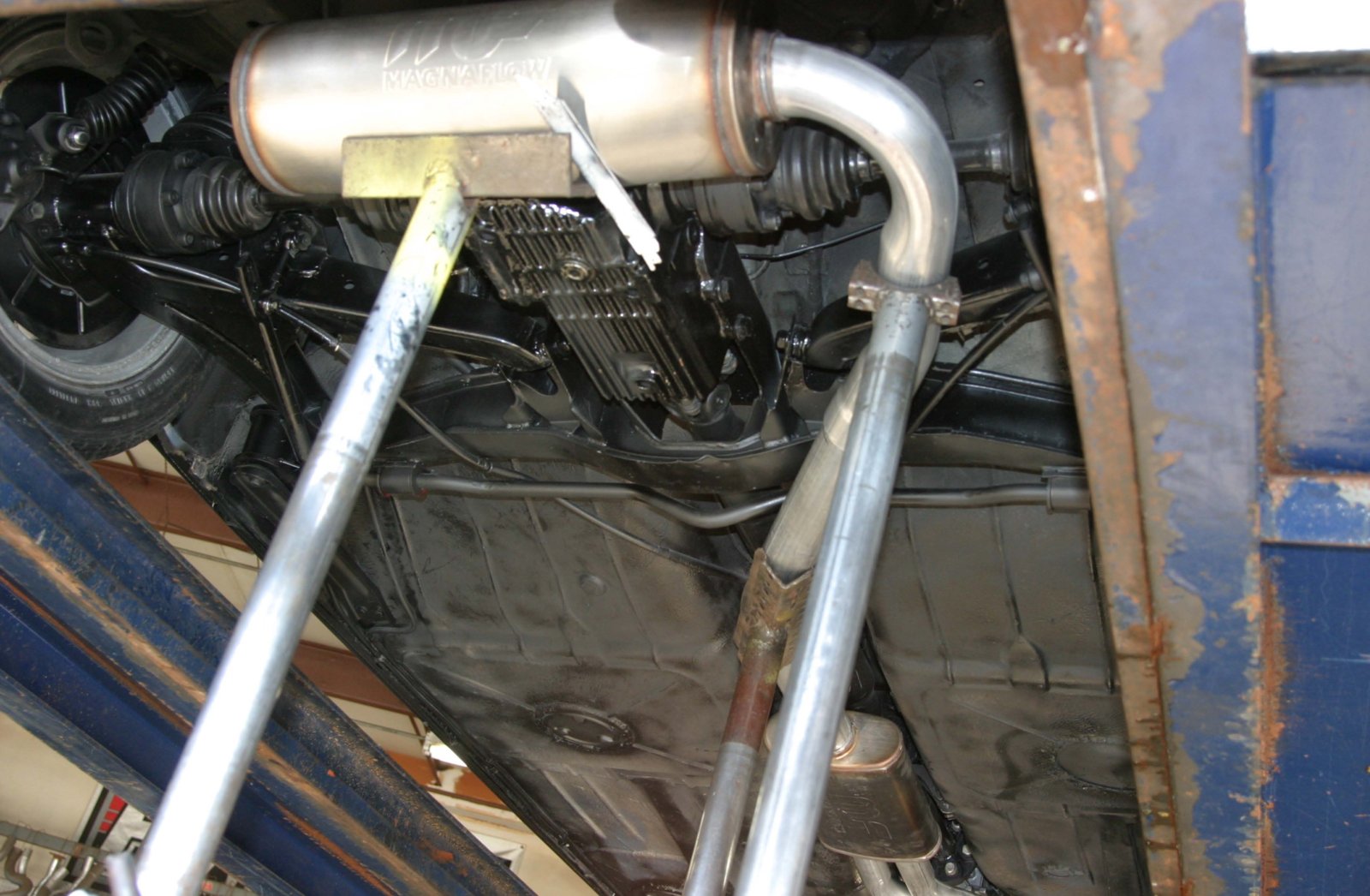

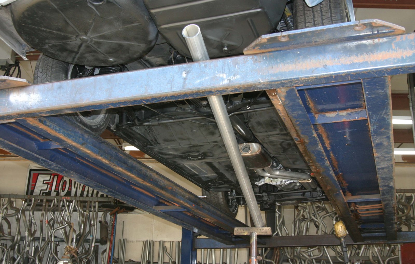

if you dont mind not being oem
just go to any muffler shop and install a generic set up
unless you going to a concouse which even then
any good muffler is perfectly fine and save a ton of money
as i did
