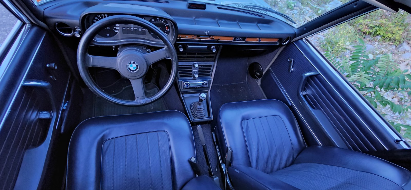

Any interior pics perhaps?

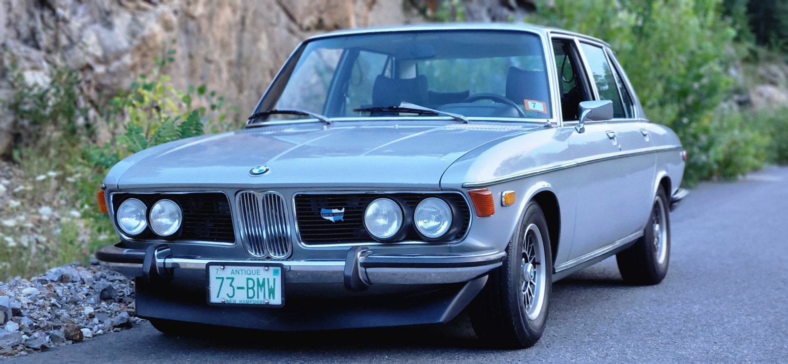

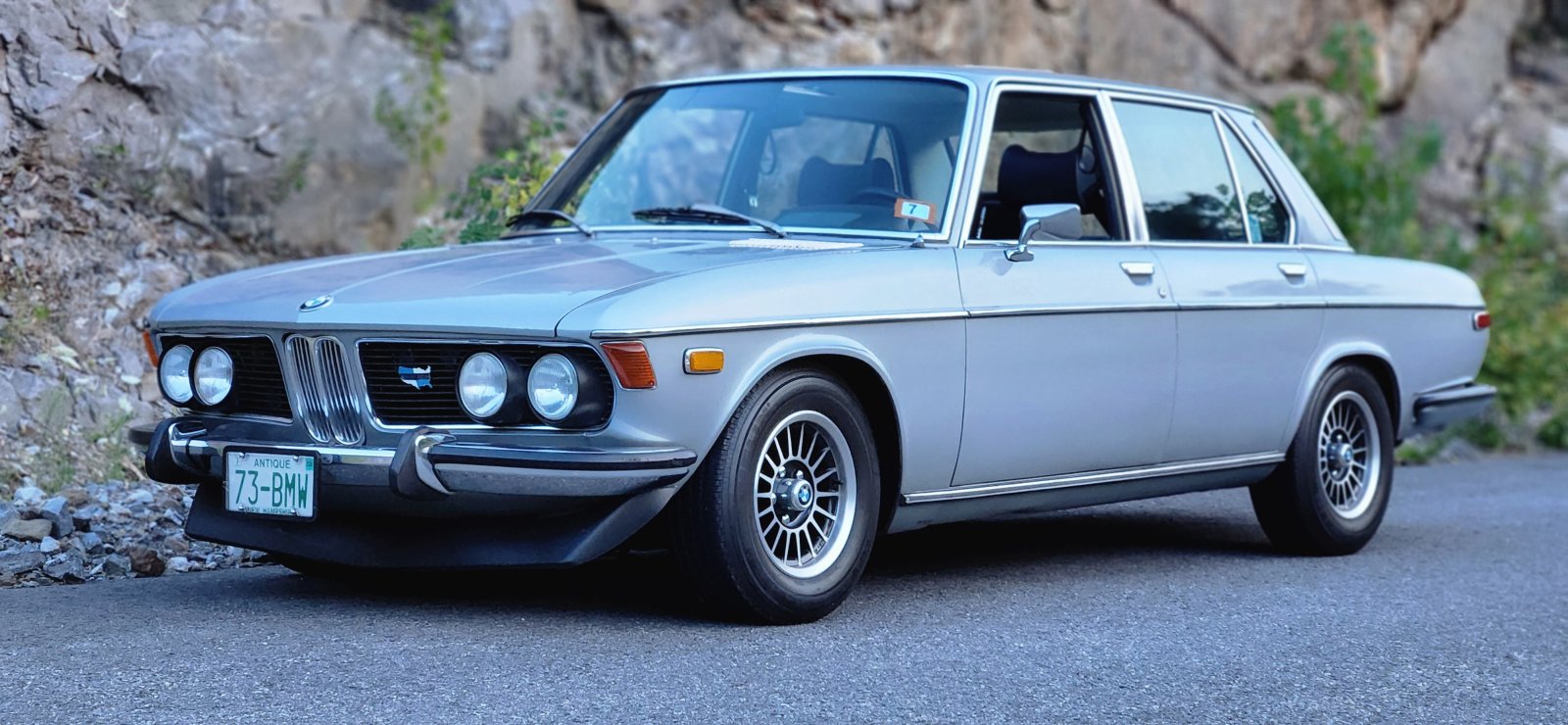

Curious, who made the air dam? pretty cool.

I think the airdam is a 1969 or 1970 mustang air dam.
