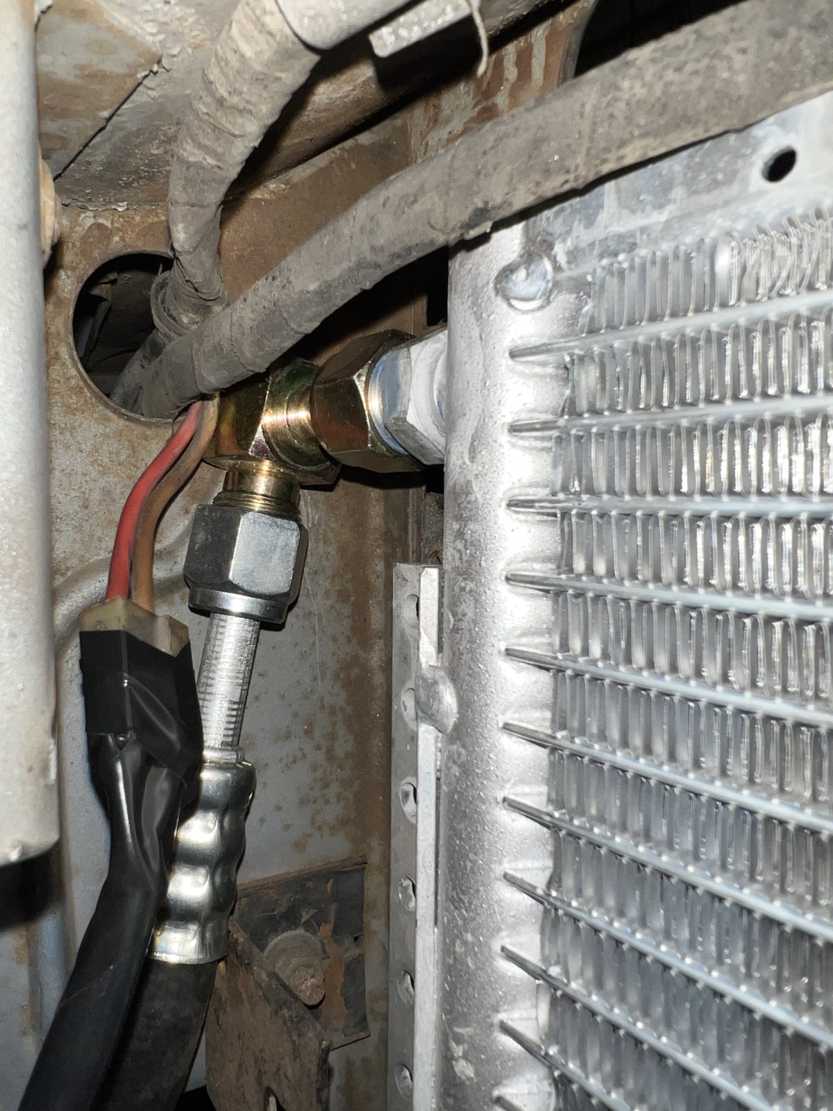

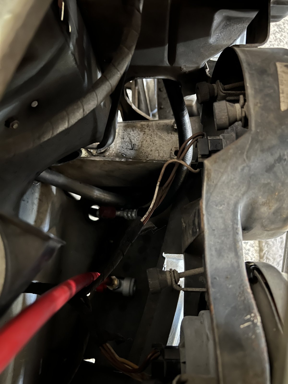

I put a R134 fitting set on the low pressure port that was already on the line between the evaporator and compressor and on a new port I spec'ed on the new line between the compressor and condenser. The consensus 16x20 size for a condenser that fits was backordered so I got a 16x22. Before ordering hoses I set it in place and decided the output port would be a straight shot out the side at the bottom but the top port would need a 90 degree adapter. If I had it to do over I would have skipped the adapter because it was bulkier than just putting a 90 degree fitting on the end of a hose. It was a really tight fit but it worked after a sufficient number of four letter words.
My other great revelation was that the high pressure port should be several inches closer to the condenser instead of the middle of the hose, but I can still reach it easier than the discharge port on the compressor!

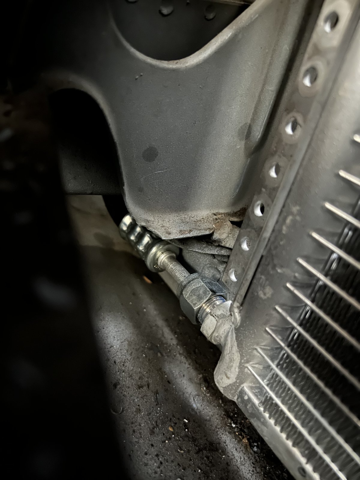

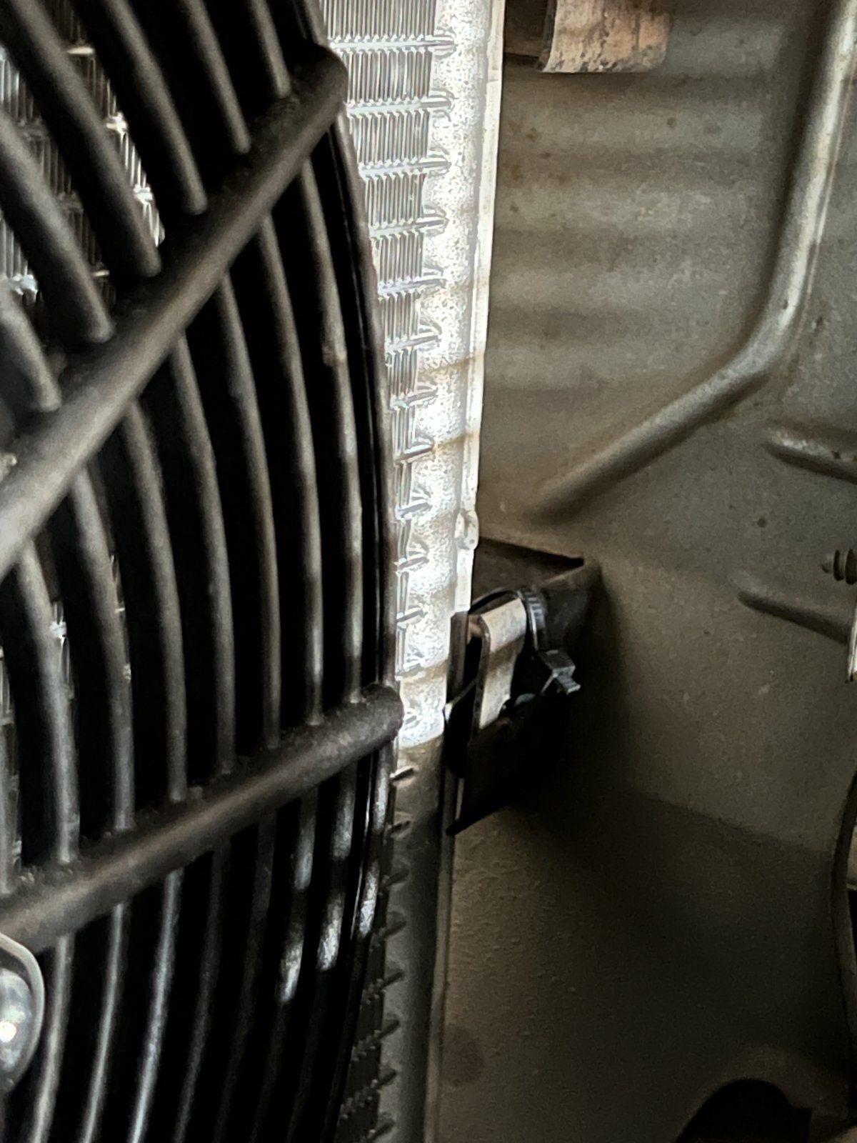

The original bolts that held the condenser in place were too large for the new one, so I decided that some rubber spacers and zip ties were Good Enough and still prevent any metal to metal contact anywhere.
Same for attaching the new electric fan to the condenser. Some standard crimp-on male spade connectors plugged right into the factory aux fan connector and I correctly guessed the polarity from the colors.
After hours of cleaning the bottom half of the engine I decided it was a good time to replace the valve cover gasket but I could now see the bolts that held the compressor in place and pulled that so I could drain it and put in new universal oil. Sadly the harness connecting the compressor to the dash had no disconnect so the compressor stayed tethered to the car but I had enough slack to support it with a wood block ahead of the front tire. My Bosch compressor has a drain plug on each side. (The brass screw on the back is not a drain plug, it's some sort of pressure calibration, whcih I suspected from reading other posts so I could count the number of turns and put it back where it started.) I opened one plug to drain it and poured new oil in the suction port until the new stuff started coming out and turned the pully until more new oil started spurting from the discharge port. I kept track of the net oil in it so I could top it up from the other drain plug while it was on its side.

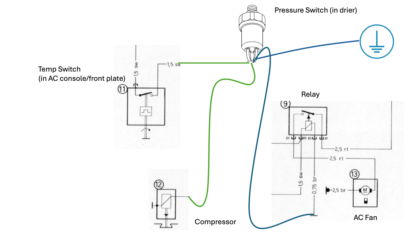

The one thing I would add to the list - if your drier permits - is a trinary pressure switch for safety, preventing too high or too low pressure in the system and protecting the compressor.
I should have thought of that, good tip for next time! I also need to fix the washer size on the drier. For some reason it has #8 fittings and #6 hoses

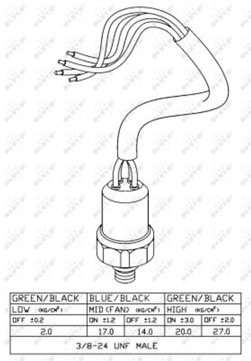

the good news about the pressure switch: you do not need to open up your pressure lines. You put the switch into the drier, and connect your wiring accordingly, as it is essentially an upgrade to your electric circuit.
I am using this pressure switch 3/8'' 24 UNF male insert

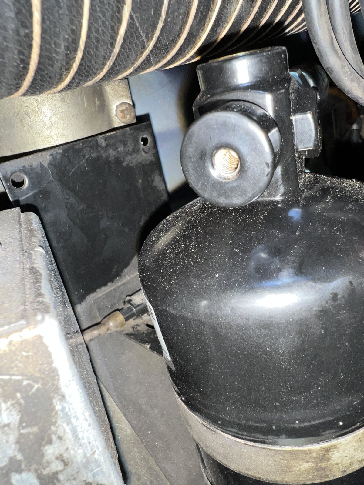

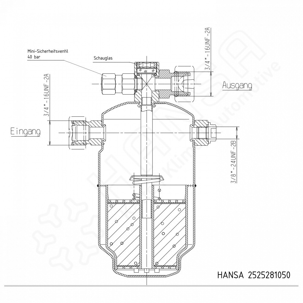

My new one is a Mercedes part with smaller threads than that. It was a direct replacement for how the refrigerant lines were routed in my car and I hadn't thought about adding a switch. I am curious how it works without being exposed to the gas pressure... I guess there's a little piston in the drier that pushes on the switch?
that is a question for Gemini:
1. How it Mounts (The Schrader Valve)​
The switch features internal threads and screws directly onto a port on top of the receiver-drier. Inside that port on the drier, there is almost always a Schrader valve (similar to a tire valve stem).
  • Mechanic's Tip: Because of this Schrader valve, you can usually unscrew and replace a bad pressure switch without having to drain the refrigerant from the system. As you unscrew the switch, the valve snaps shut and seals the gas inside.
That makes sense...not what I have, so I'll probably just wait and add one to a new hose port if I ever get a leak... or maybe I can find one that goes on an r134 high side port...
