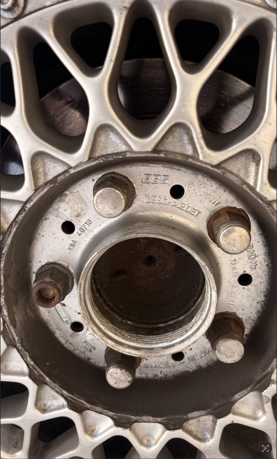

First, I lost one of my BBS center caps on a recent drive. I’ve attached photos of the wheel and the remaining cap setup. If anyone can tell me best source for a replacement, I’d appreciate it.

I have the stiffer 28mm sway bar on my E9 and like the handling. I hadn't been the one to install it so unfortunately can't speak to its feel vs the stock but it does feel fairly "grounded". I just replaced its bushings and used the Ireland Engineering ones which worked out well.
