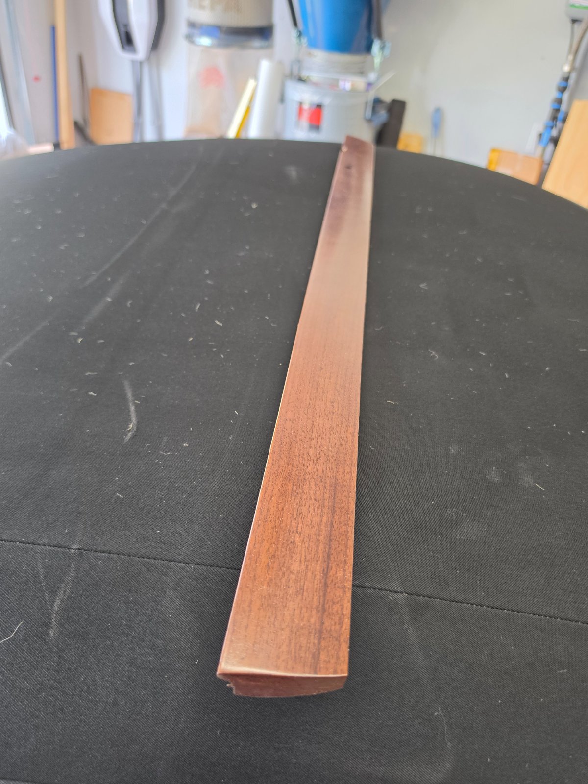

my new wood trim that will allow me to perform the ash tray delete. This of course means reupholstering the door cards.
KastelikClassicCar makes door cards and I bought a set with the ash tray deleted. If needed you can find them on this forum or the internet. Product was great.

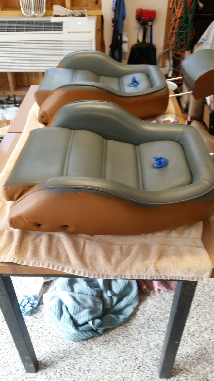

What was the previous color? That looks great. How supple is the dyed leather?
Previous color was dark gray.
As to suppleness, I'll say a couple of things. I would say they are stiffer with less flexibility than high quality furniture leather. Even compared to higher quality leather in English luxury cars (top of the line Jaguar and Rolls Royce, for example), they are firmer. I conditioned the heck out of them before coloring, and condition them regularly. So they are about as good as they are going to be, but the leather is probably more durable than supple.
That said, the dying process did not change the suppleness. The seats are as supple now as they were when I bought them.

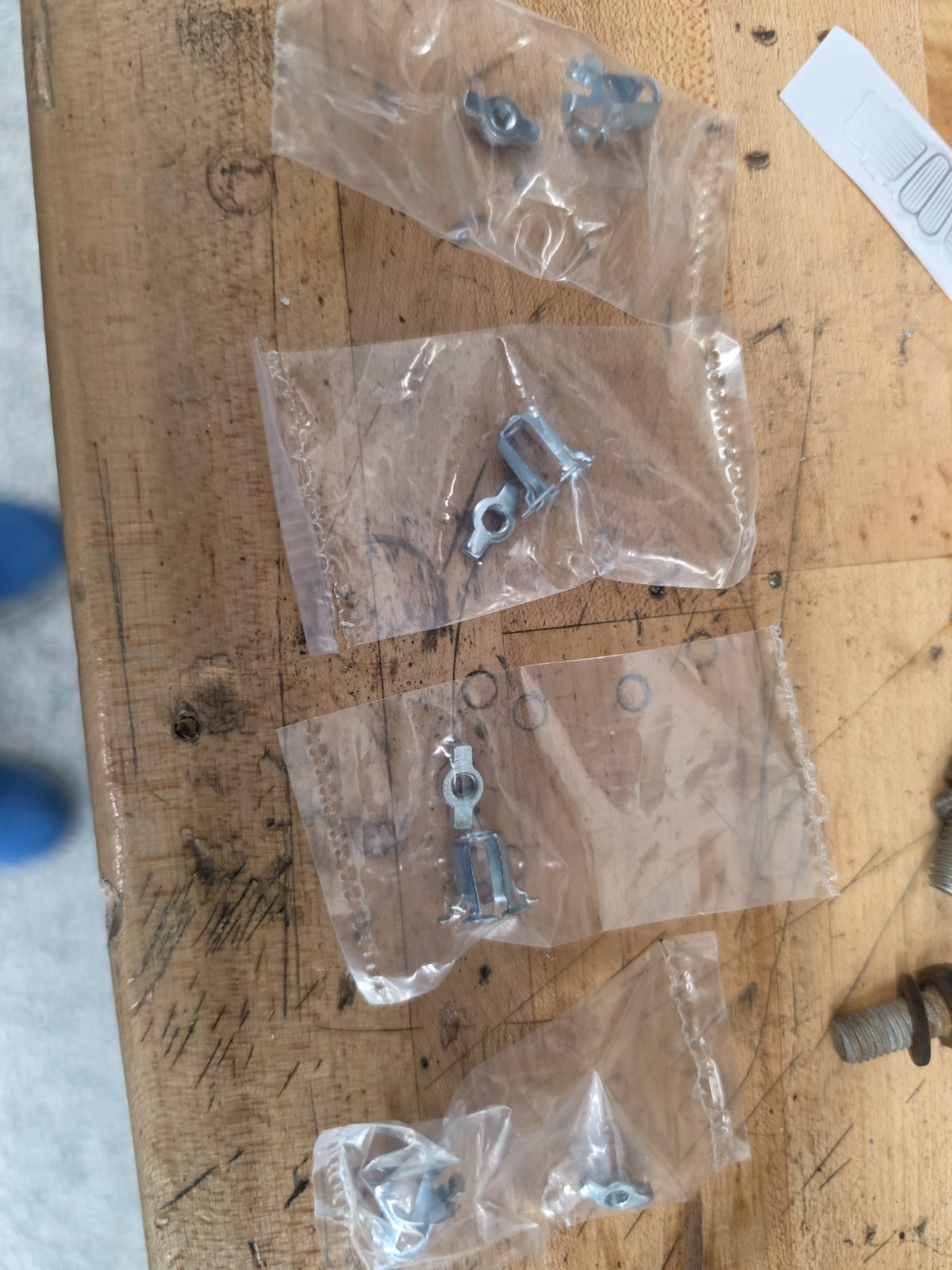

Care packages arrived today from sfdon and Thomas. New dood trim, mirror nuts and an exhaust bracket and from Don a gas tank rubber boot.
If you're putting that rubber gasket around the fuel neck filler area read up on the process, it's a bit annoying. Someone had the tip of using some female-female screw extenders, look at the install threads. I found those made the job much easier and also makes the screw easier to remove if needed in the future

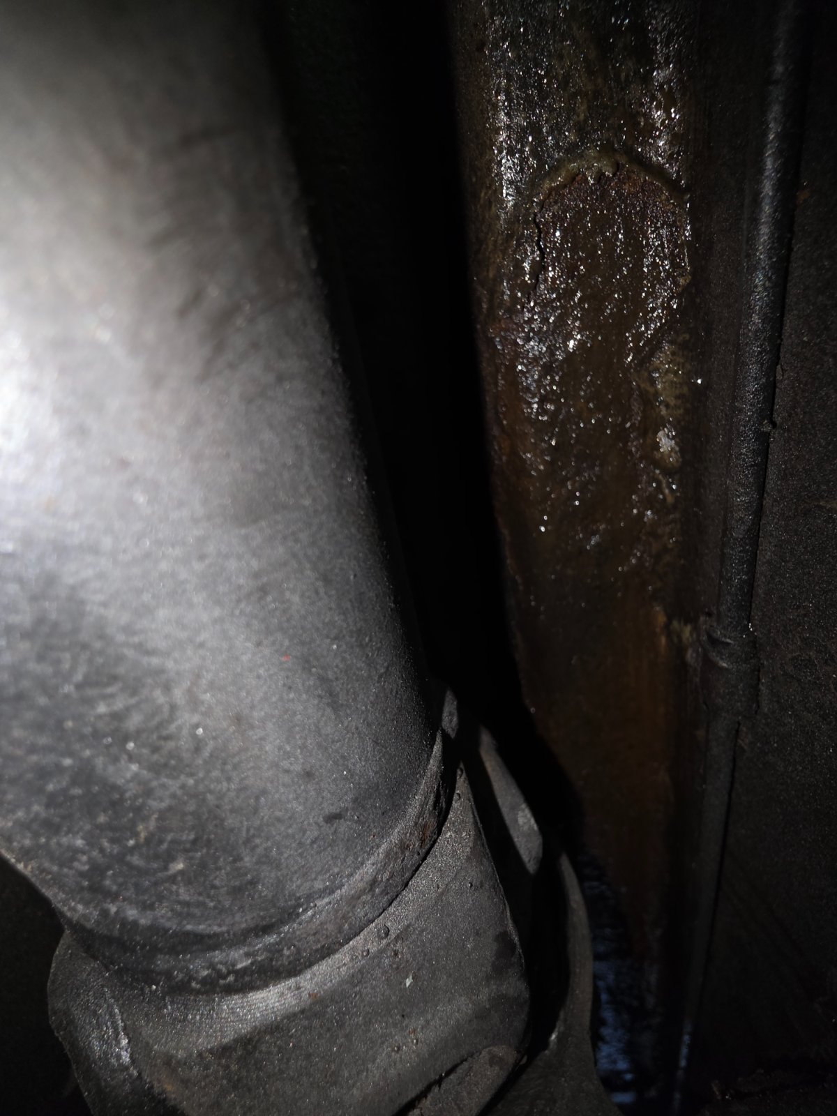

Today I have the unpleasant task of cleaning up some rust under my car. Fortunately it is only surface rust. Next i will remove the rockers.
Does that rubber gas grommet fit the Bavaria, too? I didn’t order one years ago when I should’ve…now they’re nla..:-/.
I have used the Fluid Film equivalent. Highly recommended (either one). Just don’t be surprised when you see some drips coming out of the frame for the next few weeks - it’s not oil!
I generally like KBS products and have used several of them. I have used the cavity coater and it flows very well. I did find that it oozed out of the cavities a bit after, but that is not really a problem.

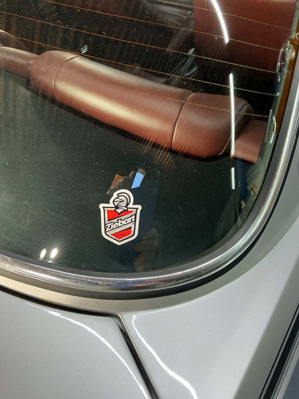

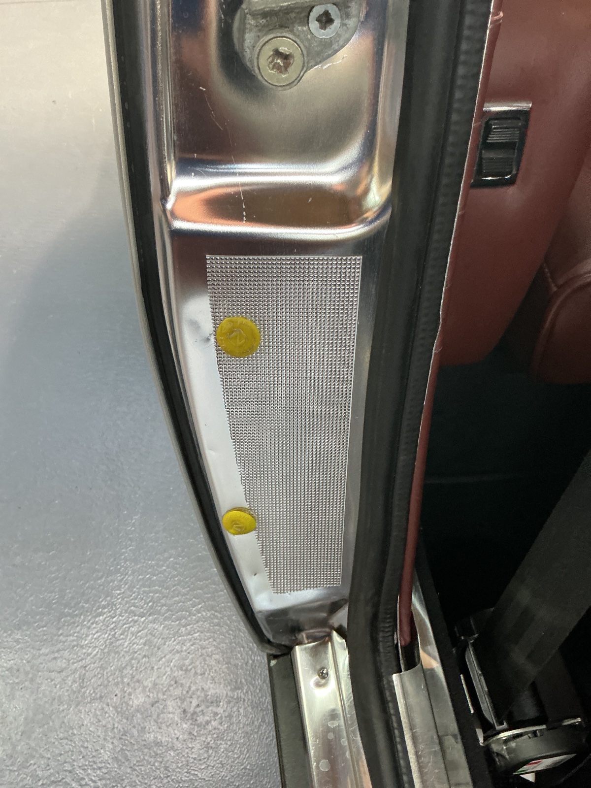

My car got the Ziebart treatment before I bought it.
Perhaps the only Coupe that I’ve ever seen that the owner went ahead and spent the money and got it treated before the rust started.
its a shame they didn't remove the B pillar covers before drilling.

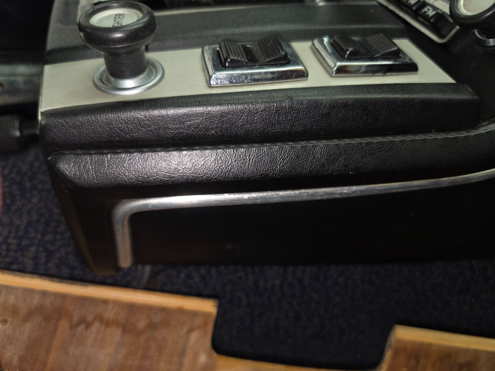

There are a handful of tiny screws in the console that hold a bracket connected to the console to a wood block glued to the inside of the side panel. You have to access these screws through the center of the console around the shifter. Its been ten years since I had an automatic, but I think on my car (a 72 with a ZF transmission), you unscrewed the shift knob and removed the cover along side the shaft (by pulling straight up). Then remove the window switches, and you should be able to locate the screws. There is a "Z" shaped metal bracket (or perhaps it was "C" shaped) that is screwed into the underside of the console. The bottom of that bracket has a slot with one or two very small screws that screw into a block of wood on the inside of the side panel. You are looking to remove the bottom screws from the slot in the Z. Then the console should lift up, but the wiper switch and cigarette lighter wiring need to be disconnected before you can remove it completely.
