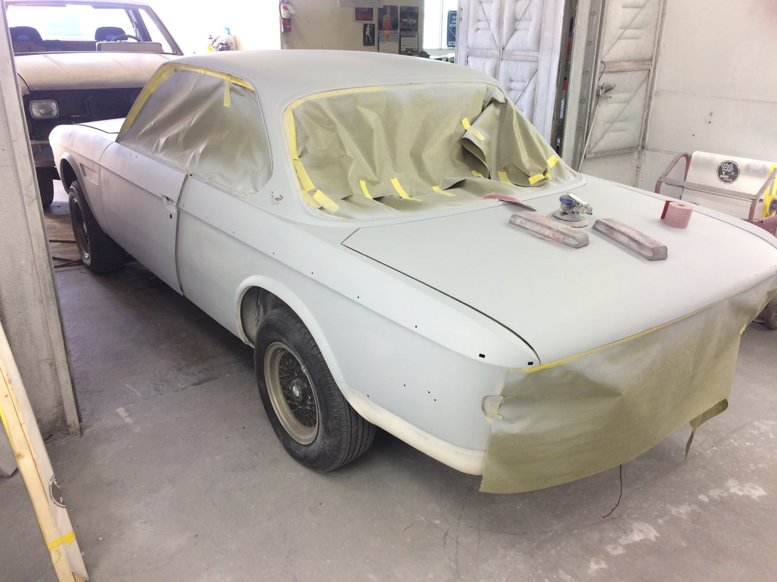

6 years ago I bought a 2800cs coupe for my dad. It was in Santa Cruz, and it had been stripped at one point but painted with crap paint. My dad always wanted a coupe - he looked at buying one when he finished medical school in the 70's - so I felt it would be fun to buy him a body and start a project together. The goal is an s38 swap + r&p steering. We're pulling the s38 out of a '93 m5 that we picked up a couple years back.

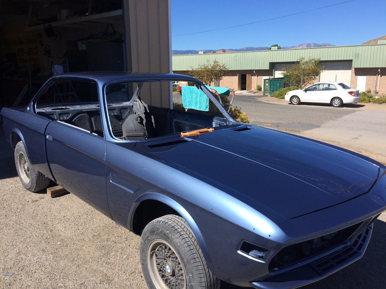

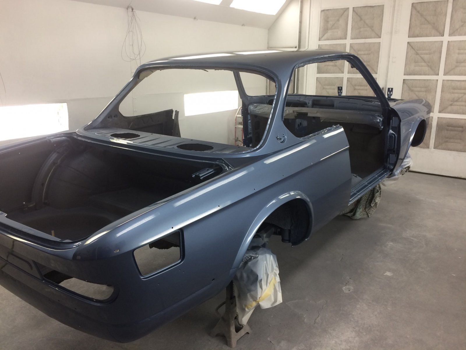

are you sticking with the stock engine loom and ECU, I think I would, you just need to sort out the EWS........................ nice colour,
personally I used to do the main work on an engine swop with the exterior in primer or with a slave coat of straight colour, saves repainting the front end after the job is done,
I like the color as well. I"ll need to be very careful. Wiring won't be that bad.
