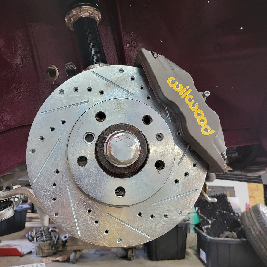

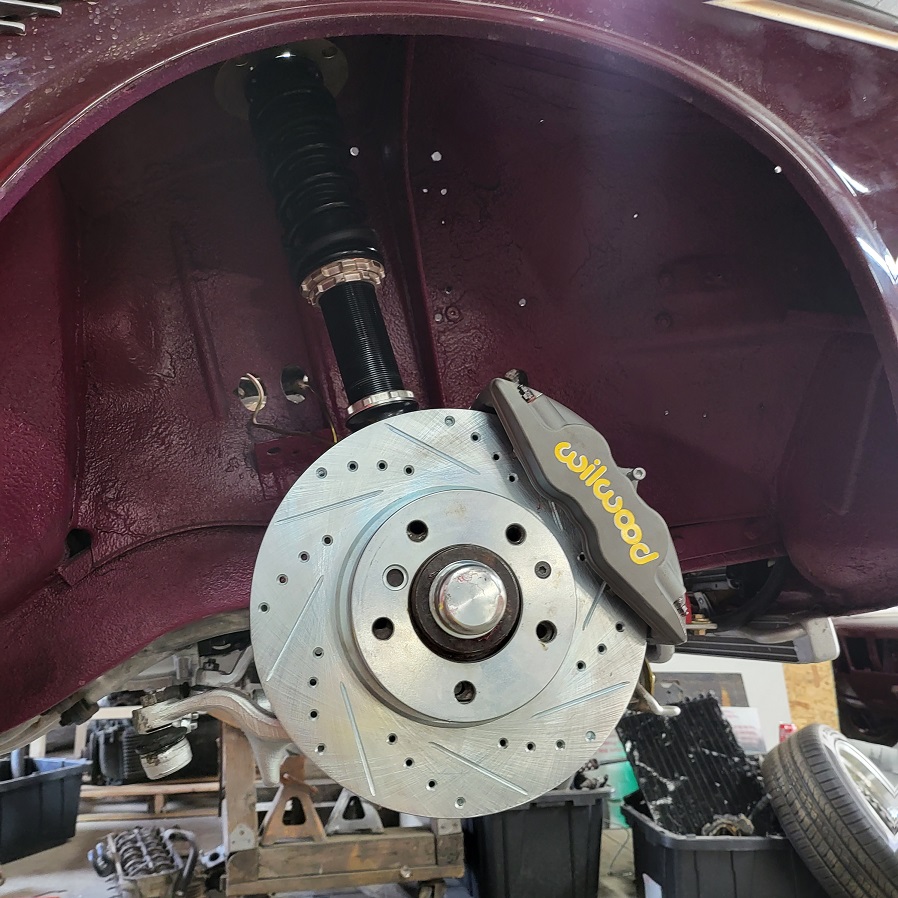

Hello all, I got big brake system for my Malaga E9 with e46 engine what you guys think any other upgrade I should do to work better with this brake system properly, I need professional opinion I don't know much about the car I am a construction guy.

Nice and shiny!
Well, good tires would be a complement to that brake system...and a modern retractor based seat belts :).
Also the correct master cylinder.
Hello, and thank you, I am using the small booster the one it is on 2002tii you can fined it was no room for bigger booster the engine is E46 and original Master cylinder, please tell me what is the correct master cylinder. and thank you
Here is my suggestion:
(1) of the Wilwood kit was specifically designed for the E9, you should be ok with the stock MC. The smaller vac booster will provide less assist so your pedal may feel slightly firmer bit require a little more pressure to operate. Brake feel preference can be very subjective.
After you drive the car you will know of you are happy with it or not. If “not,” you can resize the MC piston diameter (and pedal linkage pivot point) to increase/reduce pedal effort till you are happy with the trade off between effort and pedal travel.
(2) if the Wilwood kit is something not specific to the E9, then I suggest you do some simple calculations to check your caliper piston area compared to the MC piston area to see if you changed either the hydraulic leverage (assuming you kept the stock E9 pedal assembly). You have to also include changes in the disc diameter and effective disc radius to see if you changed the mechanical leverage. If there is a big change in overall brake leverage (>30%), you may want to resize the MC. However, what may be more important… any time you make a big change in the front brakes, you may upset the front/rear brake balance. If this happens, you may need an adjustable brake bias adjuster setup to re-balance the front/rear balance.
