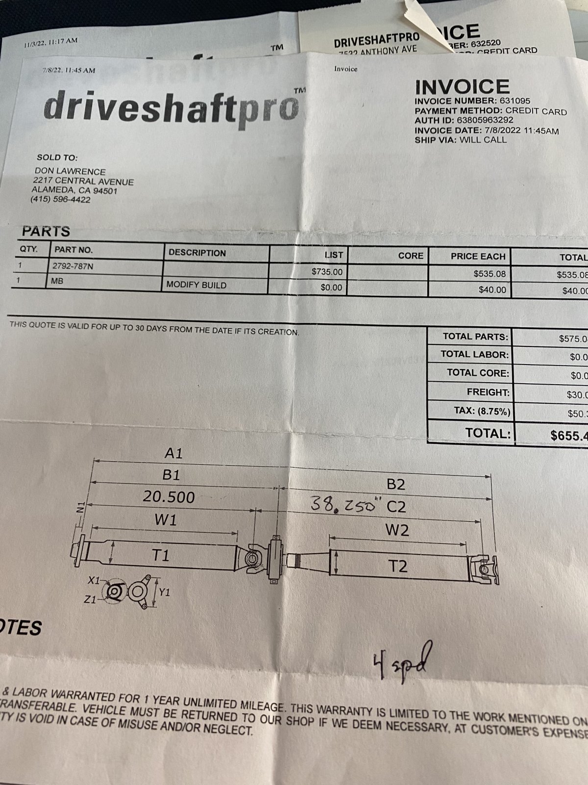

@HB Chris, are you saying that the receipt that @sfdon is showing (copied here) is for a 5 speed conversion? If so, that is very helpful to include in the DIY section as it would allow pre-order using the spec on the sheet.

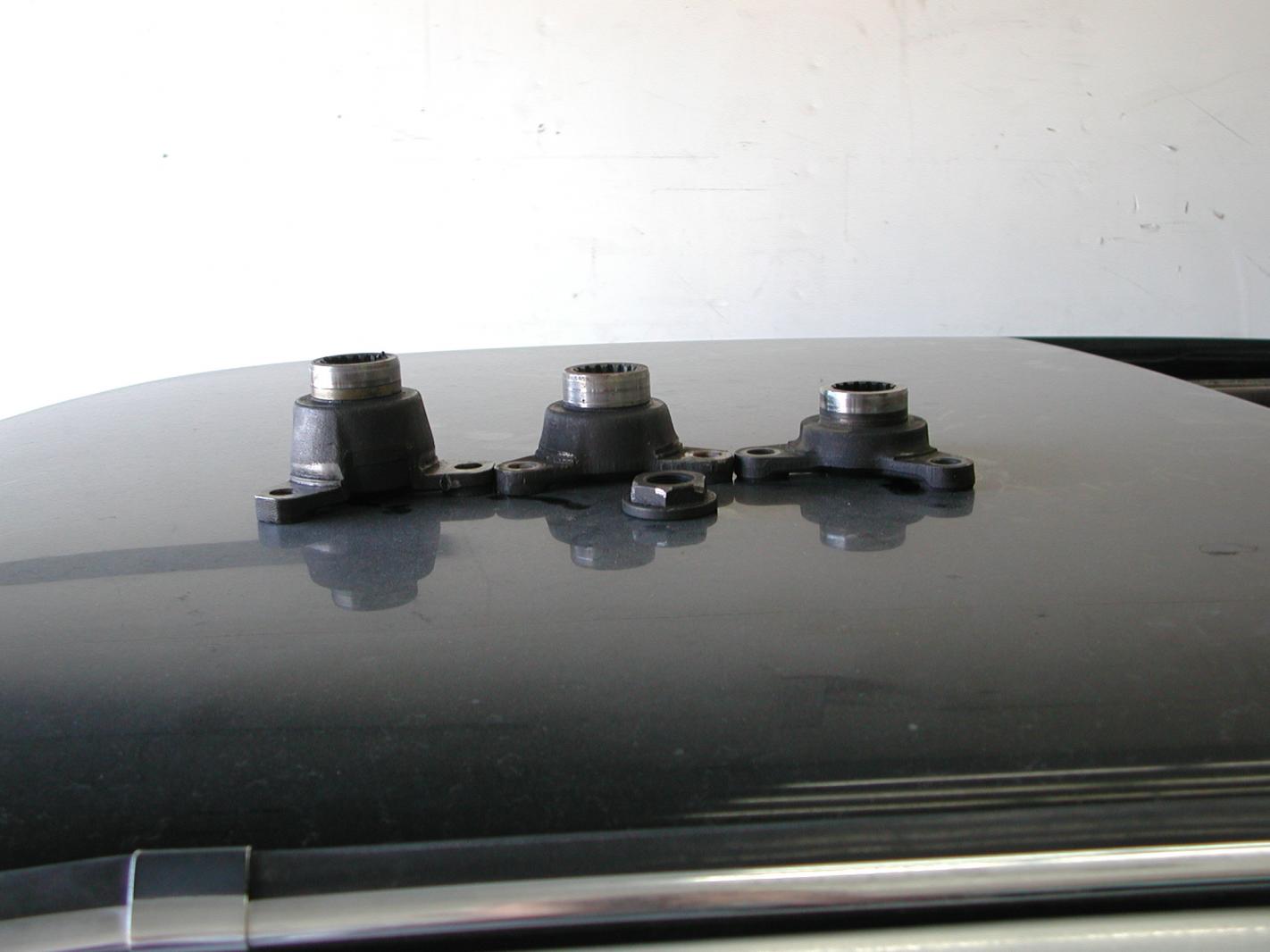

There's no guaranteed answer since there's three different output flanges on the 265's, all different length, and what type of guibo you choose to run also matters (different thickness).
So you need to know these things before you decide on driveshaft length.

5 speed shafts have 16.75” front sections and 4 speed shafts are 20.5”
UNLESS! - You use the M5 Guibo which is 10mm smaller than a stock 4 speed Guibo, at which point you add 10mm to that length Carl suggests
Do your math if you use an M5 Guibo and order your driveshaft accordingly.
From Carl’s post-
The five-speed conversion for a CS is not difficult, but there are a great number of steps. The layperson might not immediately understand some of these steps, but they have a reason.
  1. Remove the exhaust system (you need lots of room) up to the exhaust manifolds.
  2. Remove the drive shaft. A custom unit must be fabricated, shorten a 4 speed by 3.75 inches

We use 3 different guibos ( 30, 35, and 45 ) and 3 different flanges

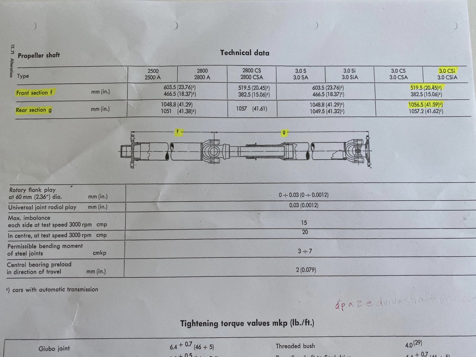

Below are the dimensions from the Blue Book Manual that I sent to Driveshaft Pro for a new replacement driveshaft recently installed on my 72 CSi 4 speed.

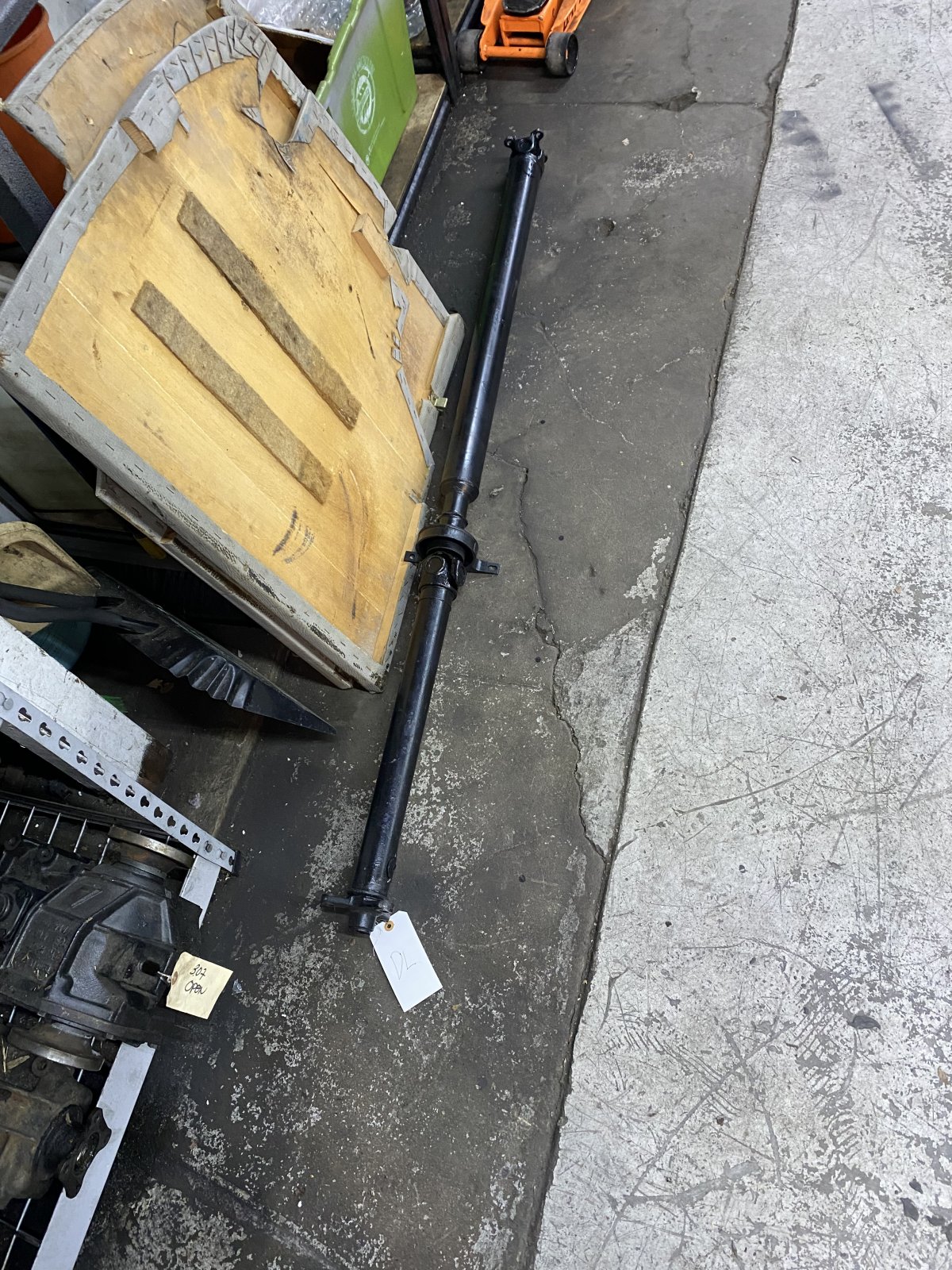

I took that drive shaft out of the back, photographed it, measured it and my tech and I decided we would not install it because we didn't like the u-joints
and just throw it away.
Young Nick the shop clean up kid came in and threw it away on Wednesday. Trash gets picked up on Thursday. It's gone.
