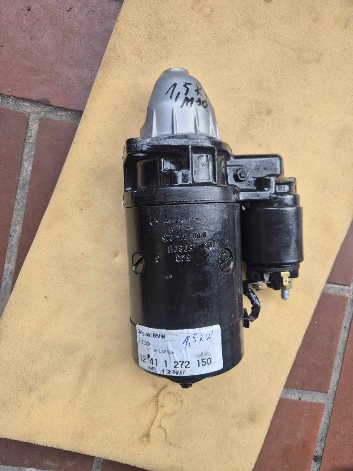

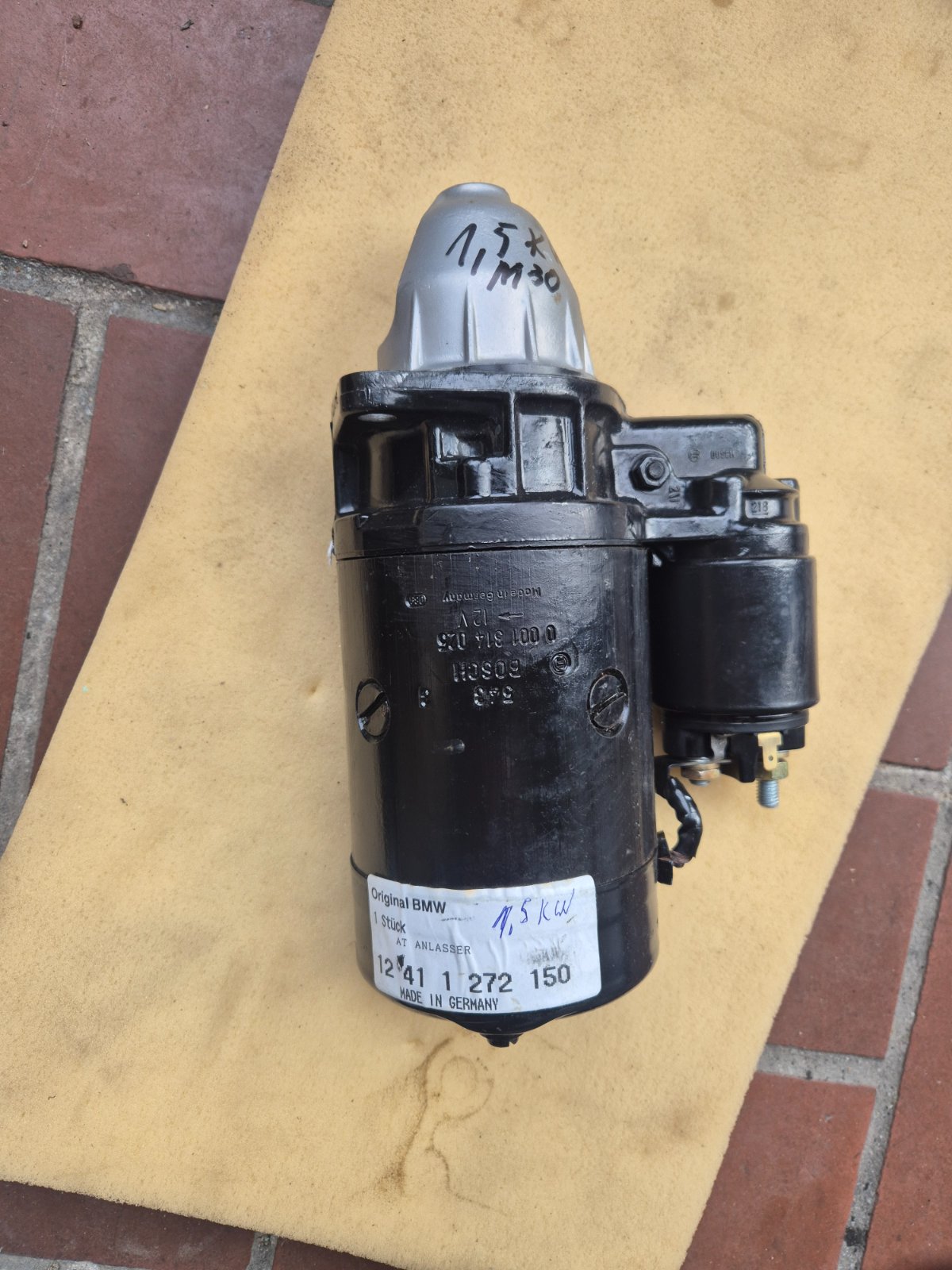

I have this available
1.5kW at 300€ plus shipping from Germany

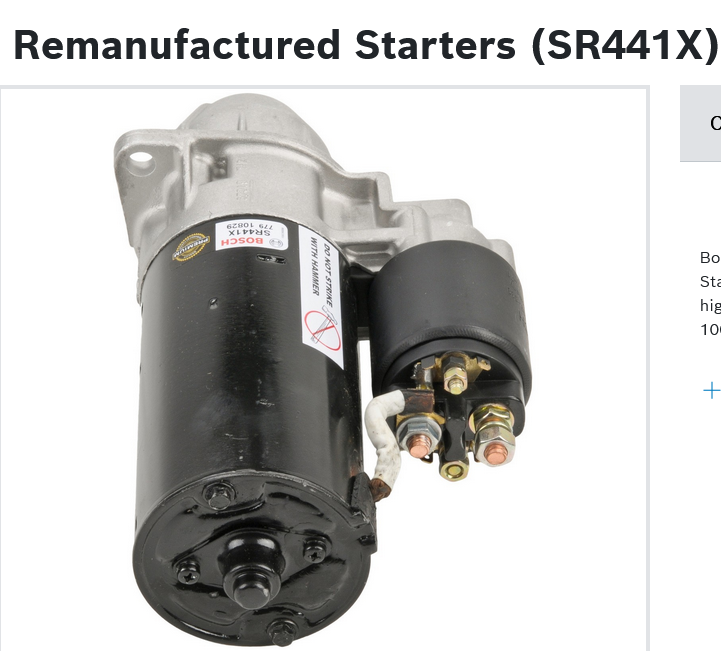

Yes but there is an issue with the SR 441x, Chris knows, I never remember which wire should not be used or constant power will be sent to the resistor and coil.

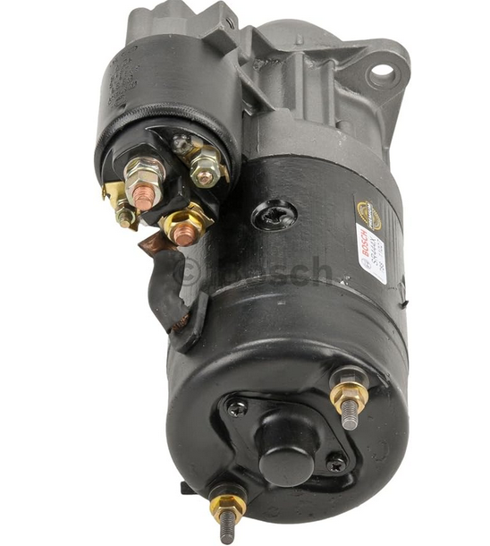

there is also the SR 444x (the one for the 12 cylinder)
here is the 441x
and here is the 444x - its 233 bucks on amazon

The wiring is simple- take the black red wire from the 12 o’clock position and place a secure end cap to it and secure it where it can never touch a ground. Replace the spade connector with a lug connector and you are done.
Never just take the black red wire off and leave it hanging.

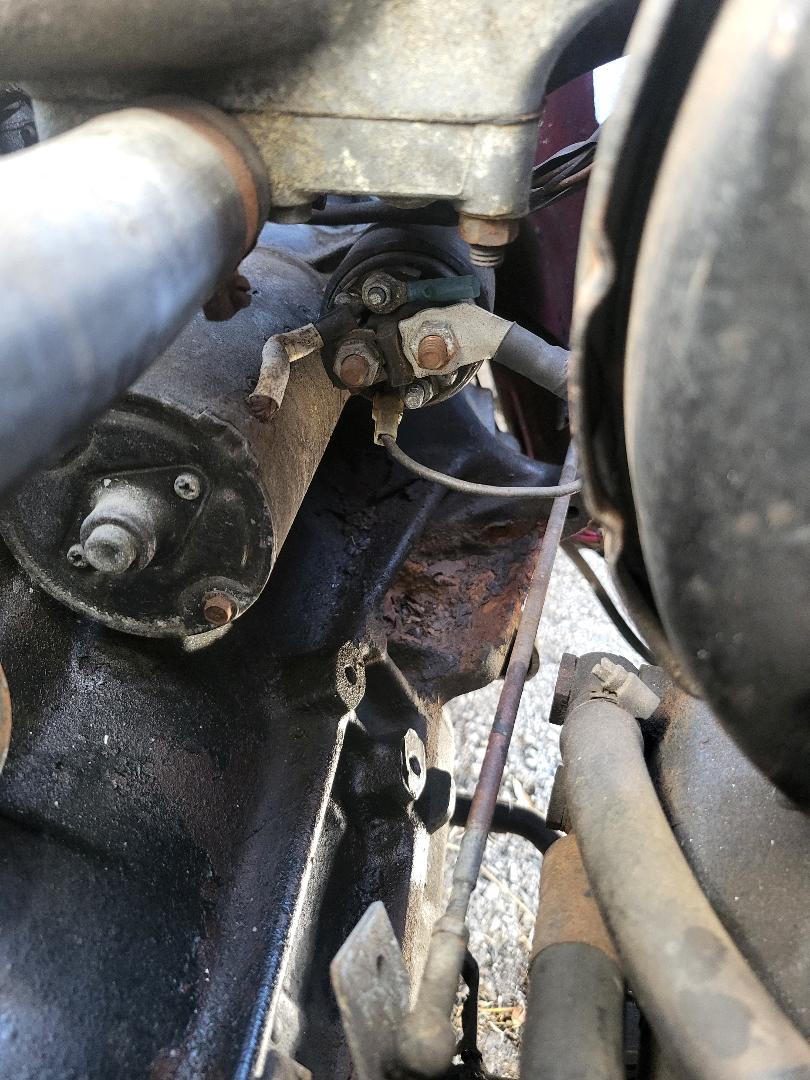

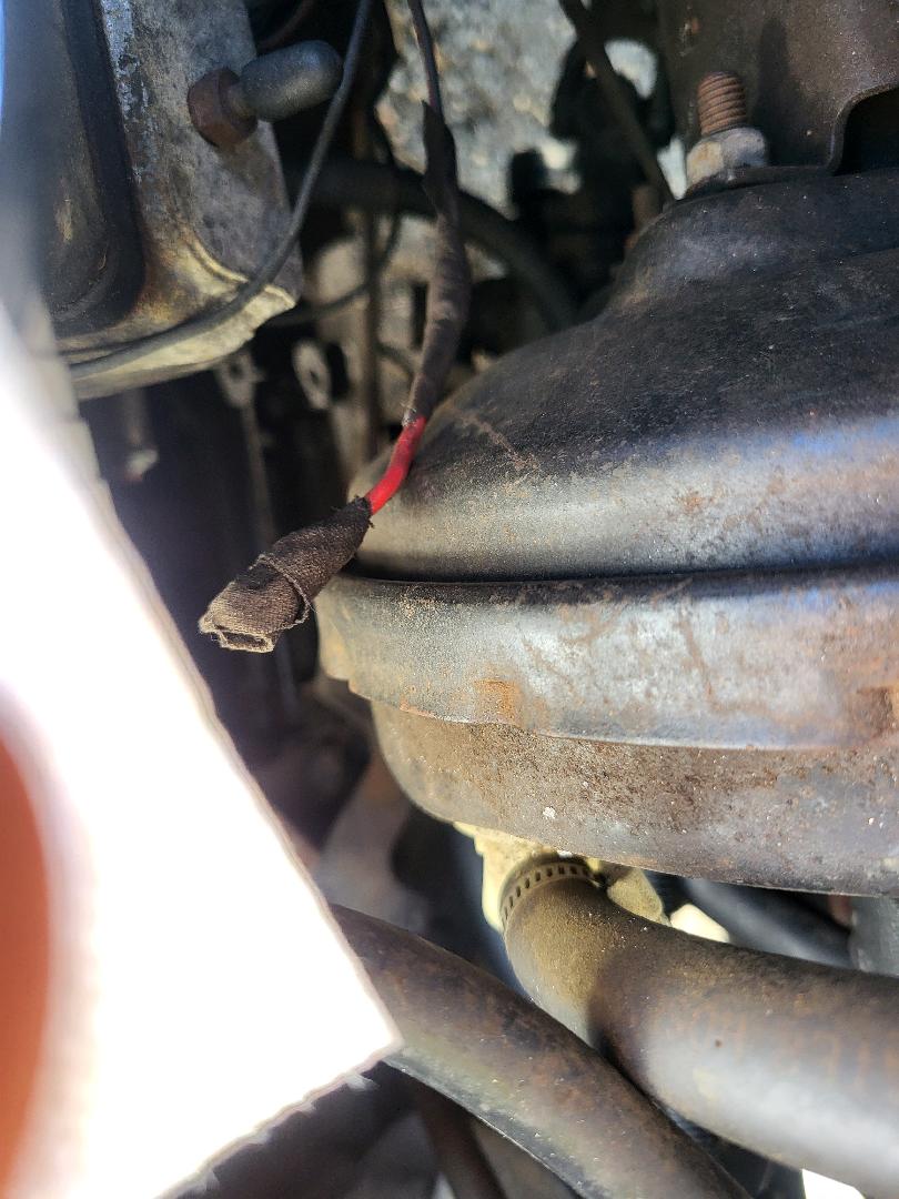

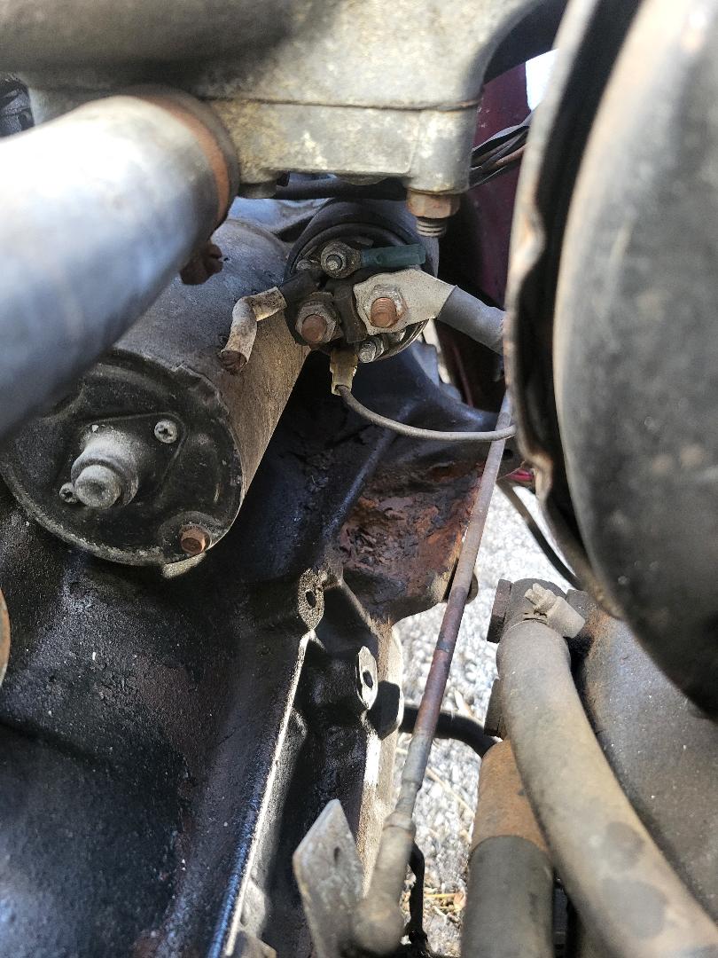

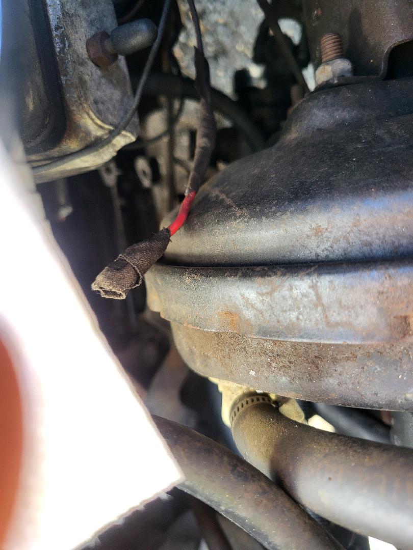

Here are some pictures on how my 71 is wired to the sr441 done many years ago, seems like the red wire is just taped up. This car was switched from an auto to 5 speed many years ago before I got it
"Taping up" a non fused wire that goes directly to your coil and next to your ignition switch and letting it hang in your engine bay is a great idea...
