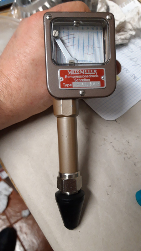

You always take it up a notch, and do it in style! Very cool find. I don't know that I'd use it for testing the compression, but I am jealous from a cool vintage tool perspective. ;)
i was after one of this for a while, now the time has come, i tried yesterday only to see that i can use it in all the spark positions, as number six is very tight fit, but it worked reasonalbly well, alternative it was to buy an accesory tube
i still have some things to do before doing this but i promise to bring here the results
