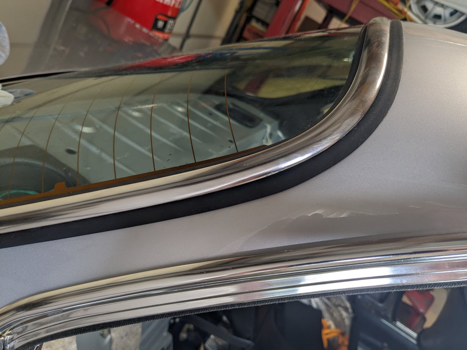

BUT, on the top right hand corner of the rear window the trim is not fully seated in the gasket groove. There is about a 3-4 inch section from the corner down the vertical part of the seal. Unfortunately I did not catch this upon installation.
Yes we tried to put a bit of pressure on the trim hoping it would slide back in, it aint going anywhere. I honestly this the amount of trim not captured has increased with the window just sitting there.

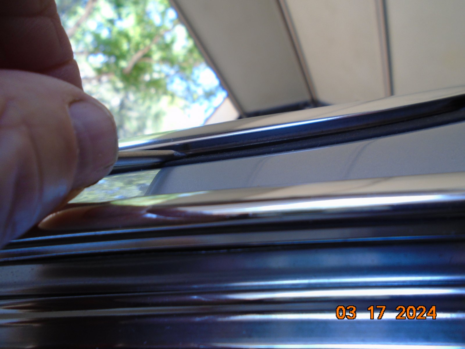

Below is the best photo I could get that if look closely can see on of the locking ribs on the trim surface that fits in the rubber groove. You can see an ice pick pointing at the gap.
There has to be a trick to get this snapped back in. Thinking of getting some soapy water and a fine dentist pick and grapping the rubber lip while pushing in n the trim. But again experience has shown we could make the situation worse.

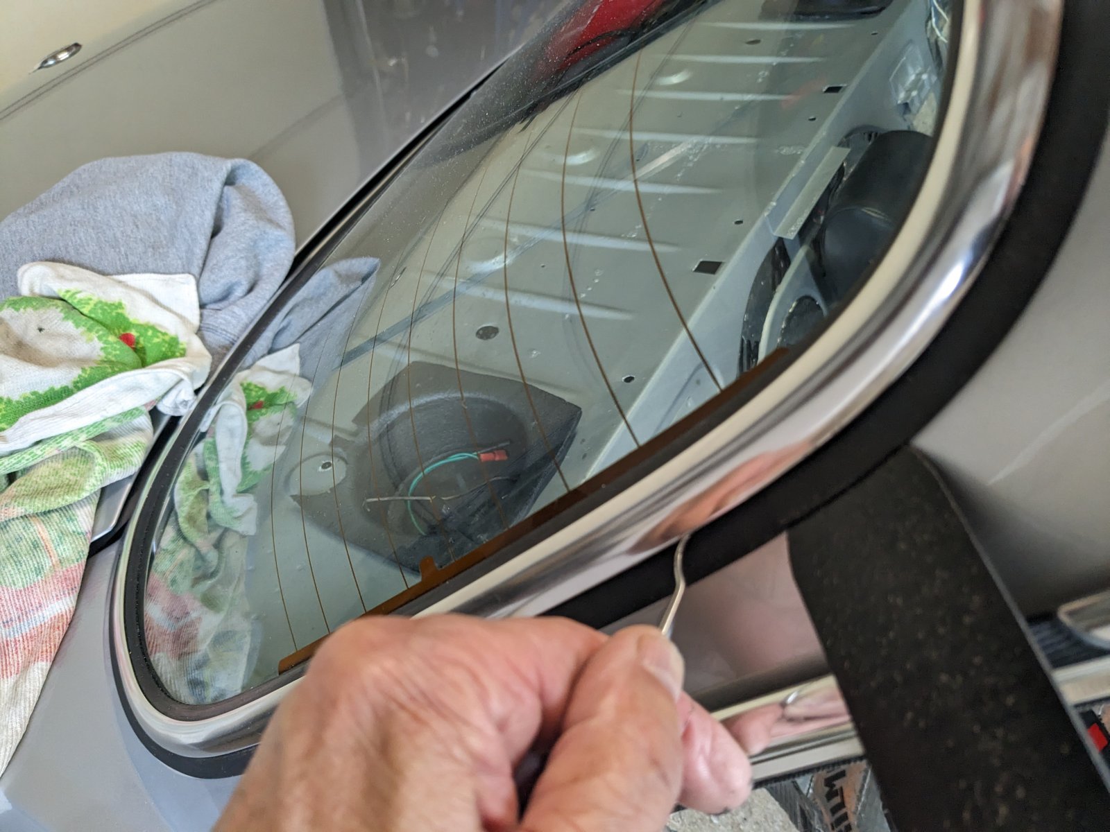

Well, got the section of rear window trim to seat. Used a couple of special tools and soapy water.
However, I'm not sure the section is 100% snapped in as there is a very very small gap still between the trim and the rubber seal, but almost not noticeable. When I say not 100% snapped in, I believe the lip in the L-section of the trim is not totally snapped into the corresponding L-shaped groove in the seal. I do not believe its coming back out. Not sure if the section was larger, this technique would have worked. Maybe when start driving the car, it might completely snap in.
The technique (or more like a lucky trick) was to use a modified dental hook pick and rounding the edge of a plastic wedge typicality use by carpenters.
The area is sprayed with soapy water, the hook tool placed so it catches under the groove in the seal, and the wedge is slipped under the outside lip between the body and the seal. The couple of nicks in the trim I believe were there and not caused by the procedure.
