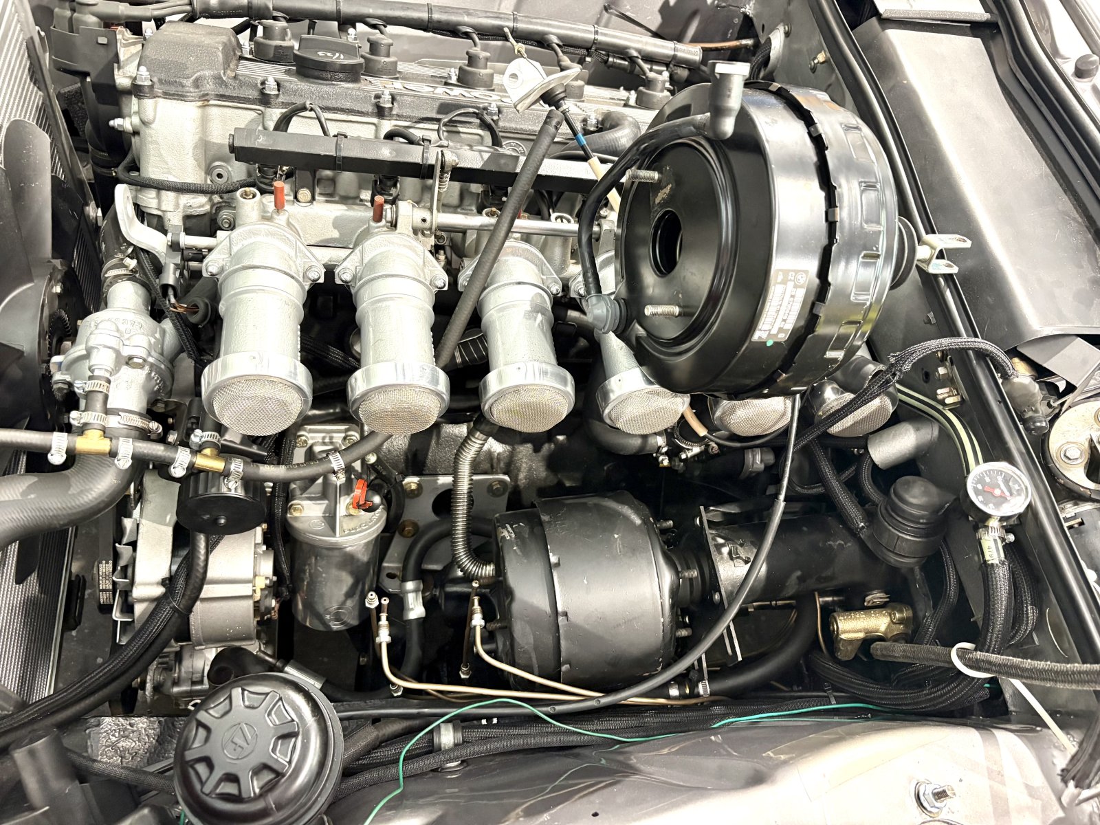

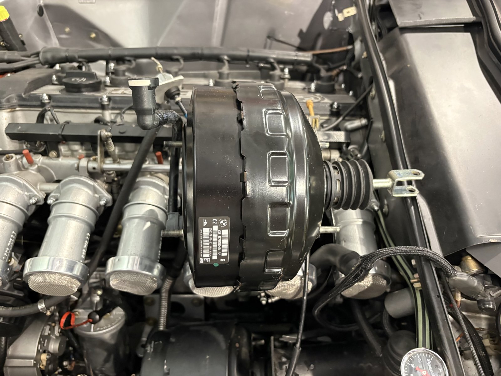

You should attach a picture of what your brake booster. Looks like there were two available. It’s important to find out which one you have in your car.
It is funny that we are all looking for this part.
My brake assist/booster is not functioning. It is the small 7” diameter unit versus a large 10 inch diameter unit. Paragraph

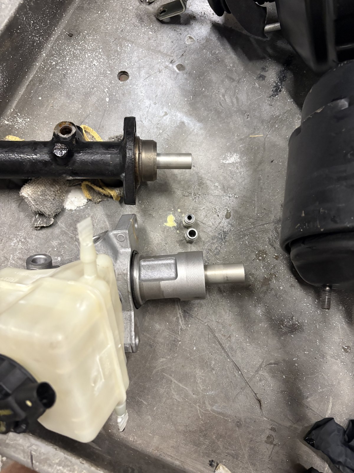

so I talked to a friend of mine that has forgotten more than I know about old BMWs. I have an order a brake booster from a 2007 to 2010 E9X style car.
It was about 85 bucks from eBay
I’ll let you know how the retrofit works.
