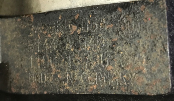

Hey everyone, my name is Vitaliy. I'm new to this forum I picked up that engine burn e9 from copart. Got it home, started slowly tearing the engine down. The engine looks fine everything around it not so really. Obviously somebody already did a FI swap. I'm new to these "older bmws". So I don't know much. I need help identifying what engine I have? I will need to buy the engine wiring harness, injectors, throttle body intake, manifold I think can be saved. In order for me to buy those parts I need to know what swap I have. I found a "3.5" on the block driver side. Also casting number on the cylinder head "1708843". The vin on the block is first line: 34 6K5 06A, second line: 5144 A 049, third line: 1100 1 730 8. I will also upload some pictures as well. Thank you guys!

Anyway I am ignorant about all things B35 and there are some resident experts on this forum. You was most confused about the series of number on your starter plate. I was expecting the last seven of a VIN.

The engine number is 5144 A 049: 5=M30, 144=serial number by month, A=Exchange Engine, 04=April, 9=1989
The engine code is 34 6K5 06A (please double check the 5 I think it needs to be the letter A or B):
The 34 6KA is 535i 85-88, 635CSi or L6, or 735 85-87 all 182hp.
The 34 6KB is 635CSi 88-89, 535i e34 from 1989 and 208hp.
Source: http://www.jaypix.com/files/engine.pdf

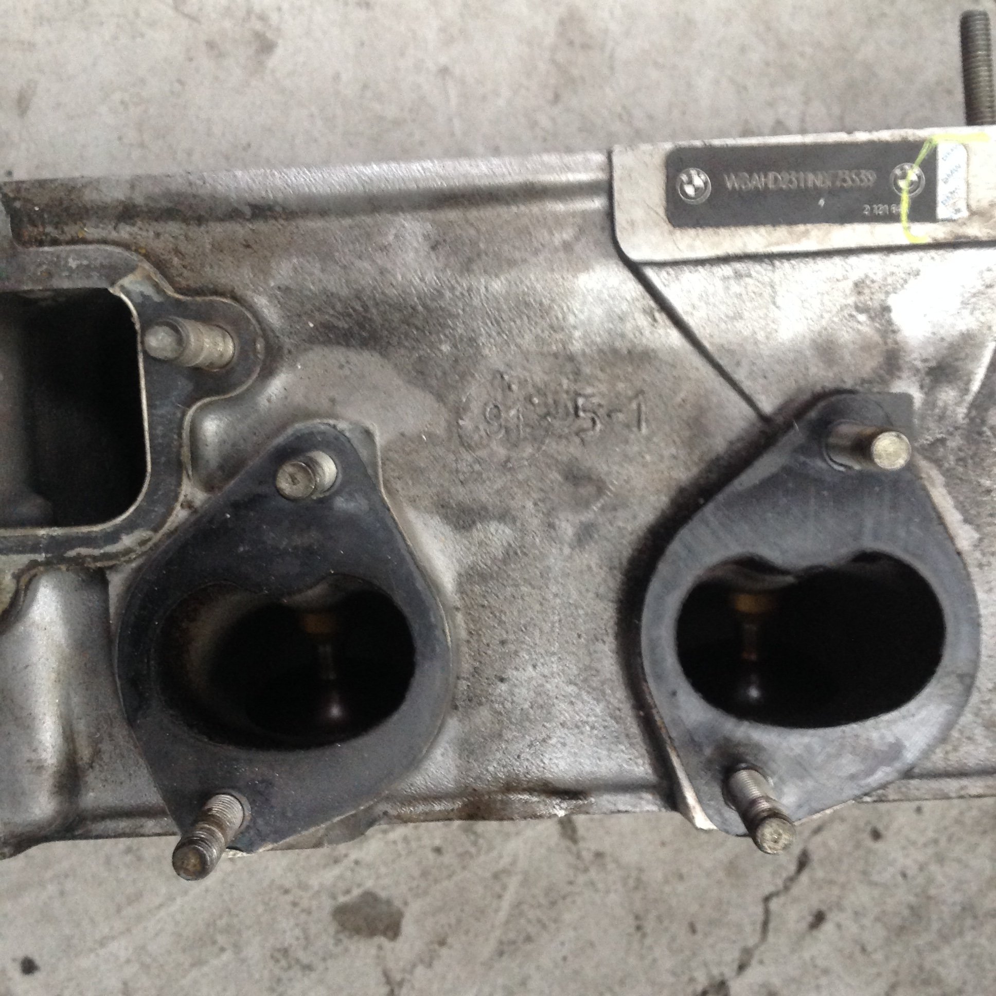

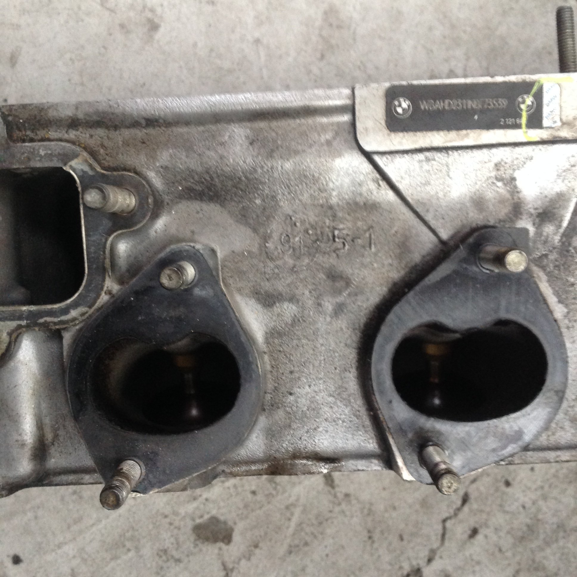

Post a pic here of the intake port of #1 cylinder and the 2 numbers above it
in the circle

Doesn't the "3.5" on the block (see pics above) preclude it from being a B34? Chris mentioned that it should be a "B" and this is for a B35. Vitaly said it was a five. It's a lot easier to confuse a 5 with a B than an A, so I it's probably safe to say it's a "B". The serial, the 3.5, and the Motronic 1.3 all point to a B35 right?
Markos, That is what I was thinking as well. If the vin tag is still on the head that will potentially solve the riddle but my b35 head didn't have it although the cracked one I had did.
Vitaliy's serial above the starter. Honestly that does look like a "5", not a "B". Is it normal to have all this stuff on the ledge above the starter along with a "Made in Germany", with no VIN? I was wondering if it was a factory replacement engine.

Mark, I just looked at that picture it looks like a "B" to me. I'll double check for sure once I get home after work today. It was extremely difficult to read the numbers I had scrape and dry and scrape to see any numbers appear lol.
That makes sense, and uppercase "B". I'm starting to sound like the Windex grandfather from "My big Fat Greek Wedding", but hit it with WD-40 and a scotch brite pad. It will clean up perfectly. Snap a pic before any rust reappears.
Yeah, Chris -- my conclusion doesn't make sense. This guide does not have any M30 b35 designations.
