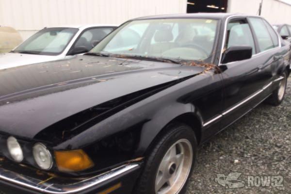

check row52 for an engine in Fairfield, an engine in Salinas, Newark, Windsor etc.
Here's one that just came out in Rocklin - B35 with a 5-speed and the right holes for motor mounts.
I have one, I’m in Monterey. I wish I had seen this sooner since I was in San Francisco today.
