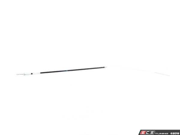

  2. new cable set for eBrake. Per my shop, they said they couldn't source it.

Handbrake cables may be hard to find
