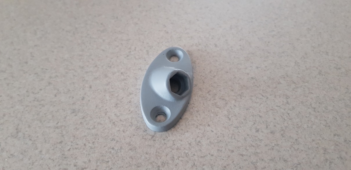

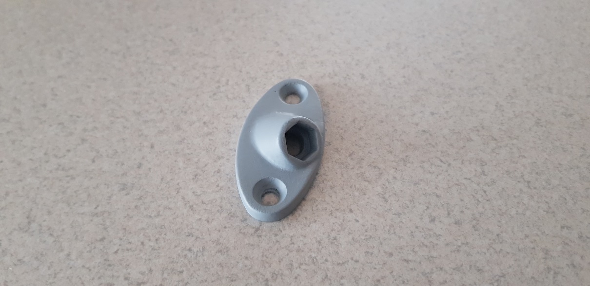

The only problem is that parts from 3nsahalee photo will not fit straight e9 bolts, that have hex shape in place where metal part go into plastic.
One of mine was also broken, so new one was made with core.
The metal hex pieces are still embedded into mine. I built-up a layer of Steve-o's Secret Sauce at the top a bit to better secure it so they’re now a tad more rounded at the hole. The original rods fit and work perfectly.
The metal hex pieces are still embedded into mine. I built-up the bonder at the top a bit to better secure it so they’re now a tad more rounded at the hole. The original rods fit and work perfectly.
Sorry, but i still don't understand that - how you made it, if the top/outer part of the genuine e9 bracket is the insert point of the hex?
Take a look at my e9 sunvisor.
the hex 'socket' and the rod are separate pieces. the rod is intended to spin freely in the socket with it's slightly tapered section and the sockets appear to have had some old factory adhesive to help keep em in the plastic’s hole, and that had deteriorated on a few of mine too. Once they break free, they’re toast. my thought/theory after inspection of the several broken units that i have is that when corrosion sets into the socket and arm, it becomes too resistant to the constant torque and gravity forces. this is also a very thin wall of plastic at the top originally-- actually the bottom as they mount the other direction (where a lot of the load goes).
I 'buttered' a nice layer of Steve-o's Secret Soda Sauce over the top of the hex-socket to reinforce this area. So, in essence, Wladek, i could lightly flat-file the area around the entrance of the socket hole to expose the metal hex and achieve the exact same look as original but feel that i've greatly improved it's structural integrity with a more 'finished and refined' appearance as well.
i can foretell of yours slipping in there and getting buggered-up in due time and looks like it already has cracks developing. i would recommend you employing Steve-o's Secret Soda Sauce to improve them. With what i've learned from this exercise; get small paintbrush and get some water in between the metal and the plastic, work some soda into the hex crevices and then inject the super glue, wait a few minutes and lightly sand if needed --- that'll secure the heck out of it for sure.
