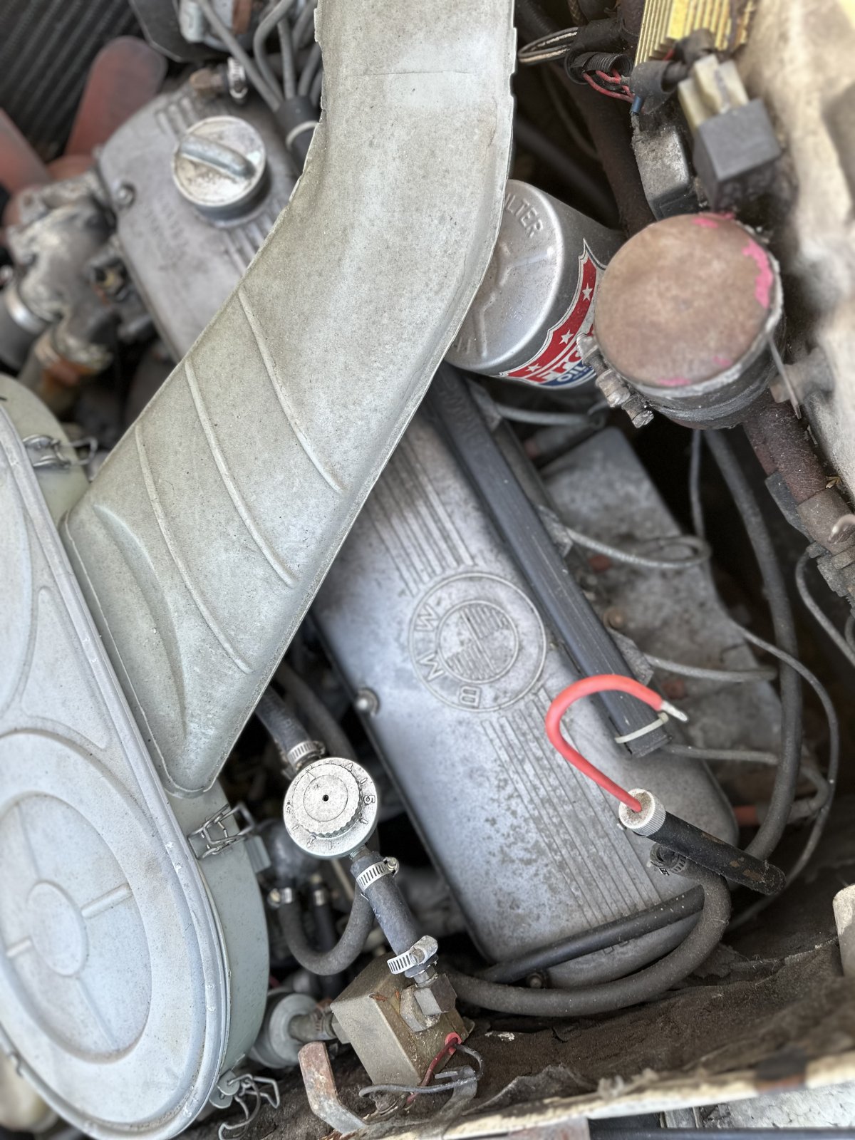

I'm new here! I have been a member for about 6 months and just got my car off a transport today! I won it off Ebay on Christmas eve! The cars history is from CA and I believe it was in CA until a year ago, I was able to check with the CA dmv and it was on a Non op since 8 years ago, then it was purchased by a collector in NJ. Who I got it from.. Curious if anyone knows this car? It has some funny wiring all around the engine bay, random switches in the dash, seems like it had an upgraded ignition, fuel pump. Kind of quirky but what do you expect for a 50 year old car! Vin Number- 2250466

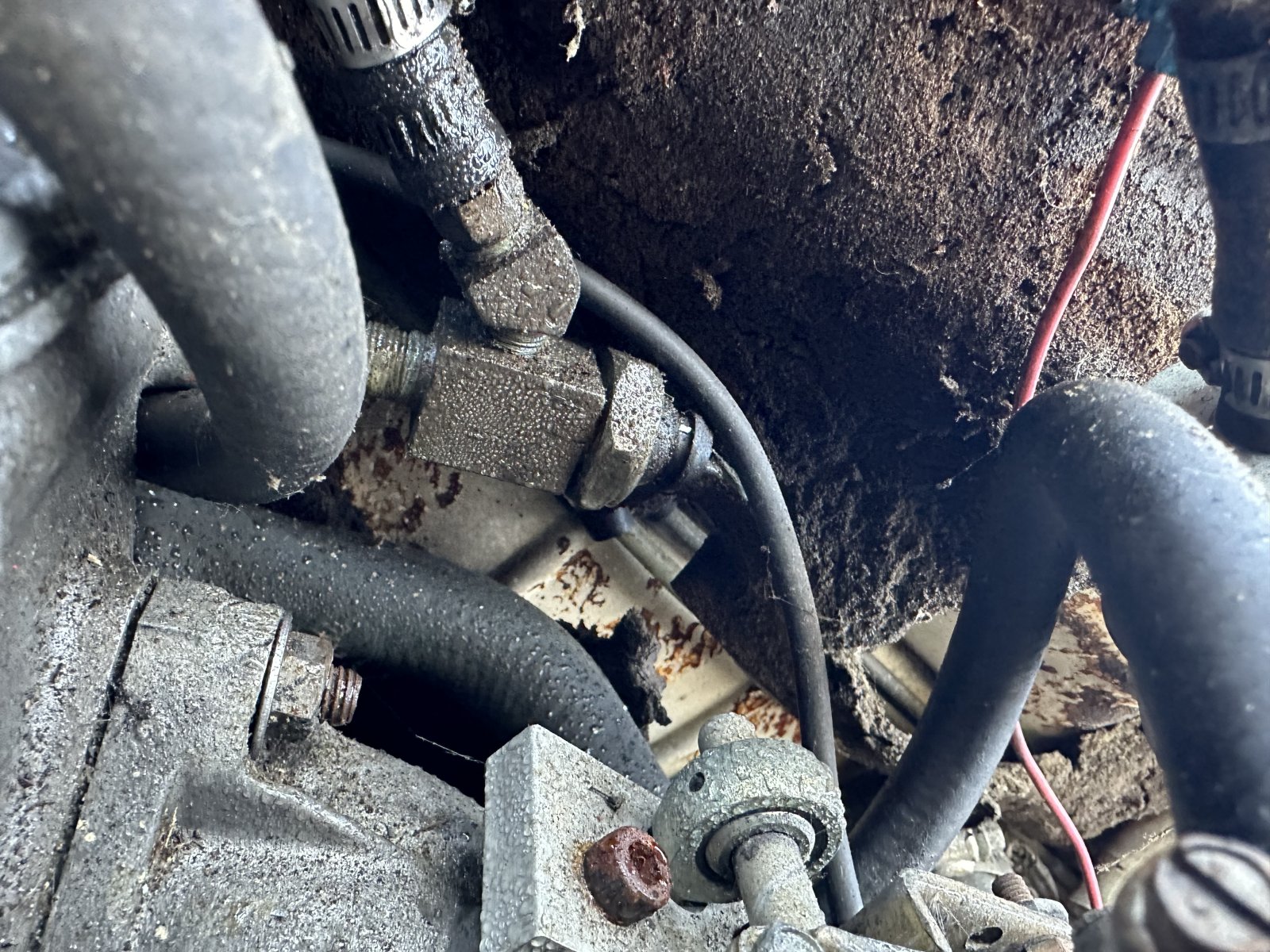

That device against the firewall is installed in between a fuel filter and a fuel pressure regulator. Could that be some sort of fuel pressure sender? Do you have a fuel pressure gauge inside the car?

I think that's right. I'm a fan of the pierburg pump, which doesn't require a regulator because its a better match for the carbs. https://e9coupe.com/forum/threads/adding-a-electric-fuel-pump-suggestions.42221/post-369474

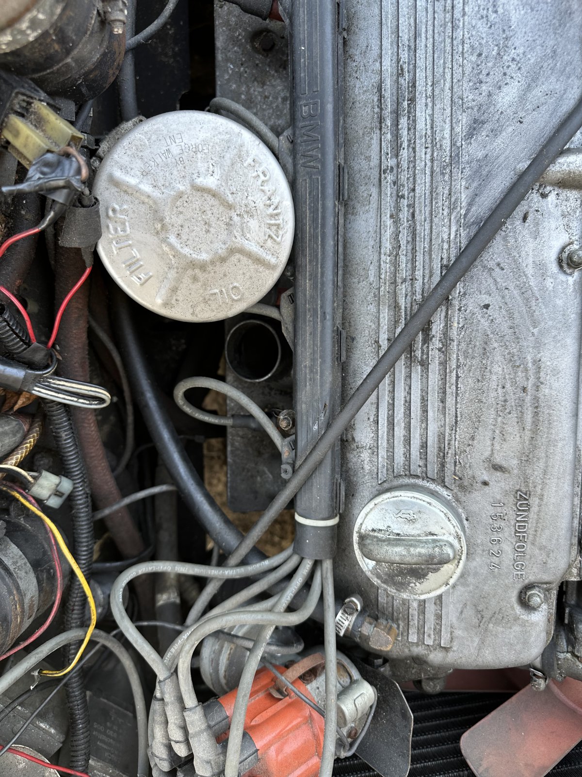

Welcome to the forum, we won't be able to go about our day until we know more about why an oil filter cannister is over by the a/c damper!
You know I am wondering the same thing, there is one in the original spot as well.. I am really confused. I am going to take more photos today to show what is going on.
Looks like it's an extra external oil filter that runs off the valve cover over to the back of the head with some sort of oil pressure sensor? There's no wires plugged in to so I am not sure.
