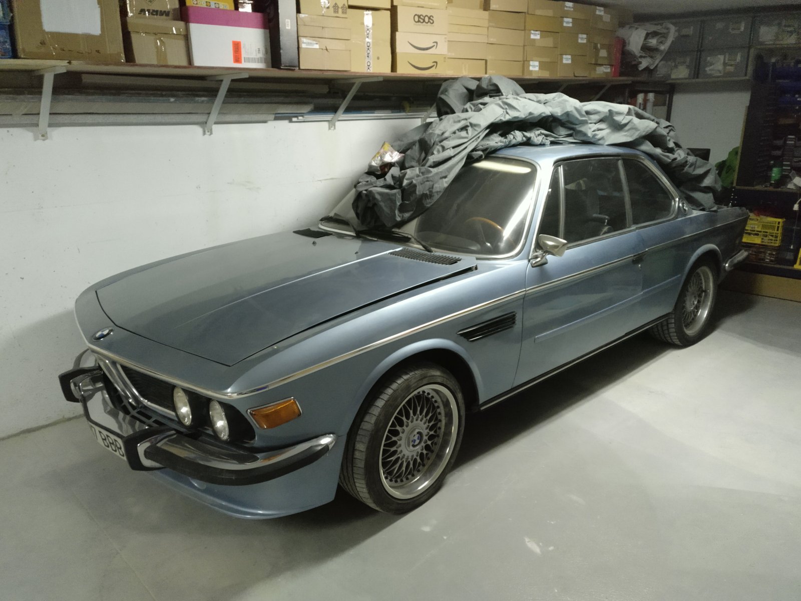

Hello to all, I'm Andreu from Spain. Since 2008 I'm the proud owner of a 3.0 CSI. I Know your forum since long time ago and It,s very interesting, with a los of information and good people plesed to help.
Now I have a fuel leakage from t'he fuel pump and wanted yo make some questions, but I thing that t'he first step was introduce myself.
Thank tour to everyone anys best retards. I Hope to read you soon. bmw.jpgIMG_20210122_160723_770.jpg
