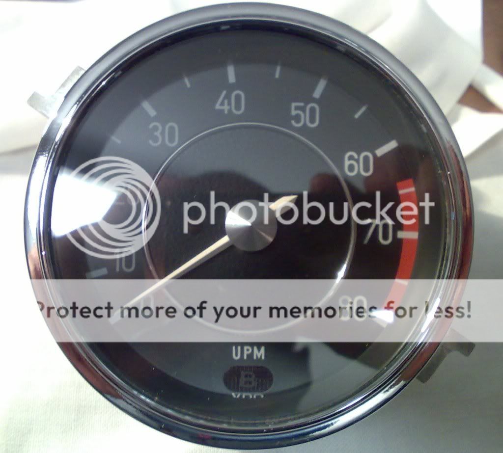

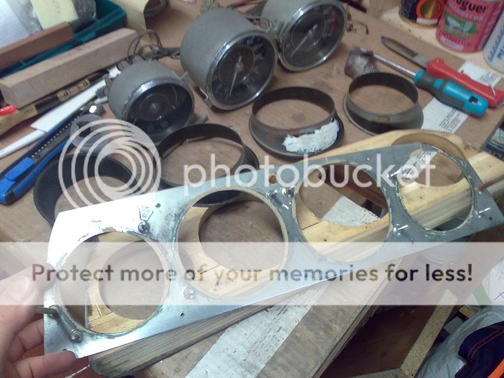

yeah, an old brand new intrument panel with all the clocks, dated 1974, ready for inspection and renewal

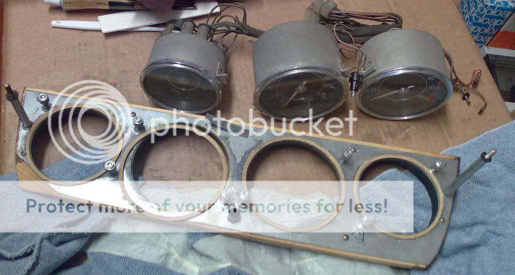

after undoing the screws, use a pocket knife to remove the metal plate

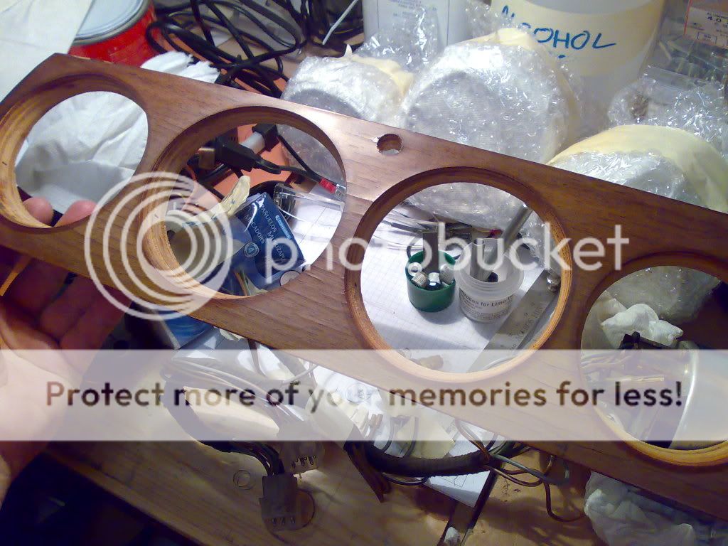

i have to renew the wood "plaque", but that implies also the renewal of all the wood in the car, and that is too much for the moment, so i will just glue some of the loose corners and polish it carefully
sand paper and rust converter
rust converter again

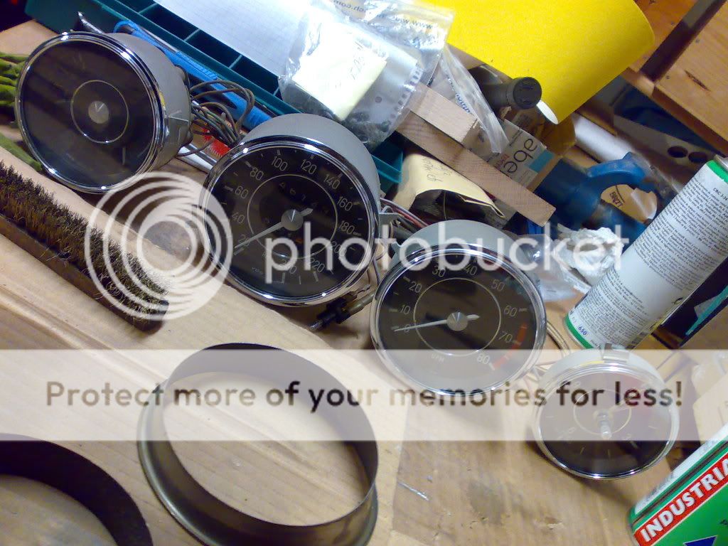

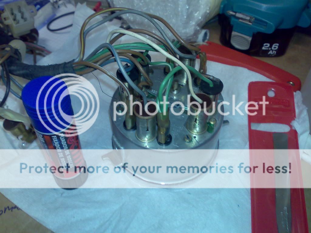

test clocks, conexions, etc, clean, brush,...
now a small problem, the info-clock was dirty inside, but to open it was almost impossible and certainly impossible to close it in a good way, so i thought of dissasembling one of the gauges (the two screws were very tough cause thread seal is present, so perpendicular screwdriver and strong push against the screw and turn anticlockwise, and, that´s it !)
then, through that open hole, a soft stick wrapped in a paper tisue (wet with alcohol) is introduced and the glass is turned resembling an old vinyl disc with its needle, but in this case what we have is a "cleaning needle"
three or more times for a good finishing

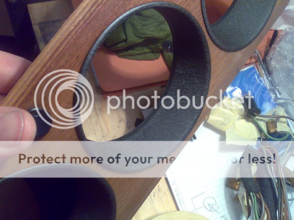

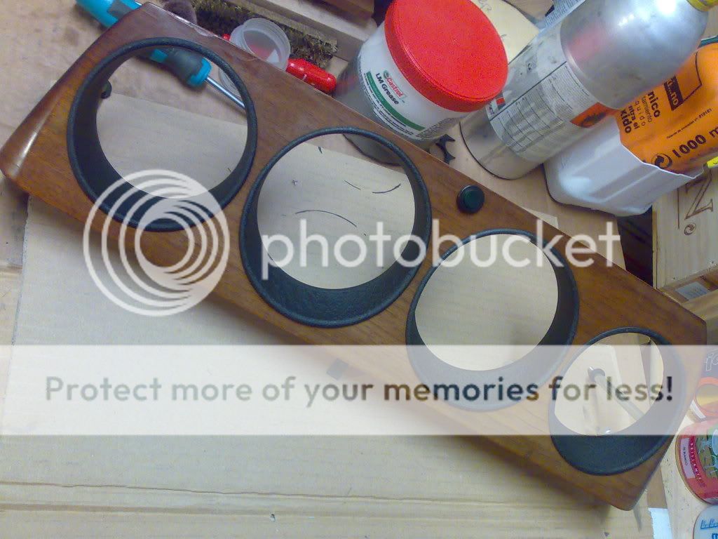

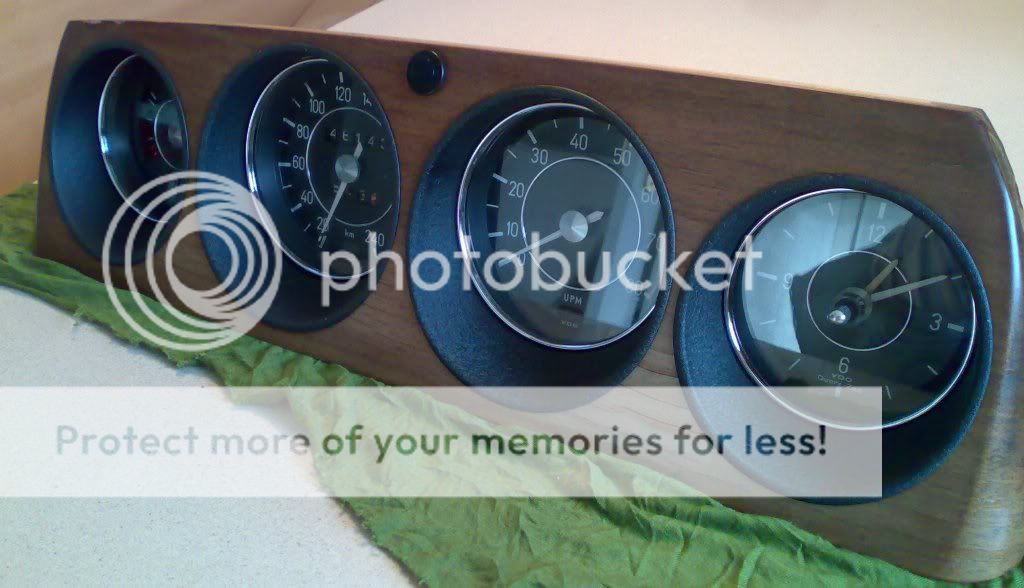

repair of losen fragments of wood with glue and pressure
repaint of the black cilynders, only one shot, to avoid losing the pattern
detail

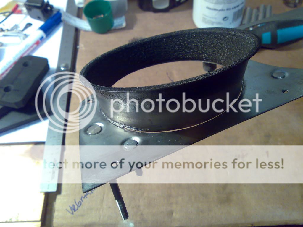

also painting the sheet metal to avoid corrosion
useful tool for making gaskets

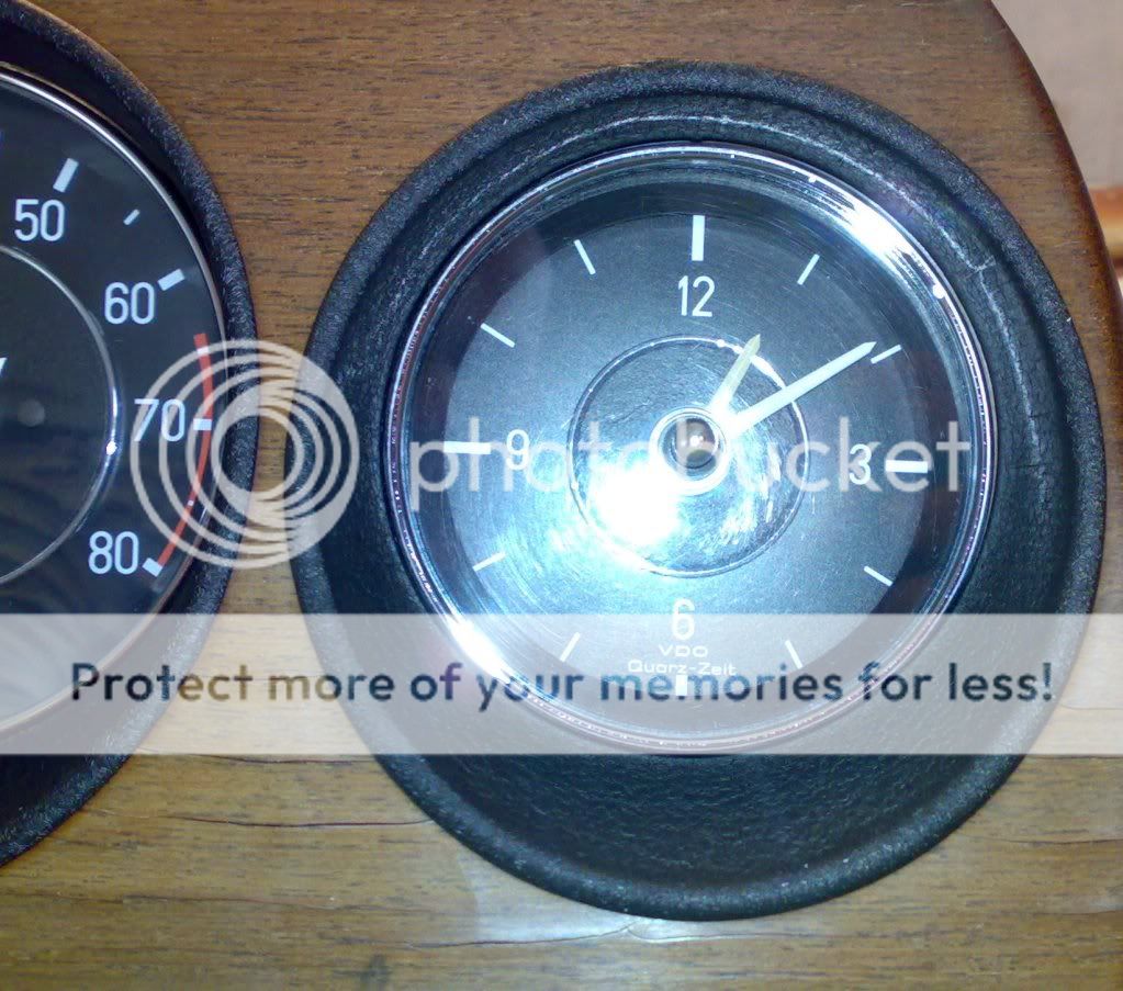

assembly of the black cilinder covers in the cleaned wood panel

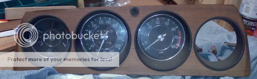

final aspect, yeah there are some cracks, but: this never meant to be a
new car, but a classic car!:-D

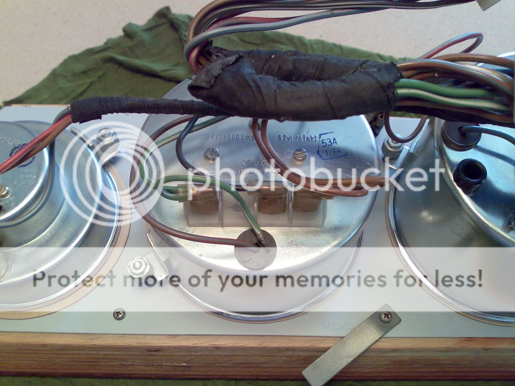

reassemble the temp gauge device, using special glue for threads of the 2 tiny screws

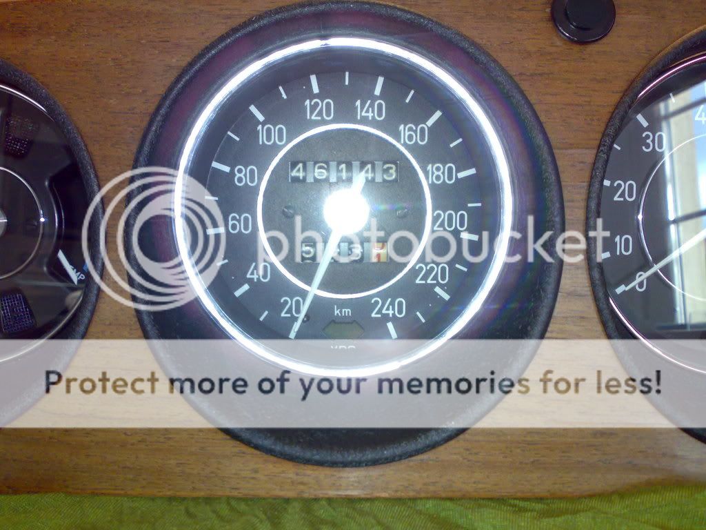

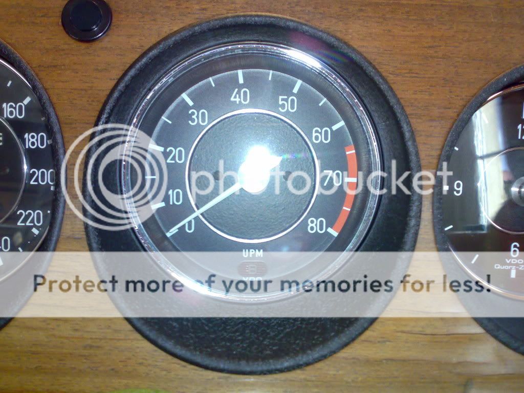

incidentally here you can see the aspect of the clean glass (inside cleaning process with alcohol 96º)
ok, it is not perfect (not for concourse :mrgreen:), but in the next pic you can remember the previos status, and taking that into account, ... it is not that bad, isn´t it ?
a final detail, the gaskets between clocks and sheet metal were damaged in the dissassembly process, due to the age the old gaskets remained sticked to the metal so i had to cut them off with a knife, so new ones had to be made, here the useful tool for it, perfect geometry !
old ones up in the following picture, new ones in the bottom
assembly pending, ...see you later !
