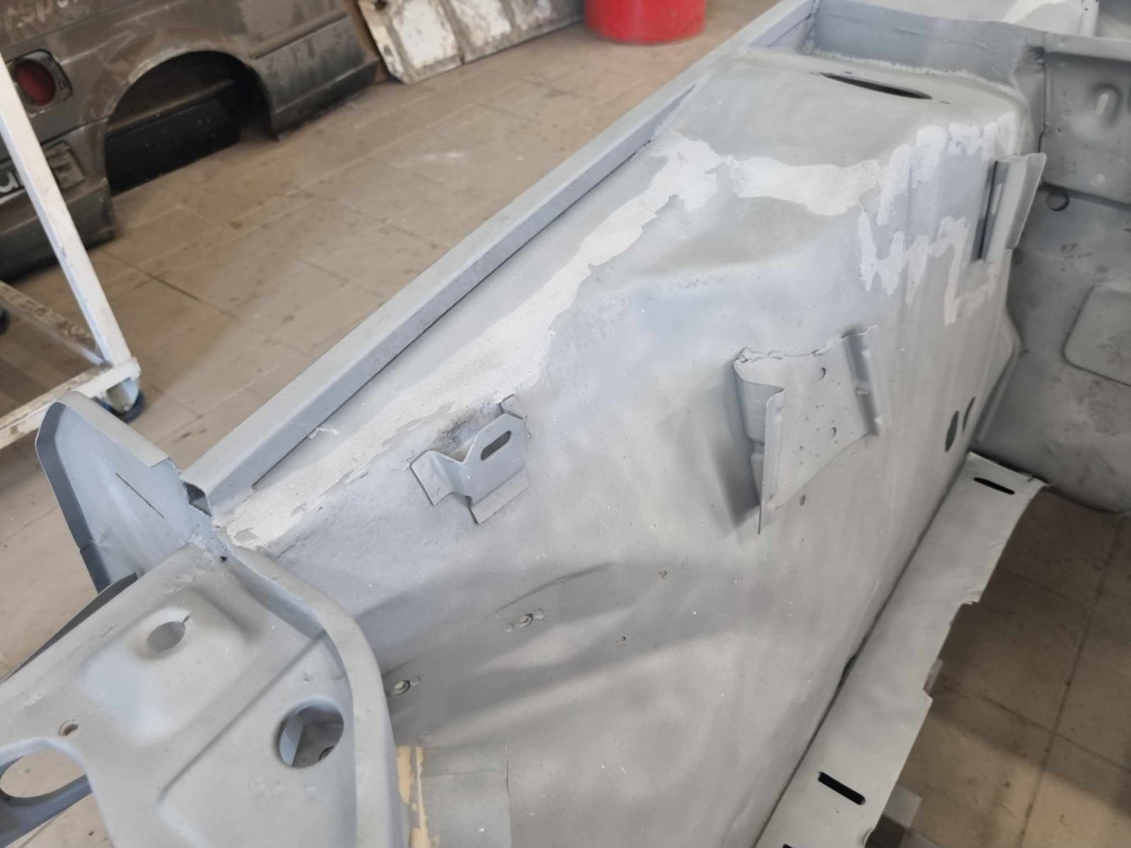

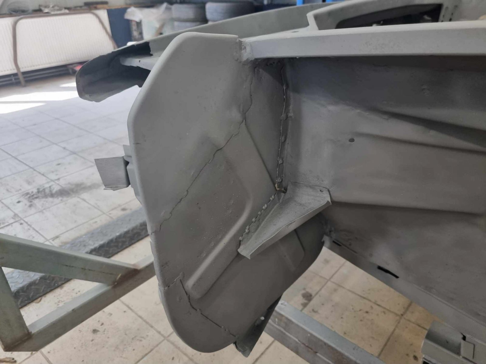

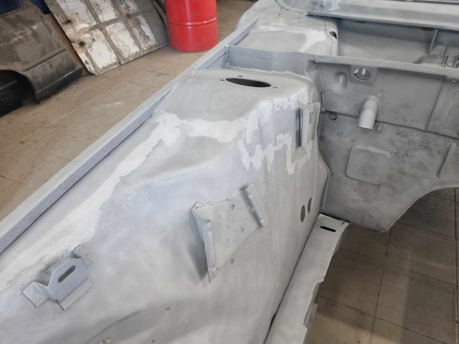

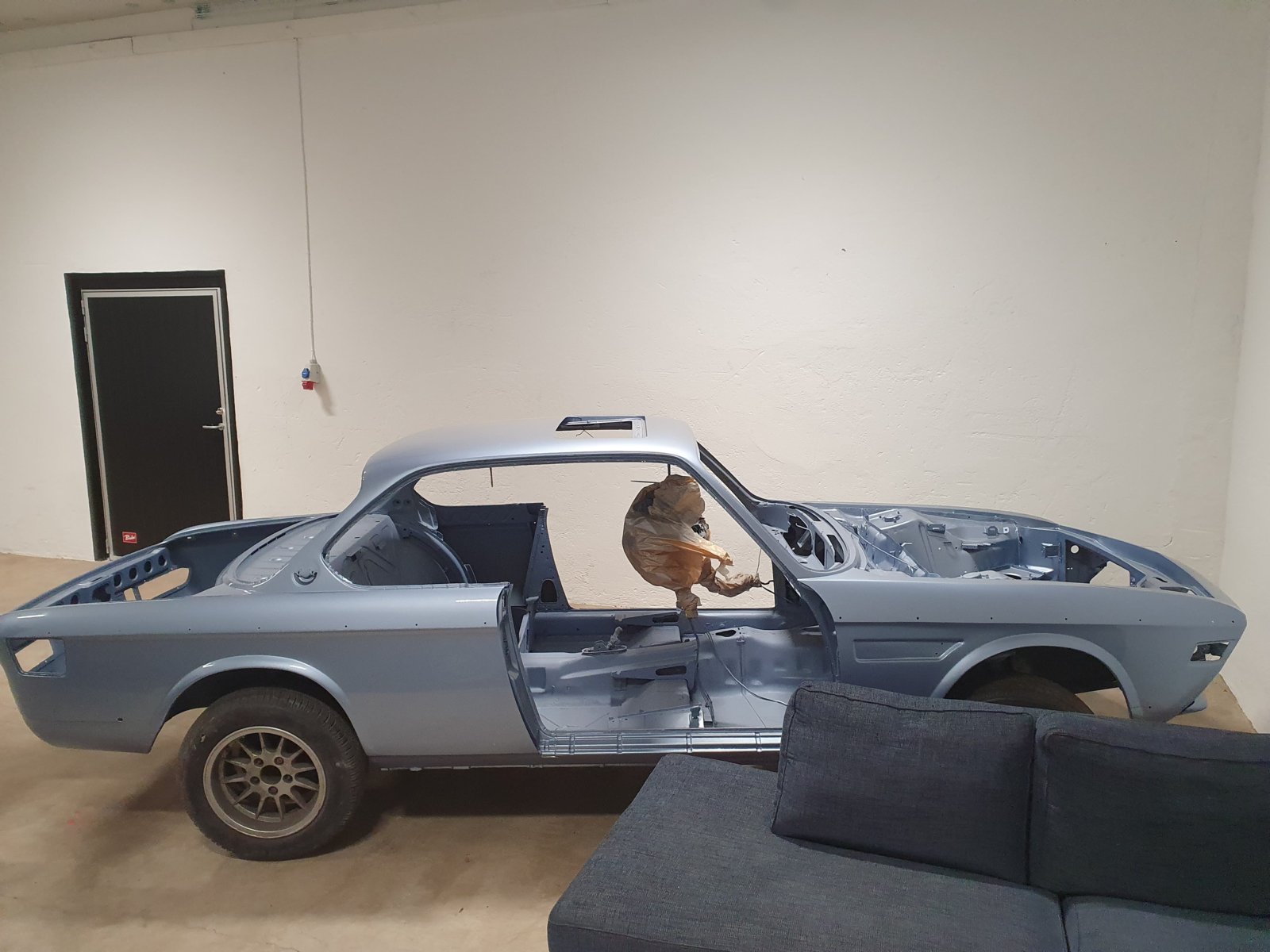

The Taiga had just been "renovated" and was freshly painted as Fjord but will go bare metal again, bad welds and patches fixed and be repainted as Taiga. It looks like it is mostly rust free but Miklos will take it apart as per usual and check everything. Should be a fairly simple project. It will remain as stock as possible, I may swap to leather on the seats, add an A/C if I find an original one and go for Webers. Tan interior would be nice but it is not stock so I don't know, thoughts?

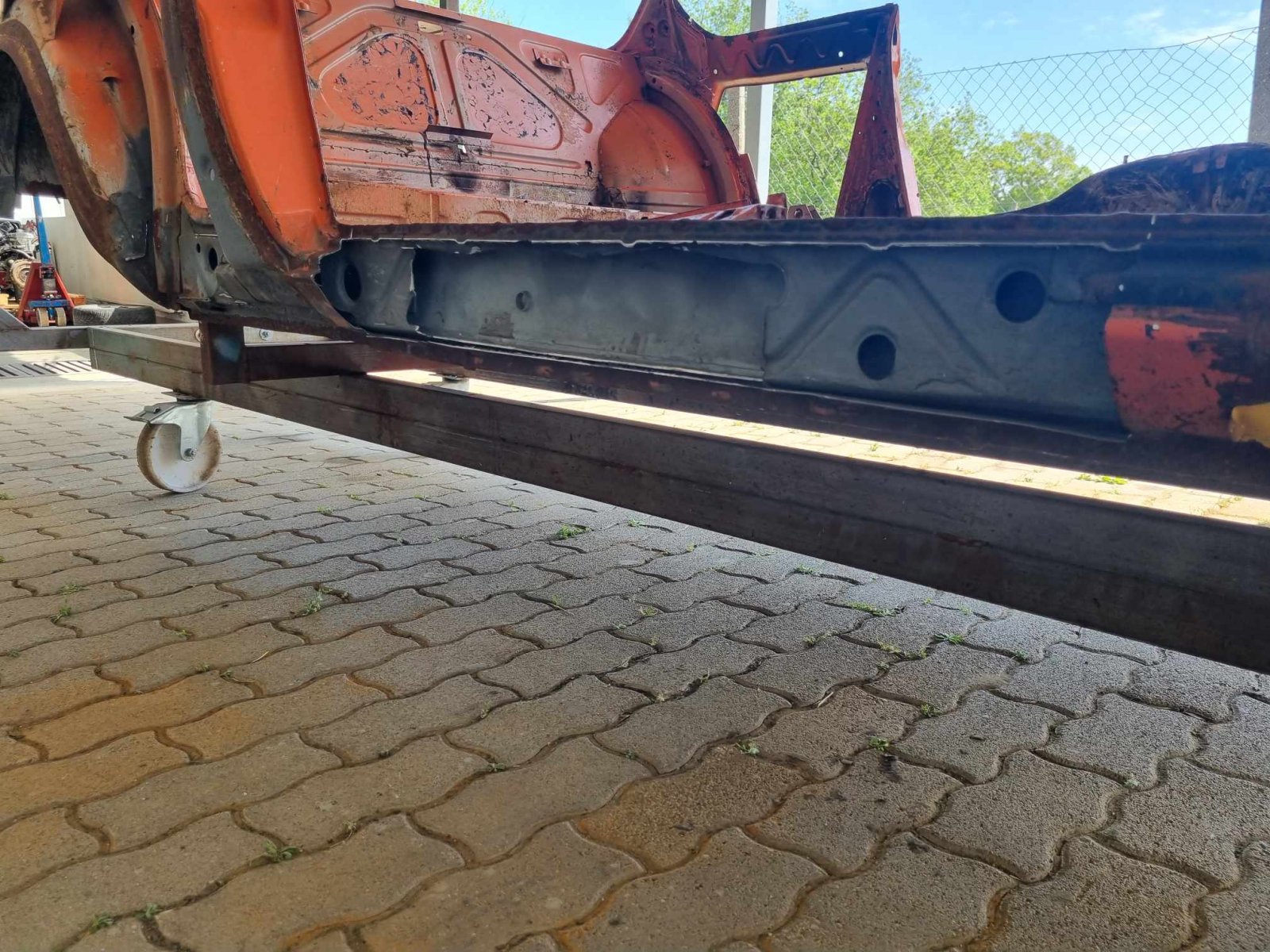

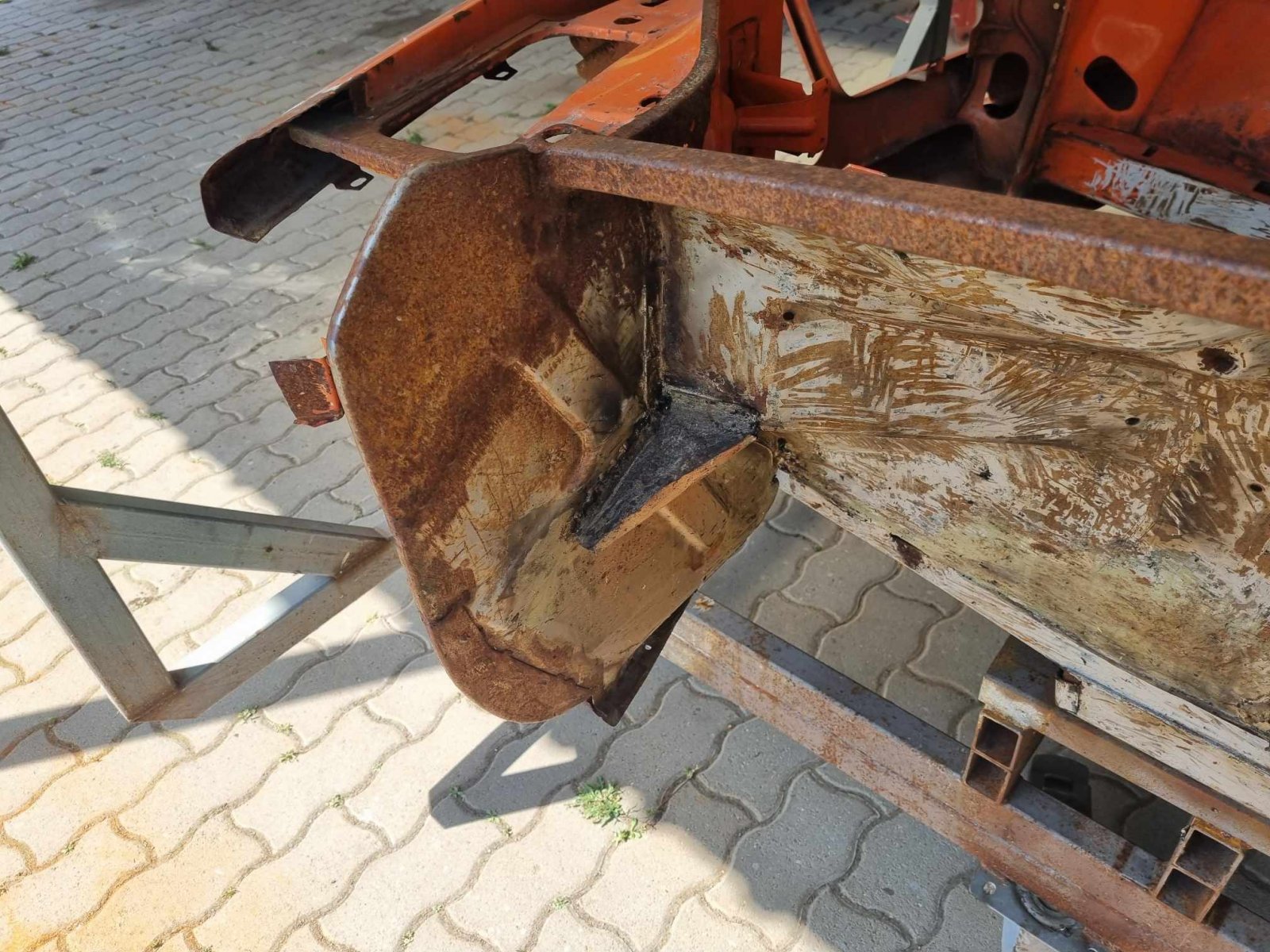

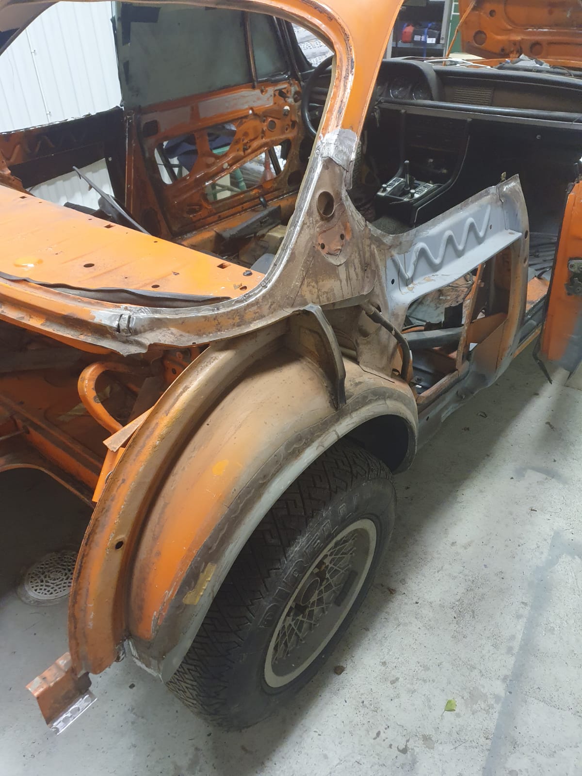

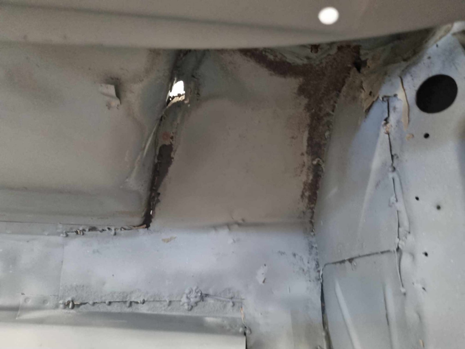

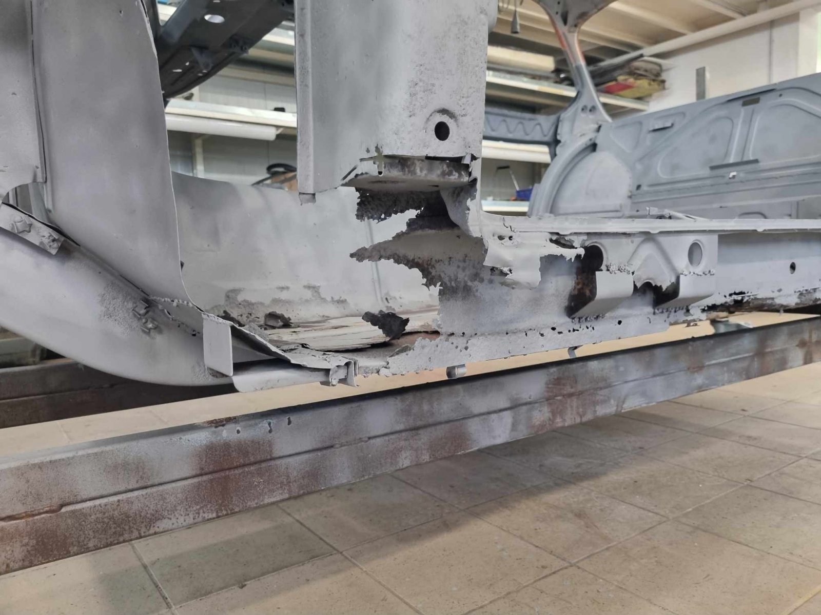

The Inka is another thing, quite a bit of rust, more than I'd like but it also comes with a lot of new panels (visible in pictures) from W&N which compensates quite a bit for it. A bunch of work has been done, just need to see how good it is, looks OK in pictures but... It comes with a nice looking 3.5L engine, supposedly restored 10-15 years ago and not driven, plus a spare engine from a 3.0SA. Seats are pre-1974, i.e. vertical but I'll redo them in leather and correctly horizontal instead. Apart from that It will be as stock as possible.
Both cars are supposedly complete, is a bit hard to judge when in this state but I hope nothing difficult is missing.
I don't know much more about the cars. have asked previous owners to write down what they know. I will of course add to registry.
Pictures below, enjoy.

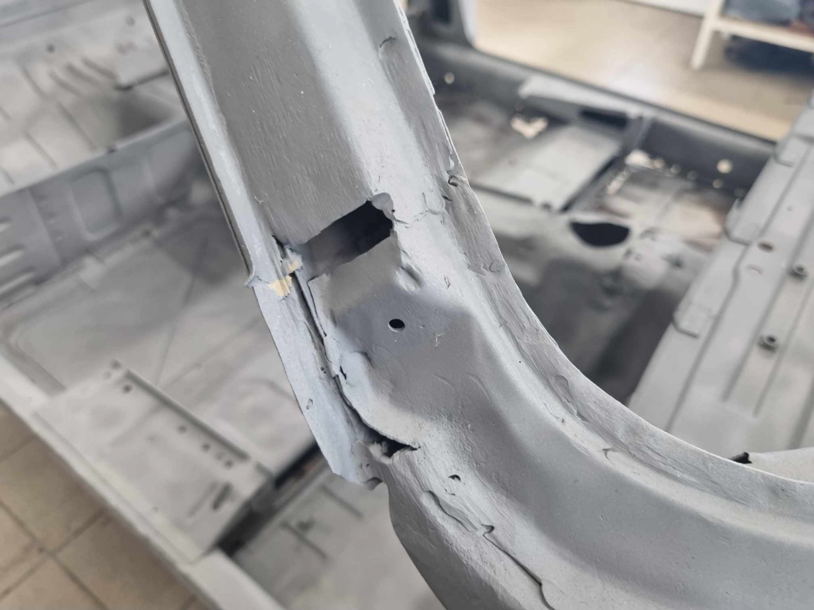

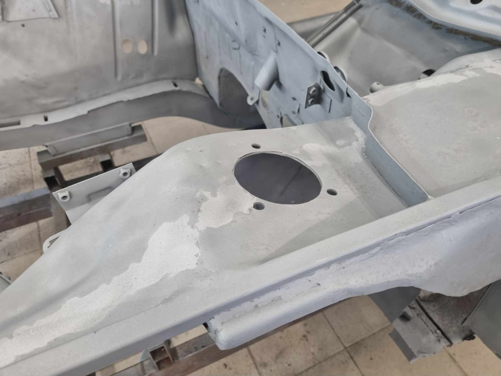

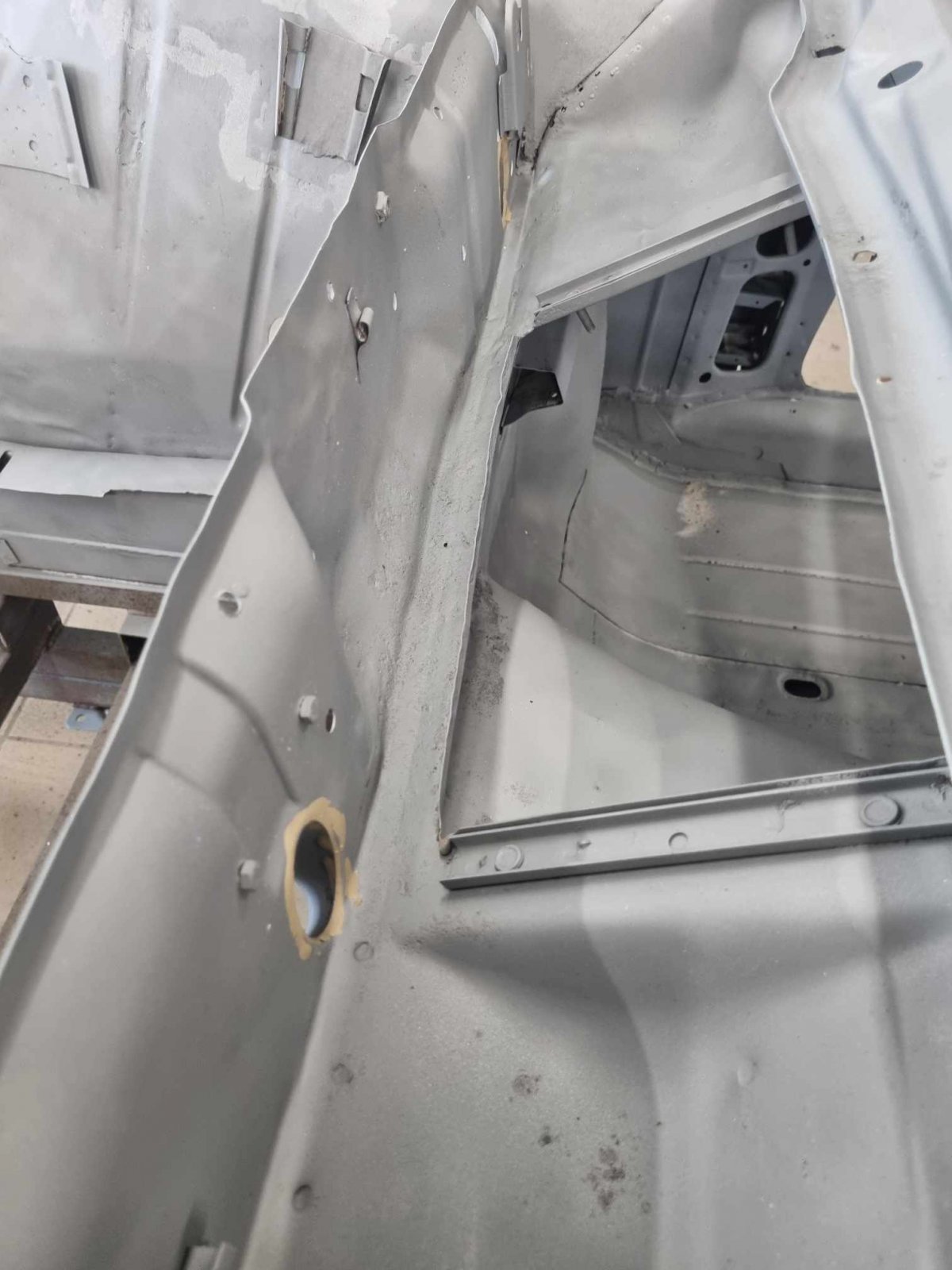

Pics of the Taiga, not much to say, you can see where we need to fix poor patching/welding.

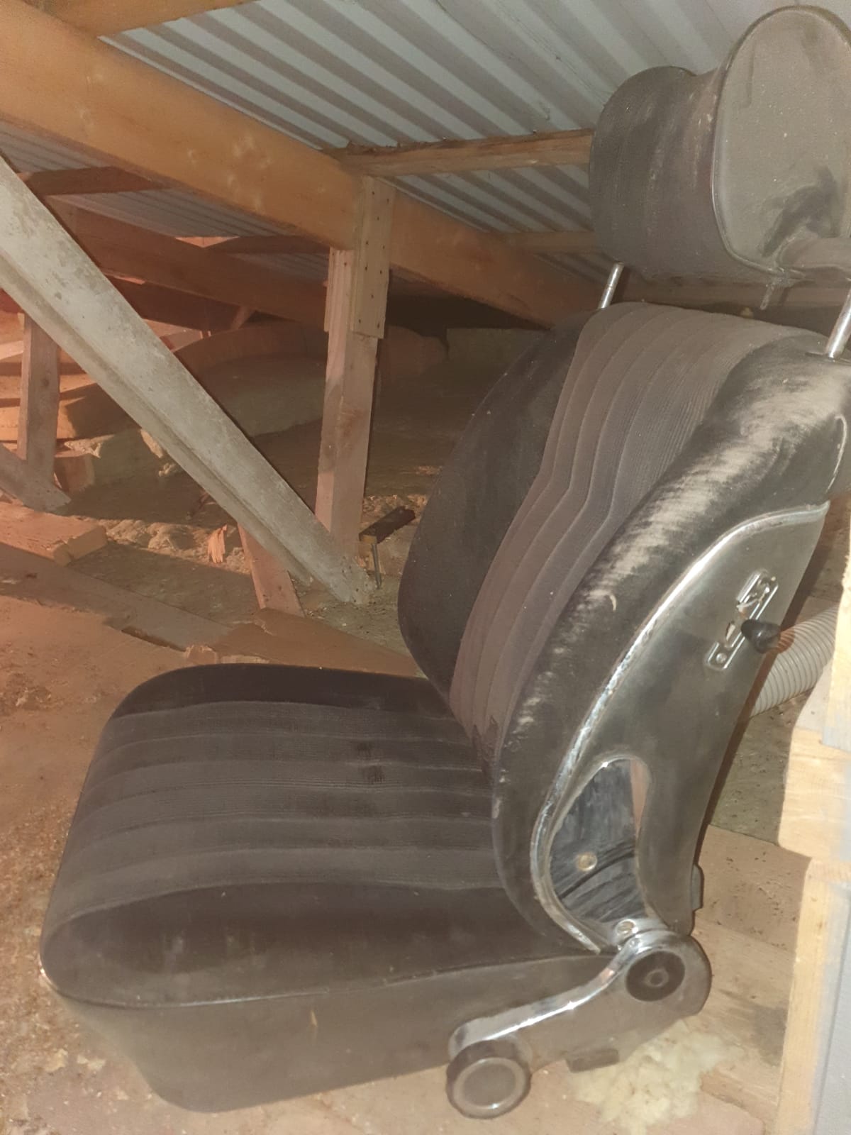

Chairs done for the Inka. No work has been done on the car yet but this is one step forwards.
For me they look good in the pictures and I am assuming things will change a little over the next few months as the material settles. But I am no expert on this....
These were made by a member here in collaboration with a guy who does interiors. They are using my pre- and post facelift chairs as templates and are planning on supplying them to people with projects like mine. I did not see them in person but they will be sent to Miklos now and I'll get his thought on them.

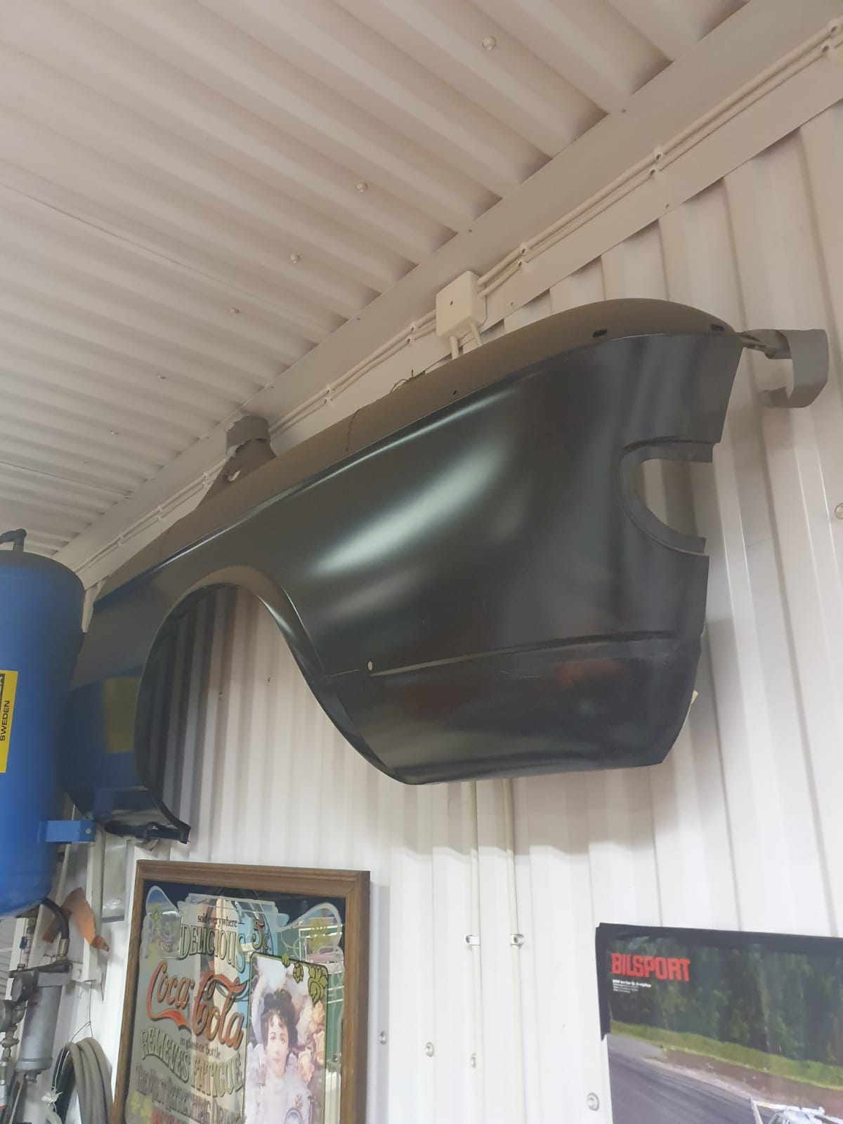

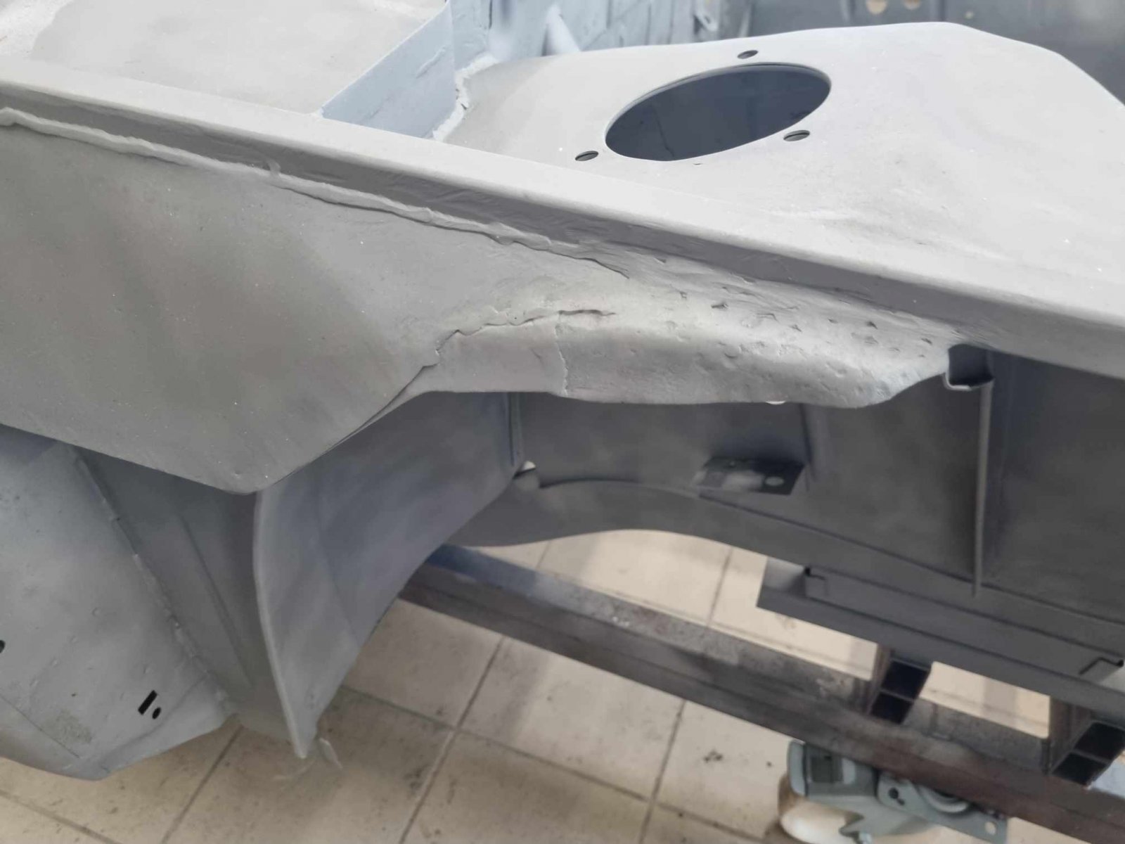

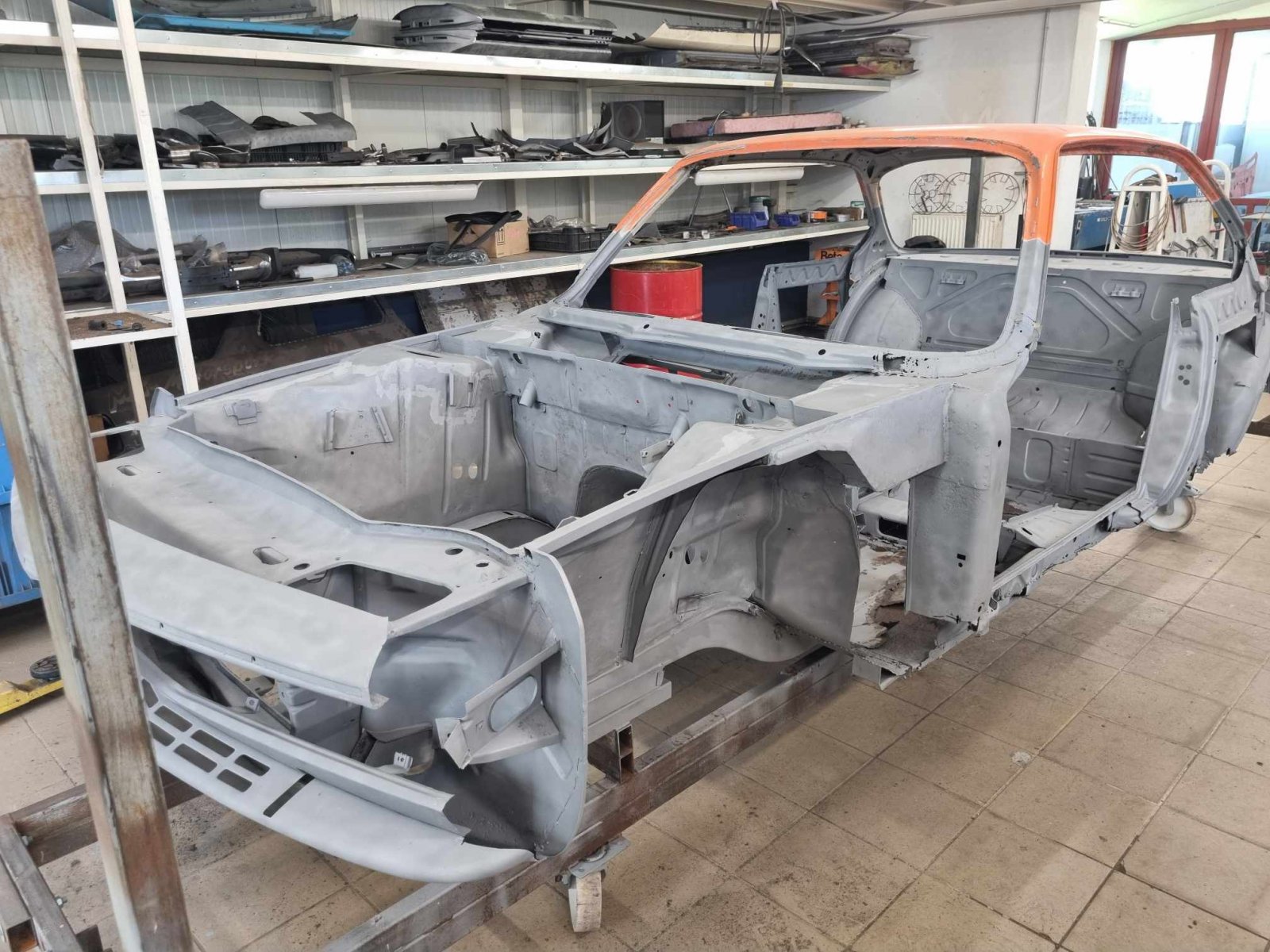

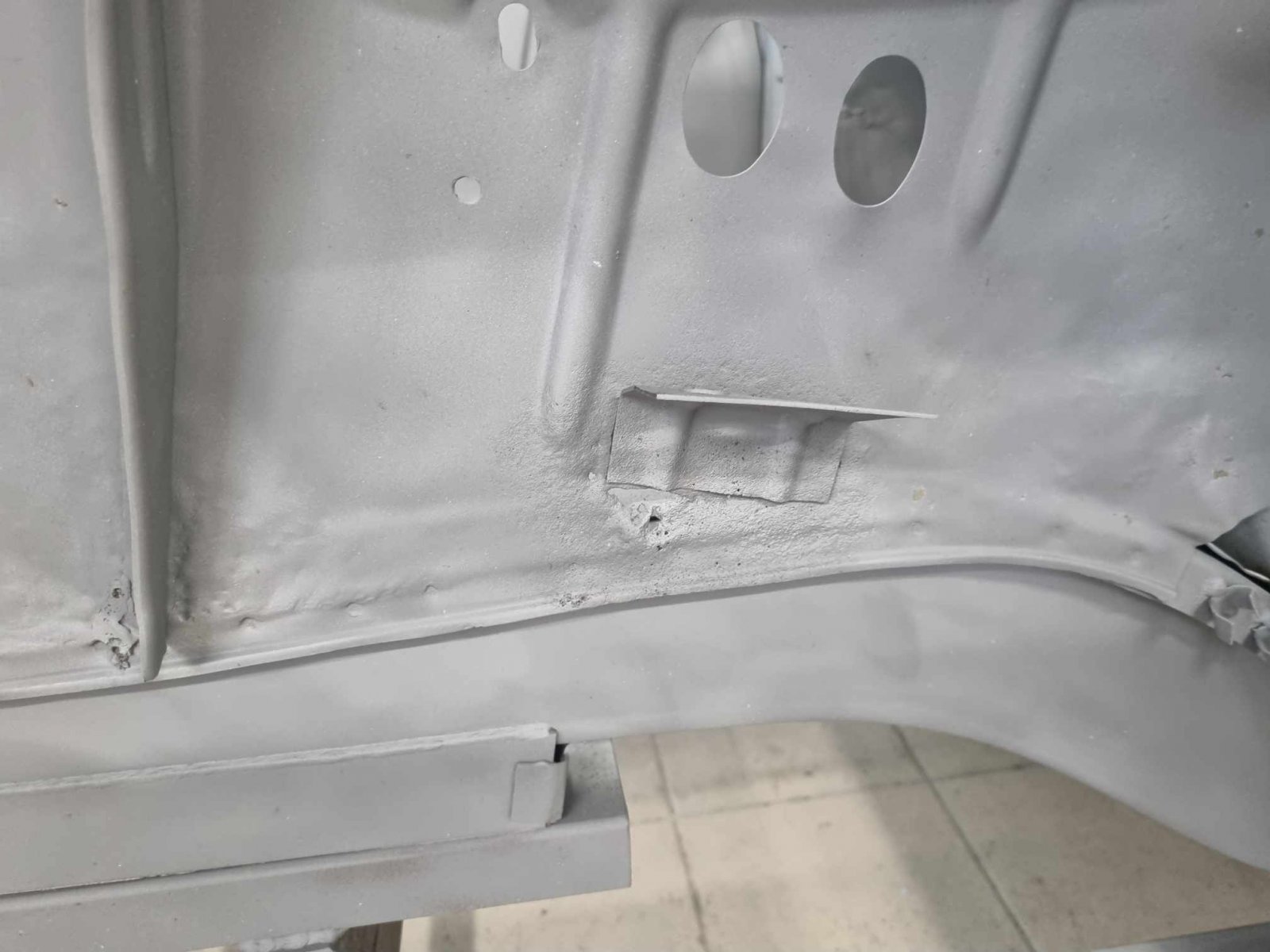

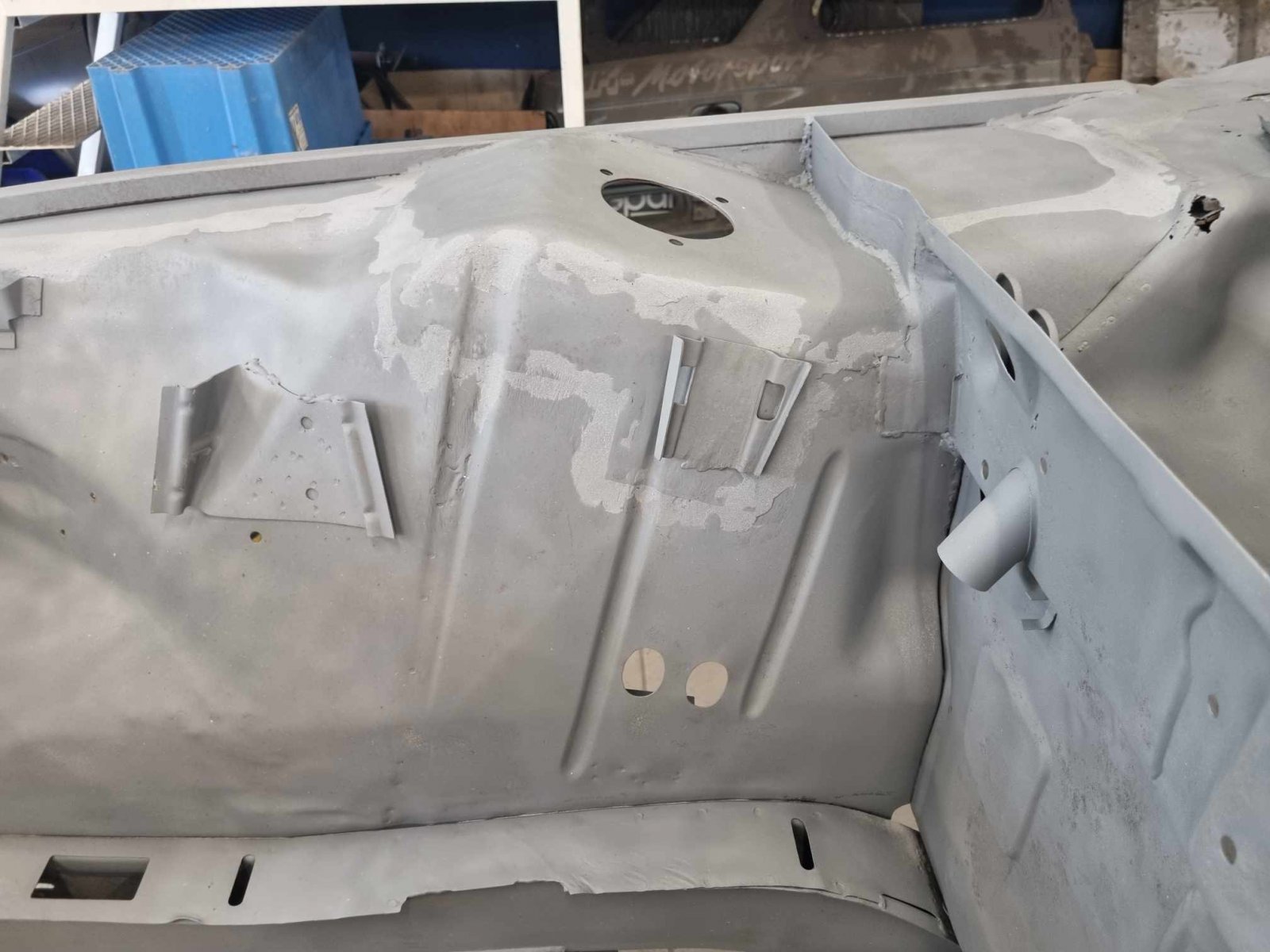

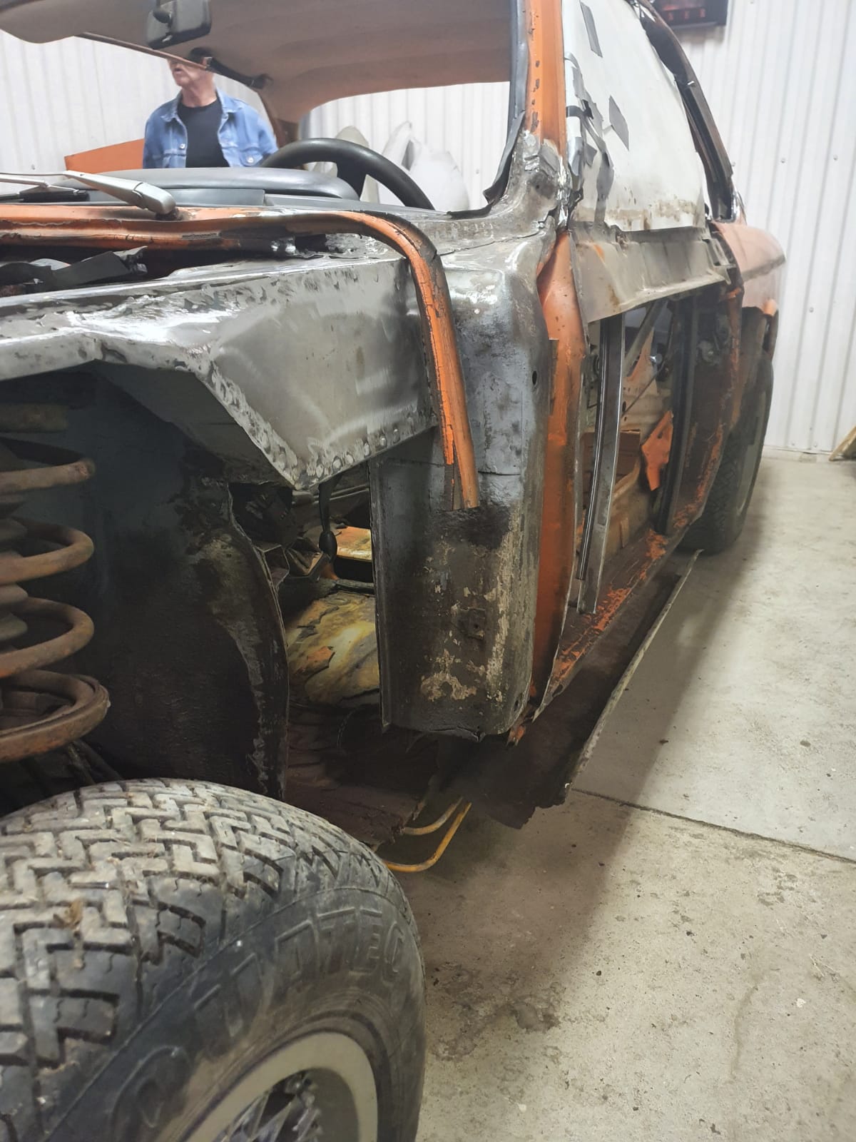

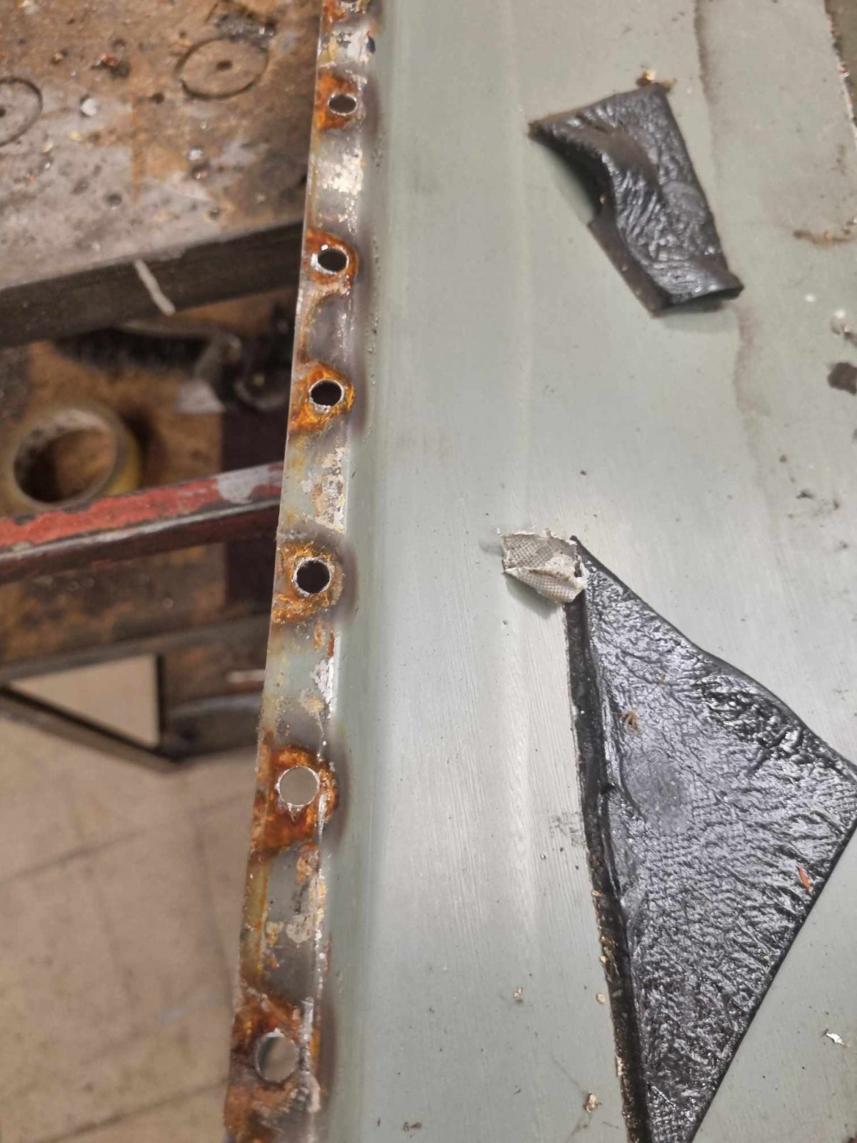

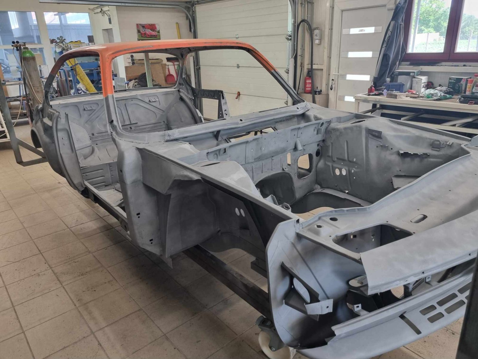

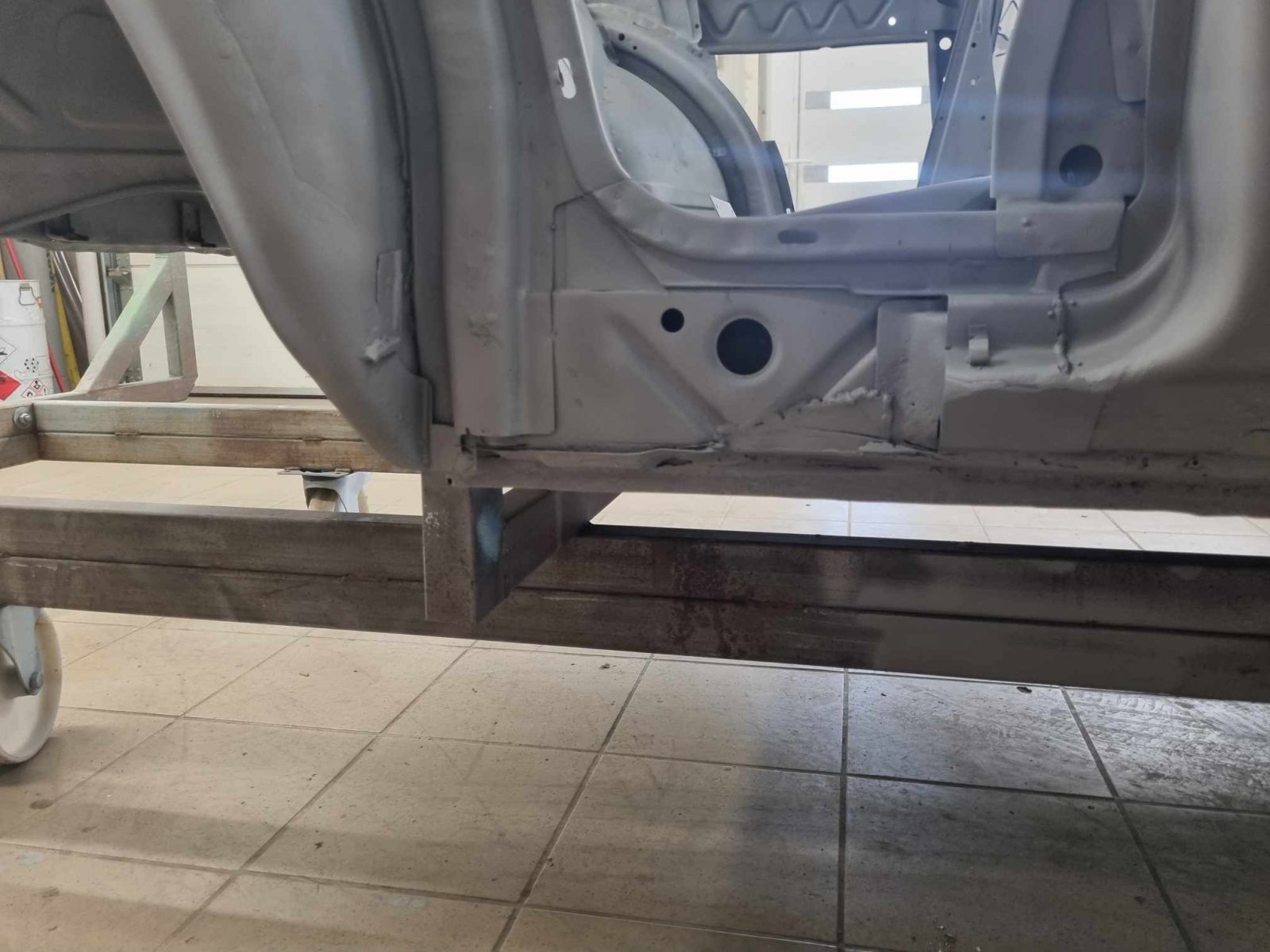

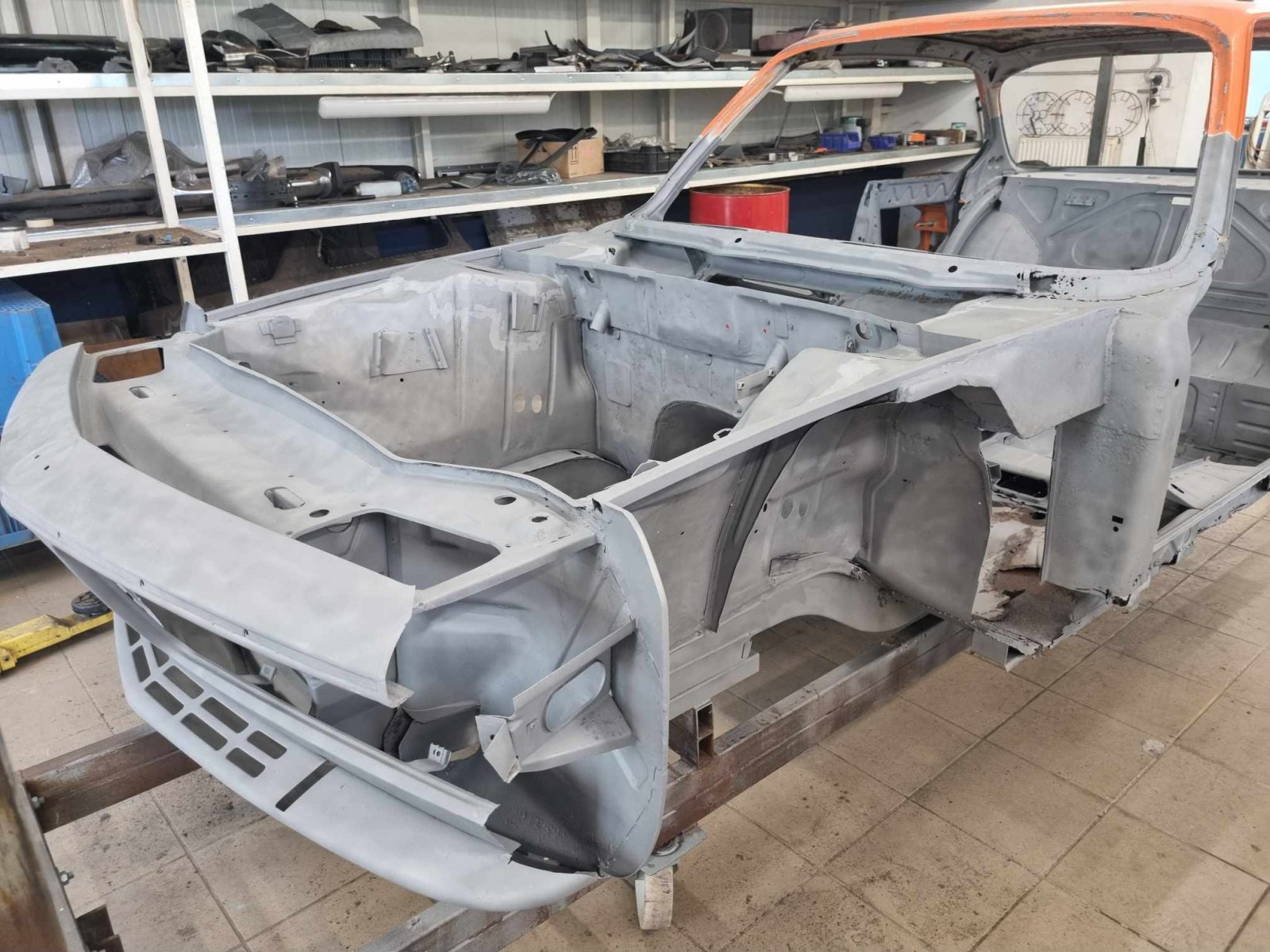

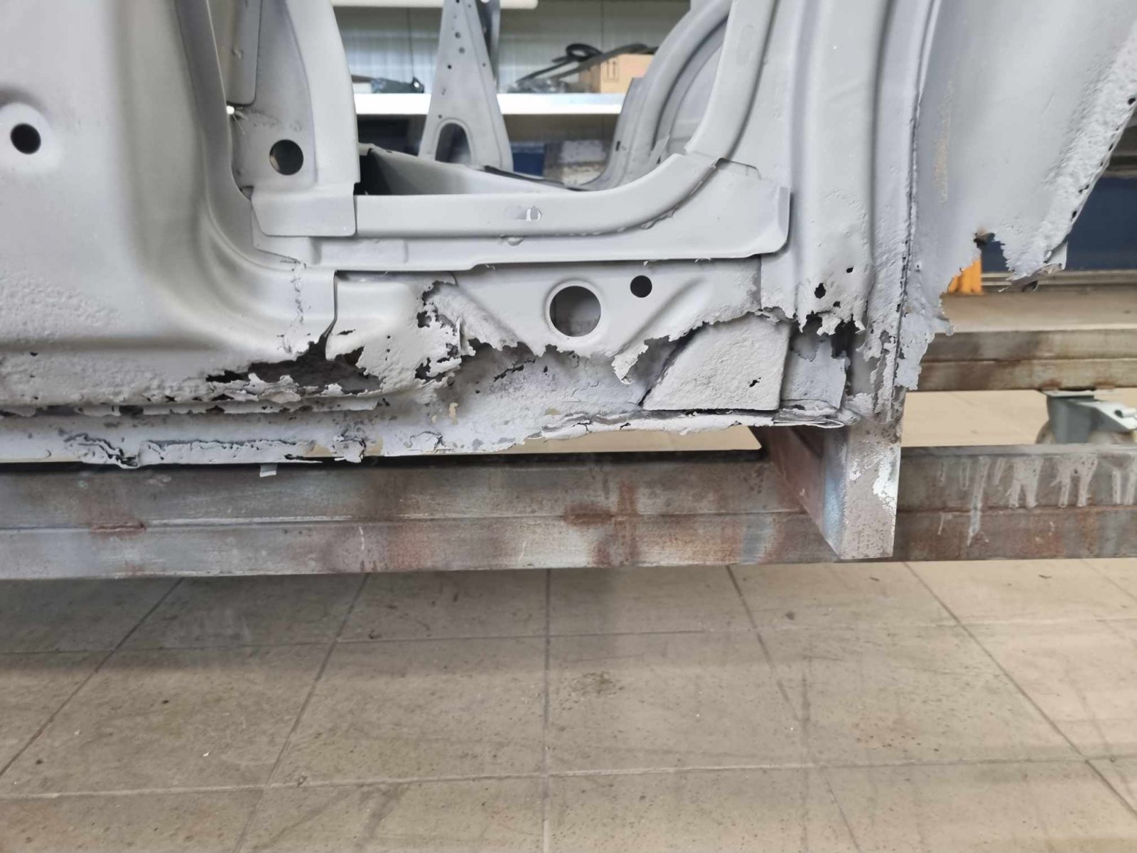

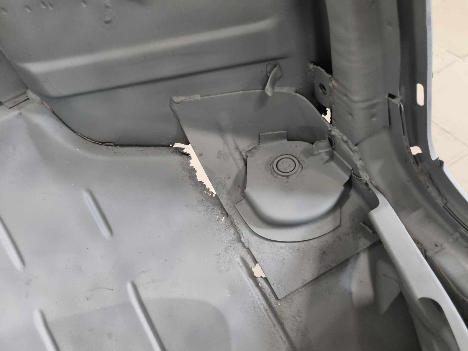

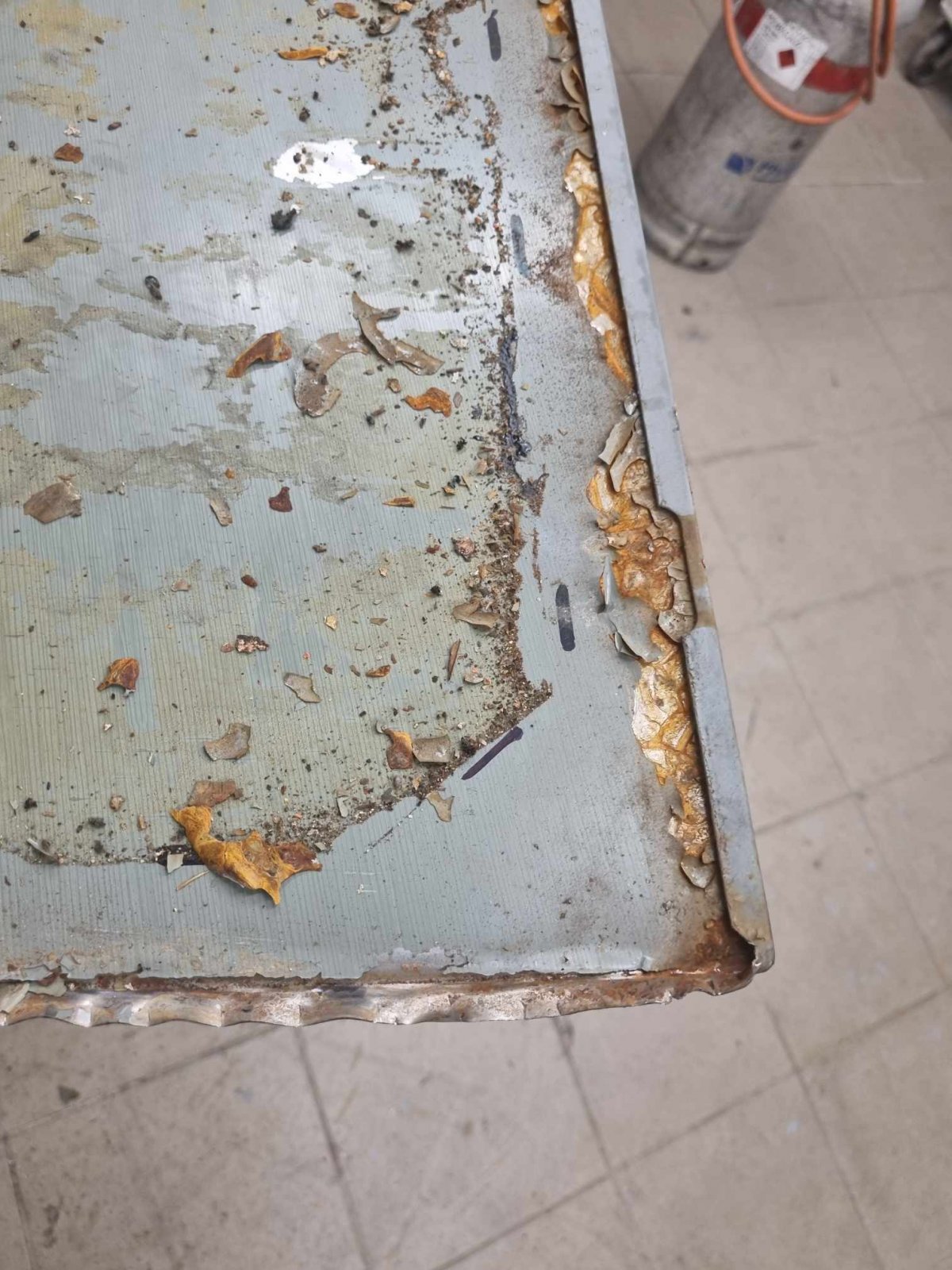

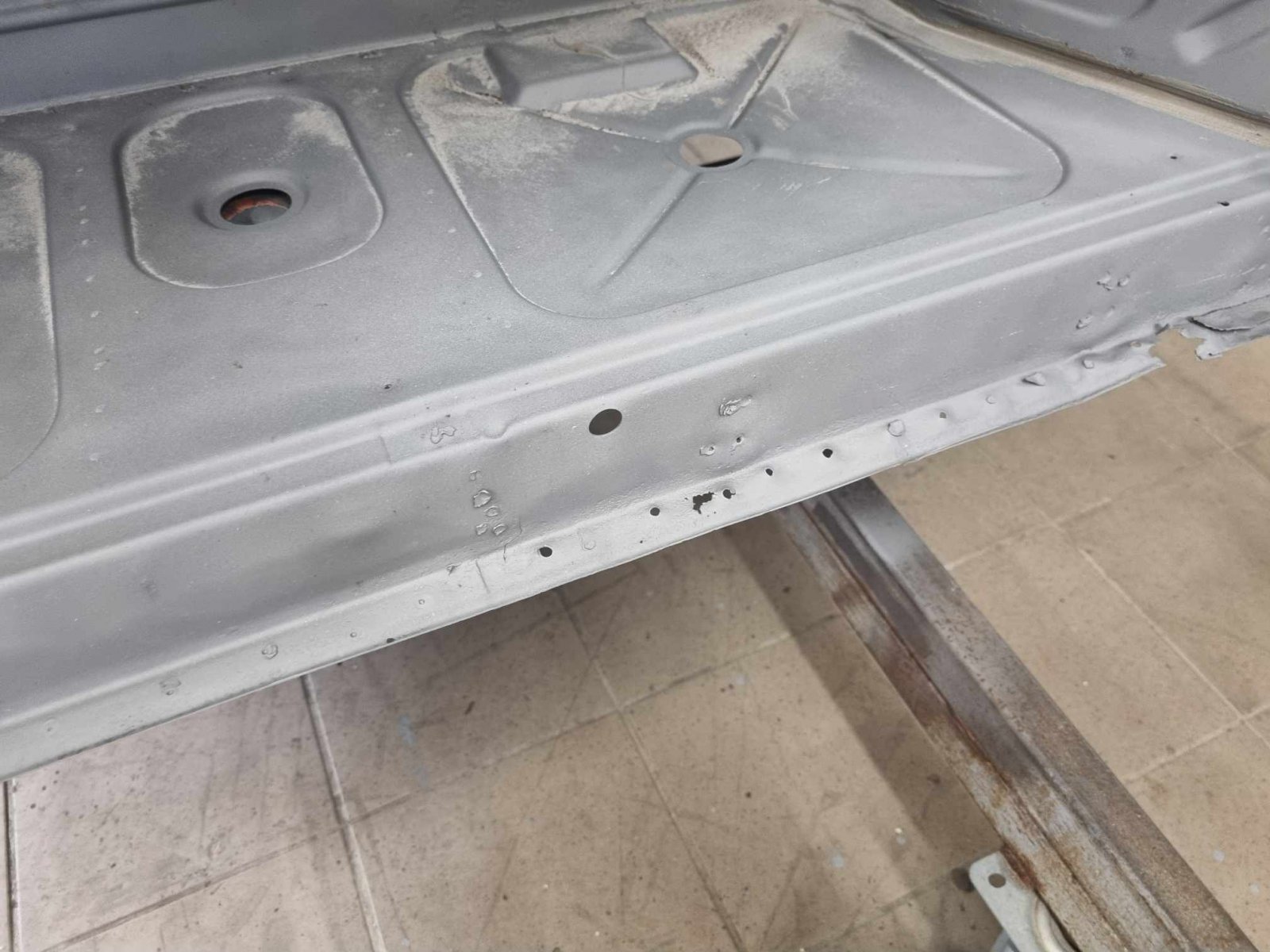

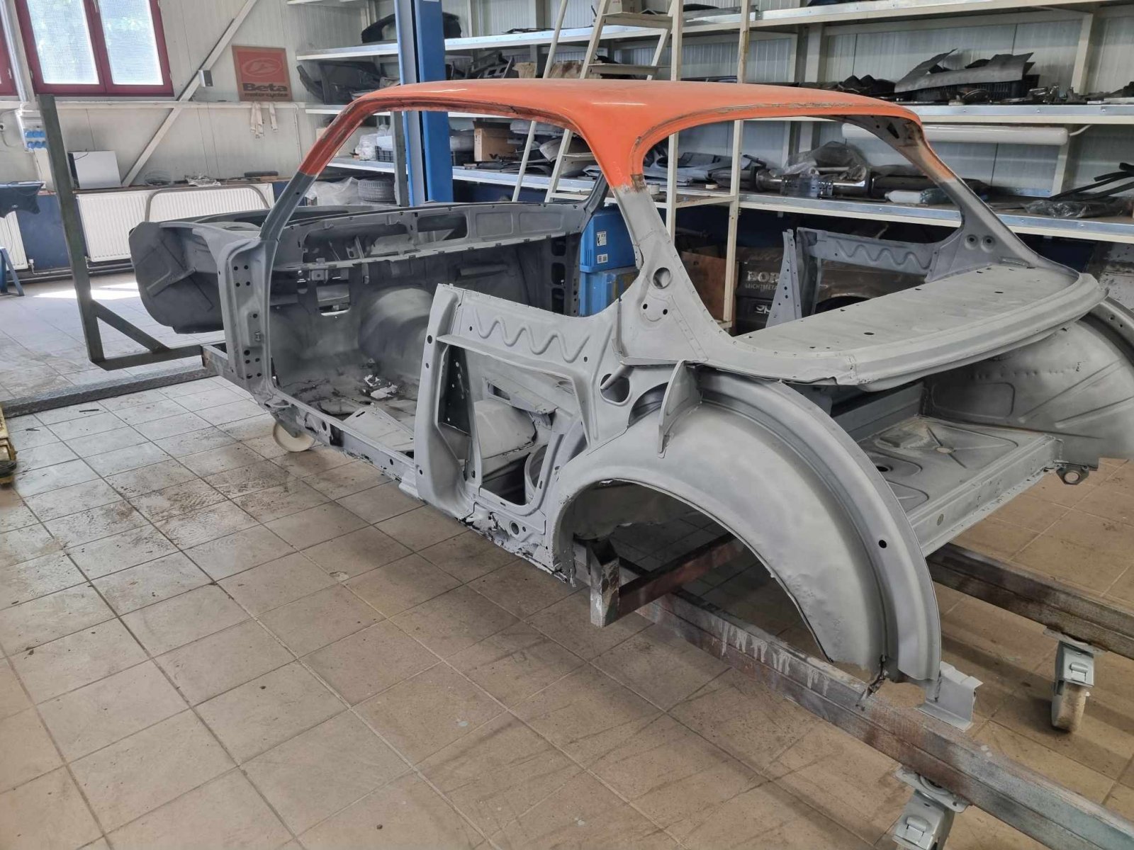

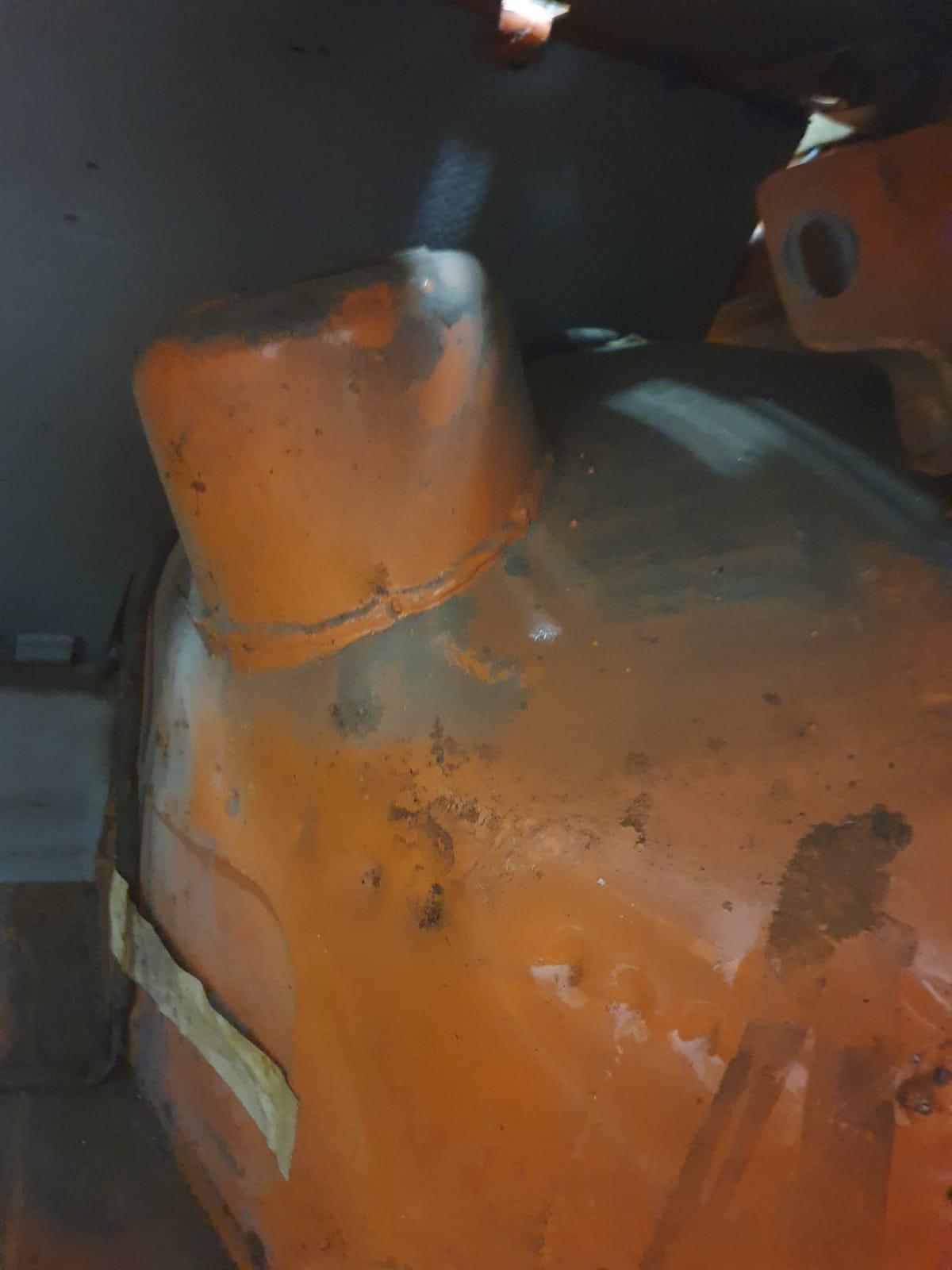

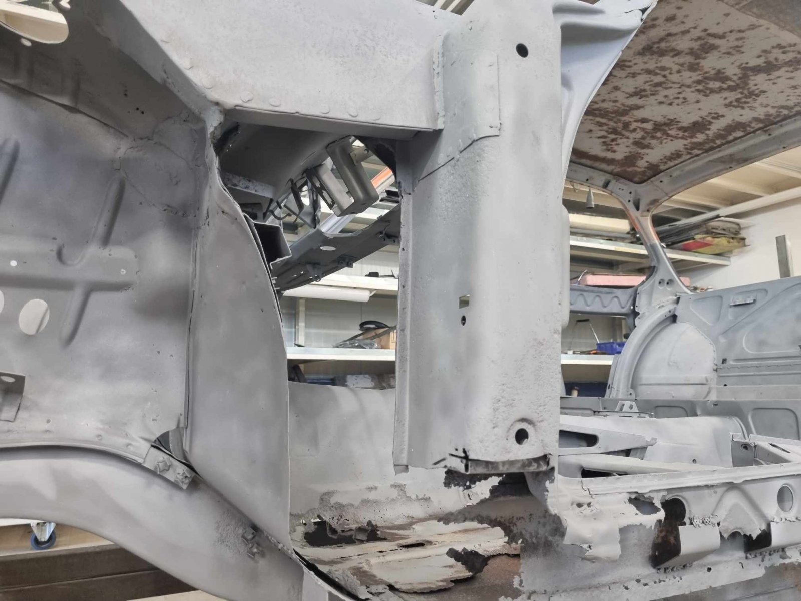

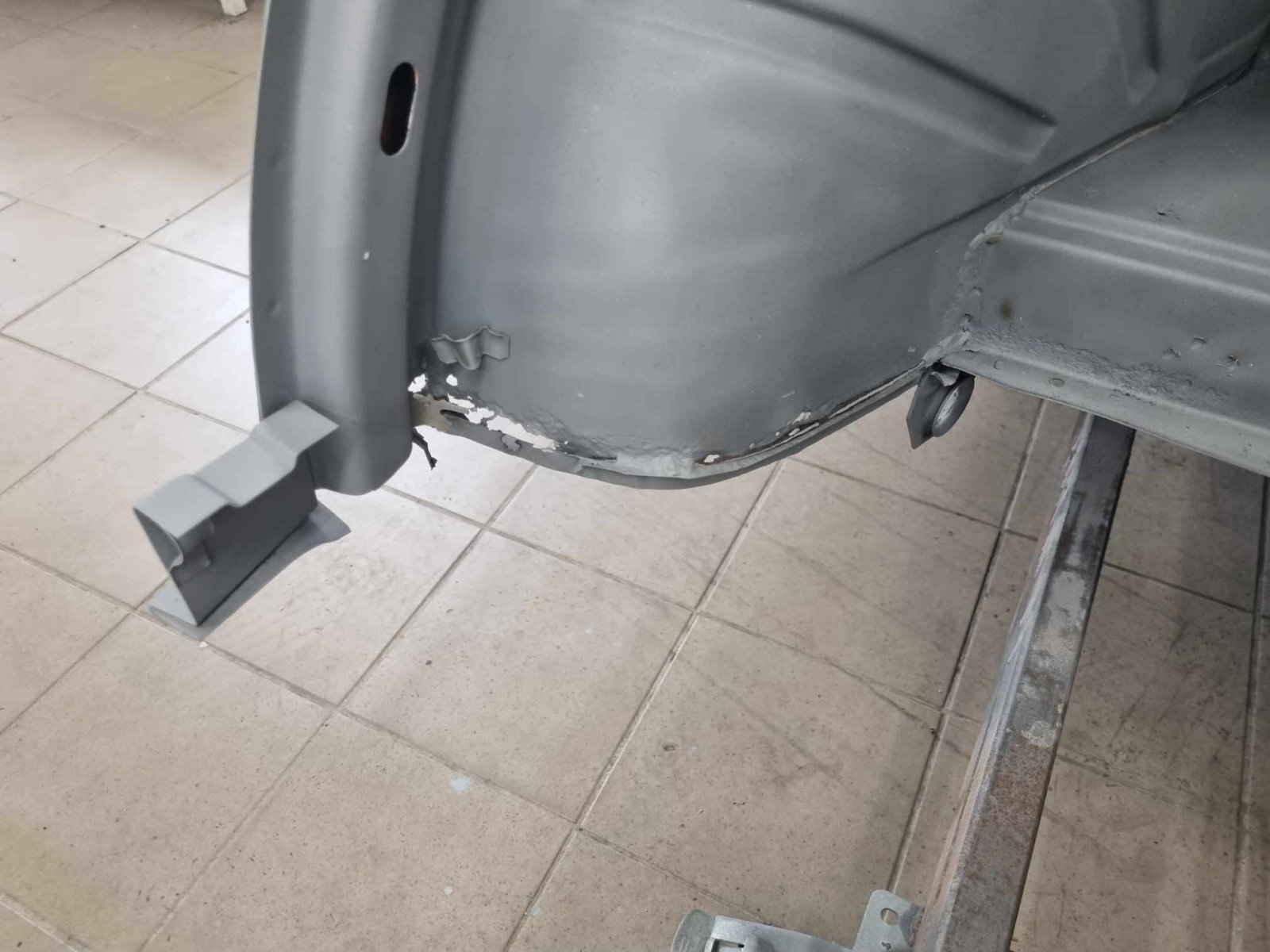

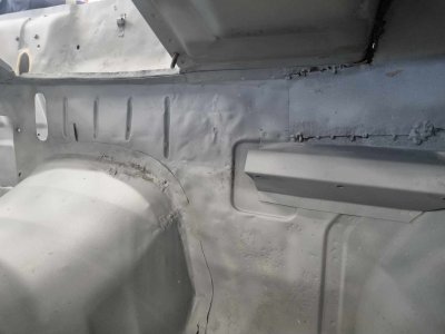

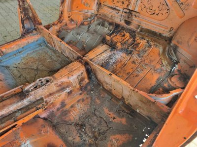

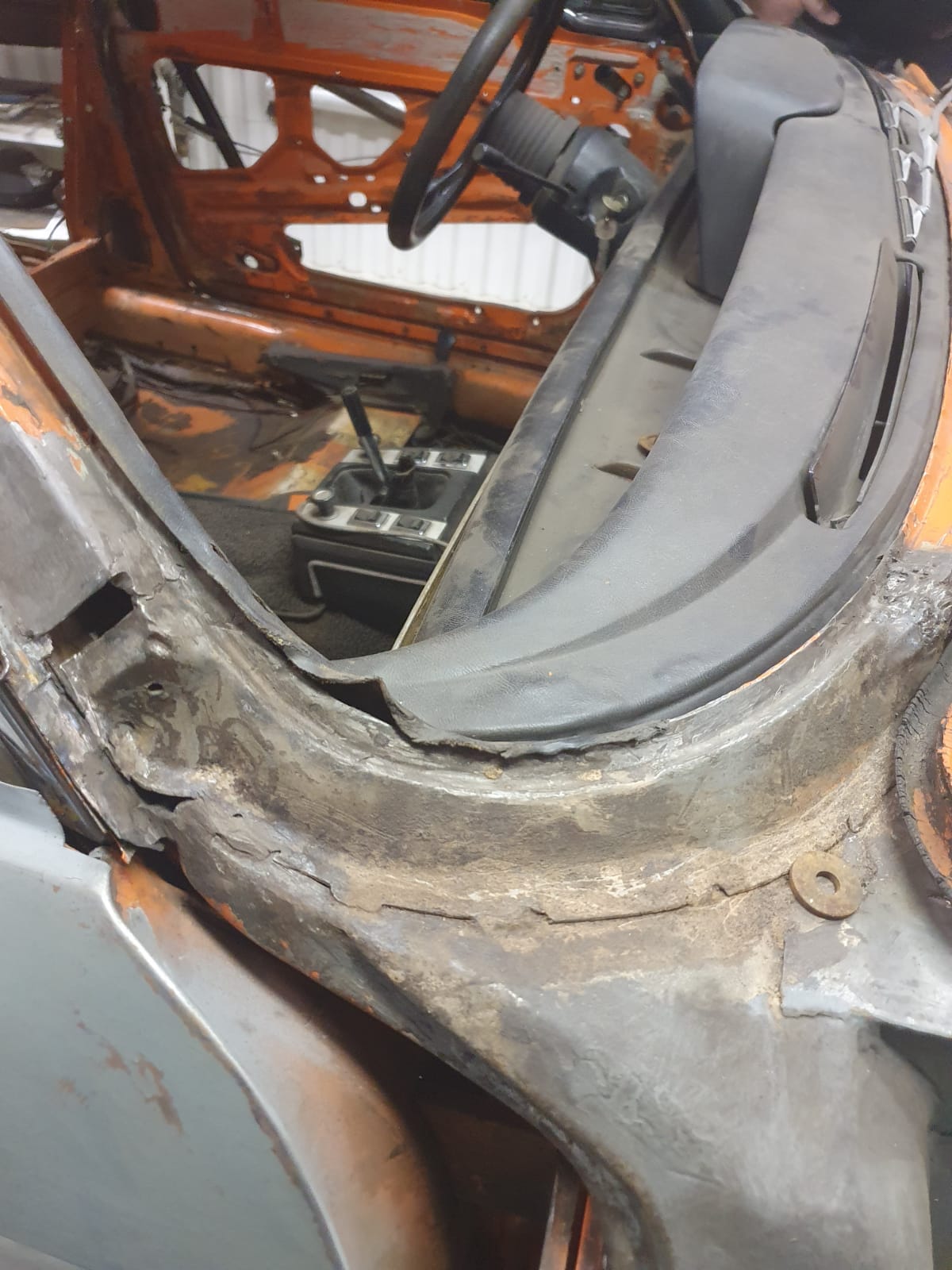

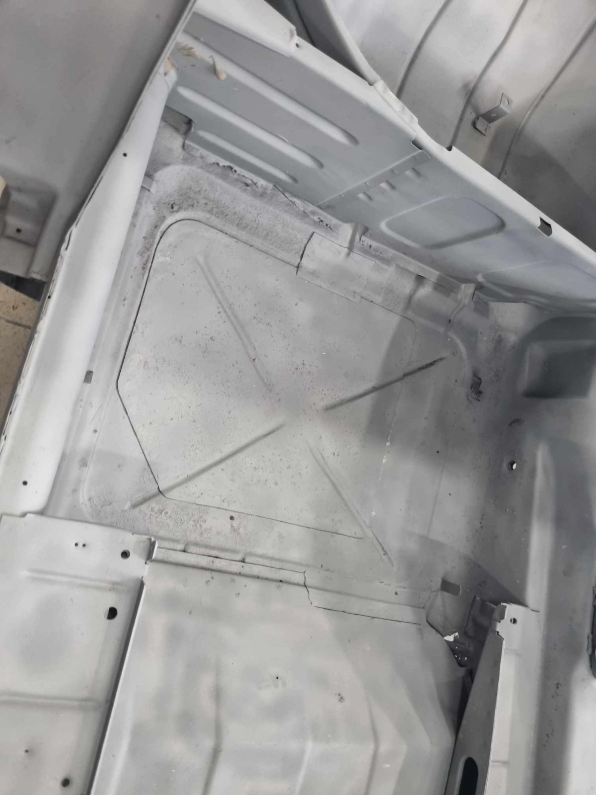

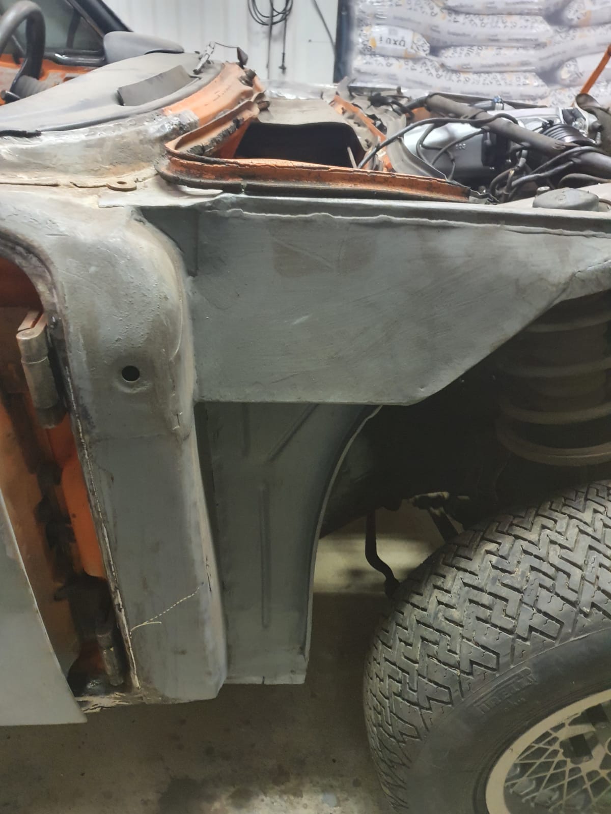

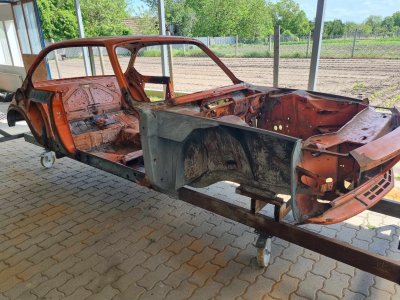

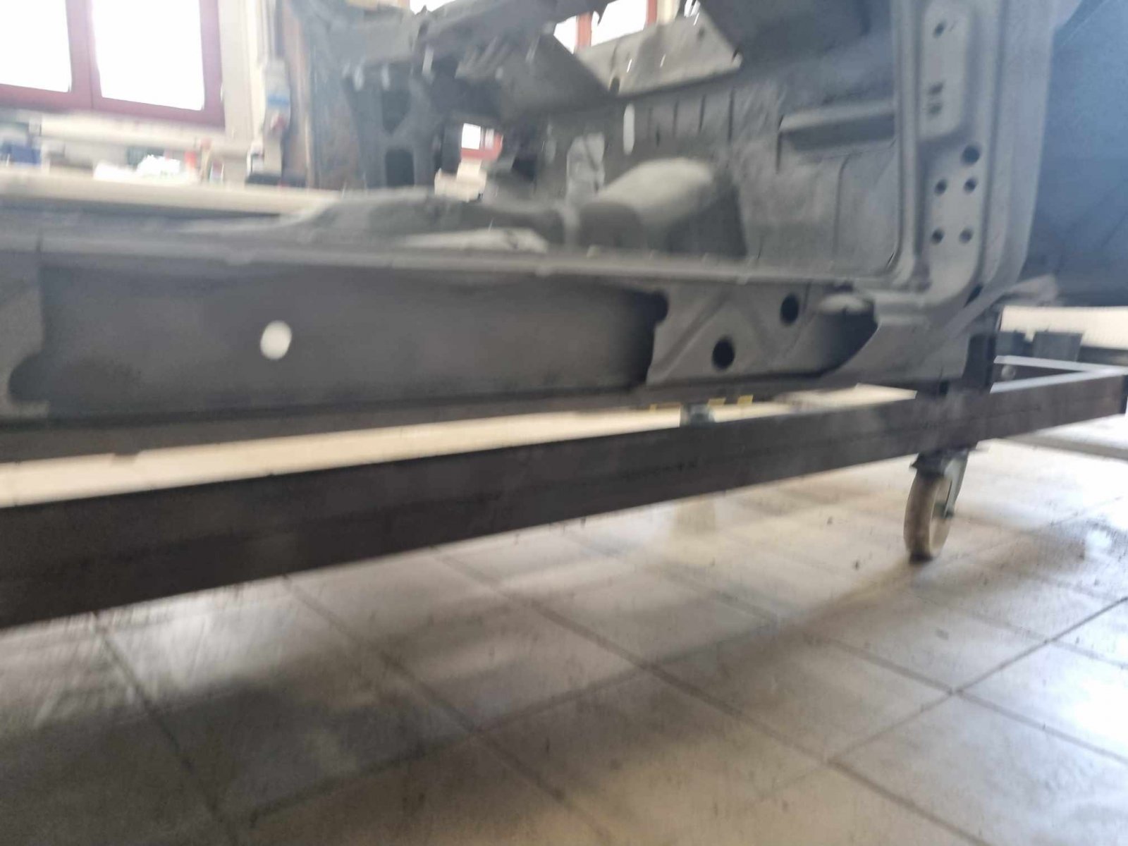

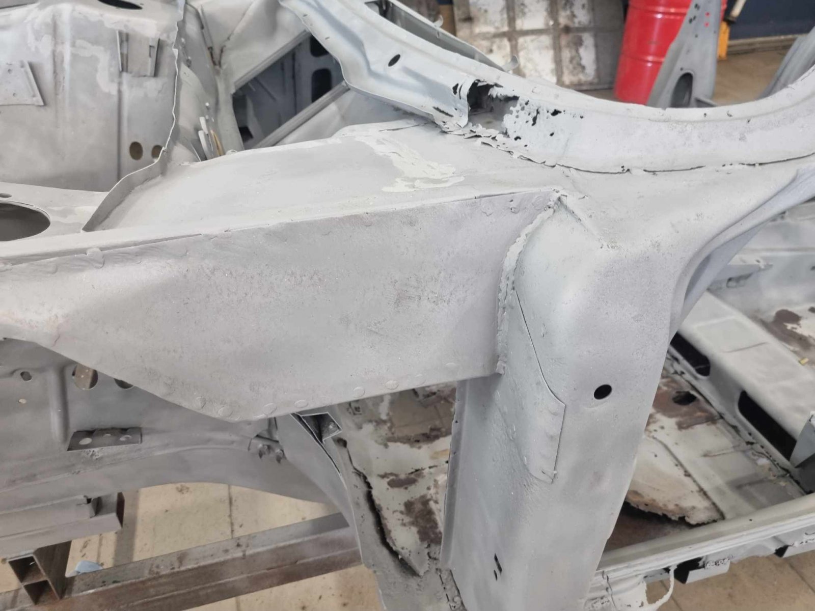

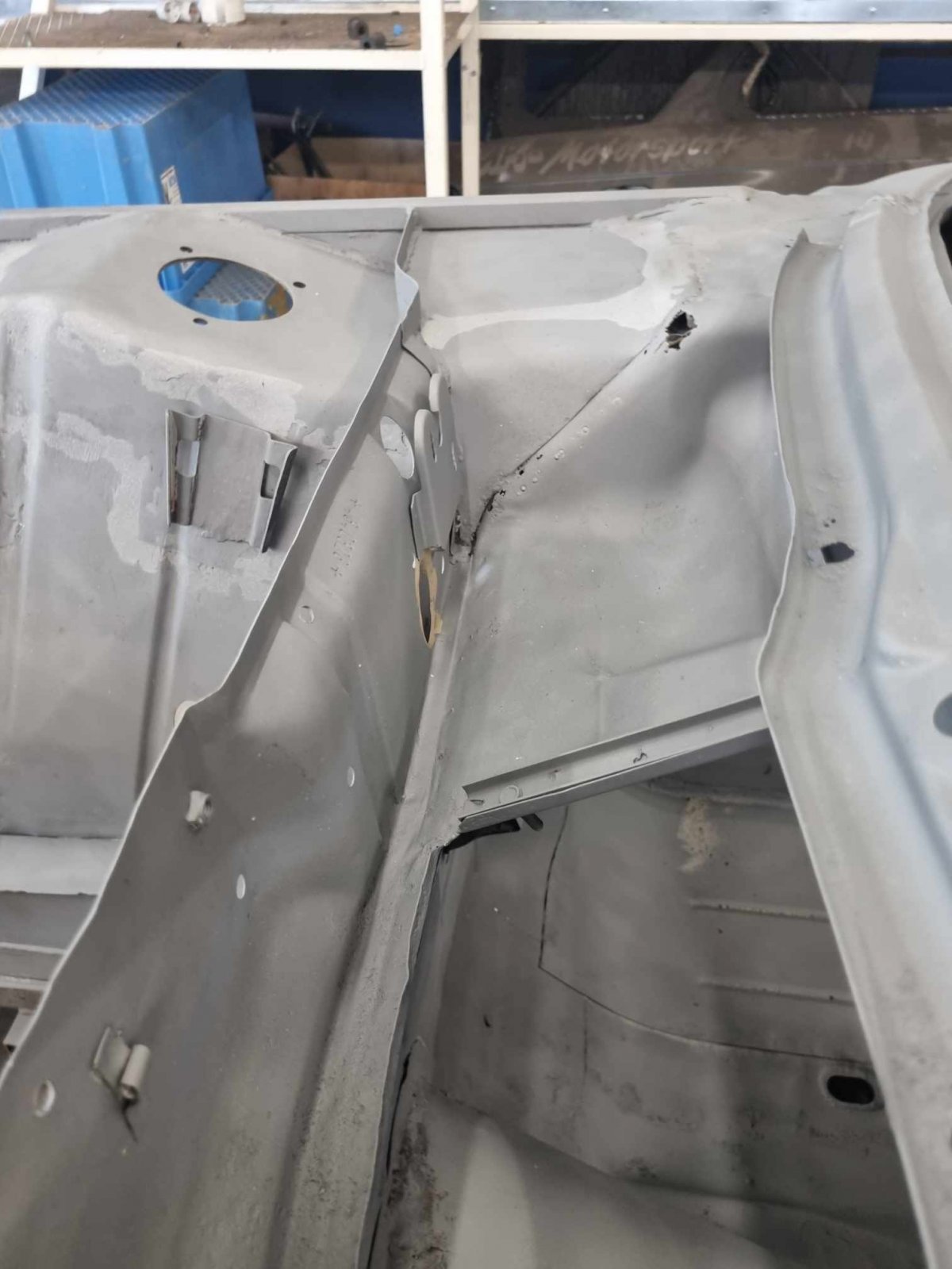

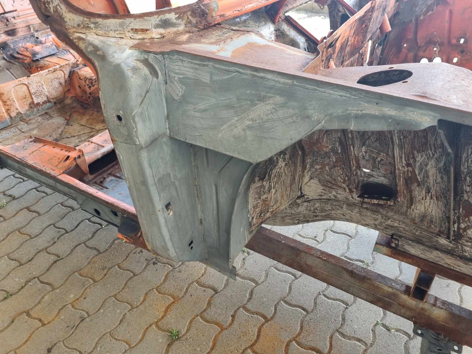

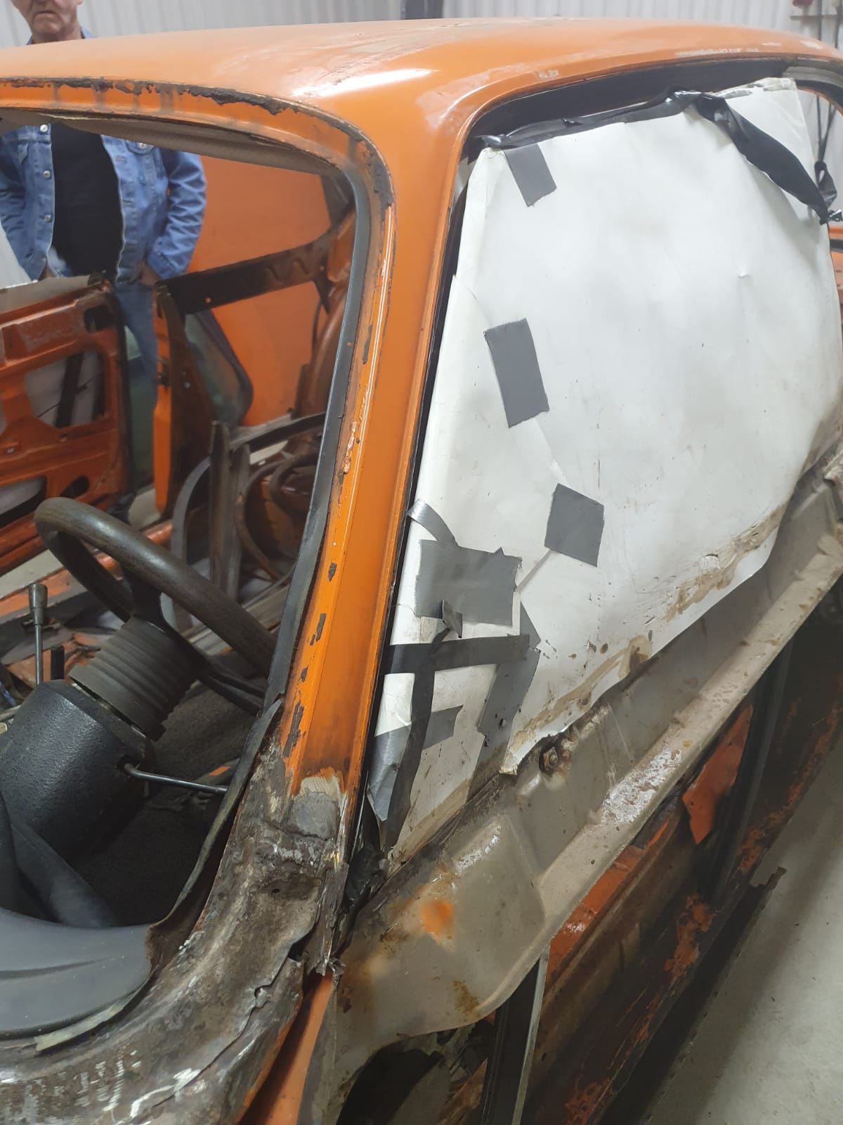

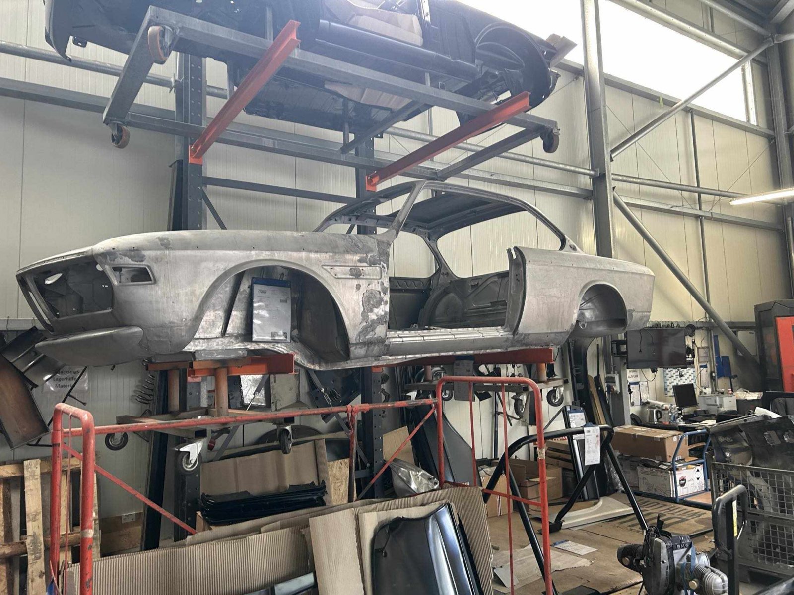

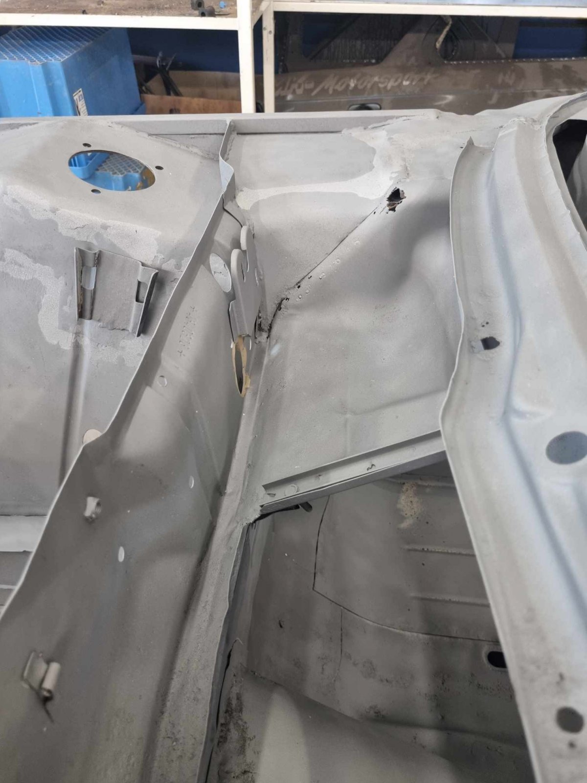

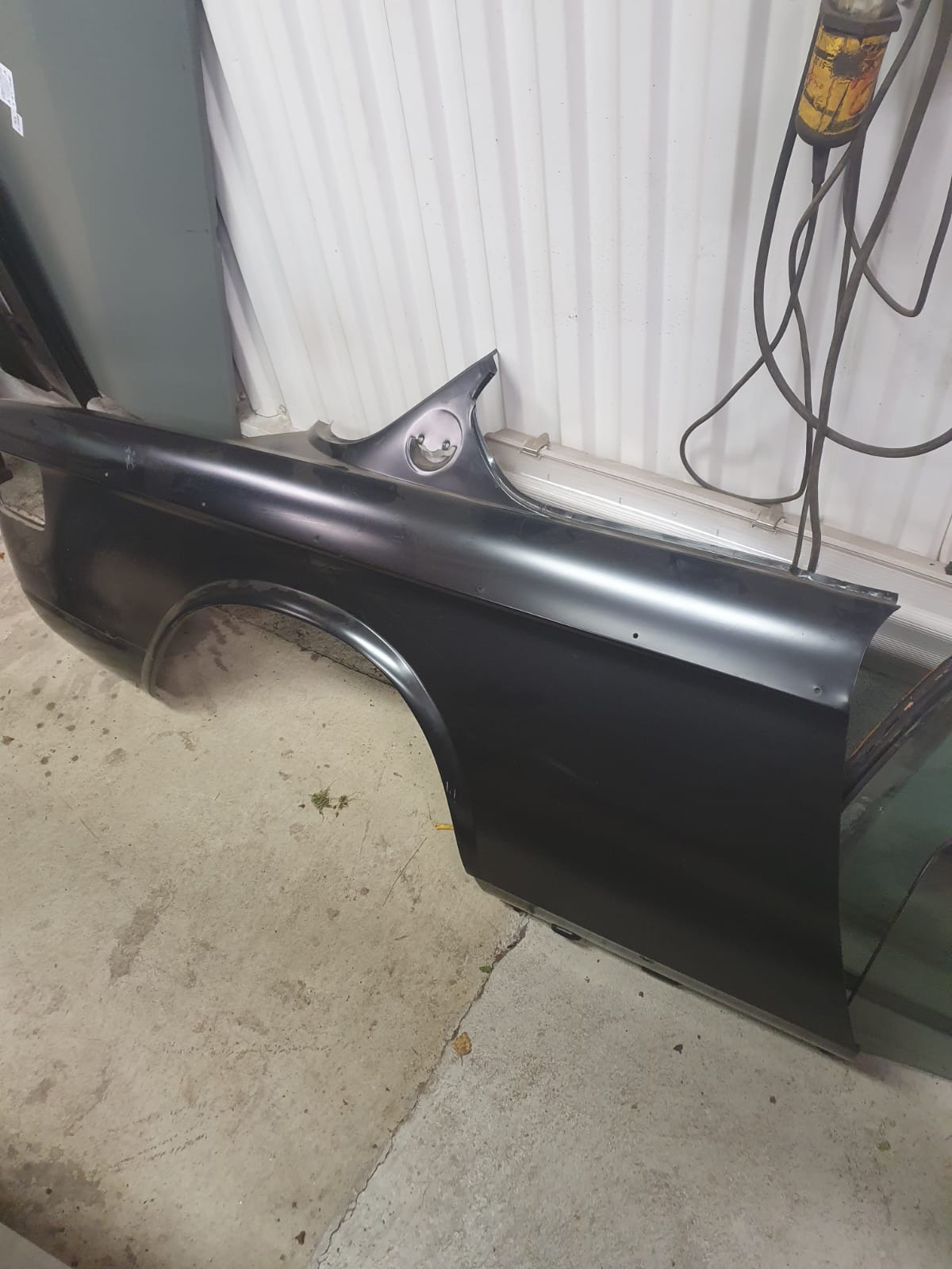

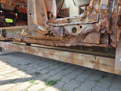

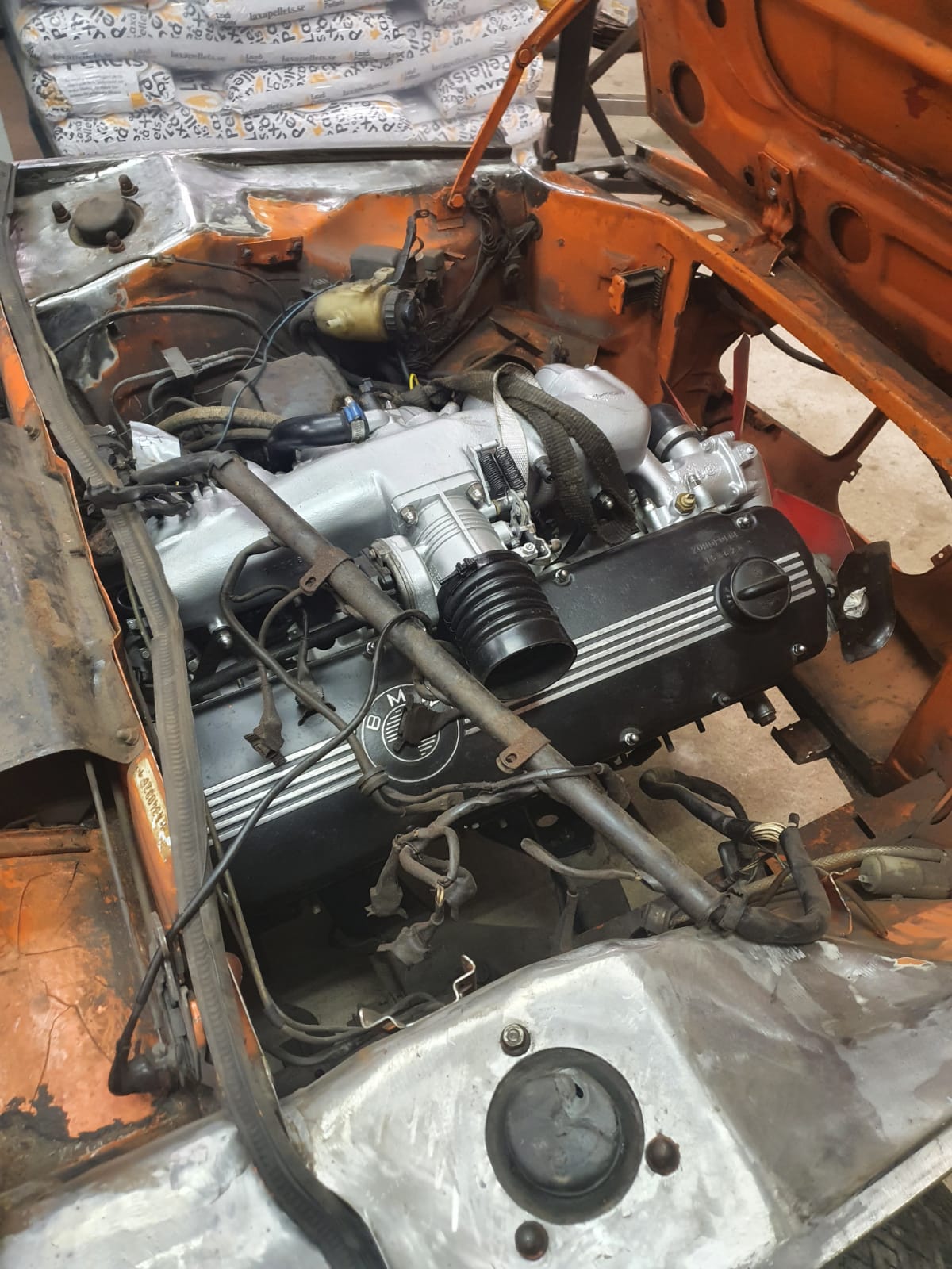

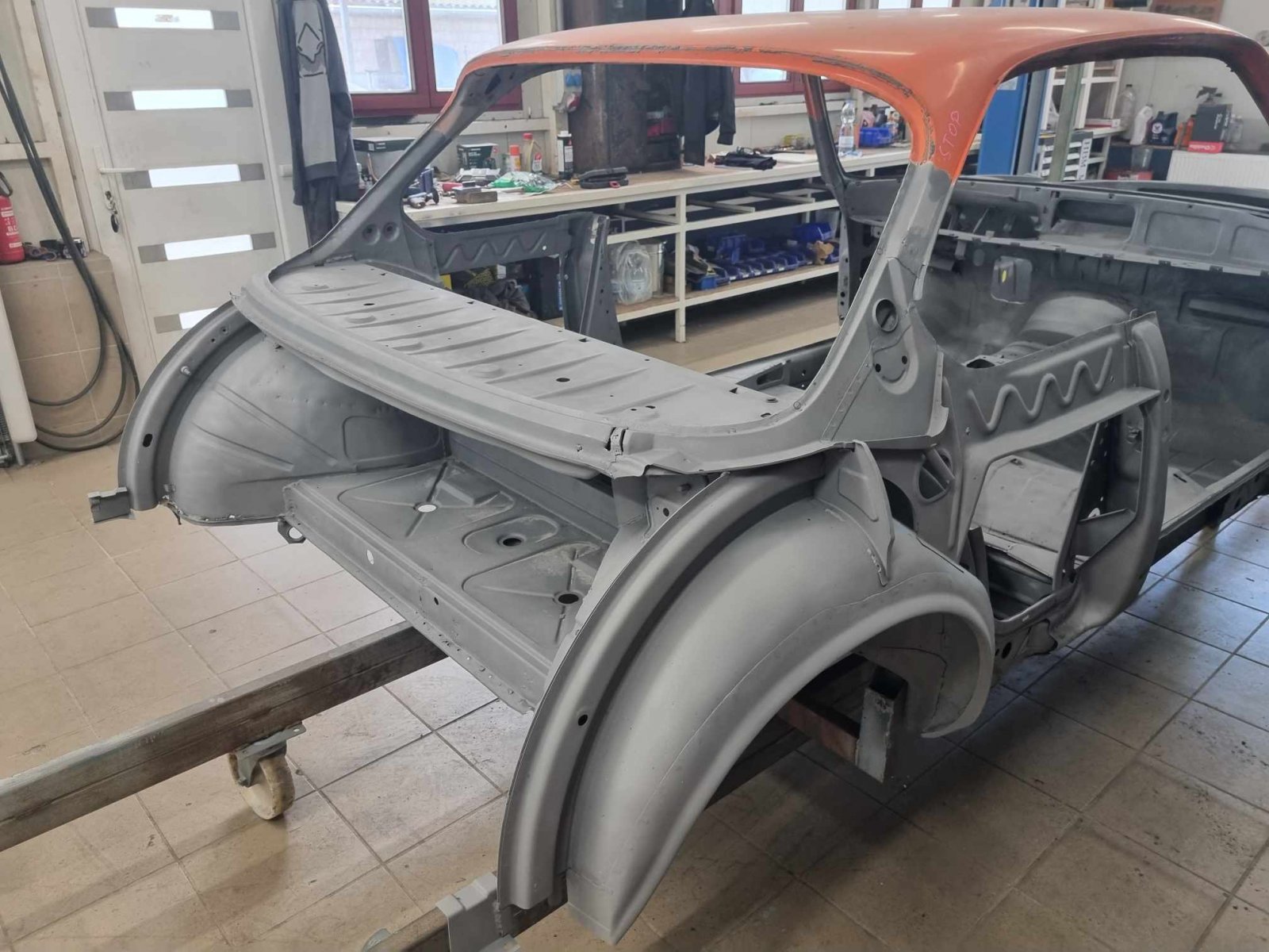

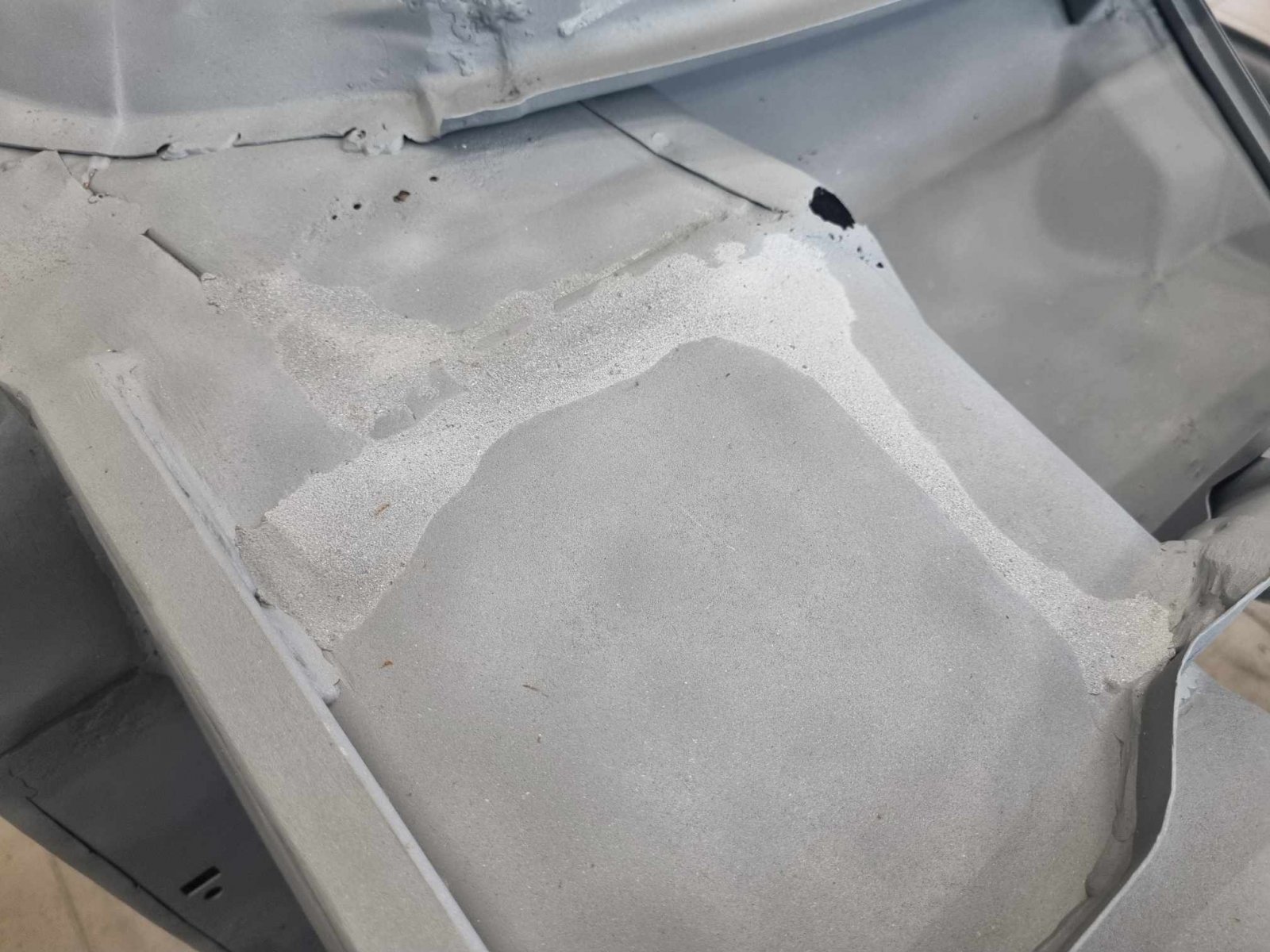

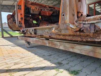

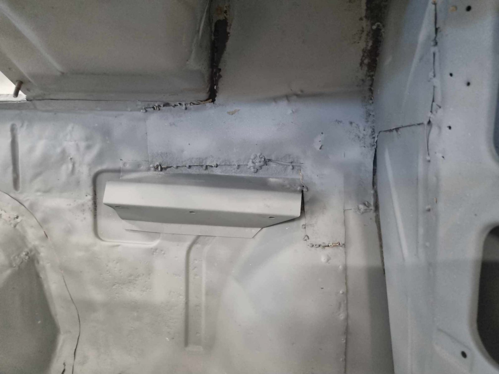

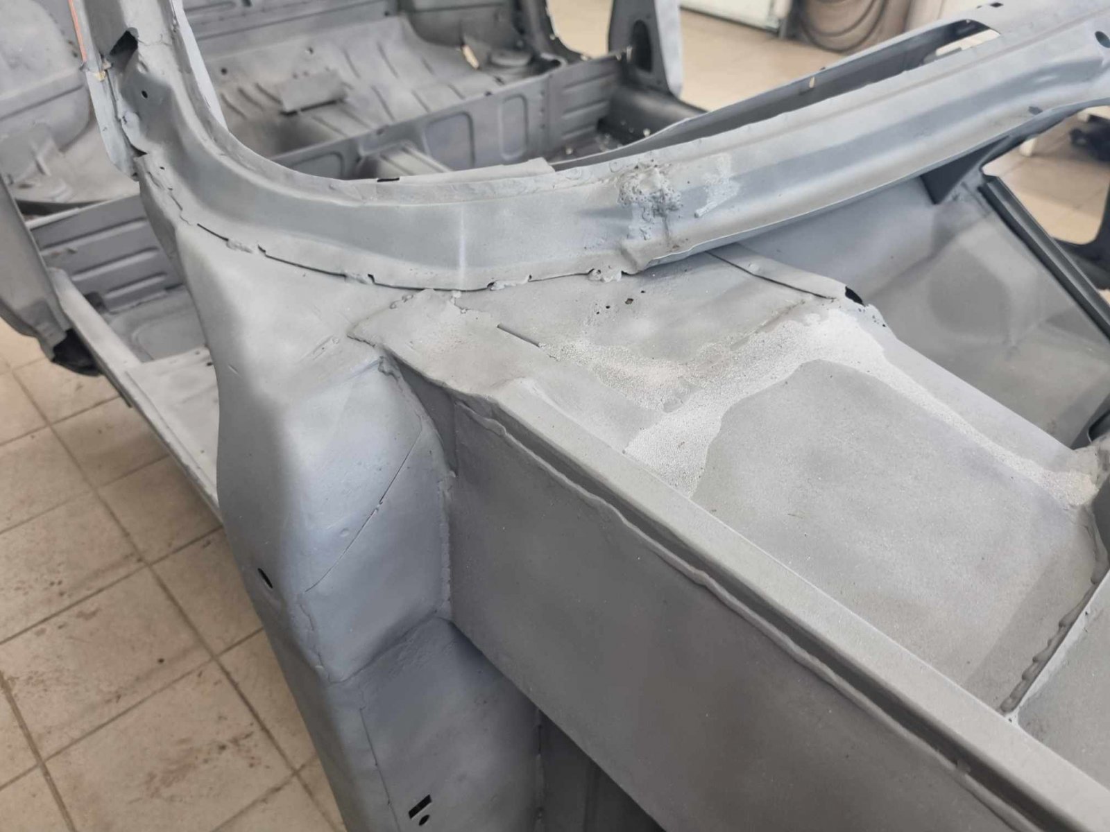

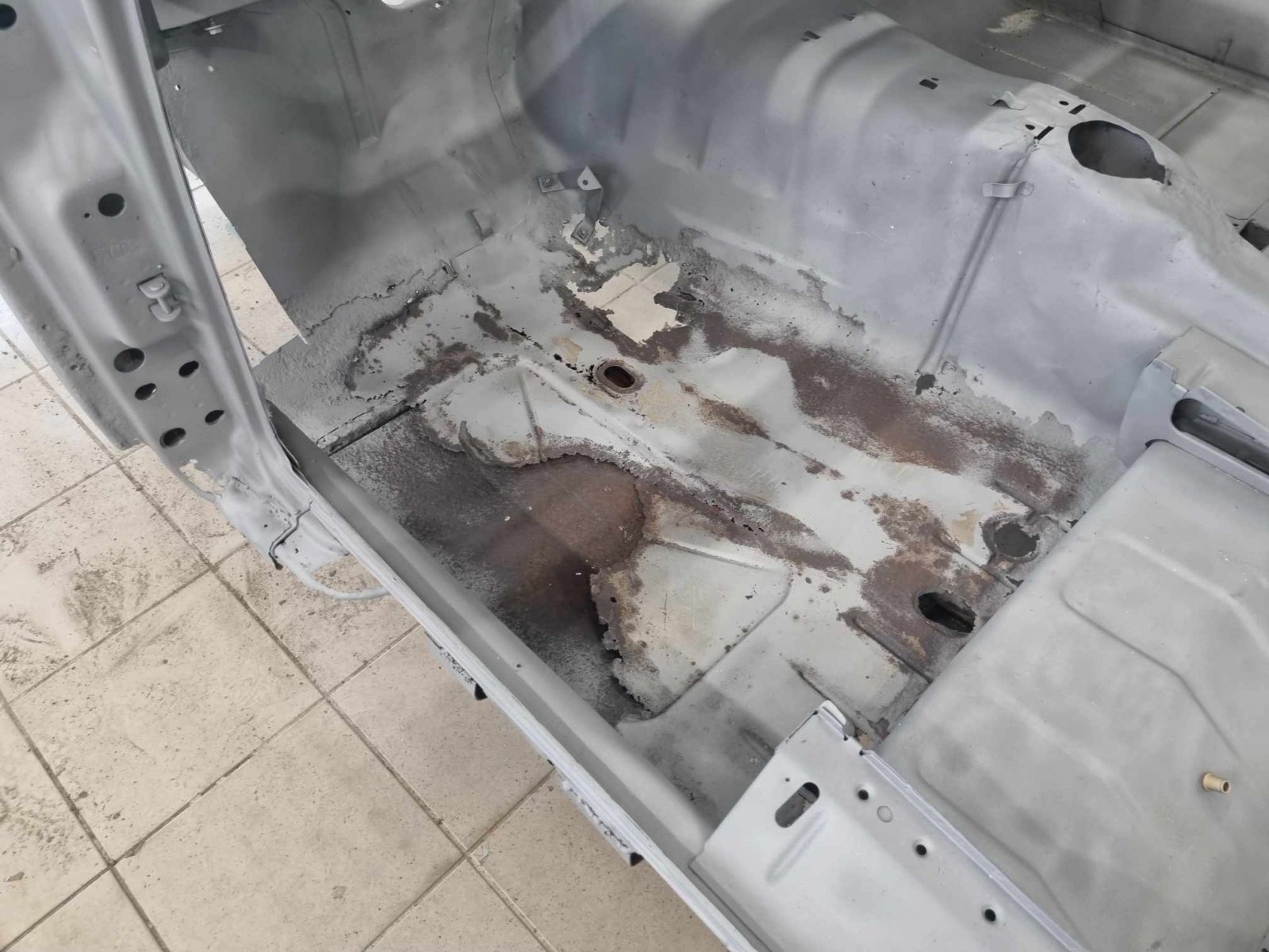

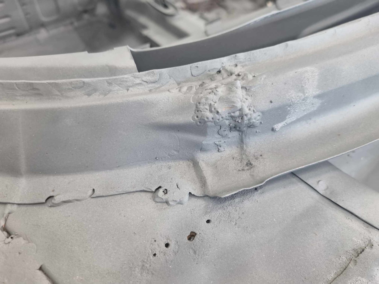

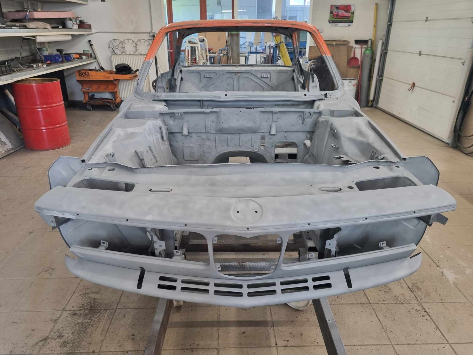

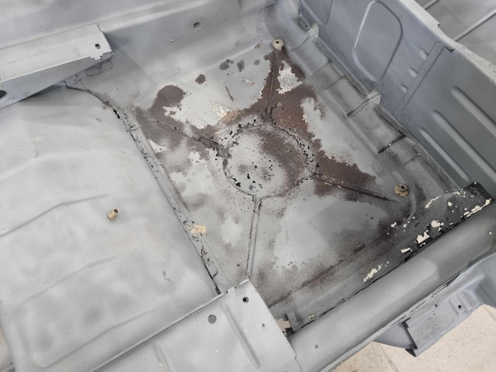

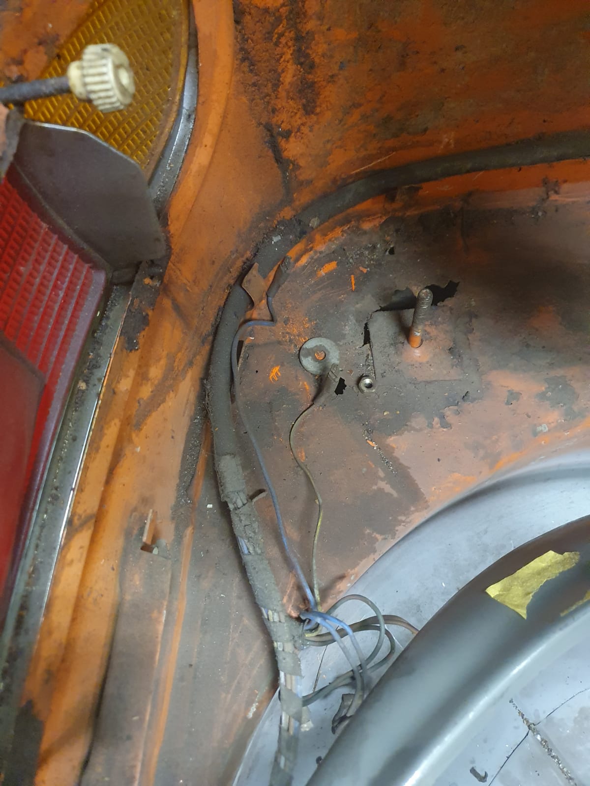

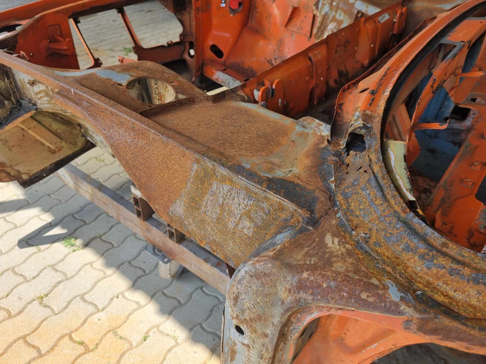

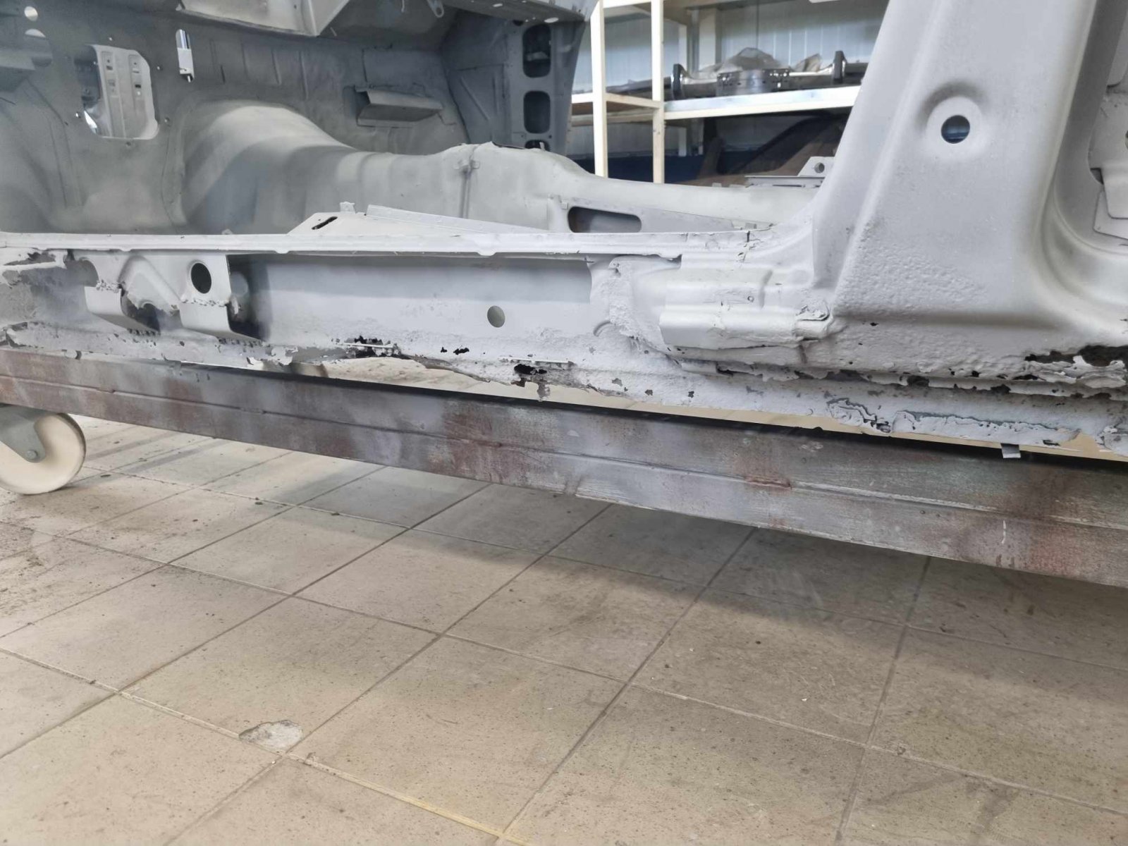

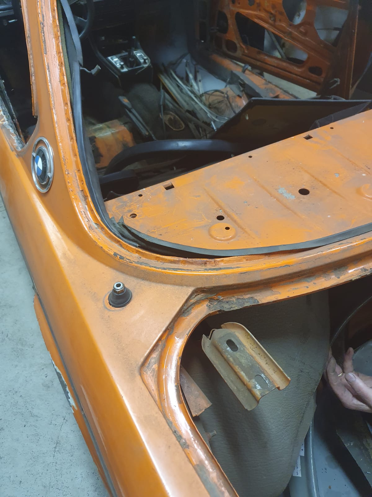

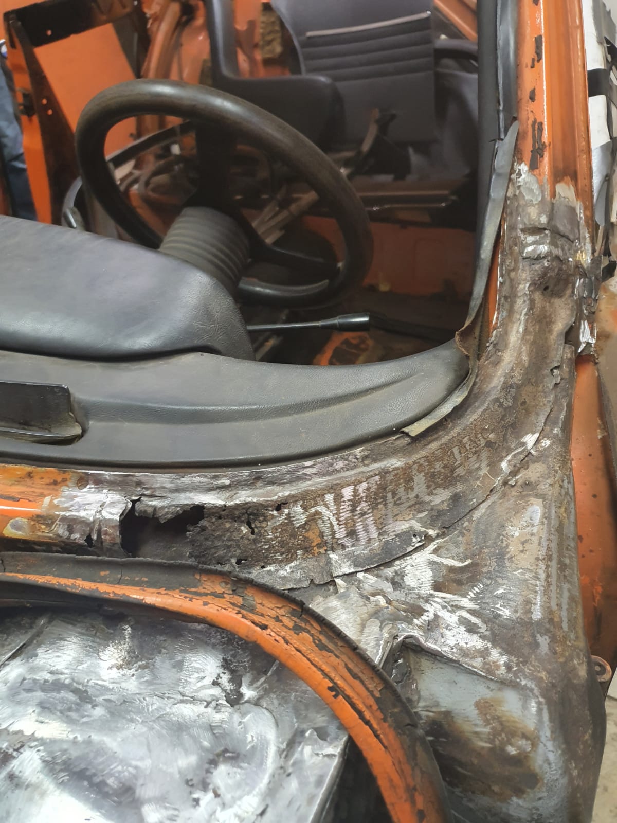

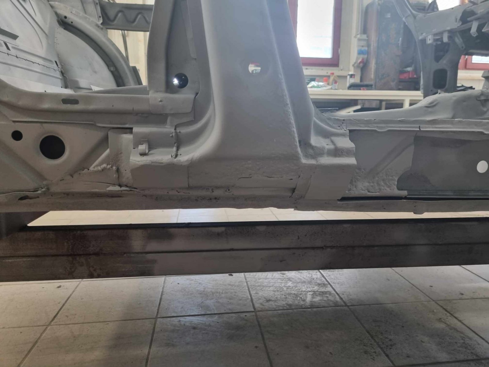

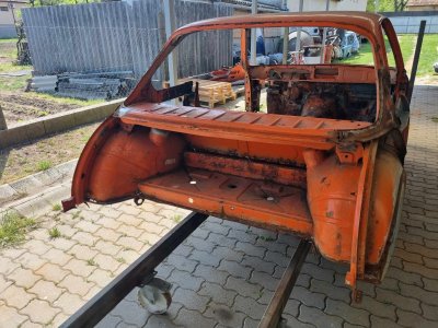

Work on Inka has started, plenty rust. Ordered a lot of sheet metal parts from W&N. close to $10k worth. Makes the job a lot easier though.
