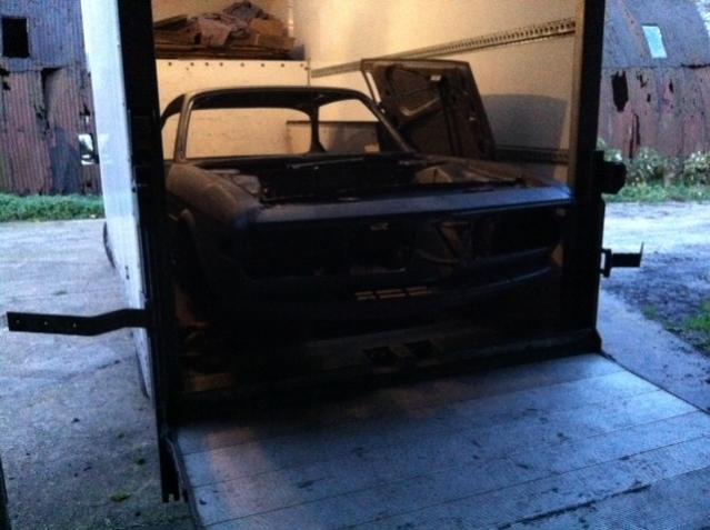

sorry for the mobile phone photo but my first attempt arrived back today from being dipped here in the UK by SPL, it was the end of the day so light was bad but as its fully stripped you can see it all good and bad!! not sure what to make of it really.... ill post proper pics tomorrow to get a few opinions...
it could be better but could be alot worse, it was a cheap car and i took a risk so what i have it seems are 2 good doors (but need new skins) bonnet/hood is good alround boot is good to the rear lip and then bad all along the back edge will need to cut it out and replace sunroof is good and shell is both good and bad to much to list without photos but main surprise is it seems the roof was replaced my novice eyes had no chance seeing that with the paint on!! wheel arches so so drivers (RHD) footwell to be replaced,,, thats all i could see with a flashlight at the end of the day, christmas comes early i guess!!
thought it looked pretty funny in the back of the van.....
what should i look out for and please tell me everything and anything can be repaired, but where and when does corrosion cause the shell to become just straight dangerous?

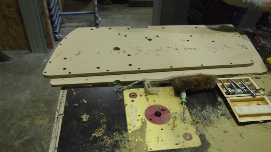

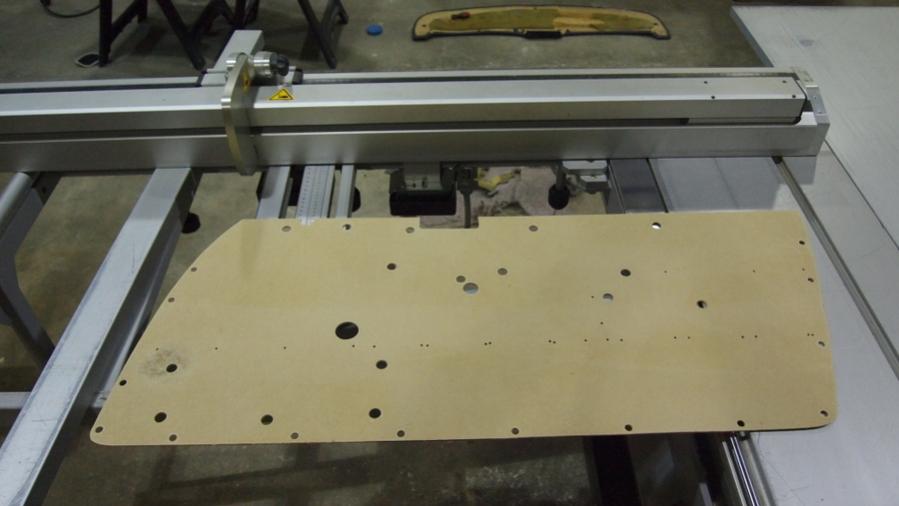

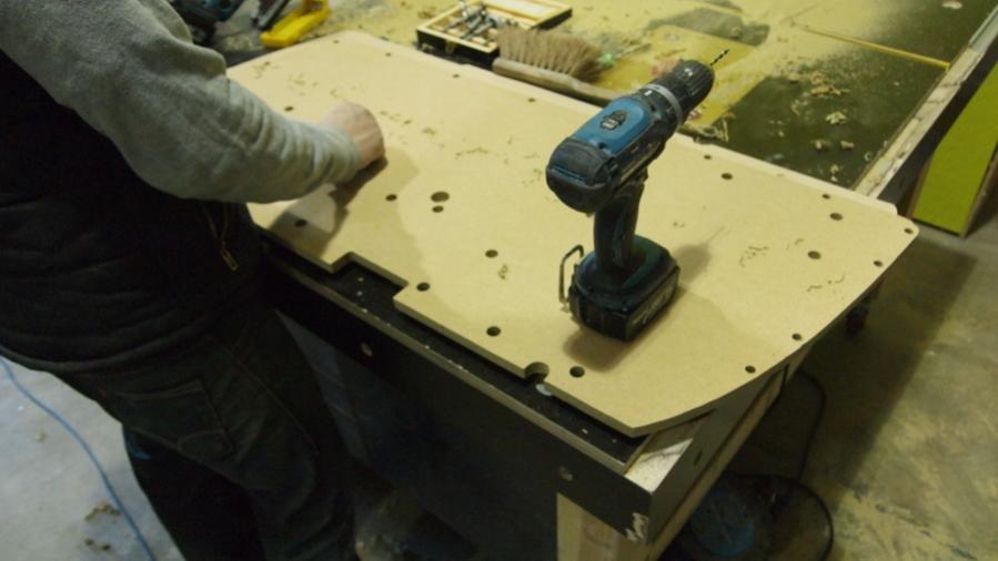

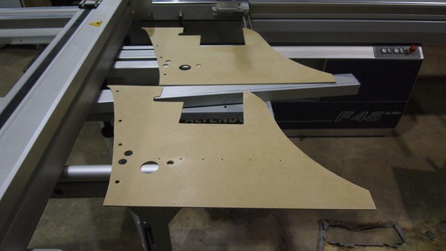

just an update and some images, today we templated and made some new boards for door cards front and rear, i have 2 interiors off to be de-done actually going to bulgaria as it is just so much cheaper than here in the UK and they have done a few before and look very good.
so decided to remake the door card boards as the originals were not in the best of condition, we also made up new boot lining panels and cleaned the grey skins which came up really well and re-covered them
