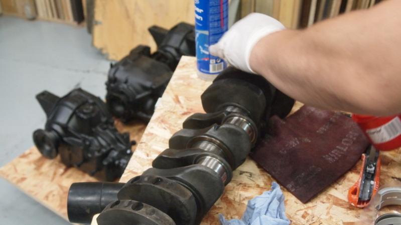

current "situation" is... my 2 good shells are now dipped and back my first not so good shell has been chopped and i have a few panels ready to donate to the good ones....anyway the shells are waiting for a while as we have been working on the CSI engine which we stripped and i had bored polished skimmed and new rings bolts and gaskets, we put the pistons in today and the head will go on tomorrow chain and covers etc.
the other engine a 3.5 m30-getrag 265 is ready now with s38 throttle bodies mounted and i will be painting that over the weekend.
the plan is then to finish the shell in the foreground first as the modified car with GAZ coil overs 17" alpinas and bike brakes all black shell with black powder coated trim, tinted windows exotic wood trim and dash (on my new CNC dash soon for sale) and tan leather interior, far from original but should look the buisness!!
then onto the CSI which will be utter originality
all the undercarriage for both cars has been blasted from 3 sets and will all be re-bushed/rubbers and its been painted with engine paint like the diffs which can be seen in the background

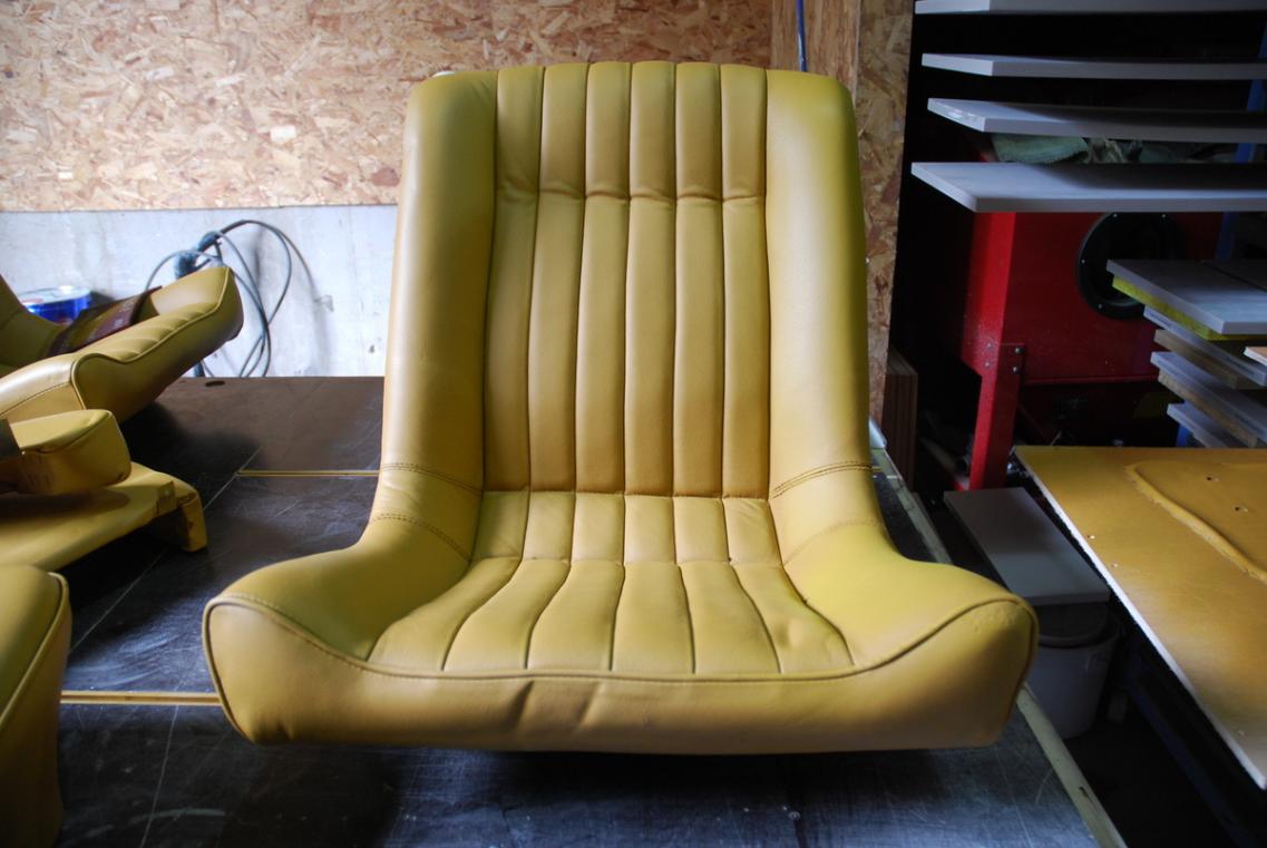

anyways i had a tan leather interior i bought a few months back here in the UK (ebay) and thought i would show the results of a re-spray, never knew you could spray leather!! but ut worked out pretty well i think...some before and after shots using a tinted to match PVC paint mix from my paint supplier about 6 light coats rubbed back in between with a very fine scotch pad and applied with a hvlp cup gun
it looked pretty unnatural when wet and i wasn't sure it was going well at all....but then i got a full and consistent coverage and suddenly it looked great, not too difficult either

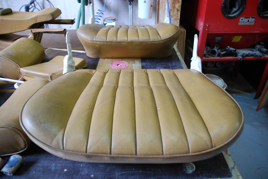

before
good condition no rips or bad damage, just very discoloured and old
