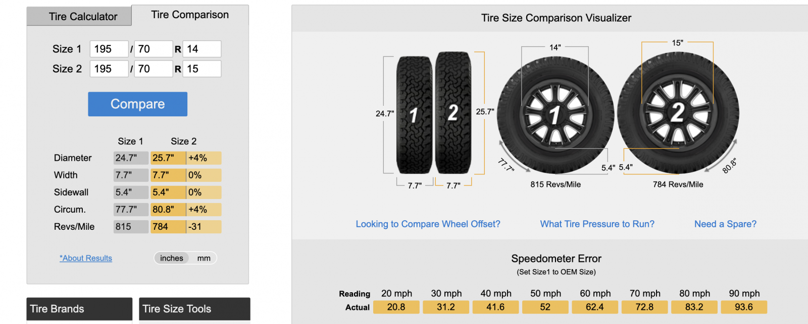

The speedometer will read. lower than actual by about 4% (if the speedometer was accurate with the stock 195//70 14 tires)

You may want to pace your speedometer with a GPS (free ones are available as an ap for your cell phone) to see what the actual error is. My speedometer actually got MORE accurate when I changed from 195/70 14 to 205/70 14.

its not that hard to get a Km speedo. i have one that i will never use - just don't know if it would work for you as it depends on which diff you have. here is the FAQ to determine which speedo you need based on the diff in the car
